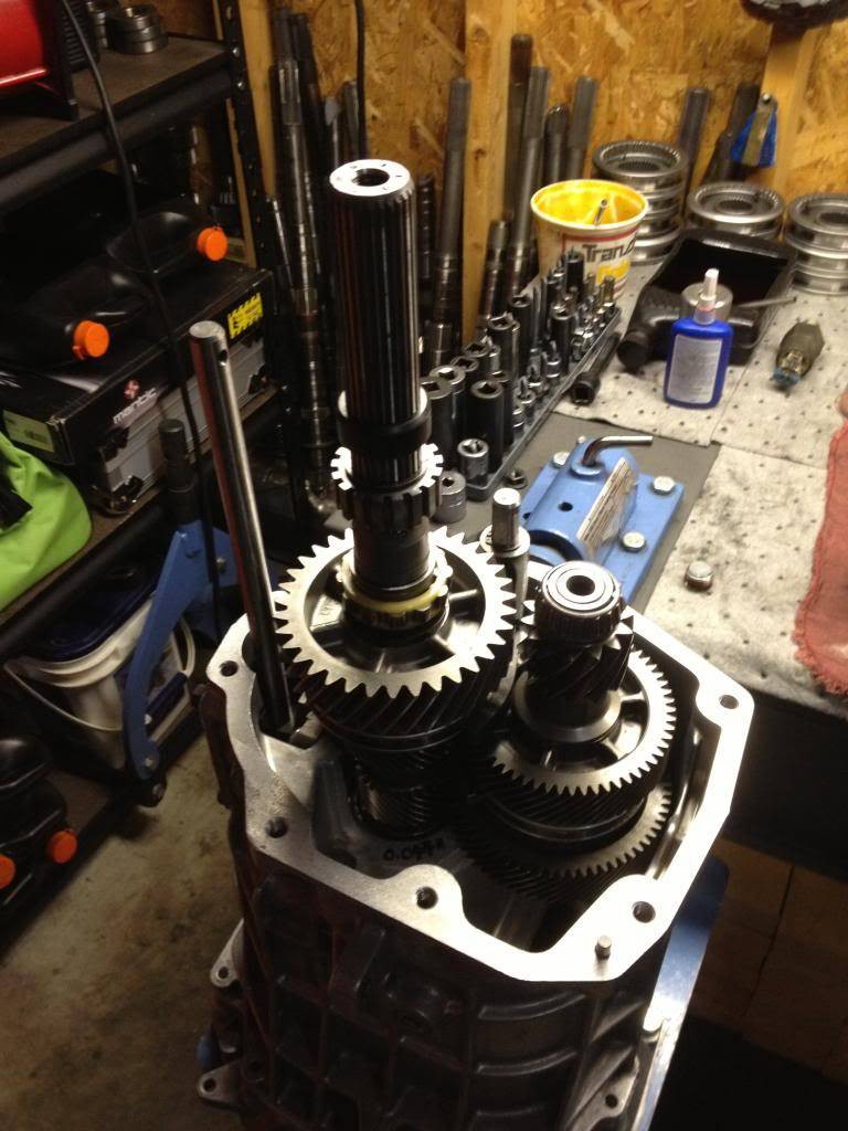

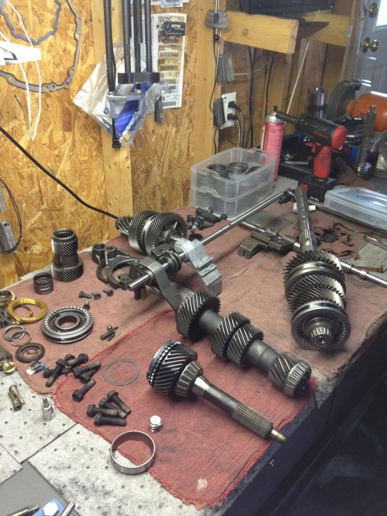

      Ok so I have a lot of pics to put up...and it's been so long I forget what is what.

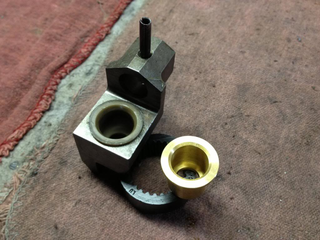

      The first set of pics are of the tear down of my LT1 T56.....
      Good view of some mangled Servo teeth.....
      Douglas Lutes

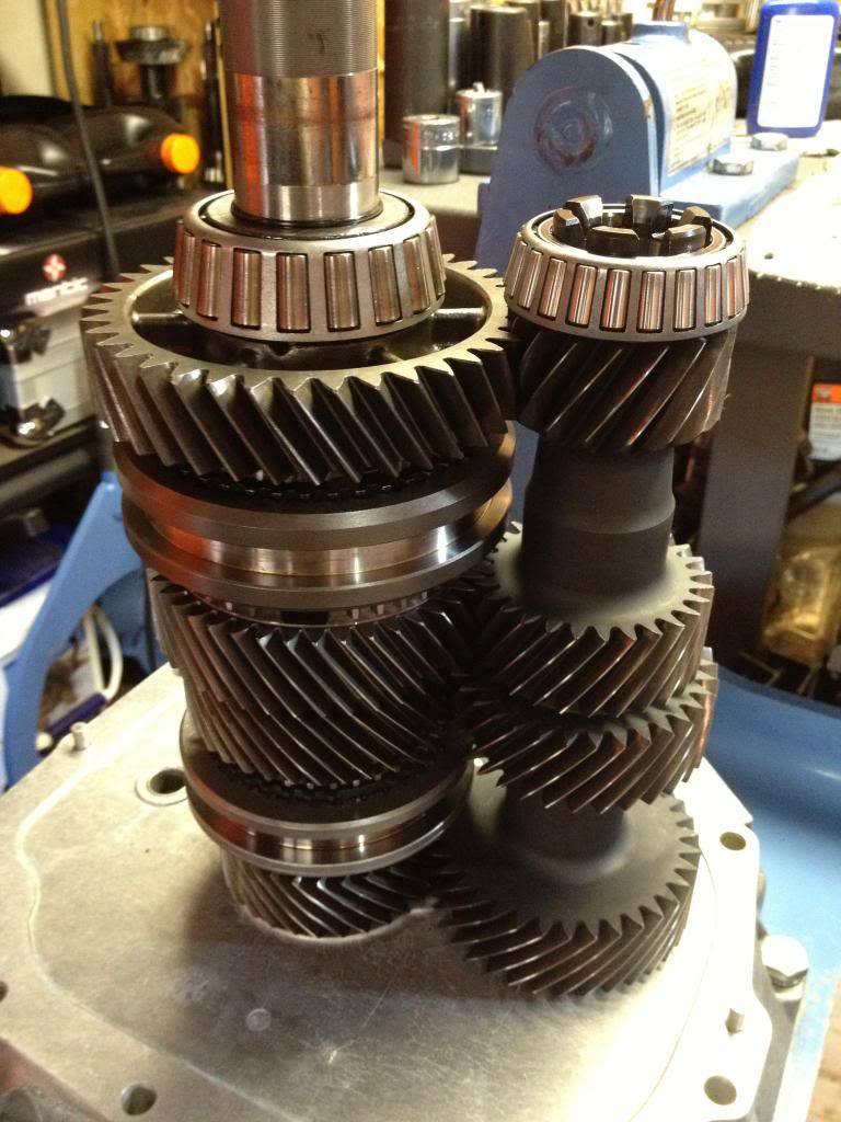

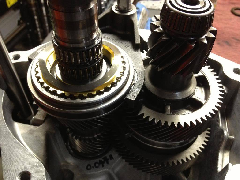

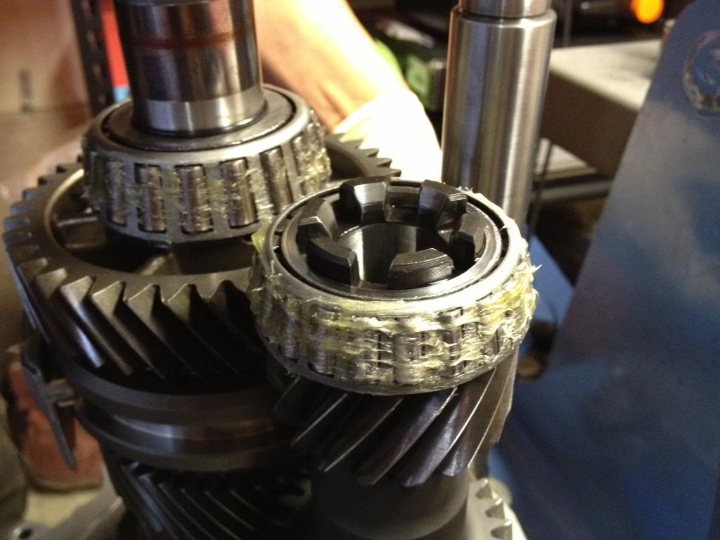

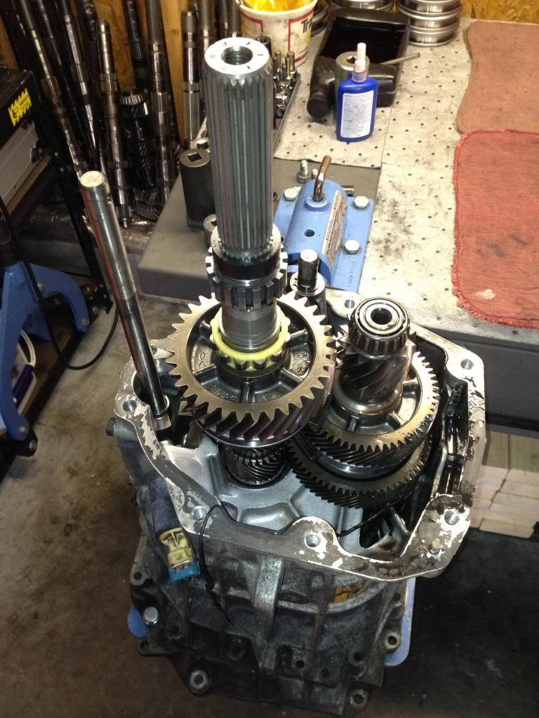

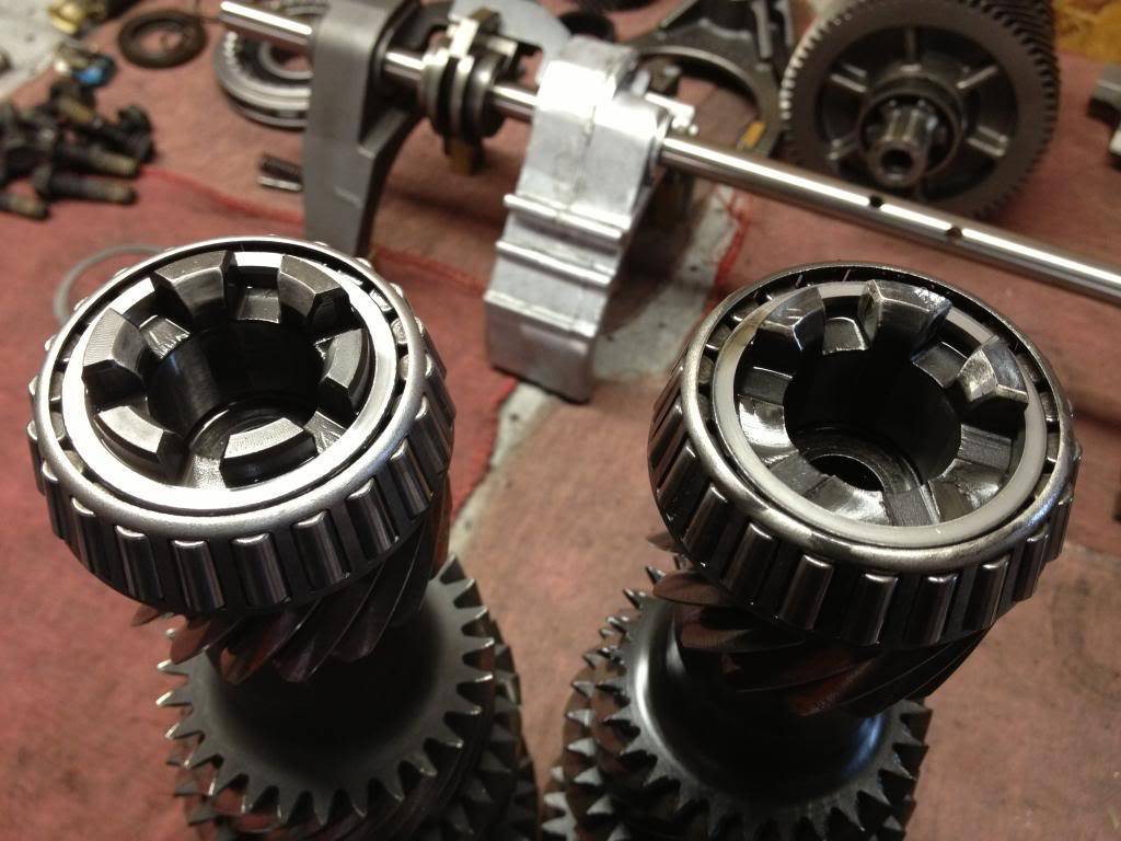

      Here is a pic of the counter shaft...which is missing three out of the six teeth on the castle end of the shaft. This needed to be replaced....
      Another somewhat common weak link in these types of Transmissions is the second gear. The bottom row of teeth are not full lenght to the base and they tend to sheer off under and sort of serious load.
      There she is...all taken apart.

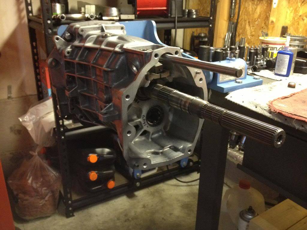

      Let's get this baby all back together with all the new and upgraded parts!!!!!
      Here is a side by side comparison of the new and old counter shaft.
      Douglas Lutes

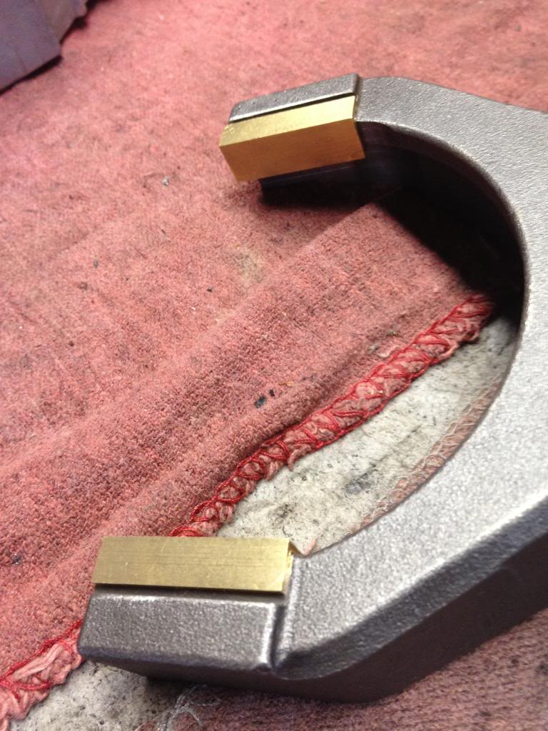

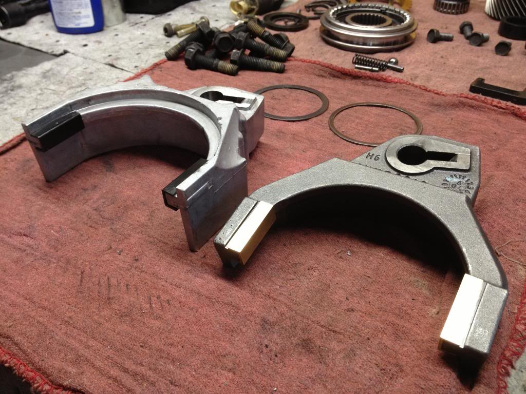

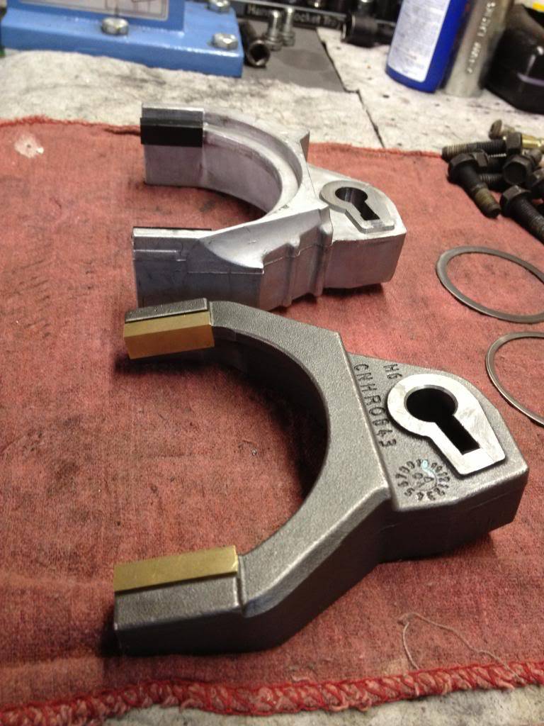

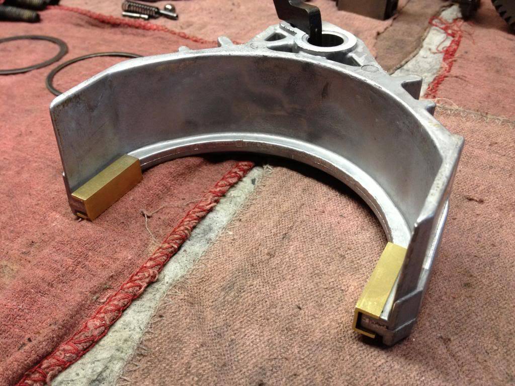

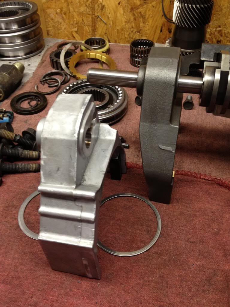

      Here is the upgraded steel shift fork, with the upgraded Bronze pads, vs the weak stock aluminum one.

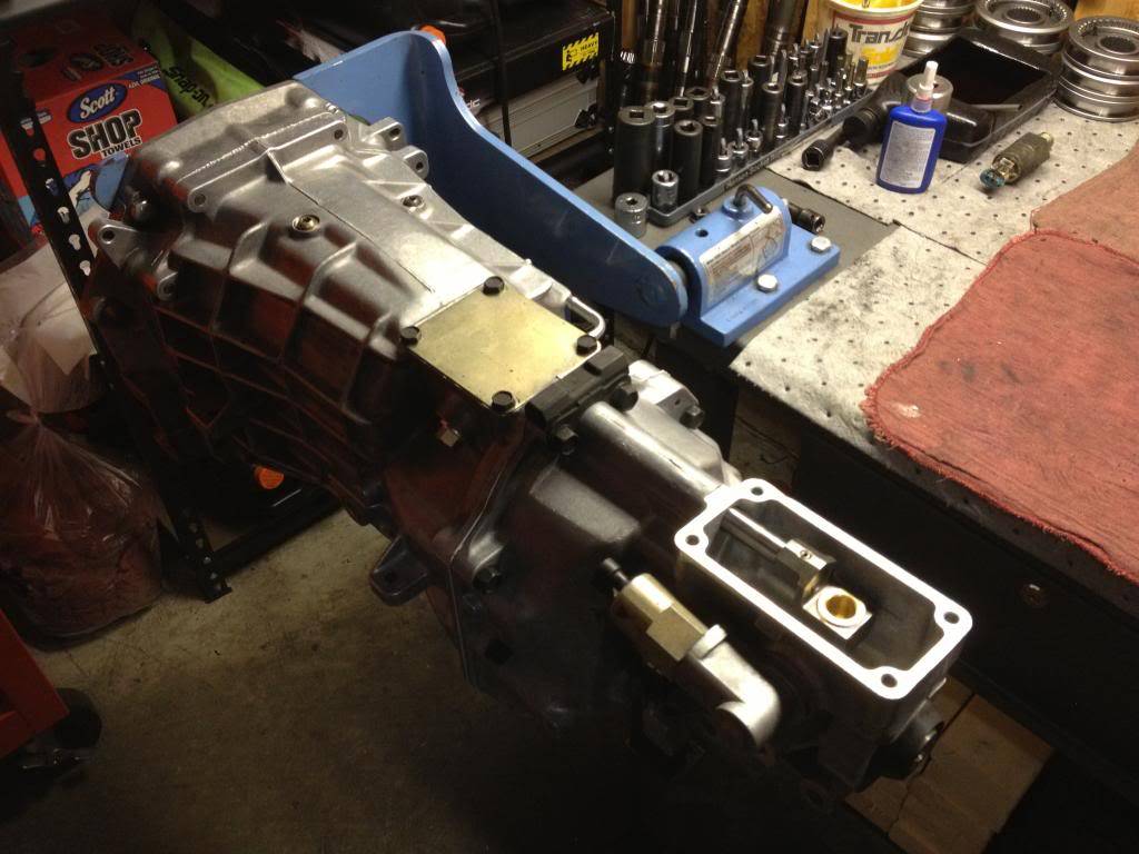

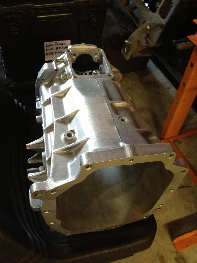

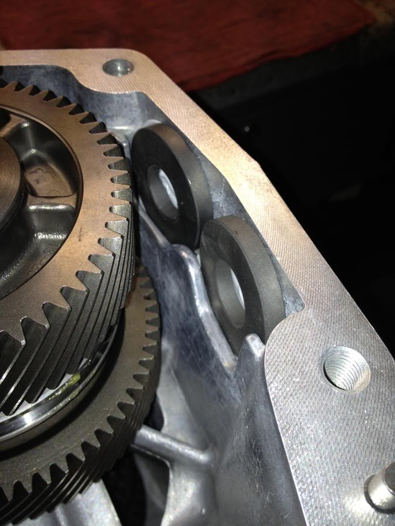

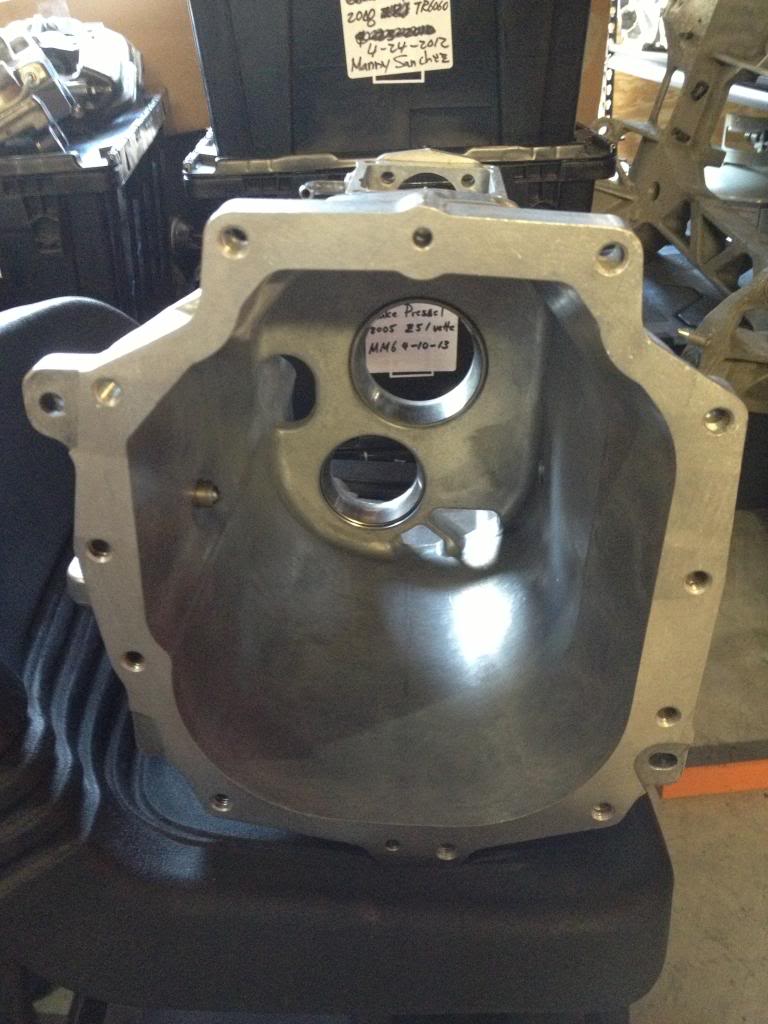

      RKT56 also puts the case in their tumbler to polish up the case....this thing is like a jewel!!!!
      Douglas Lutes

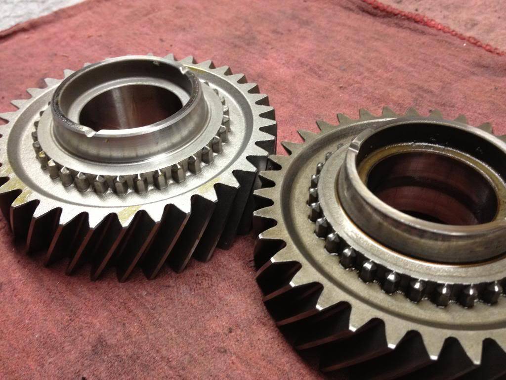

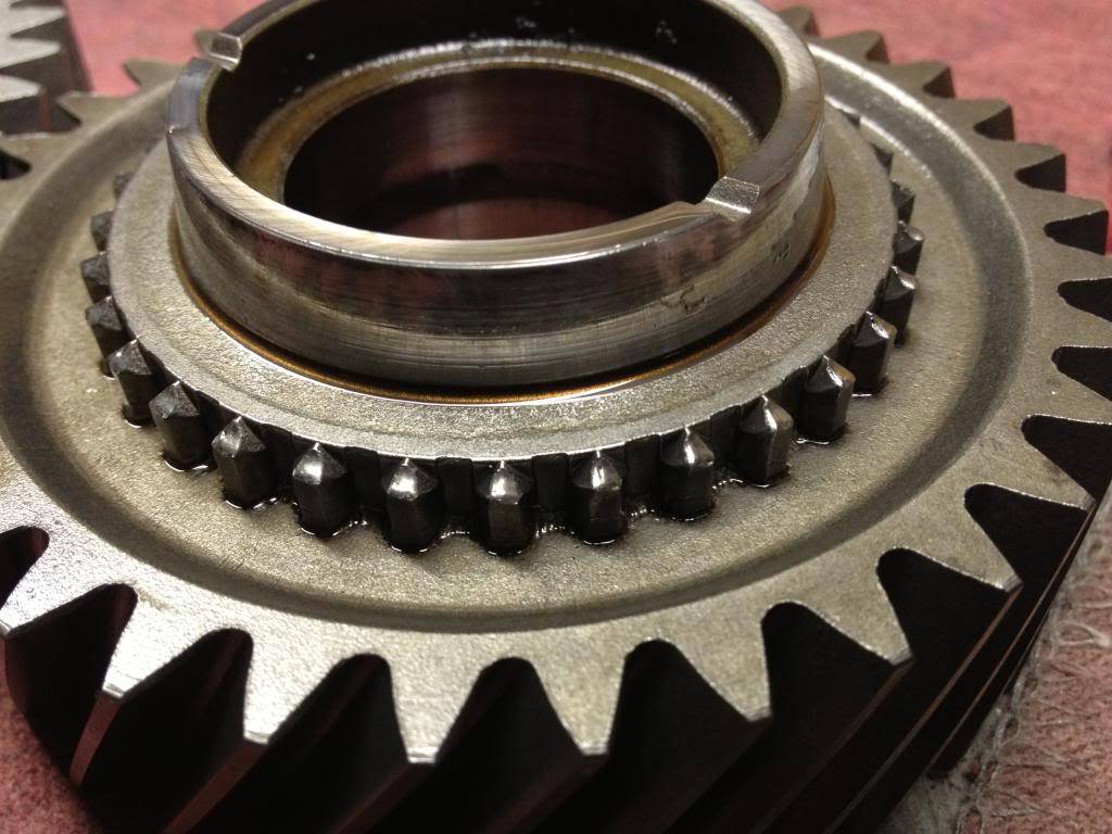

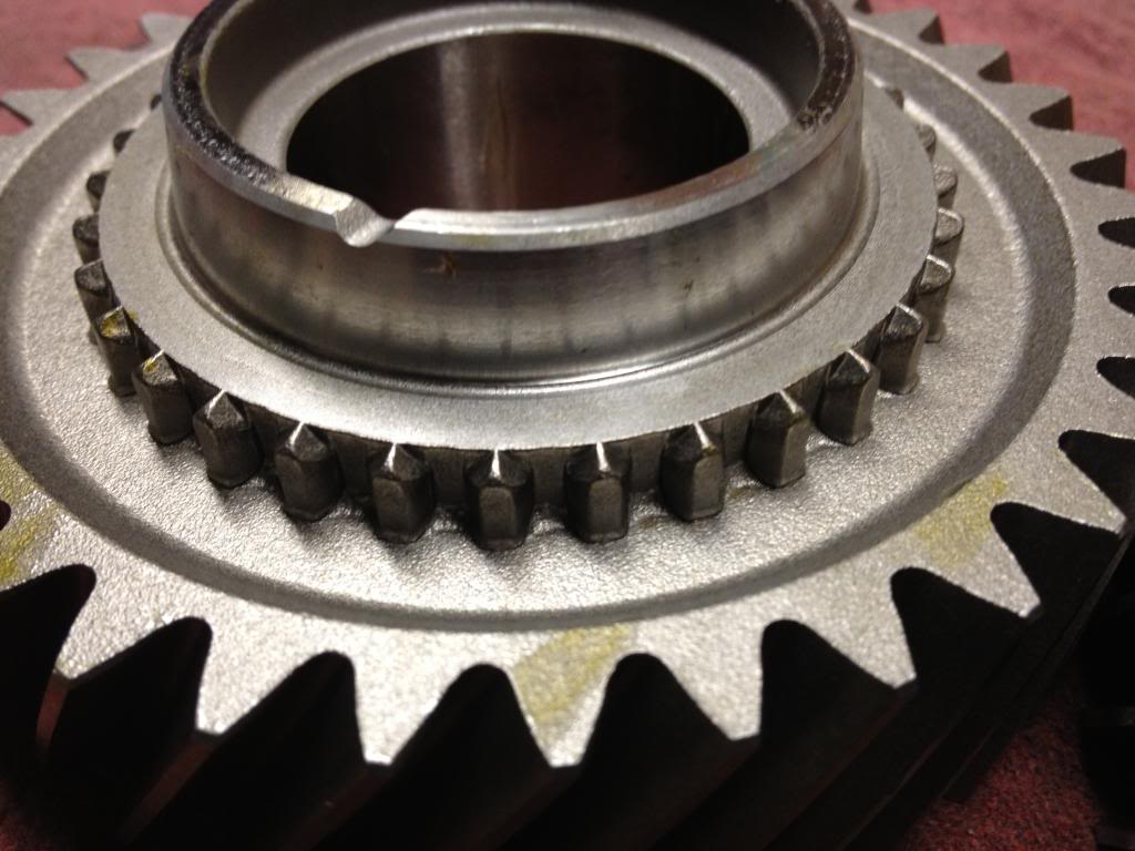

      This is the new vs old reverse gear. You can see how the teeth are rubbed down on the gear on the right.
      OLD
      NEW

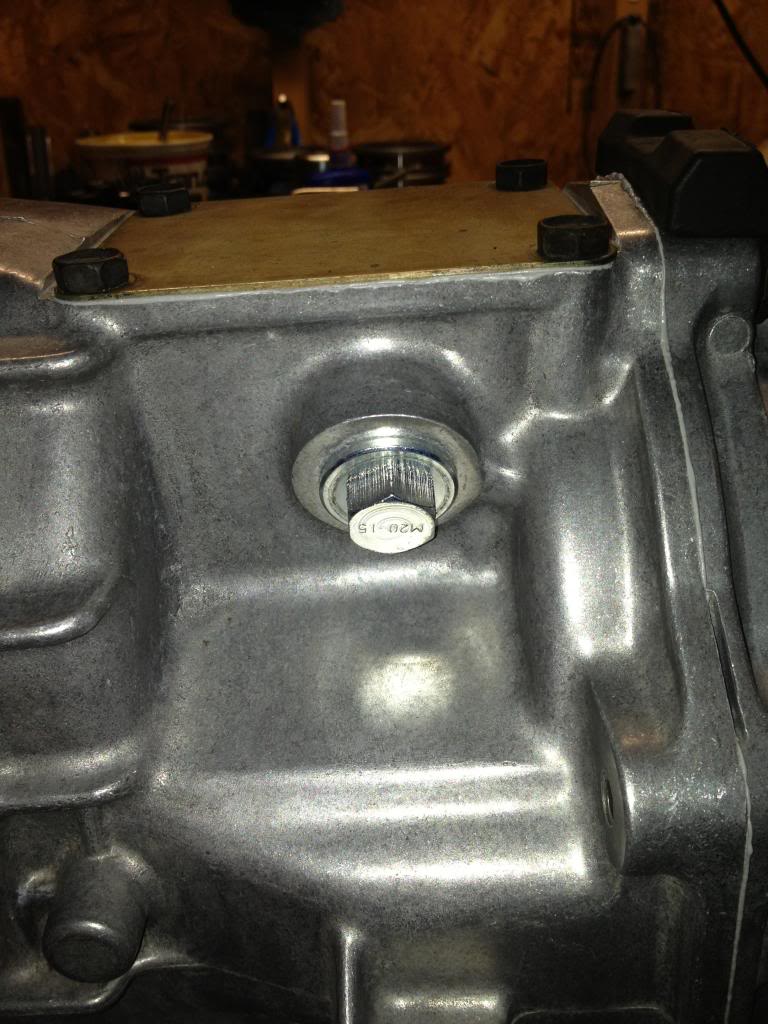

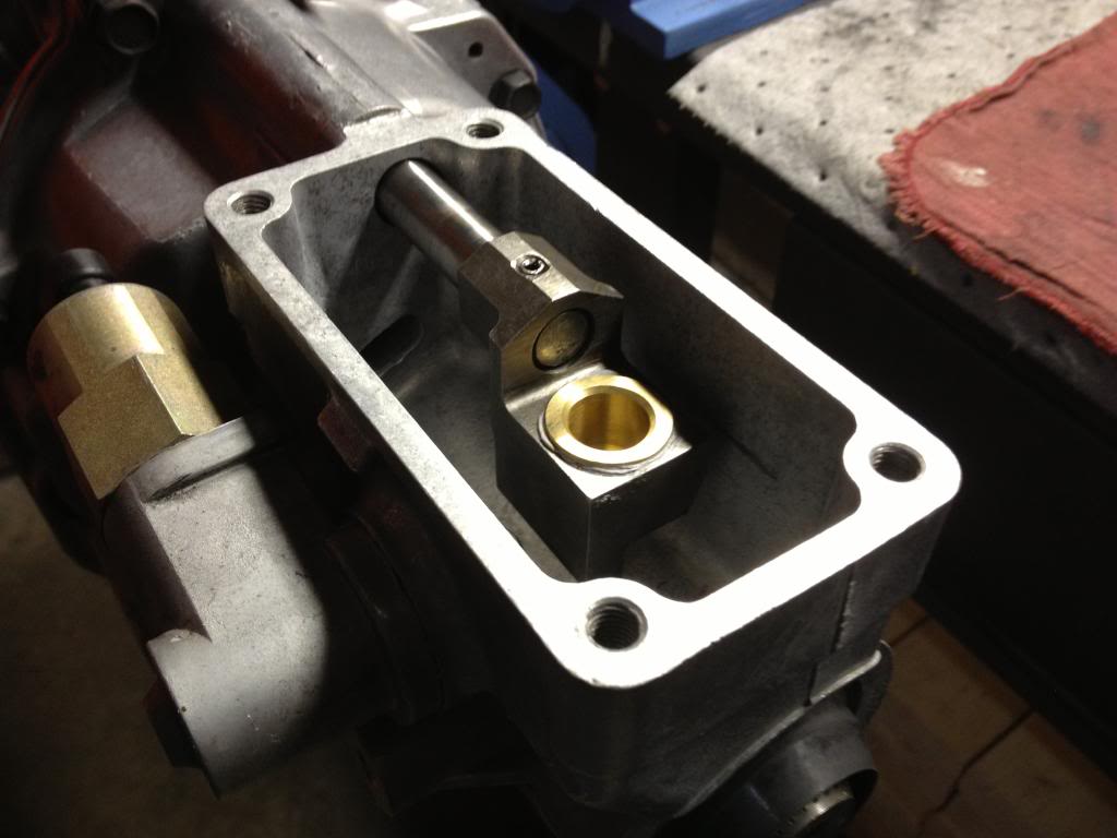

      Plug to delete the skip shift...

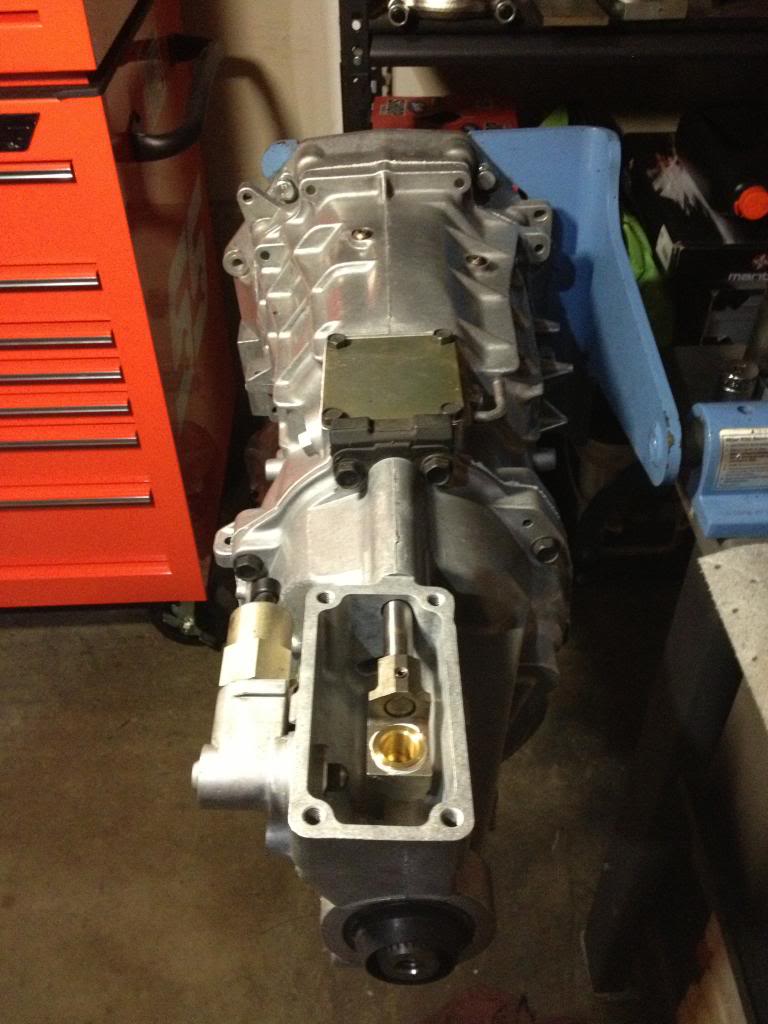

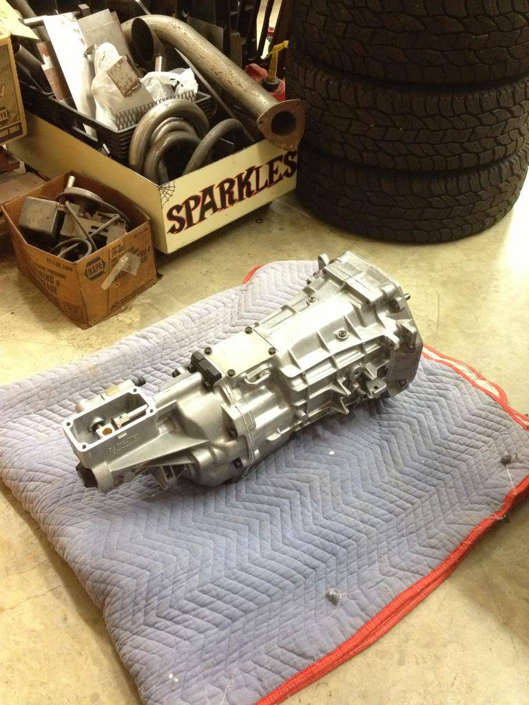

    19. #639
      Woodbine, MD
      2,770

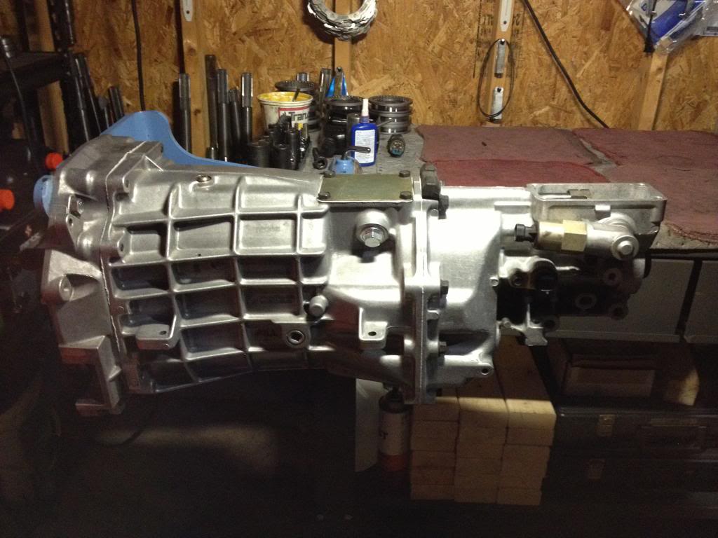

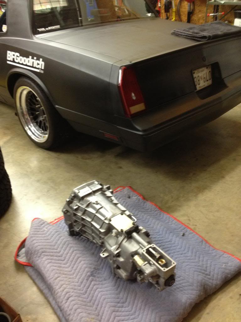

      and she is finally home!!!!

    20. #640
      Charlotte
      1,295
      SPARKLES..... YAY!
      Nice looking t56.
      Did you add those 2 magnets on the bottom of the case?
