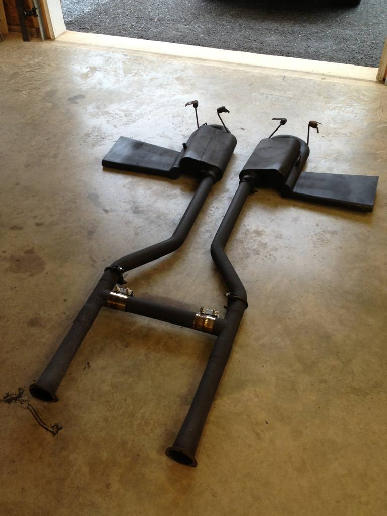

      My exhaust......custom!!

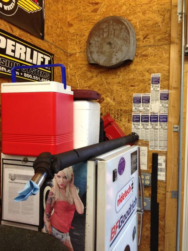

      This looked like a perfect place for a driveshaft!

      I love your exhaust, I actually bought stock C5 Vette mufflers to do something very similar on my car, the difference being that on the C5 mufflers the inlet and outlet are on the same end.

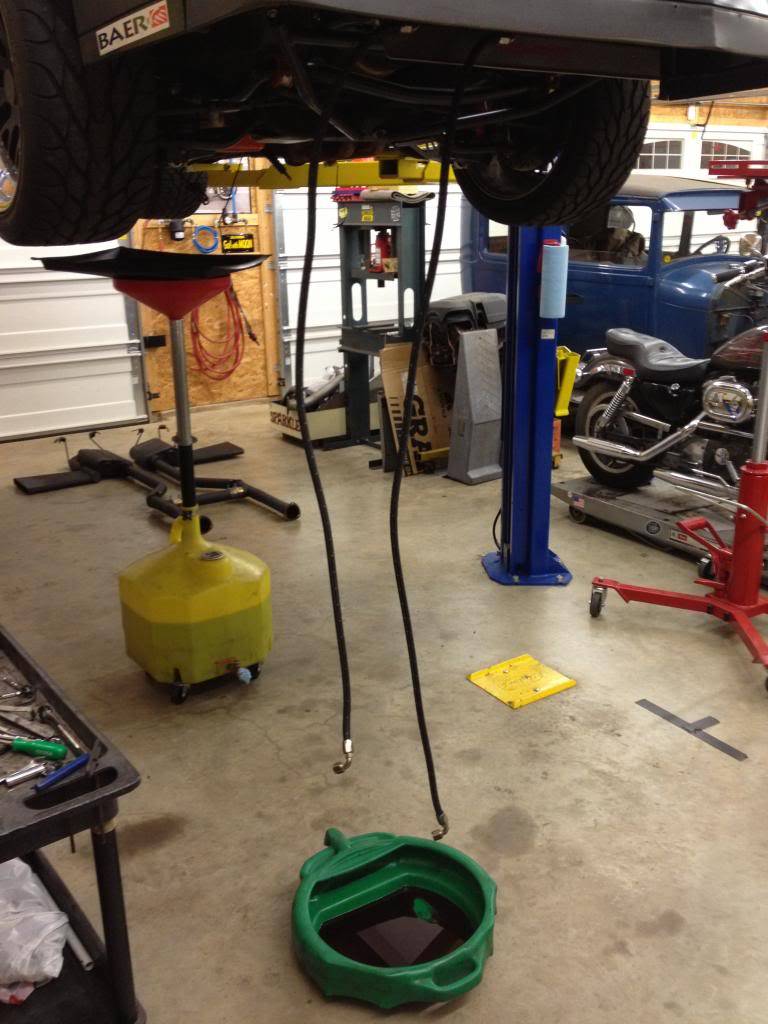

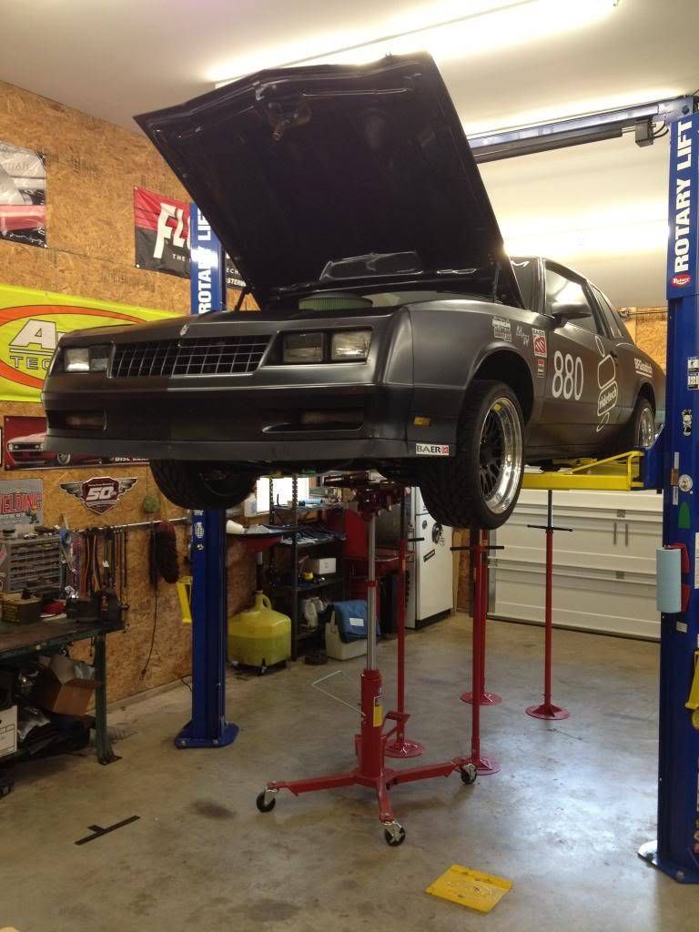

      Well the trans is out and now at the trans shopping....waiting to find out what happened to it. This is a turning point in this car b/c if the diagnosis is minor and the builder will fix it for free then the 200r4 is going back in...but if there is some sort of major issue that isn't covered by the builder then the 200r4 isn't getting fixed and the car will sit until I get a T56. I am just tired of messing around with this car.
      Trans lines are down...and draining.
      Douglas Lutes
      1988 Monte Carlo SS

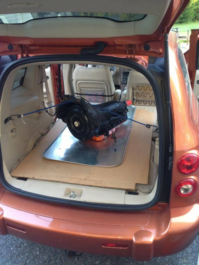

      The trans in my daily driver HHR on the way to the trans shop...

      With the trans out and the Monte up on the lift...there will be plenty of down time to finally complete some small projects on this car.

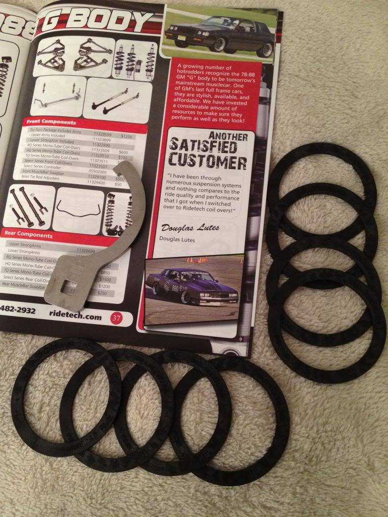

      I think the first will be installing these new coilover spring bushings that the awesome crew over at ridetech sent me. I dig the new spanner wrench too!!!!!!!!
      BTW...it's company's like ridetech that keep me going. Just the best bunch of people around.
