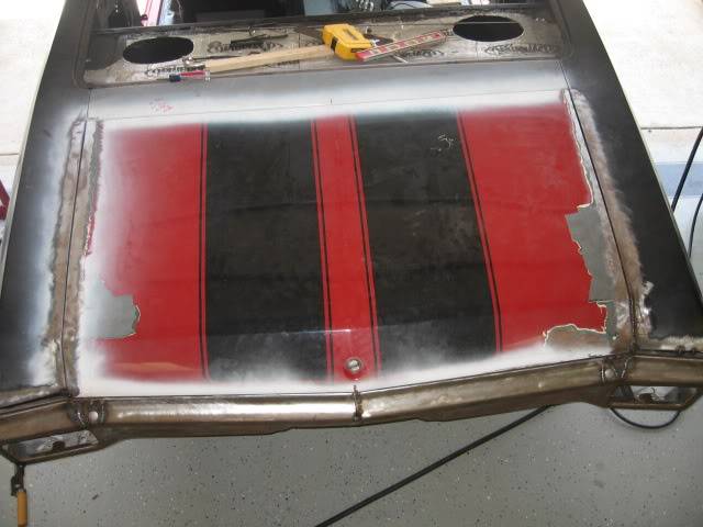

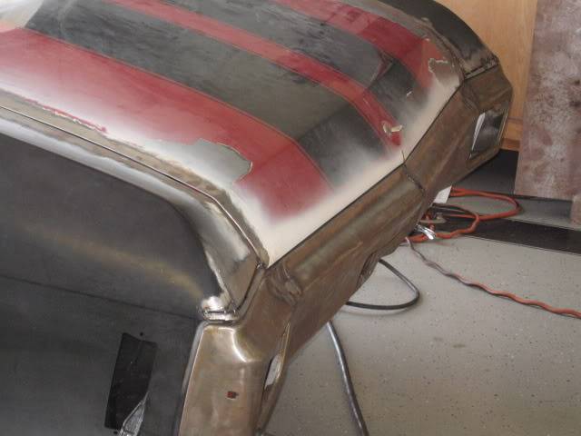

      a little more work on the bumper today. ive been taking a bunch of classes at work, so progress has been slow. its hard to come home after not seeing the family for 3 days and head out to the garage. so not much has been getting done.
      but, i got both quarters roughed in to the bumper. both sides needed to be extended out and down to get the gap a little better. i also smoothed the bumper brackets after final welding them to their new size. i started smoothing the welds on the bumper as well, but these pics were taken before i started on that. so...... i need to fill in the slices/gaps on the quarter, finish smoothing the welds, weld the brackets to the bumpers and smooth the bolt holes and then i need to start on the filler panel that mounts to the bottom of the bumper. i figure i have another 10-15 hours before im finished.
      im pretty happy with the results. its been such a long time since i started that its hard to tell how much progress has been made. i wish i would have taken a bunch more before pics, but either way its better. i'd say that with the old being a 1 and a perfect being a 10 that this falls into the 6-7 range. there are a few things that i wish were better, but i dont have the time or skills to make them perfect. most obvious is that the ends of the bumper still dont follow the quarter perfect. its only off about 1/8 - 3/16, but i wish it was 0. when i worked the quarters i could have made it 0, but the transition btwn the deck lid and quarter would have been screwed up. i'll get some more pics once i get it all smoothed out.

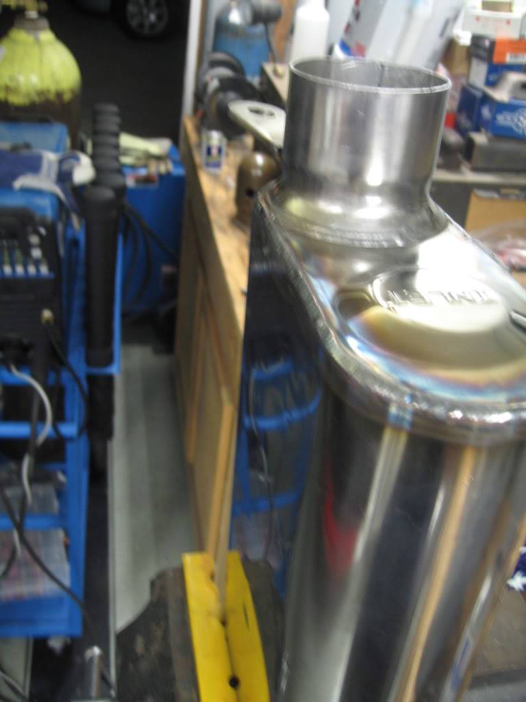

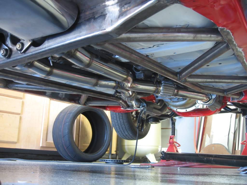

      i need to get the exhaust done so i can get the frame to the blasters and get it all in paint by the end of the summer. its taken a lot longer than expected, and my few hours in the garage at a time goes by really fast.
      i started with a mix of 3" and 2.5" tubing and transitions from columbia river, and bends from pypes all in 304 stainless. i spent some time polishing all the stuff from CR since it didnt come done. overall, im pretty happy with all the pieces i purchased.
      now the issues...... i had debated whether to keep the donut gasketed joint from the edelbrock headers, or cut it off at the collector and do v-bands. im glad i left it alone, but i hope it doesnt leak. assembling and disassembling has really done a number on the gasket. i hope to get some more before its put together for the final time.
      issue two.... don't make a 16ga stainless exhaust your first tig project ever. i practiced a little before the tacks, but fitment has to be dead nuts perfect or i blow a hole. and i do mean PERFECT! and i still havent figured out how to fill a damn hole. some pieces are tacked without issue, especially those done on the bench, but it seems that if i blow in one there are a few more holes before it sticks. im still tacking everything together, so hopefully i can practice a little more and maybe the back purge will help things a little. i am AMAZED at how well a tig tack holds though. 2 tacks on a piece and i cant break it apart. i have to knick the tack with a grinding wheel to make it work.
      issue three..... maybe i dont understand the mandrel bending process, but i was hoping that if i cut a piece in the middle of a bend that it would be the same size as a piece cut from any other random part of any other tube. its not! the bent piece is smaller and that has led to some fun issues. its not a huge difference, but the extreme ones are about 1/16" different. that means when joined, one has a ring exposed all the way around the joint. i have a feeling these are going to be fun to final weld.
      i could talk for hours on the "experience" i have had so far. if you see something, i probably have an answer for it, but id rather not bore you with any more babble. here are the pics of where i am now.
      flex joints so that the rest can be solid/poly mounted.
      there is more room here than it appears. this was all complicated by flowmaster not having the muffler in a offset in/out. no hangers are in place yet, so its resting on the holes in the mid crossmember. this is the easy side though. the watts link is 6" higher on the other side. its going to be interesting to say the least.
      i have it coming under the frame behind the tire now. i just need to decide where to run it, and whether it will come out under or through the rear bumper lower valance.

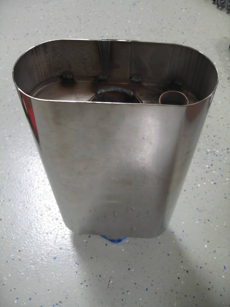

      so i had some decisions to make on the mufflers. the wife wanted it quieter than before, but i still wanted it to sound good. i ended up buying the stainless 50 series deltas back in december when bing was giving 20% off ebay purchases. ever since then i have somewhat regretted not going with the 40 deltas like i had before. i figured that the bigger motor and larger piping would make it louder, but that the increased insulation, carpet and x-pipe would mellow it out a little. a wash? im not sure.
      since i had to open one up (i'll get to that later) and i had already polished them and couldnt return them, i had three choices. leave them as is, weld up the resonator chamber in each muffler essentially making it just a longer 40, or removing the extra 4" and making a 40 series. i ended up just leaving them as is, but if i want it louder after its been on the road, i will take the full 4" out at that time.
      then there was the other issue (the part i said i would get to). flowmaster only makes one part number per style (inlet/outlet) of muffler. so, if you need two mufflers with offset inlets that are next to each other (our chevelles), one muffler has to be flipped over. when you flip a flowmaster, you get the ugly case seam. and since i was polishing them, that wouldnt work. below are the pics of what i ended up doing. cut the end off and grind away their weld until the stamped plug end was back to normal. then just flip, reinsert and reweld. now i have a matched set.......
      here you can see the inlet side of the muffler. the small hole to the right is the inlet to the resonator chamber. that is what i had planned to weld up.
      here it is flipped and rewelded. i cant get any good pics of the welds. they just look blurry.

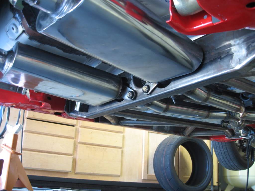

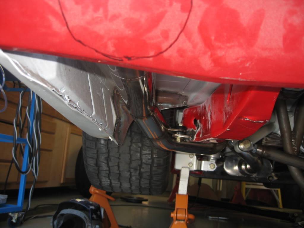

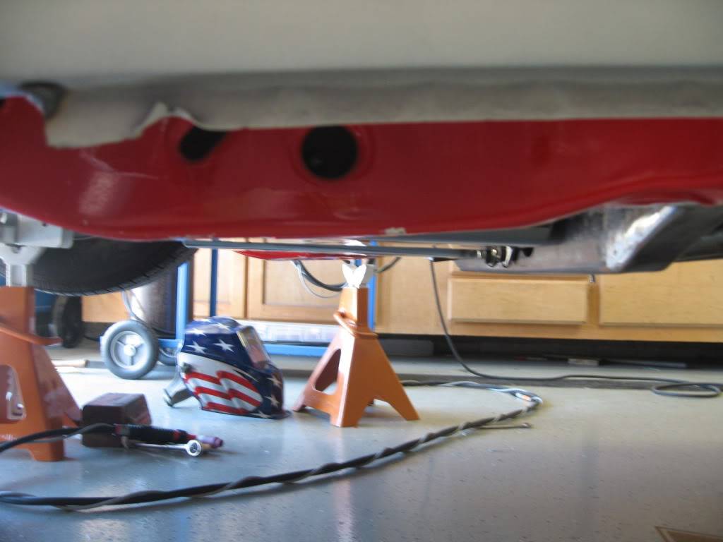

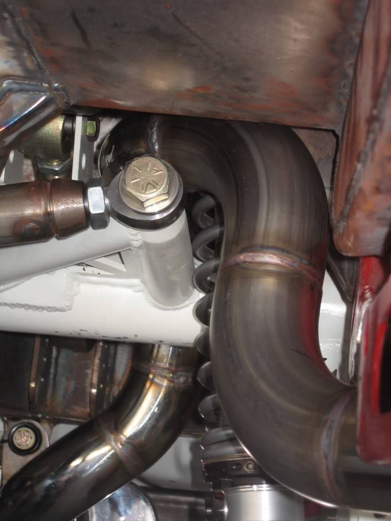

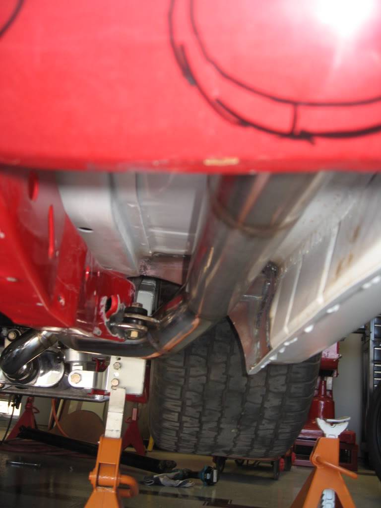

      here are the rest of the exhaust pics. like i said before, an average of a B/B+ on weld appearance. some are D's mainly on the right rear tailpipe since i did it first, but there are a few A's as well. did i heat it too much and lose the stainless properties? only time will tell. i have a pretty good rainbow effect, and the haz isnt too wide, so i hope im fine.
      the first two show how the frame was cut to allow the exhaust to sit up higher. i would have loved to have made them go through the frame for a little more rigidity, but i would have needed another two vband clamps to make it work and the hole for those flanges needs to be pretty big. i also got the mounts from the roadster shop. im hoping i dont end up melting the ones closer to the motor.
      the exhaust will exit through the valance below the bumper. i have some transitions to make the tips 3" and i plan to make them slightly oval. that work will come once the frames done and the bumper gets completed.
      here you can see the tight spot. if i would have welded the watts connector on at more of an angle and given myself another 1" of clearance, i would have saved a few days work. this was a TOTAL PAIN IN THE ASS!!!!! the watts crossmember had to be notched to make it work. this was another time where changing build plans bit me in the ass. i never expected to have the car so low that 1/4" of travel mattered. the rear never went this low when i set up the watts since it wasnt until after that i notched the fram.
