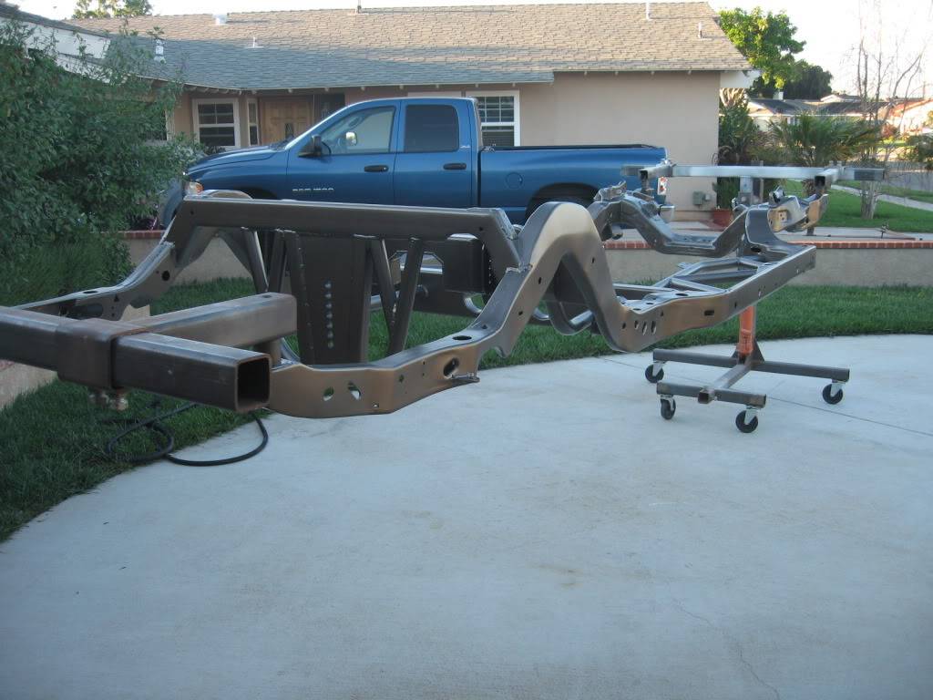

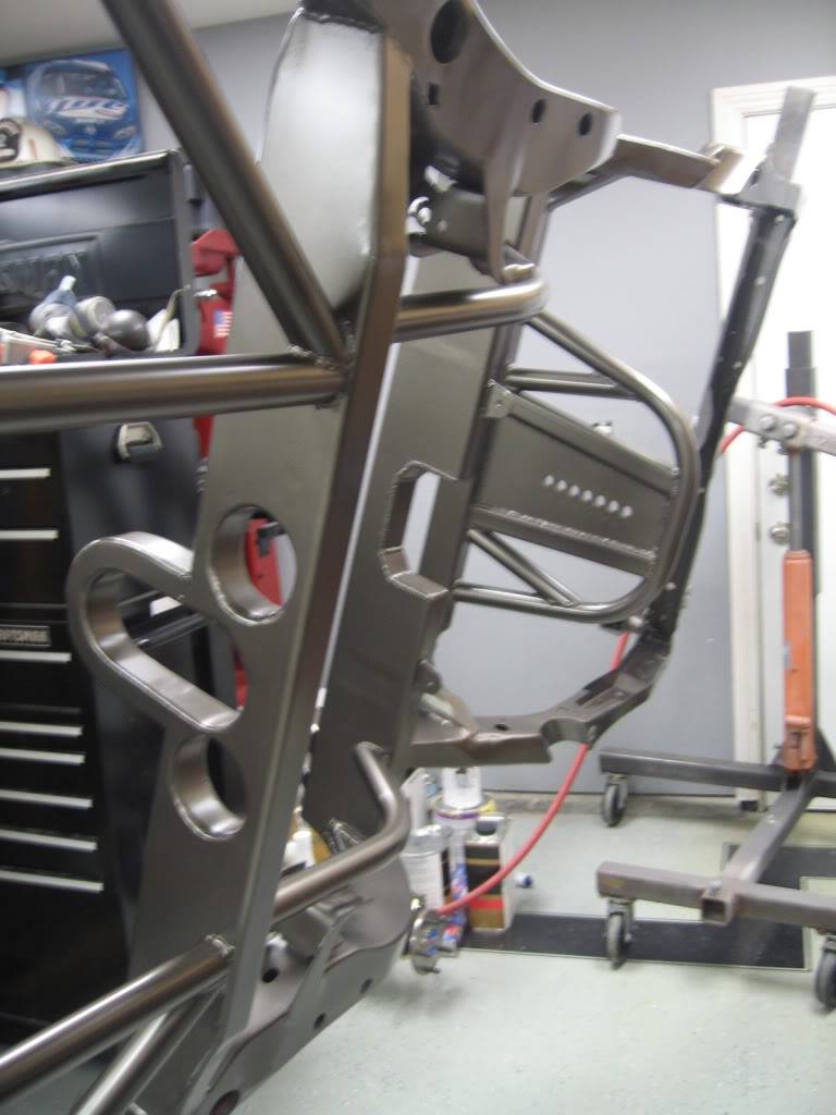

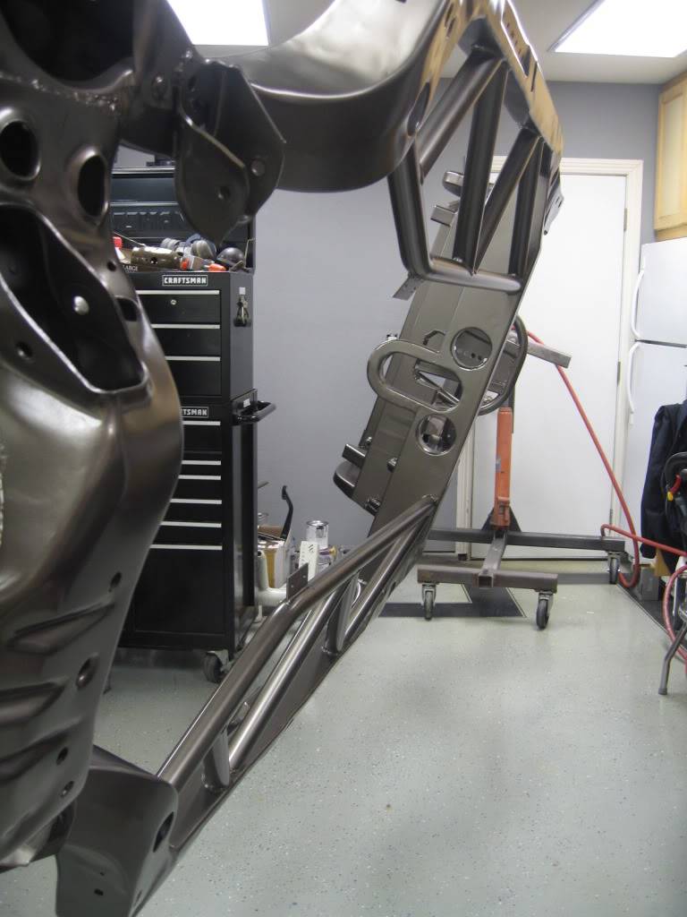

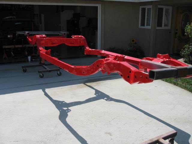

      well its done. at least the frame. it turned out ok although i had hoped for a little better. i could have used another two coats of slicksand to smooth it out a little more, but like the wife keeps saying, nobody is going to see the damn thing. i did have two areas i really wanted to nail; the outside of the rails that are seen under the rockers of the body, and the top of the rails in the engine compartment. id give the sides an 8 and the engine compartment about a 6. there is one area where the seam show a little on the tops of both engine compartment rails. again, another coat of slicksand would have cured it but i was over it. it looks good. overall it was much better than last time. i spent a lot more time with the blocking this time.
      after painting all the parts tomorrow im going to take a couple weeks off from the car. i plan to get all my bolts and anything else thats now gold zinc together and get everything done in either black cad or black zinc. i should have it back together by the end of the month.
      here are a couple pics.
      Tim

      i got the rear cleaned up and sanded today, so it will get color and clear tomorrow. then comes a short break.
      i was organizing pics and looked back to 3 years ago. the pics look familiar, but a lot has changed. can you say deja vu? i actually dont have many of those suspension pieces left either. most of it was new and then was sold............

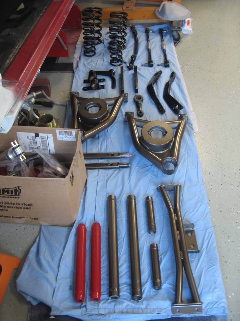

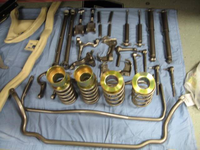

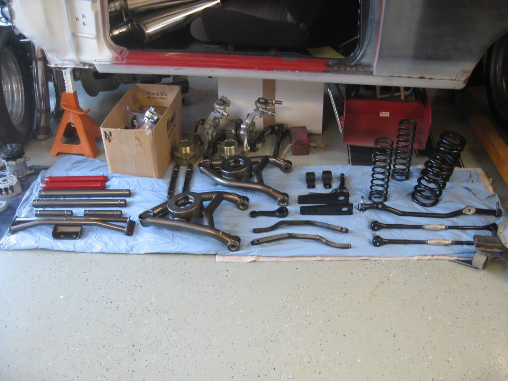

      so most of the parts got painted today. i was hoping to get the rear housing done as well, but there was just no time to prep it. the plan is to prep it tomorrow and shoot it sunday morning. im also going to paint the alternator and the a/c pump. i had planned on shooting them the grey, but i may change my mind and shoot them black. we'll have to see.
      the parts actually came out better than expected. i didnt do much in the way of prep, so you can tell if a parts sand cast. i'll call it character......... i did the same thing last time and was happy.
      i can't wait to get all the bolts together, coated and then assemble it all again.
      here are some pics. i stole the reds watts arms from penny, but really i needed something to make them visible and draw attention to the suspension. that is also the same red that is going on the outside of the car.
      oh and as you can see in the last pic, i need to cut the shrubs and mow the friggin lawn! or so my wife tells me........
      Tim
