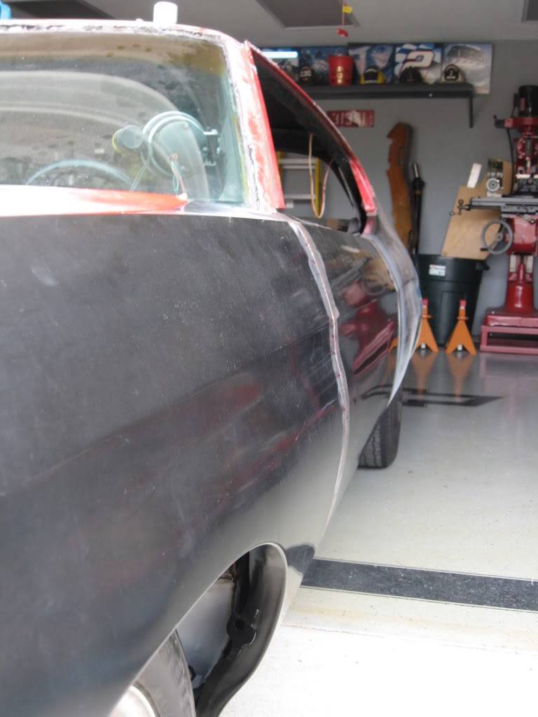

      so i now have both doors on and i have started working the drivers side fender. it lined up decent to start with, but no where close to where i wanted it. so far i have about 5 slices above the body line and about 5 more within the 3 inches below the body line. it still needs some adjusting, but the top half is getting closer. its a total pain in the ass since each small move can make a big change and since every slice requires the fender off, it takes time to get it back where it was.
      i also wasted some time adjusting my slices based on how i sighted it. since the gap varies about .050 now, making it sight right and making it follow a straight edge across the gap were two different things. since the gap will eventually get fixed, i had to go back and redo it. still not done, but much closer than when i started.

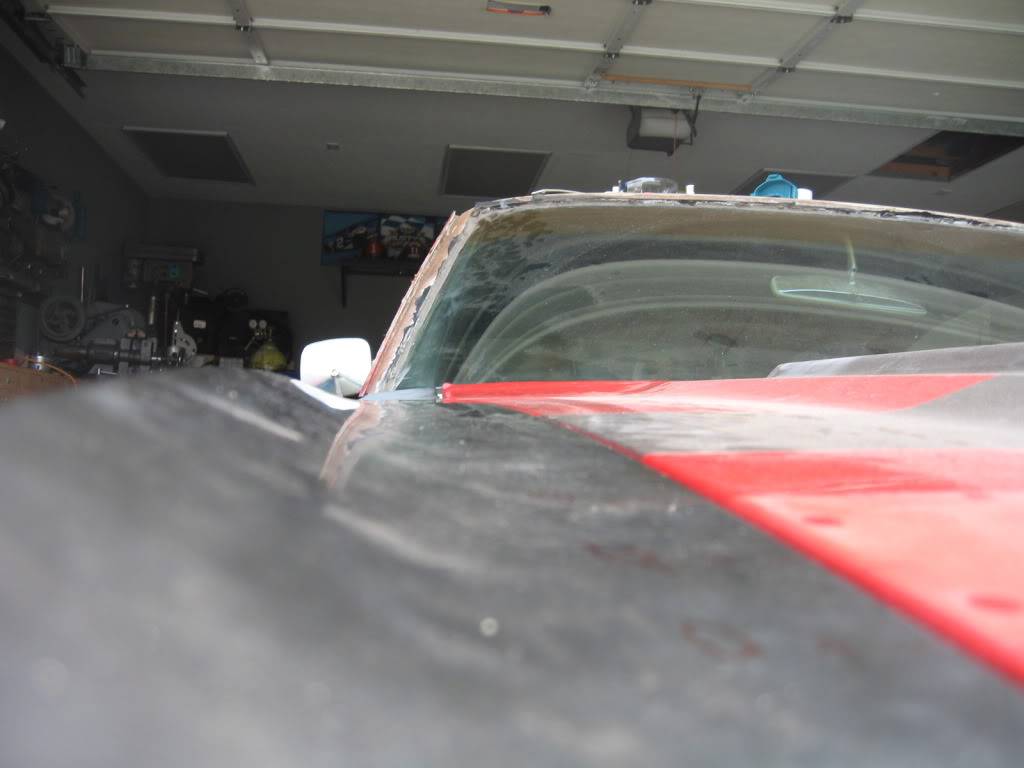

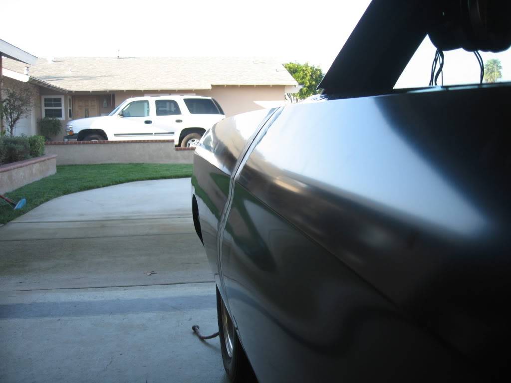

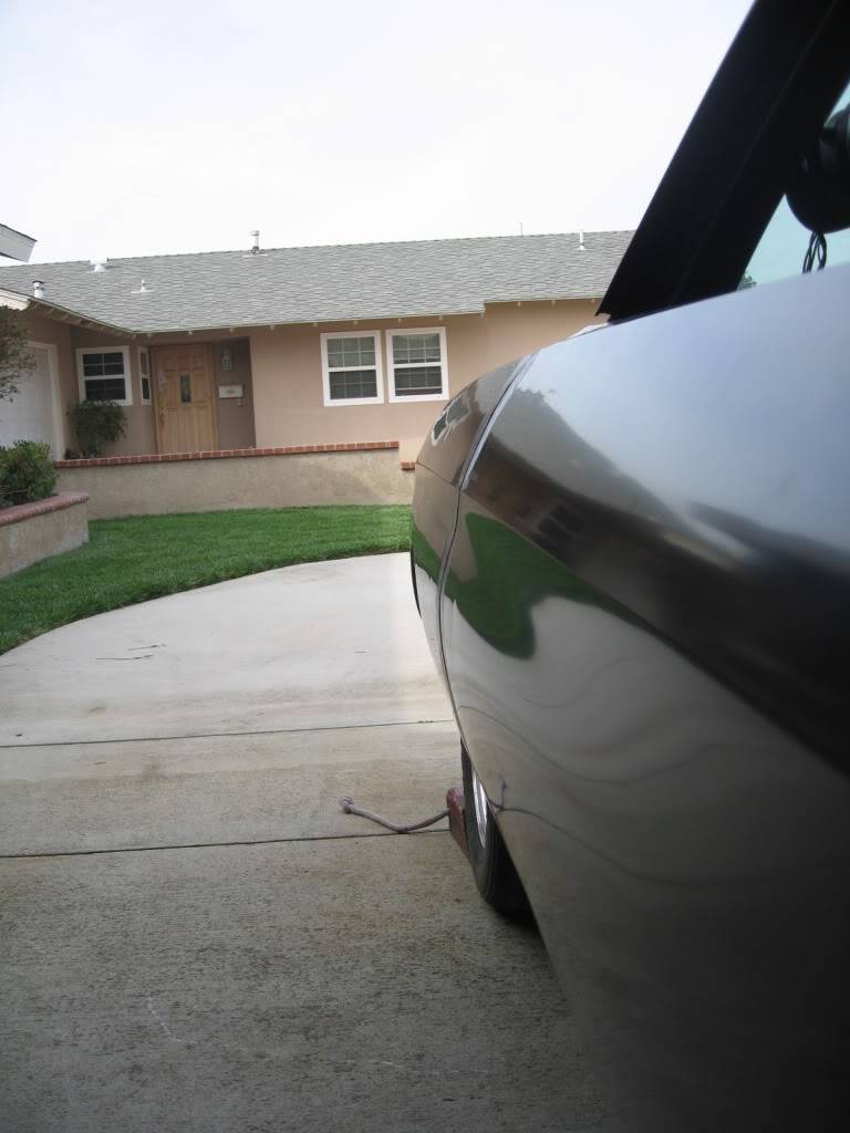

      i finished roughing in the door last week and got the hood on earlier this week. i'll finish working the door gap once everything is squared up for good. every small movement changes it just a little, so it would be a complete waste to try to do any more now.
      im still struggling with the hood though. im shooting for about .180-.190 gaps and had to make some more adjustments to the tops of the doors and fenders to spread them out just a little and widen the gaps some (another reason im not touching the door gaps till its done). even though i tried to measure and set them correctly when the hood was off, i knew this would happen.
      the biggest issue i had was that the passenger side of the hood and the fenders contour were off. by about 3/8"! the front and rear were flush, but the hood sat too high in the middle. i tried bracing it at the front and rear and applying some pressure, but it was going no where. since i dont have my original fenders, and because i cant remember 8 years back to whether they fit this way or not, i had to come up with a plan. i planned to make slices all the way down the inner structure of the hood, but realized that this would take some work to metal finish.
      so, instead of butchering the hood, i drilled out 12 of the 14 spot welds that hold the outer fender skin to the inner. i left the front and rear spot welds alone and raised the middle the 3/8 that was needed. i plug welded the holes back up and just need to grind down the welds. its about .020 off in height at the worst spot, but i plan on skimming the gaps anyways, so i figure this is well within spec. i also noticed that when i was done moving the outer skin, a couple reference points now match the drivers side fender. hard to explain, so i'll post up some pics later to explain.
      the next step will be to sand off the old paint and the ecoat and start working the width of the gaps. i was surprised at how consitent they are now though. +/- .010 is about what im starting with. i'll see if they get any worse when the old paint is gone.
      here are a few pics.
      this is the first of the hood after i corrected the high spot. the camera makes the hood look high, but its the angle. it sat about .375" high at the grey spot on the hood.

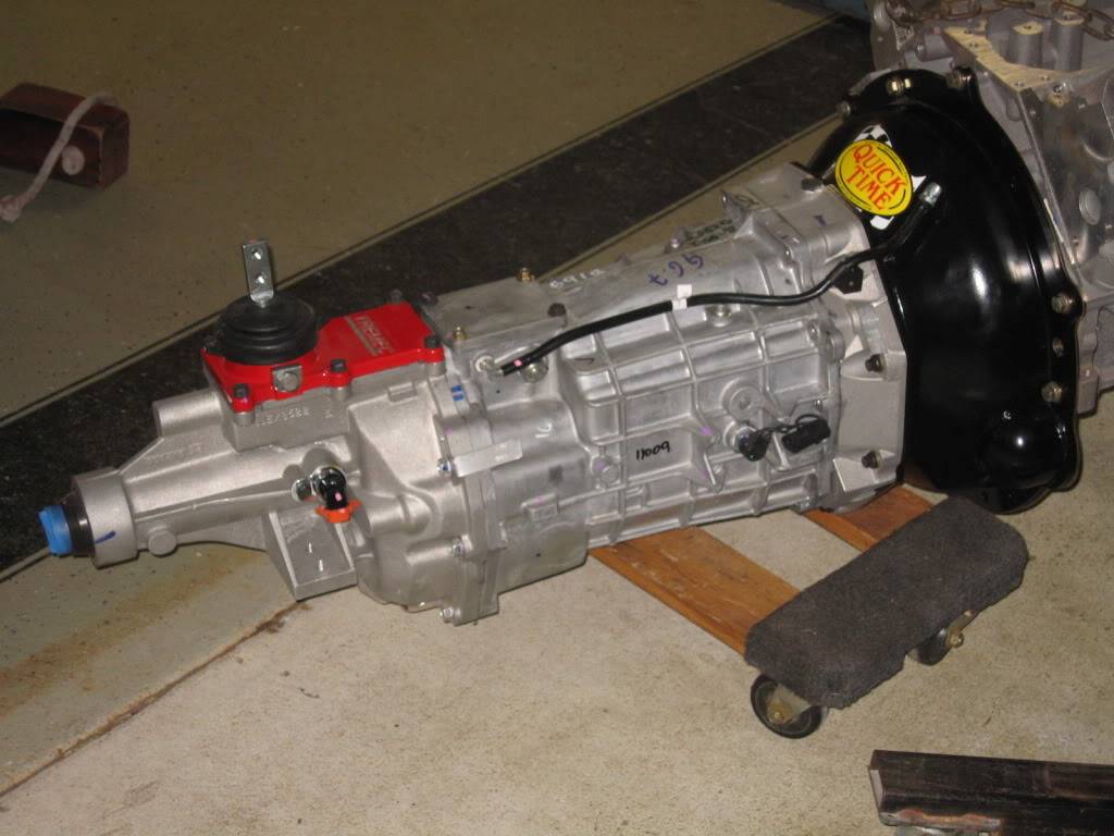

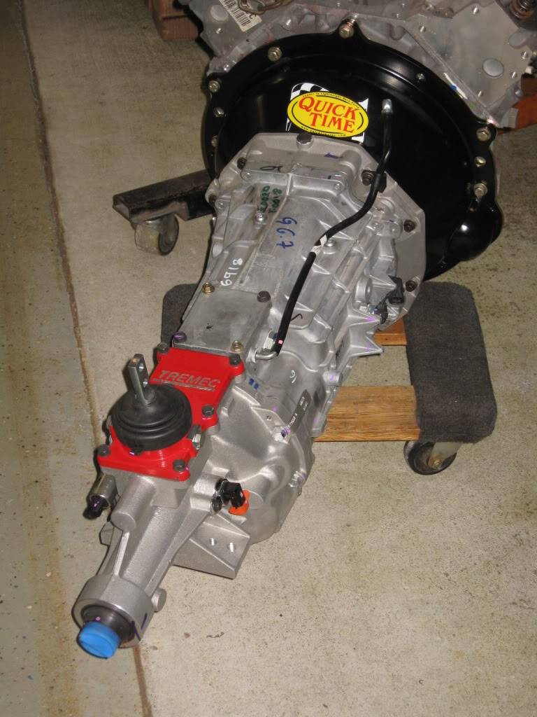

      its here!!! i pulled the motor, bolted it up and stabbed it all back in as a unit tonight. i have lots or room still left, so im pretty happy. i knew i would have to change up the mount from the tko, but the ideas that i had hoped would work, wont work. im going to try and borrow a tubing bender and see about making another crossmember. if that doesnt work, i'll cut 4 sides out of some 1/8" flat plate and make something else. i really wish i had a friggin waterjet!!!!
      the shifter also threw me for a loop. its acutally clocked/tilted about 5-10* towards the driver. i thought the tranny was sitting a little sideways somehow, but the mount and motor are flat.

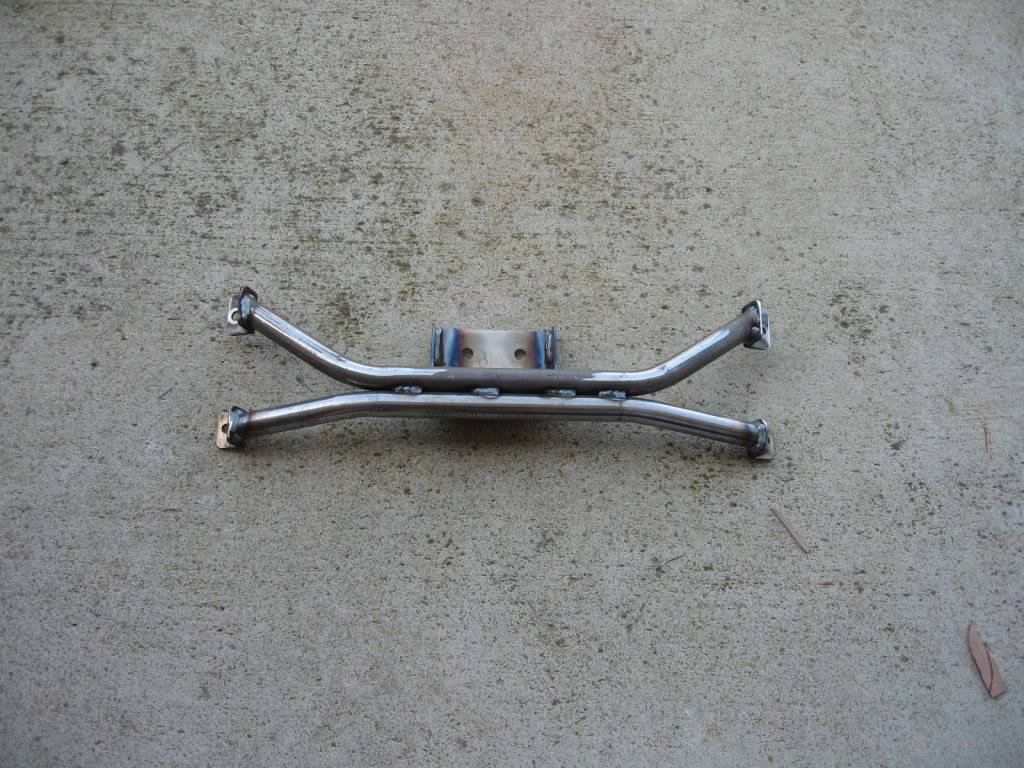

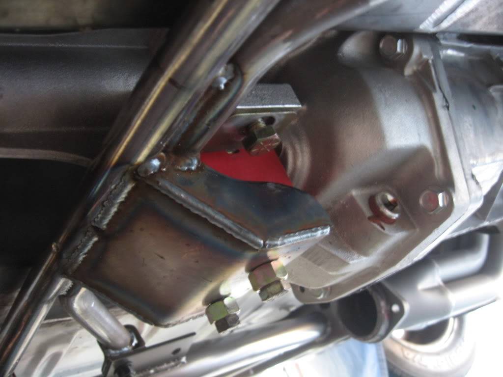

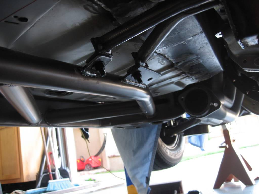

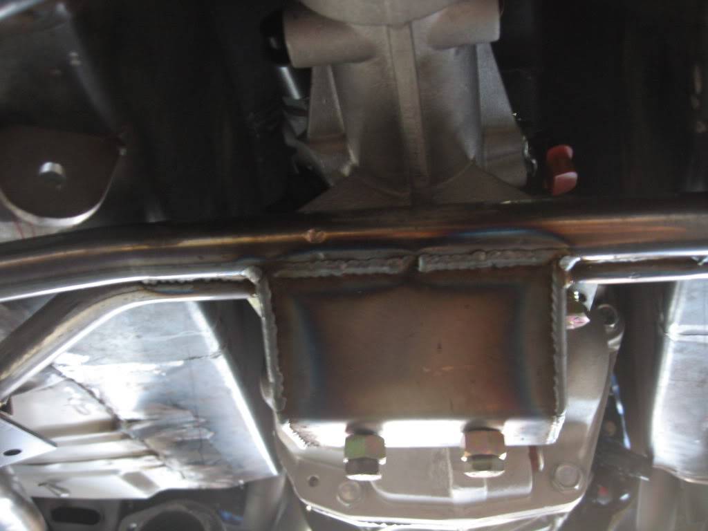

      i finally got the new trans crossmember finished. i literally spent 10 hours making the damn thing and i have another 5 pieces that didnt quite work. when i made the first, i made the cross, mounted the tabs to it, positioned it, and then tacked it in place. since the front tab was still there, i had to make these pieces fit that tab. much more difficult!
      my original idea was to use 100% of the existing tab and not have to weld to the painted frame. but, the magnum positions the mount about 4" back from where the tko was. i wasnt really comfortable building that much angle into the mount. so i had a decision to make. i could either cut off the old tab and weld in a new one, or i leave the original and weld on a much smaller tab to the rear. the first option would have messed up 4" of paint where the old tab was once it was ground off, and it would mess up 4" of paint where i would weld the new one on. the second option only messed up 1 1/4" of paint and won for that reason.
      unfortunately i knew going in that the exhaust would have to be reworked slightly. the front section is 3" tubing, but the flex joint is over 4" and is in the way. i was actually surprised that it clears when mounted back up, but i literally have 1/8th. i have to cut the flex out and reweld it back in about 3" forward.
      here are some pics.
