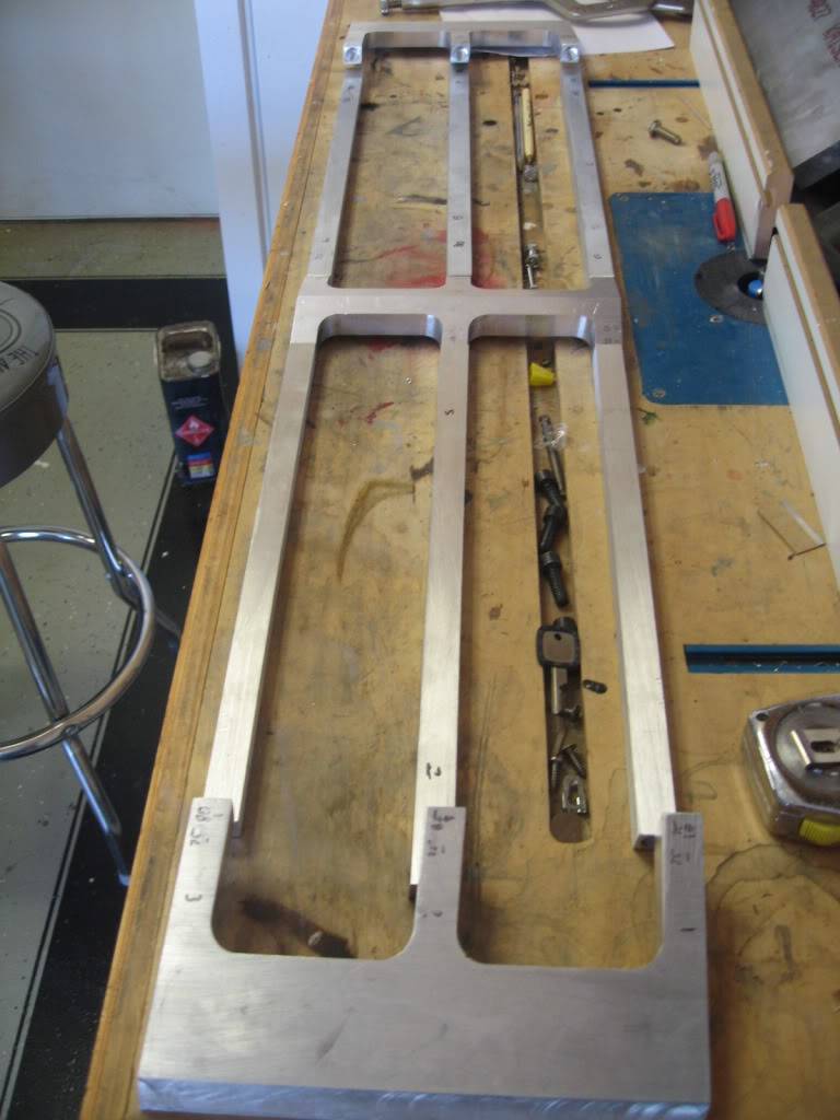

      heres a pic of the grille. i still have to cut the middle bars to length and it obviously still needs to be welded. i hope to have it done by the end of next week.

      grill looks cool but not seeing what it looks like in my head lol

      getting closer. ive only knocked to tops off the welds and i still obviously need to weld in the center bars. when its mounted only 3/4" of the solid ends will be visibile. it will give it the full perimeter that i was looking for.

      What filler rod did you use to make the welds? Some filler rod cleans up and blends in better, the type of filler that is mainly used for ornamental welds. I used it before when I used to weld aluminum hand rail.
    12. #432
      Dec 2007
      Carlsbad, Ca
      1,213
      i used 4043. it wasnt the rods, its just that i suck. the middle bars welds turned out much better. i need to keep practicing, especially on a weld longer than 3/4". its real tough to get started and stop in less than 5 seconds. i also just picked up a foot pedal for this project. i had been using the hand controls and could never get used to them. the foot pedal was MUCH better.

      still needs a lot more work, but its getting closer.....

      looking good cant wait to see it with the mesh that will set it off

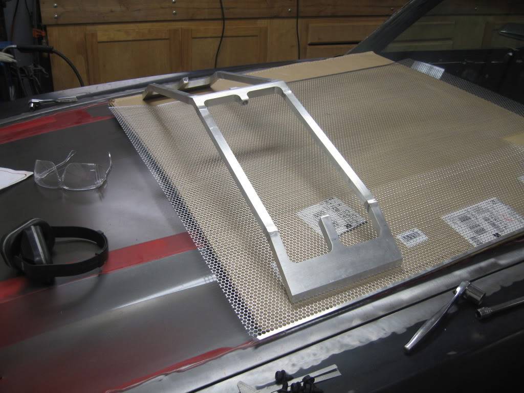

      Dumb question but, where did you get that mesh and what kind of mesh is that? - Was thinking of replacing the lower grills of the 80 firebird's nose, thanks.
