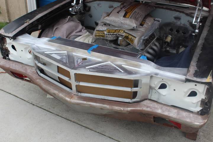

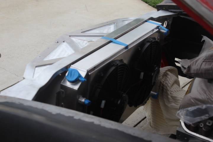

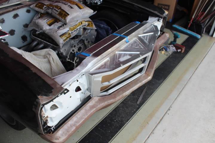

      finally got some progress done on the closeout panel. i ended up flush trimming it to the grille and started making the rest of the panel. i debated including the radiator under the panel, but left it out. i think it looks great and dont really want to hide it. i'll post some pics up tomorrow when i get a little further.
      also, i need to come up with another material for the grille. the hex mesh just isnt doing it for me. even when painted black it almost doesnt exist. ive seen some honeycomb sheets that i may use if i can find one thats ~3/16 thick. this would give the appearance of being more closed off which i think it really needs.
      still hoping to get the car in paint by the end of summer if jcg has room. its going to take some work to get it there, but it needs to get done. my plan was to build it completely with a running motor and all before tearing it back apart. since being sick set me back about 6 months i dont think thats going to happen. hopefully i dont ruin too much by doing the work after paint. im also hoping that working on the car doesnt set my health back at all.

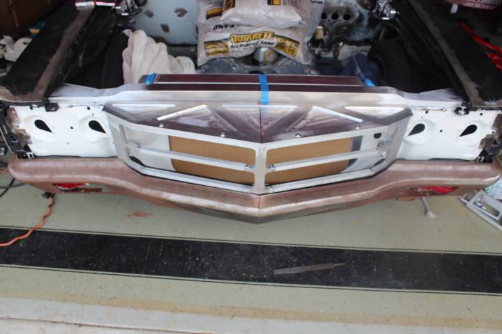

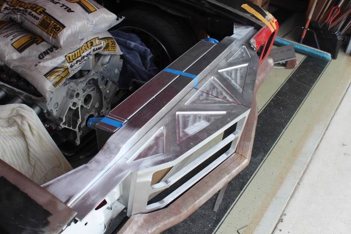

      here are a few of the pics. still not finished, but close. the main piece still needs to get extended all the way to the fenders and where the top piece flares out isnt quite done. the whole back side of the top piece rolls down 3/4" to make a nice lip in the rear, but there isnt one yet where the piece slopes down. when this piece is welded in the transition between the center and the little edge flares will get radiused.
      im not totally sold on the edges flaring out by the fenders. its small enough that they dont really distract you, but not large enough to appear to do anything. the real reason was so that i didnt have to cut the support on the drivers side fender. if i end up hating them the piece will just run straight across and ill modify the fender.

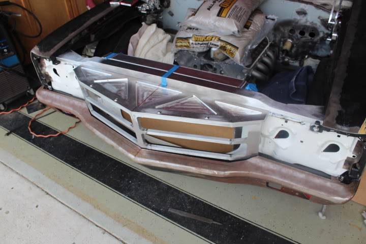

      just a little update for today. i ended up getting the ends of the bottom piece welded on and smoothed out. now i just need to finish the back lip, weld the two pieces together and figure out how im going to mount the latch. its going to use the stock piece with some mods. more pics to come.

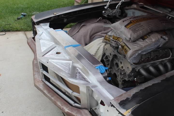

      here are the latest pics. its now one piece and the back lip is complete. i will work on the latch later this week and still need to add 2 more bolts into the grille and the bolts on the end of the closeout to the fender. the radiator is still just sitting on the metal, so it will come up ~1/4" to make it the same level as the closeout.
      i also plan to call steve at RED about sleeving a block. still hunting for a gen IV aluminum 5.3 block that i can use. ive been convinced that theres no reason to pay for an ls2 or 3 only to sleeve it. im also going to start calling around again for some builders. im actually hoping i can find someone local instead of trying to play phone tag with texas just trying to get a quote.
