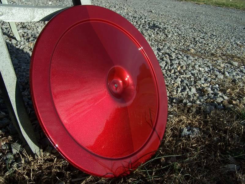

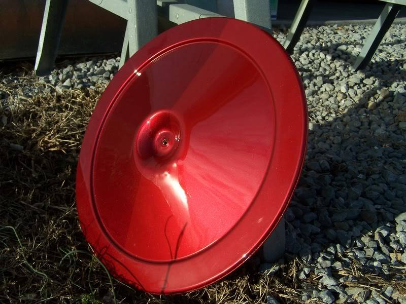

      Well its not rainning and the sun is out so took a few pictures of the test panel.

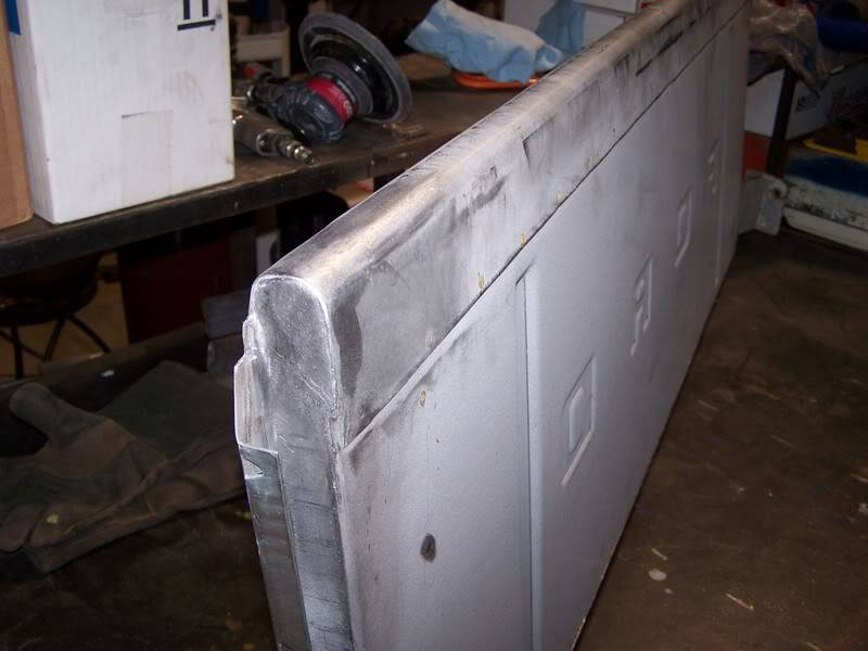

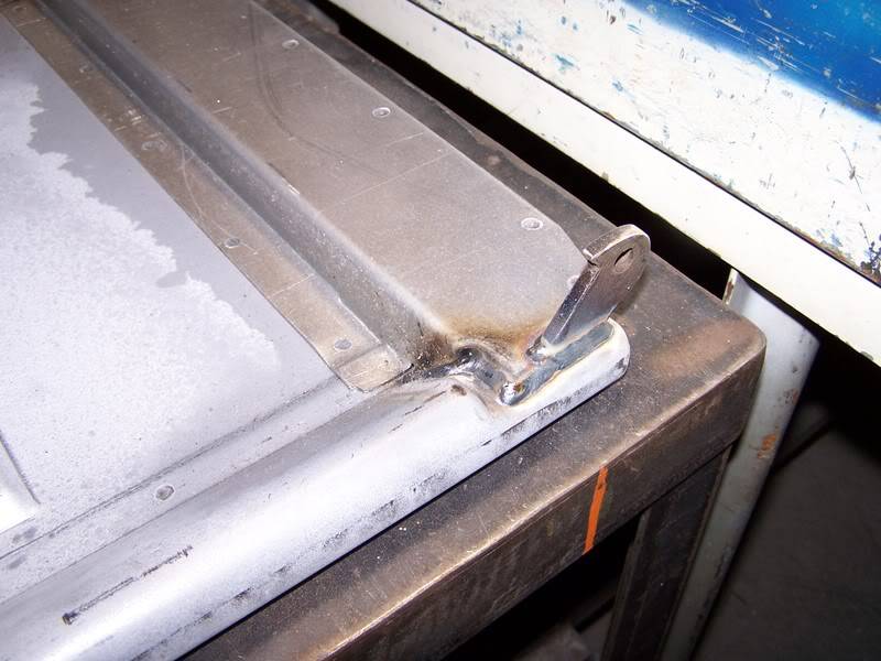

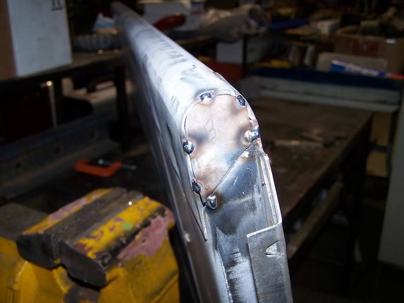

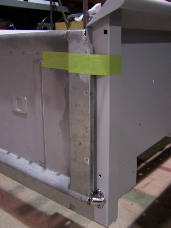

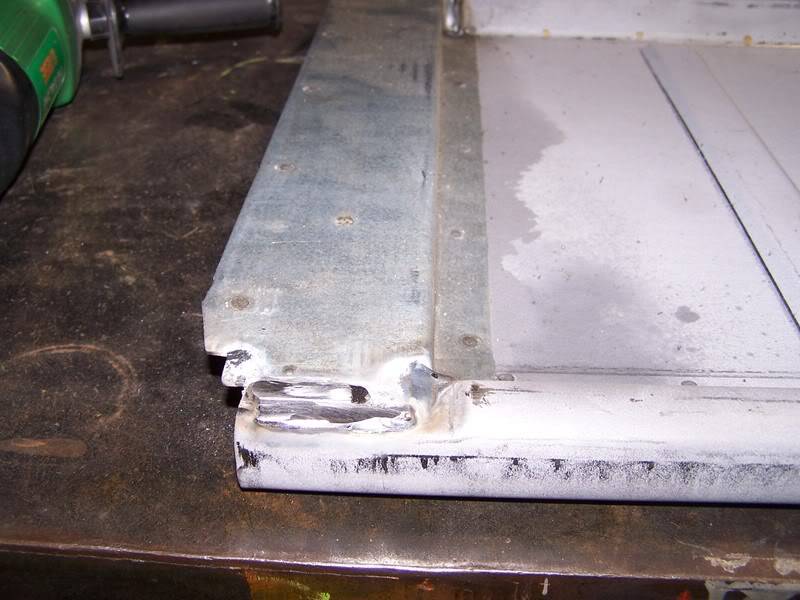

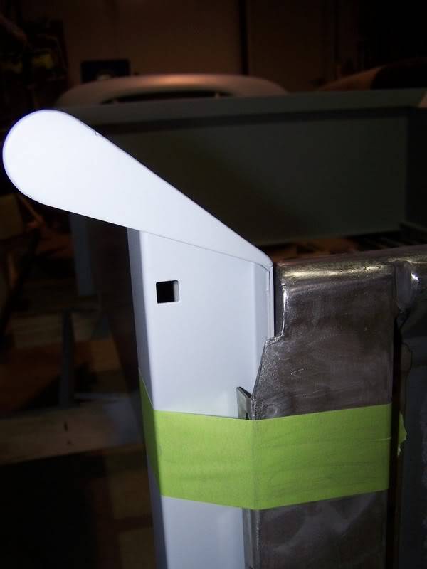

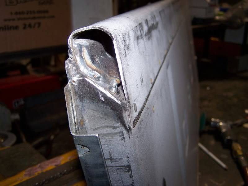

      I worked on getting the tailgate a little smoother. I took the old stock ears off were the chains hook so I can install hinden latches inside the bed.
      I also made some cap's for the sides of the tailgate so It would not have that stock hole in the side. I dont think most people will notice but better then that ugly old hole.

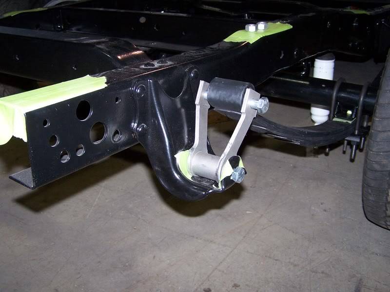

      I also reworked some new shakles for the rear springs.

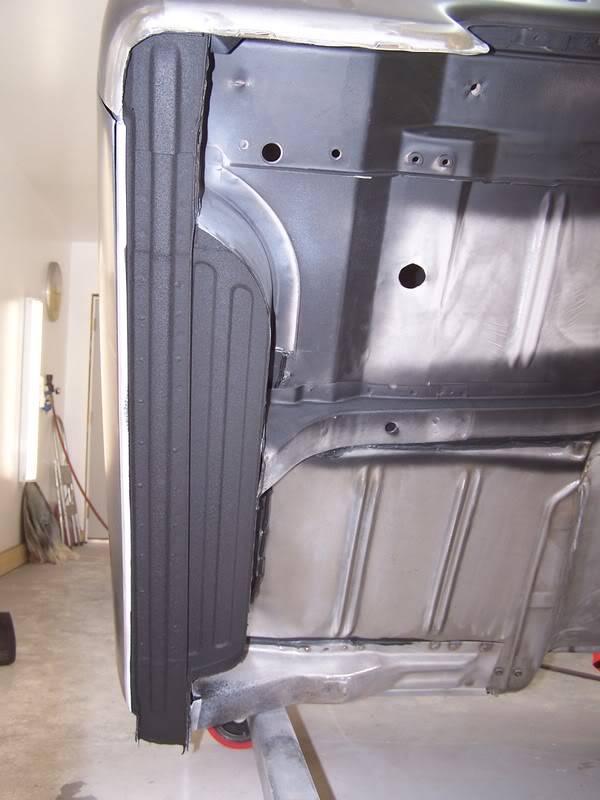

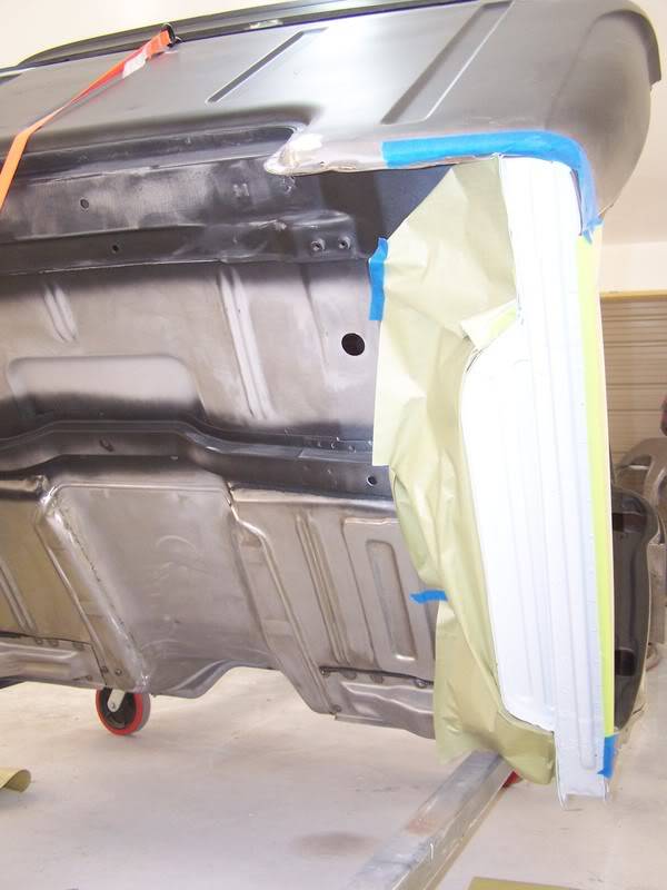

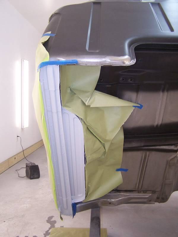

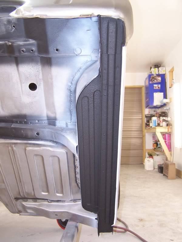

      Well today I was able to get under the steps primed and under coated. I used the stuff by 3M and it cam out really well and its very easy to spray. Now I can finish working around the trans area and then spray it.

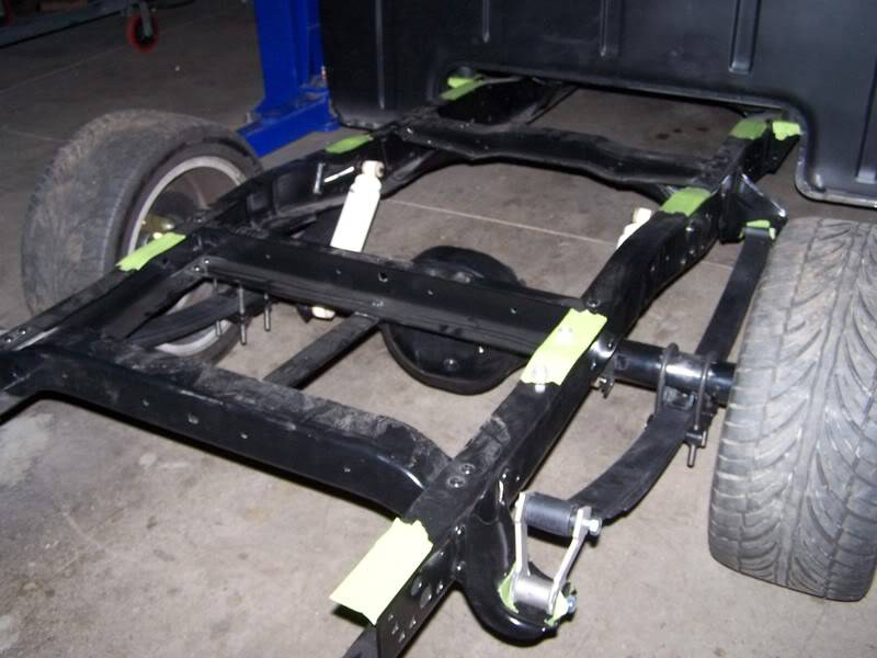

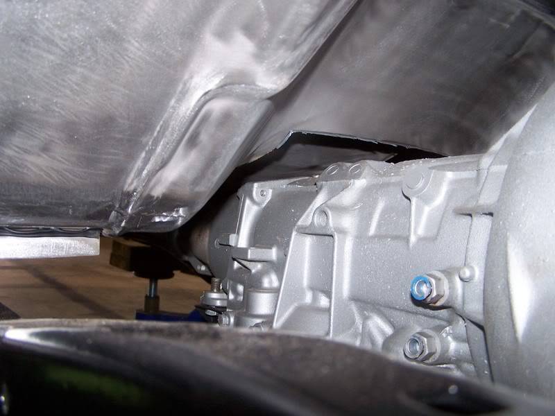

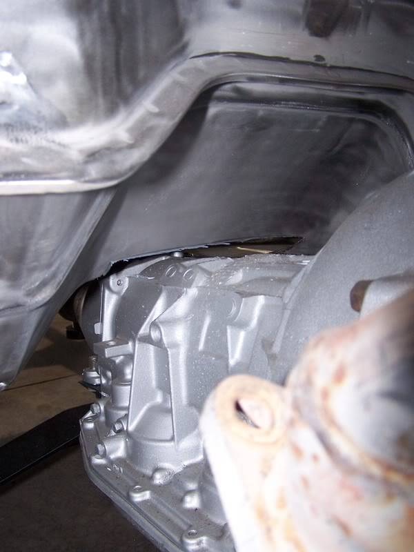

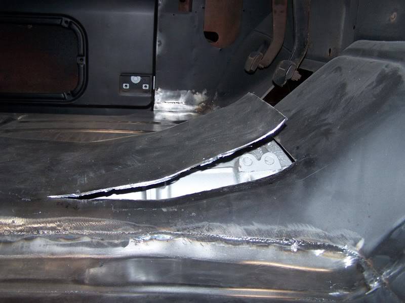

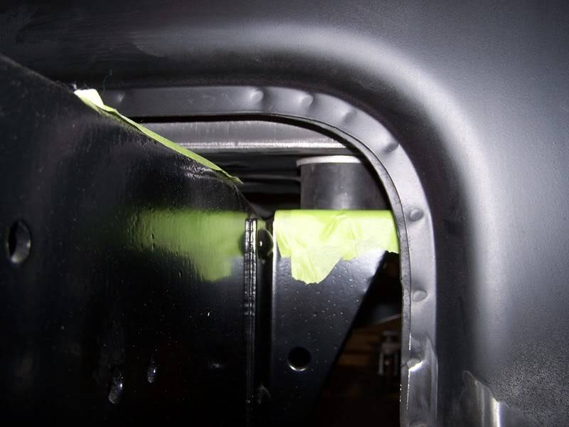

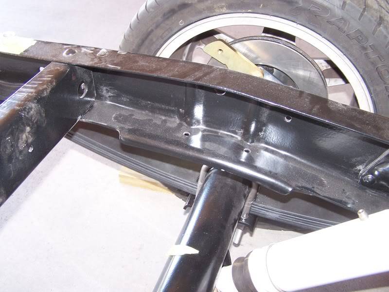

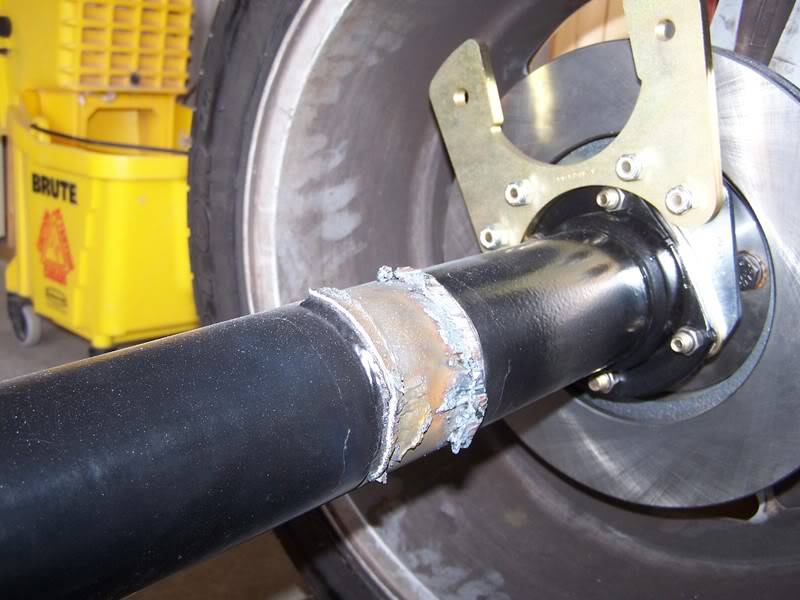

      New body bushing's came in today. I was able to set the cab down and see how much I would have to cut the floor for the trans. There will be a custom console in the middle so nothing hurt here. You can see by the pictures I like to keep everything tucked up for more ground clearance.

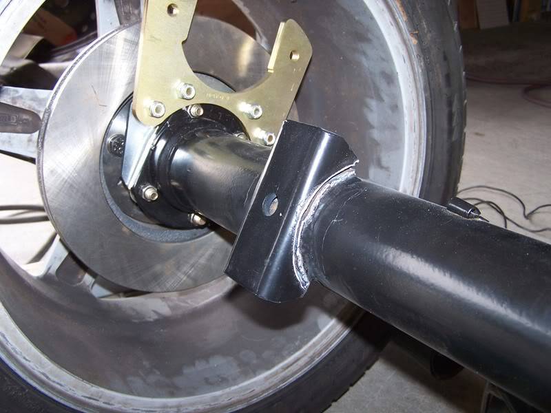

      Next thing was to get the rear end setup. I want the back down a little more so I cut off the perches and put them on the bottom(flipped axle). Ill have to go back and C-notch the rear and box it in but thats ok. Only thing left is to set the angle and get some nice shocks and get the gas tank here.

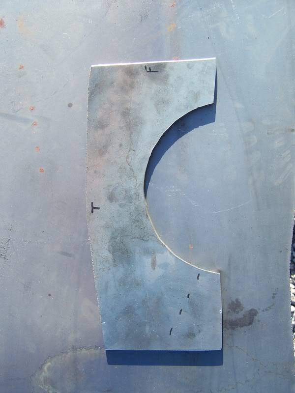

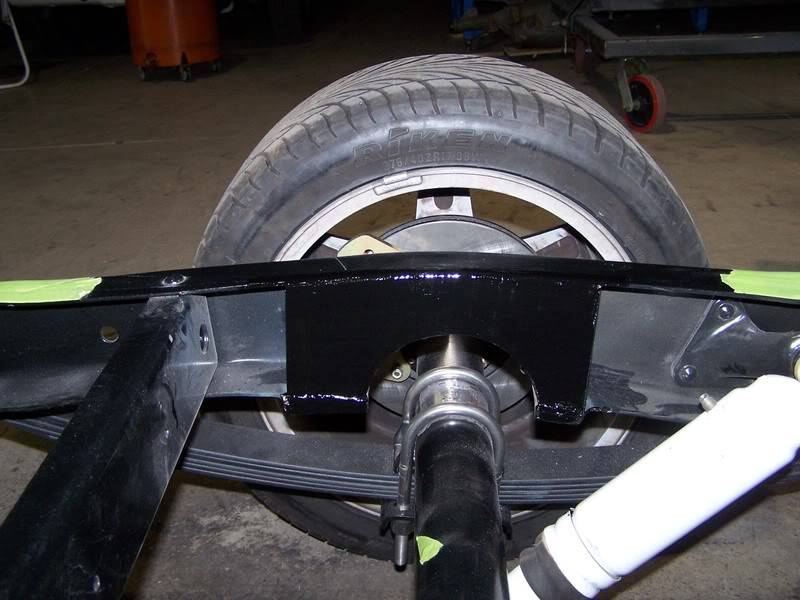

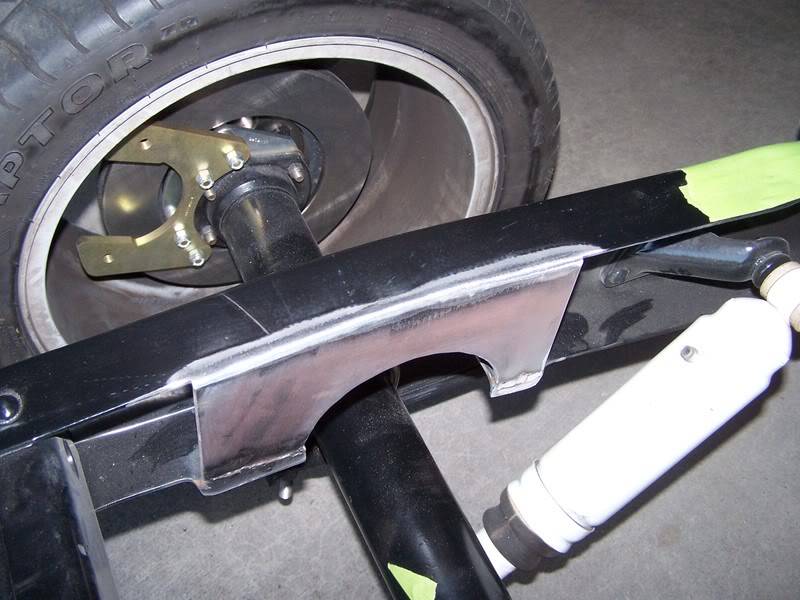

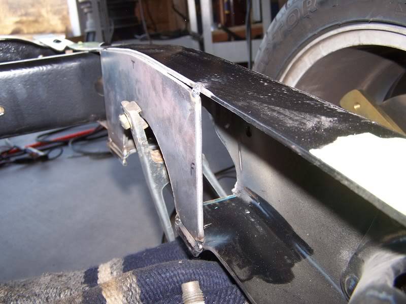

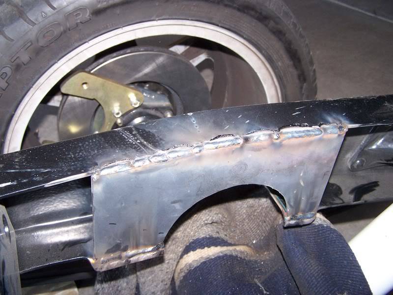

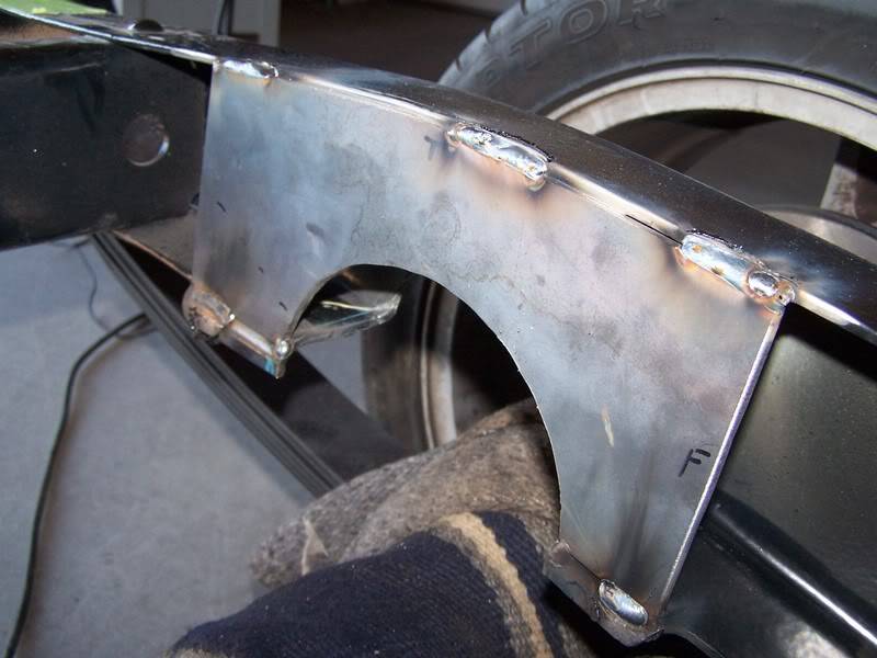

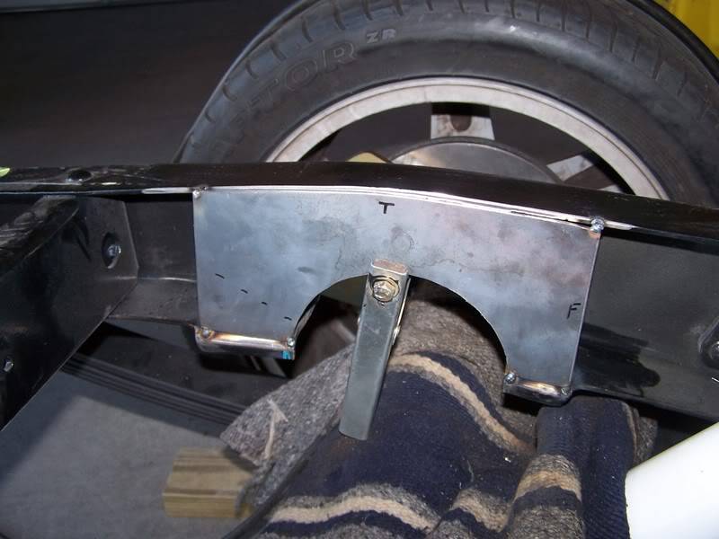

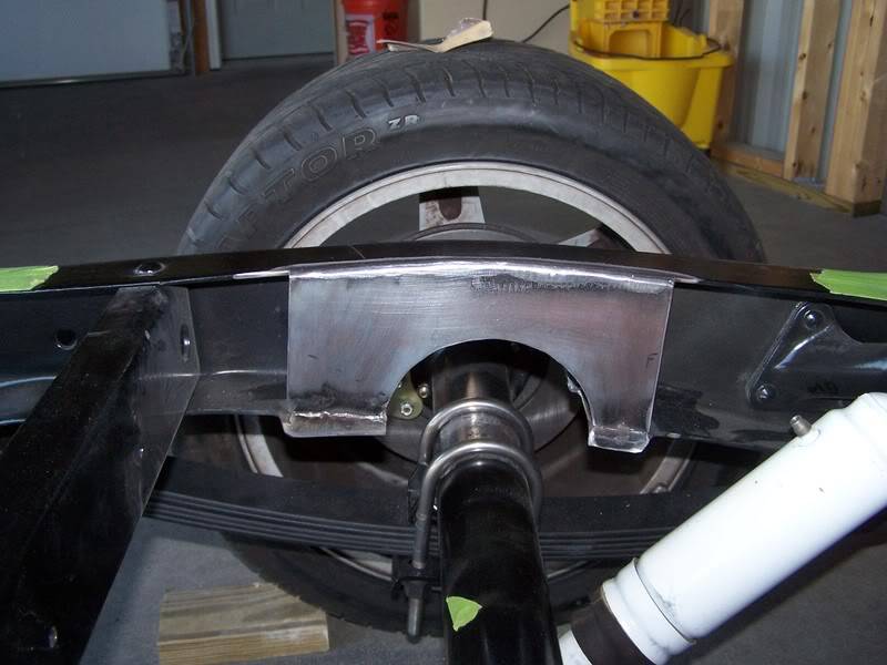

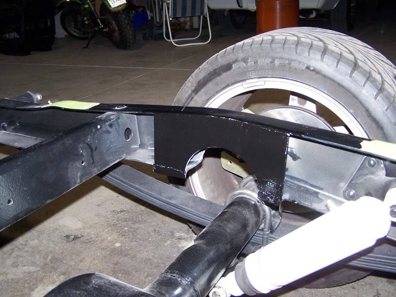

      Made a little progress today on the rear. I made some boxing plates & C-notch's.

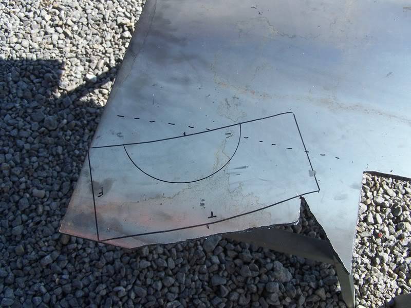

      BEFOR:
      Cutting out my boxing plates.
      Welding and grinding down.
      I tried not to grind back to much because the frame is powder coated and Im going to have to spot back in.
      AND AFTER ALL IS SAID AND DONE:

      Quote Originally Posted by bigboy View Post
      looking good are those stock springs and stuff
      Yes, and it had 3 smaller ones that were helper or load springs that were not needed.
    19. #99
      Dallas TX
      1,633
      Personally I would go a step more and box in the radiused part that the axle goes up in to. Not much more work and will make it 10x stronger there.
    20. #100
      Tennessee
      499
      Quote Originally Posted by gearheads78 View Post
      It will be, I didnt have time to put the C's in that I made. I'll be installing them and finishing the passanger side tomorrow. Come on now give me a little bit more credit then that....lollol
