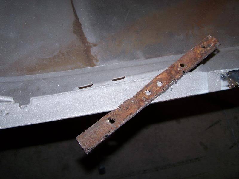

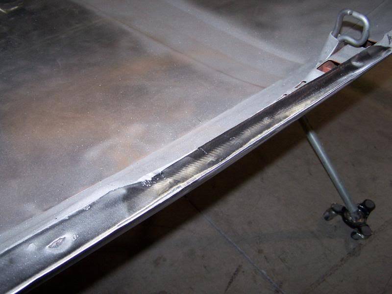

      Got the rust cut out of the hood today and new patch's put in. should be able to get the hood primed and back on the truck for one last fit. After that the cab comes off and will not be back on untill paint .

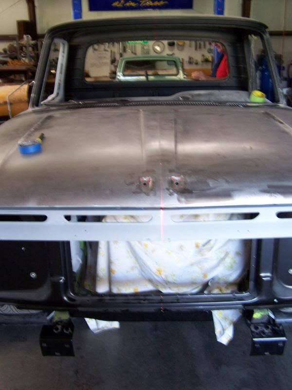

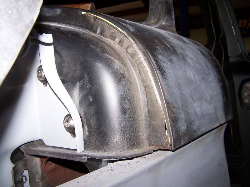

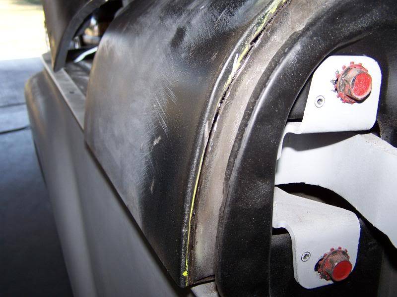

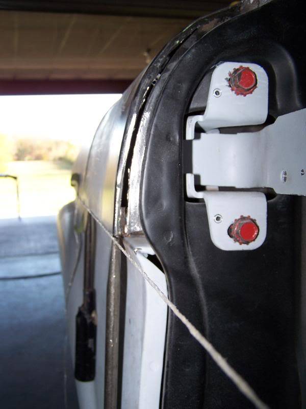

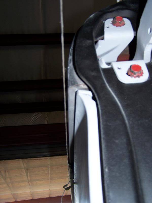

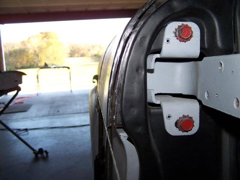

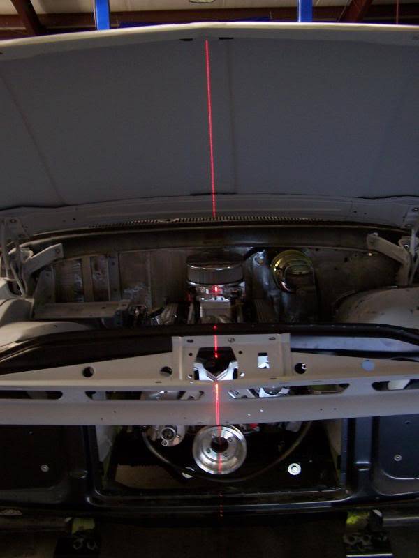

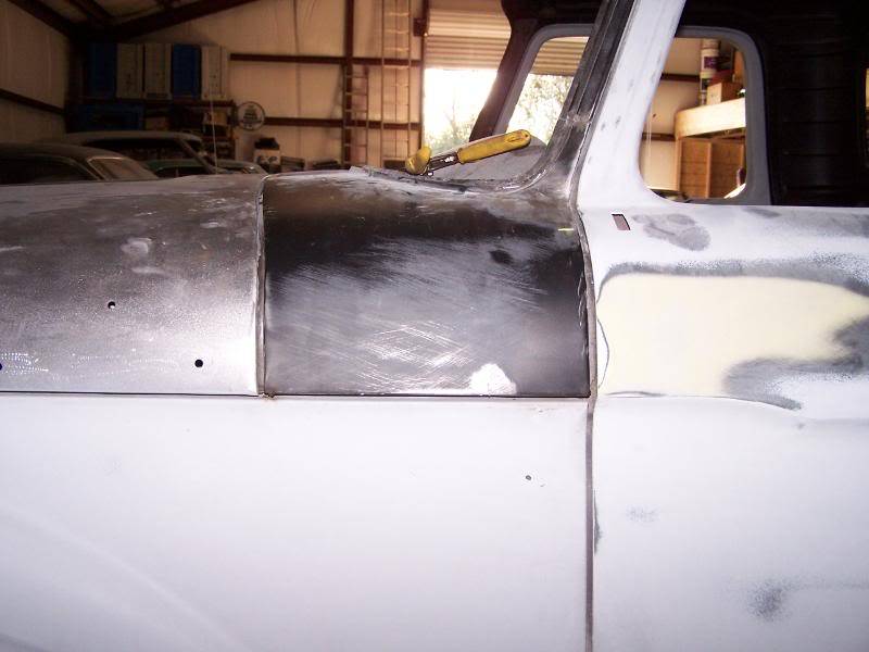

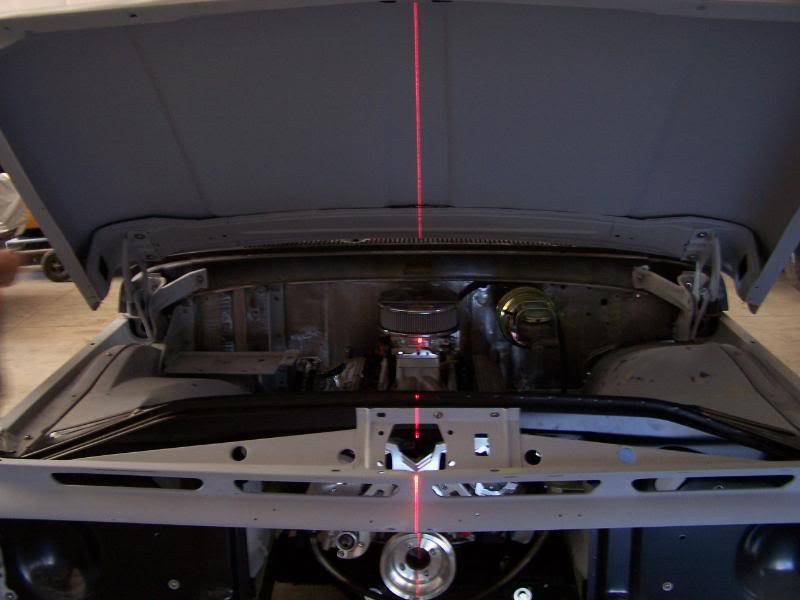

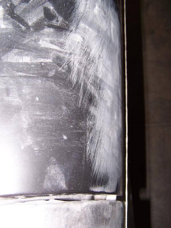

      Hood went back on for the last time I hope. I set the hood on center with the laser then adjusted everything else one more time before teardown. Only problem I had was with the driver side cowl too far in. The hood, door and rear cab corner lined up great so I cut the cowl and moved it out. Now it lines up great and ready to come apart.
      GETTING HOOD ON CENTER.
      1/4 GAP AT COWL AND HOOD (BEFORE)
      AFTER CUT.

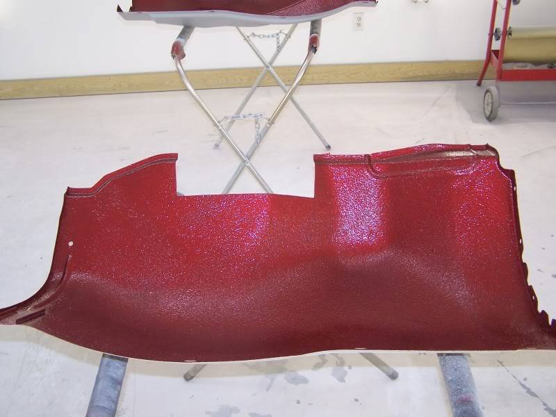

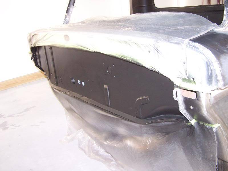

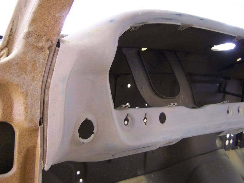

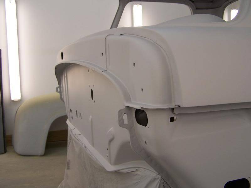

      Thanks Motown, I put the firewall in DP90 tonight. All my holes are drilled and ready to go. After its painted I shouldnt need to drill anything. Paint is getting close.
      OLD FIRE WALL
      NEW FIRE WALL

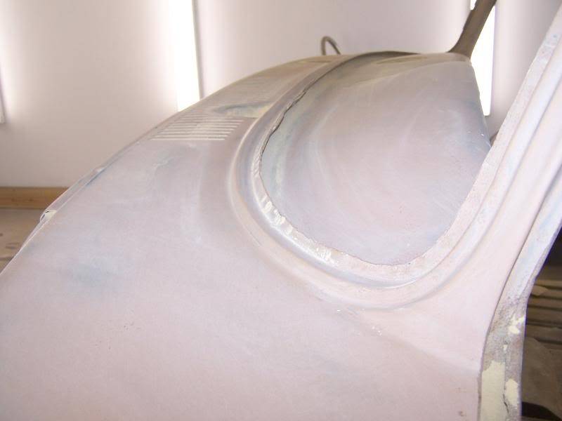

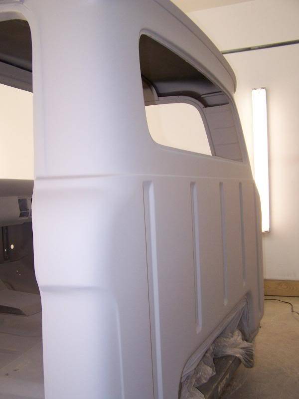

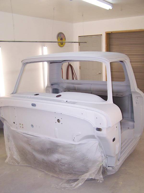

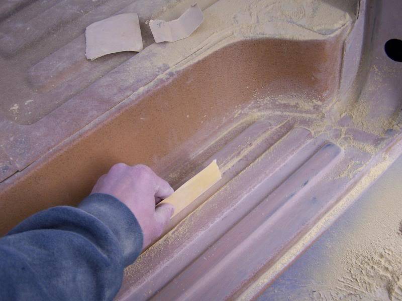

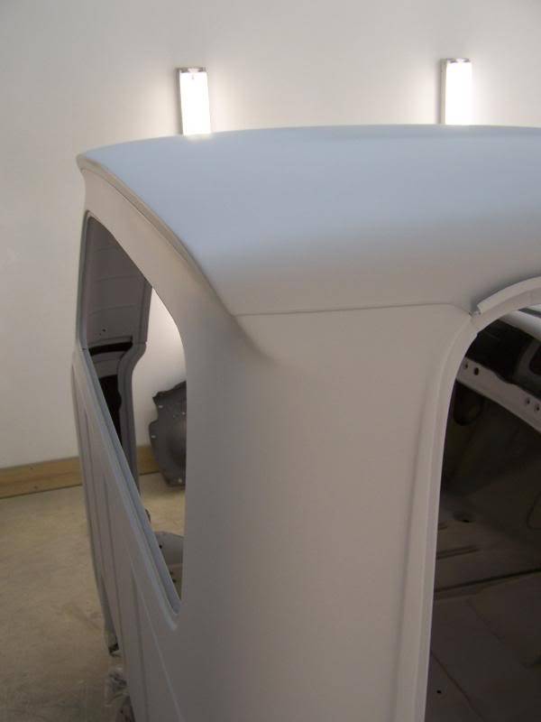

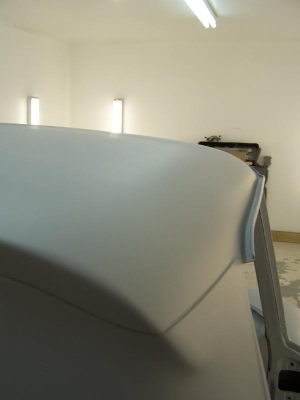

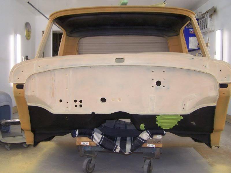

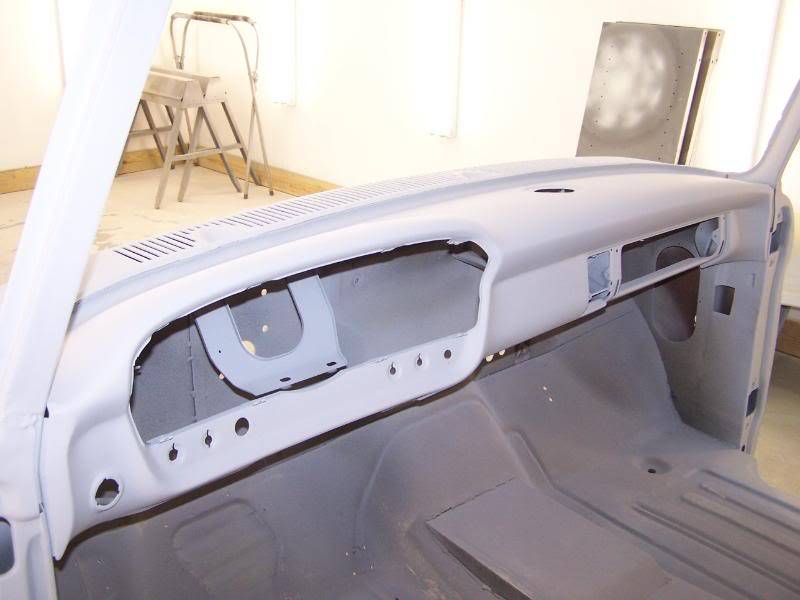

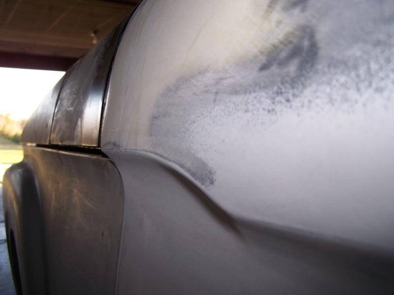

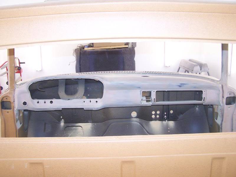

      Thanks guys Ive been holding off on pictures but the wet sanding is almost done. This is all you get to see for now...lol
      I hate sanding down here.
      Ready for last prime and wetsanding.

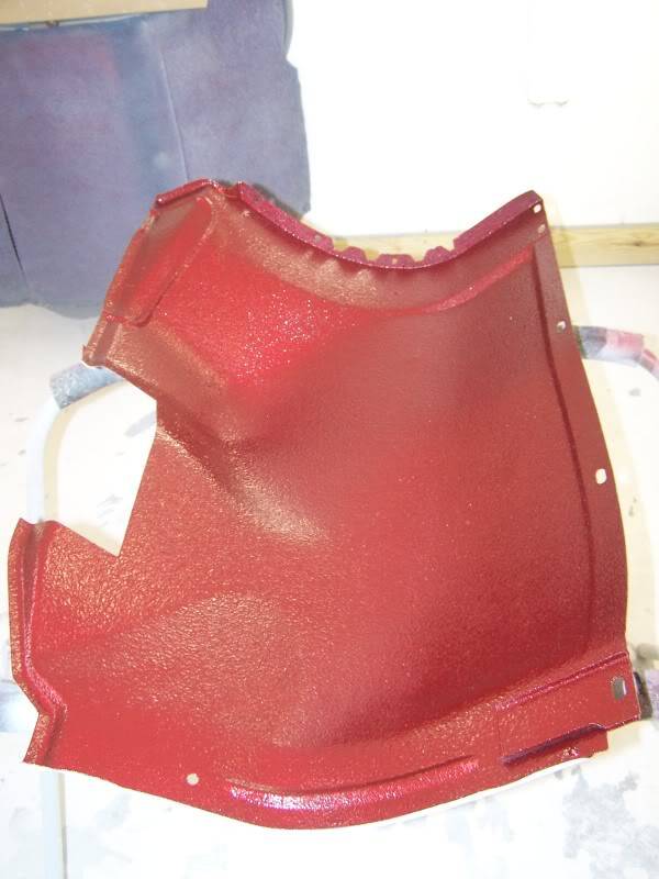

      Just a small sneak peak!! O yea this is the color mixed with under-coating under the front innder fenders, you get the ideal.

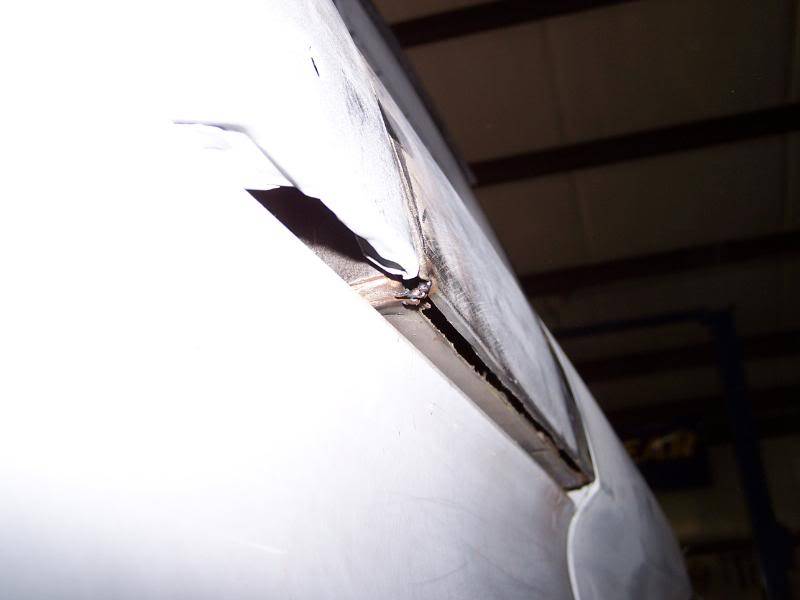

      Is there any reason you didn't shave the drip rails or fill the cab seams at the roof line? It would seem like a given with the amount of work you are putting into this.

      Customer did not want anything shaved but the big emblem on the hood and the two on the sides. The truck belongs to a woman and like most, "knows what she wants."...lol.
