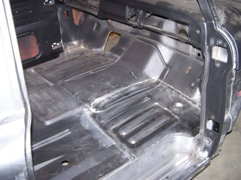

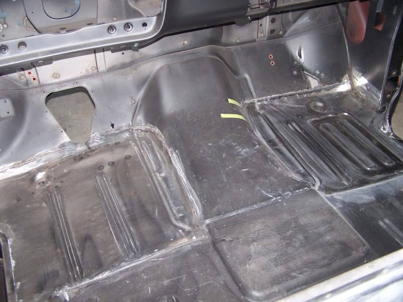

      Thanks!! Few of the Floor pans, Little more welding and Ill be done with them.

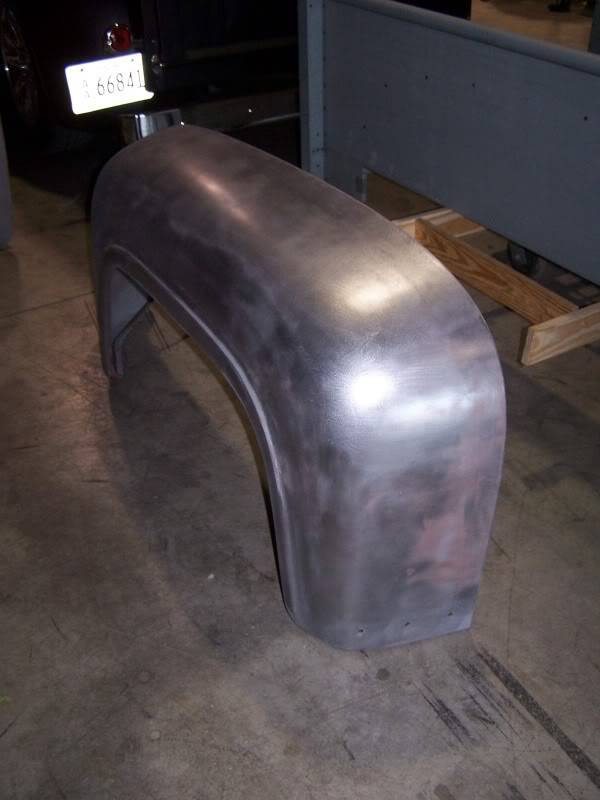

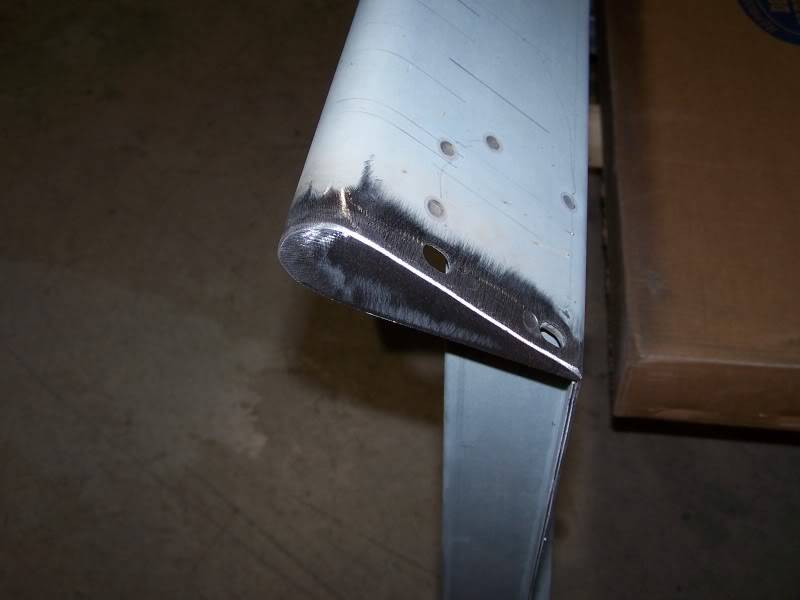

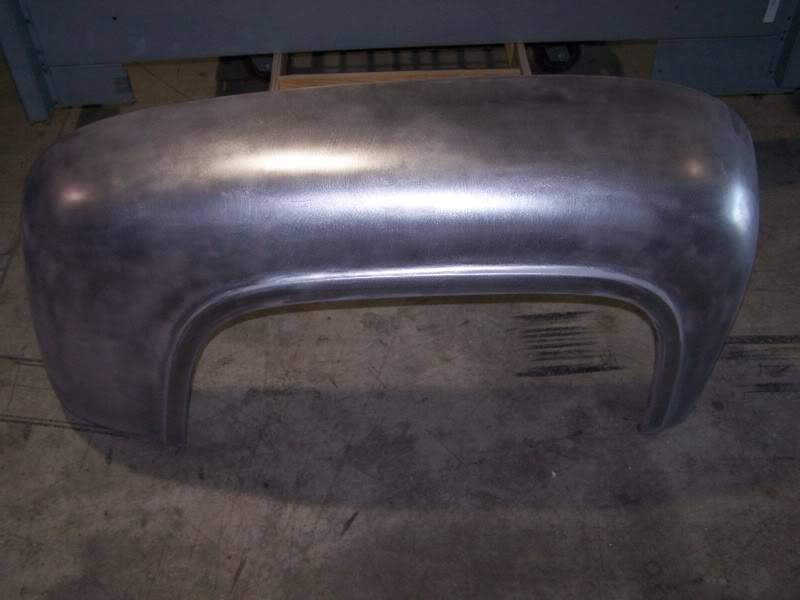

      Today was a slow day, I had some stuff that needed to be sandblasted for other cars so I did the rear fenders for the tuck today. The fenders are in really good shape, just had a few dent from rocks coming up and hitting them. Hope to get them in primer tomorrow.

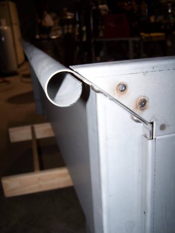

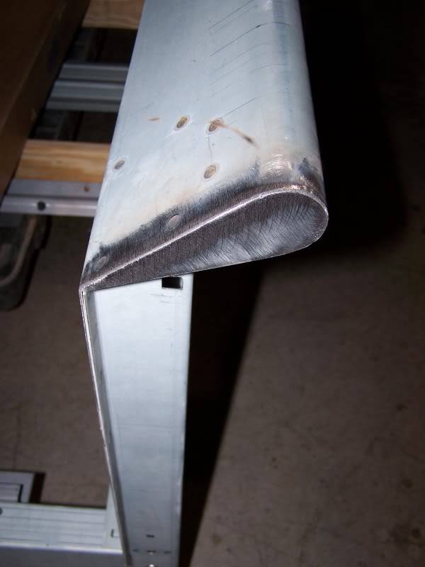

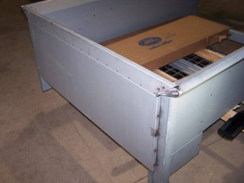

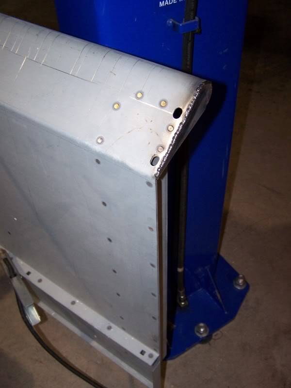

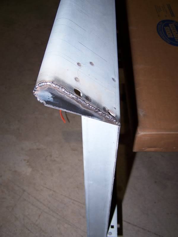

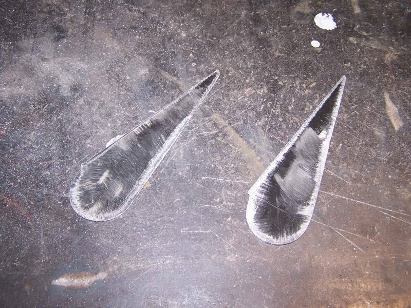

      Now that the site is back up I can post a little update. Almost got the new paintbooth finished. So now Ive been working on the new bed by installing teardrops on the front and back sides of the bed. To me it really cleans the bed up. I also finish welding the back panel on, so now it time to sand and prime the bed. I have also been metal working the fenders and getting them in DP90.
      Bed sides before teardrops.
      Home made.
      Ready for grinding.
      Hope to have more later.

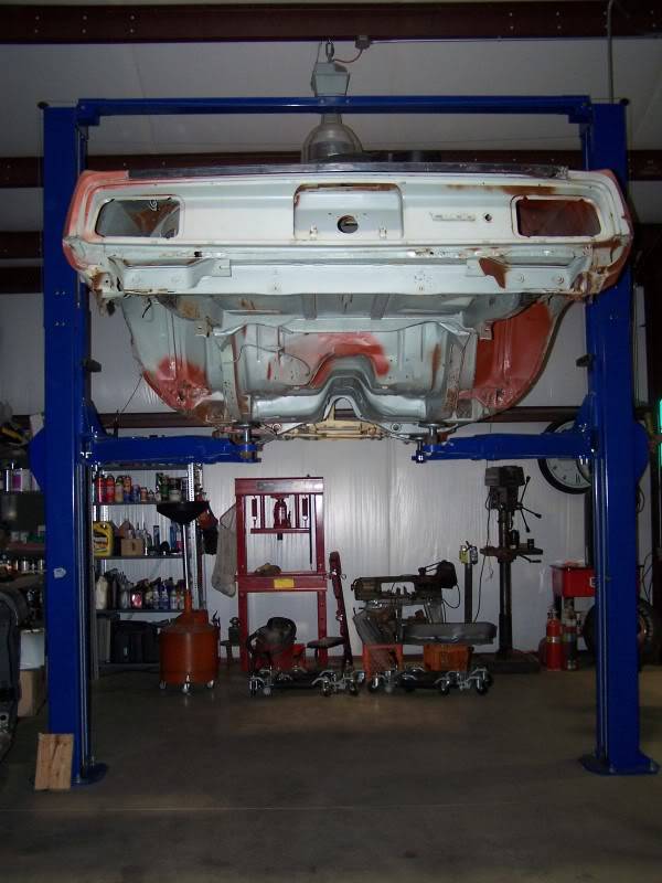

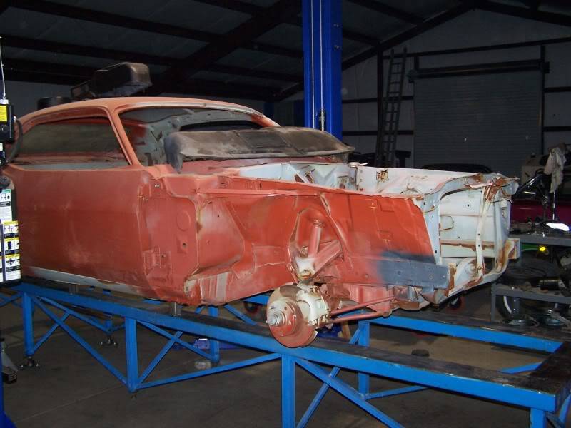

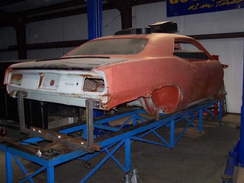

      Thanks guys, I was hoping to get a lot done on the truck today but had to move the cuda onto the table today. This project is one of mine but it will have to waite. Here are a few picture for you guys.

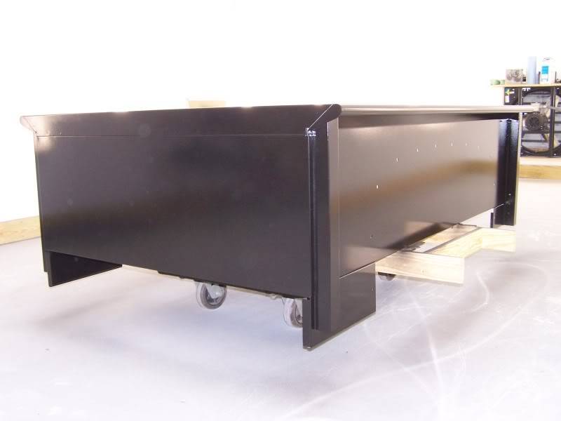

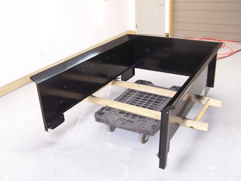

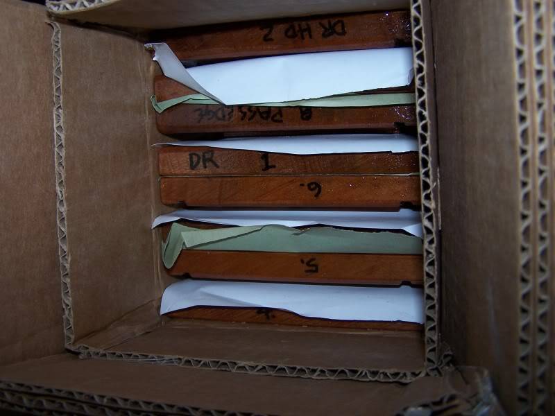

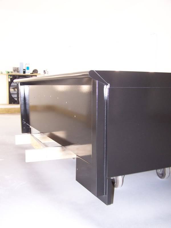

      Little update, got the rear fenders and bed put in DP90 today. Heres a little shot of the wood for the bed. The color has come down to a red so as soon as my customer makes his mind up Ill post it.

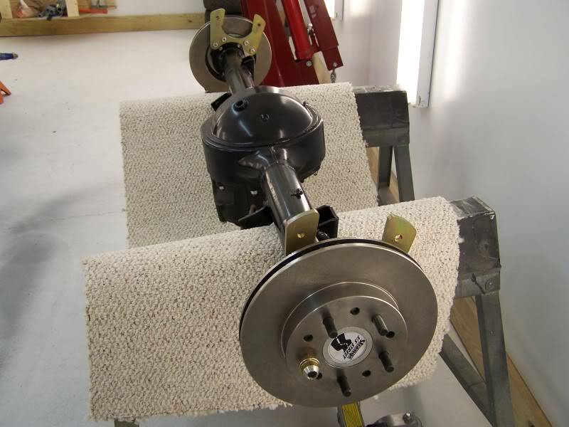

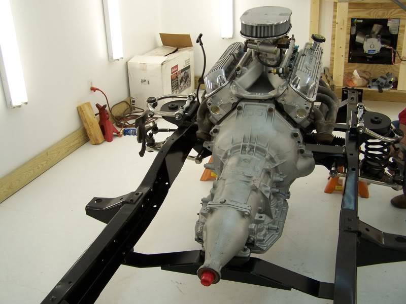

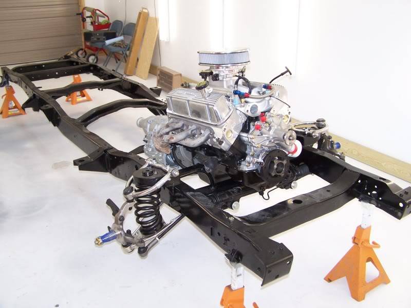

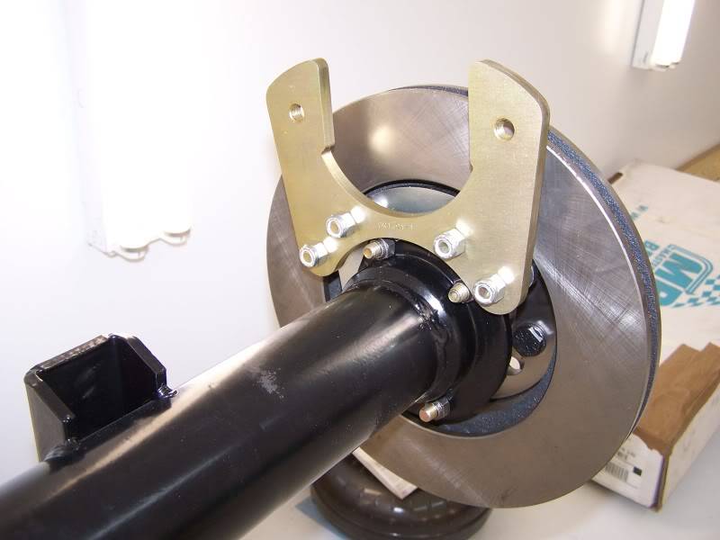

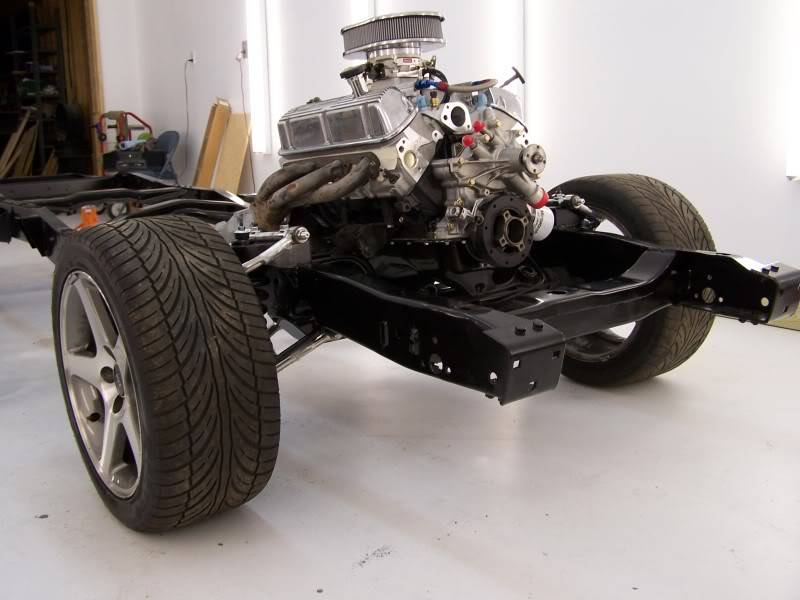

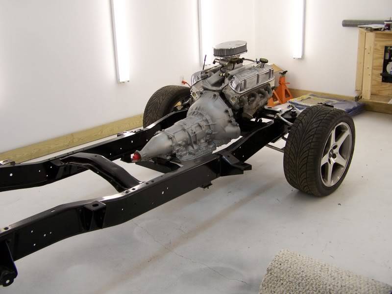

      Well I got the frame set up at the shop today. Got the motor and trans centered. Trans is a TCI AOD by the way. Started putting the coils on. Got the rear end set up with MP master brakes and Strange Axle's.

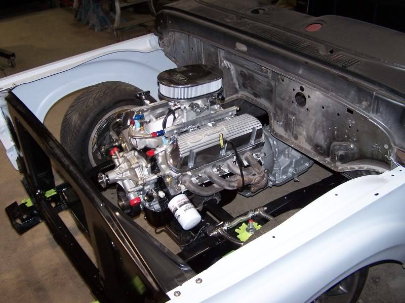

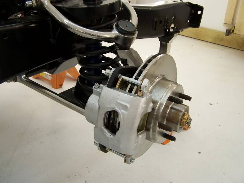

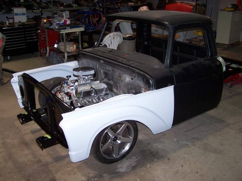

      Thanks guys. Ive got too many toys, Im not sure Ill ever get to them all. Slow day today, finished painting the brakes and putting some wheels and tires on jut to see how it looked in the front. Not sure what wheels and tires yet untill I get the body mocked up.

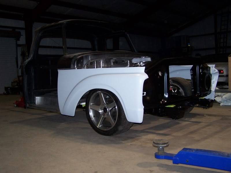

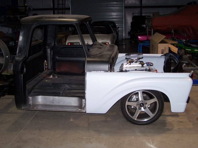

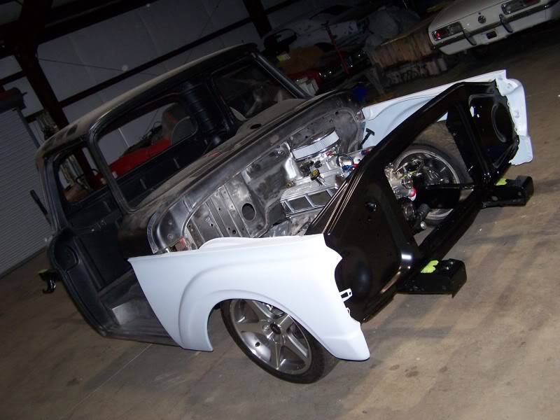

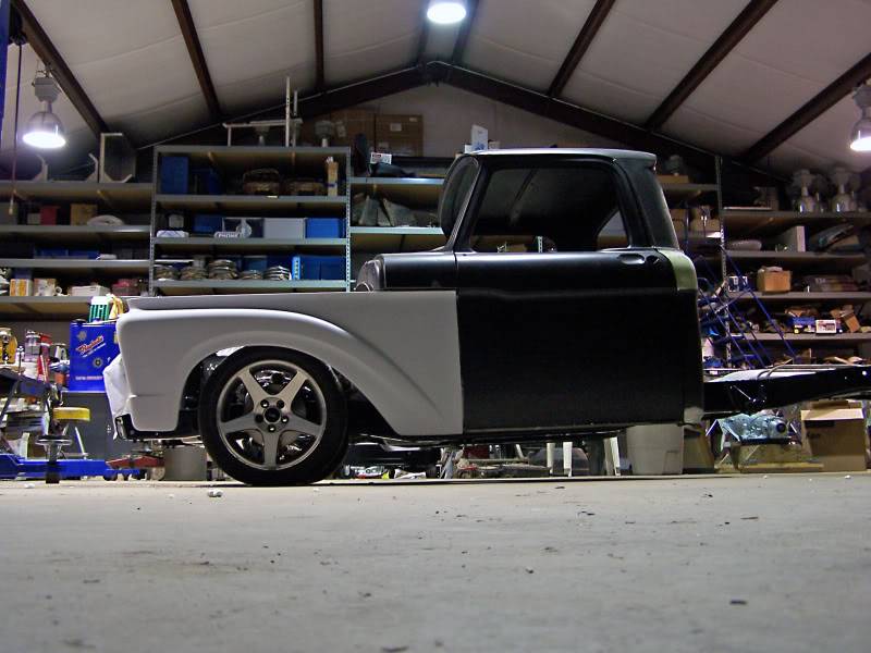

      Set the cab down on the frame today and set the fenders on just to see how she's going to look. Ive still got to set the rear end up but parts are slow coming in. O and this is not the wheels were using just mock up wheels.
      Maybe the color, dont know yet.
