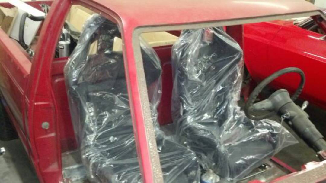

      Cobra Suzuka (wide version) seats arrived. Custom ordered in black vinyl and without logo.
      Installed with Planted aluminum side brackets and Cobra sliders. The planted side brackets were much cheaper than the competition and look to provide a great range of adjustability. The sliders needed an extra hole drilled into them and the grab handle was too narrow, so Randy bent up a piece of 4130 to replace the grab handle.

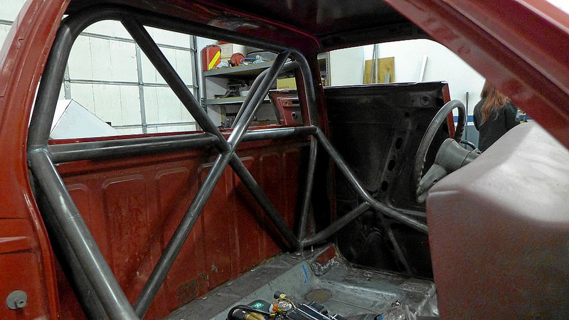

      From the factory, the cab is mounted on rubber bushings that support sheet metal standoff boxes welded to the underside of the cab floor. Unfortunately, the rubber bushings are exactly where the landing points of the roll bar main hoop and door bars should be.
      In order to weld in a roll bar that can bolt to the frame, those standoff boxes were cut off so the cab floor is flat in that area (but still multiple layers of sheet metal). A plate is welded to the top side of the floor with perimeter bolt holes. New cab mounts were welded to the frame with matching plates so that the cab may be bolted to the new mounts. The roll bar will then be welded to the plates on the top side of the cab floor.
      Rear cab mount:
      Front cab mount:
      Roll bar:

      Cobra Suzuka seats (black vinyl) mounted on sliders:
      Door bars have enough room so that they don't get in the way of elbows:

      Roll bar finished:

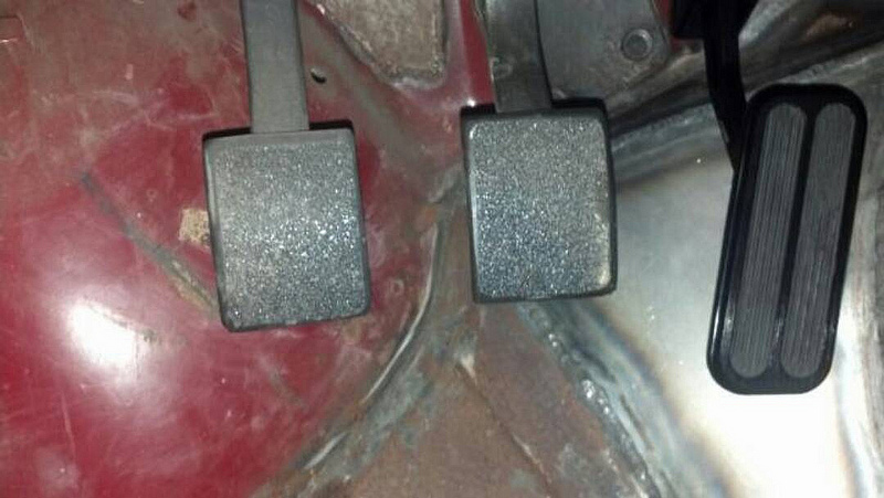

      Throttle pedal mounted:

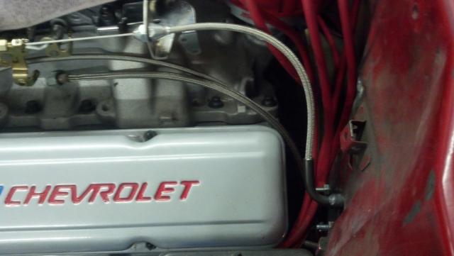

      Throttle cable:

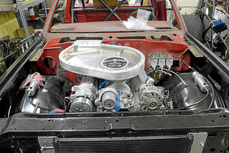

      Air conditioning compressor and clearanced valve cover:

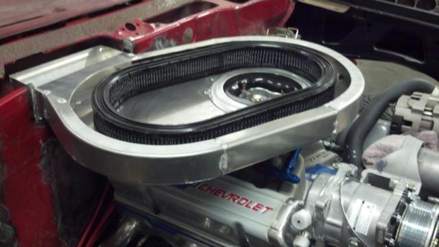

      Cowl air box and air flow director carb insert:

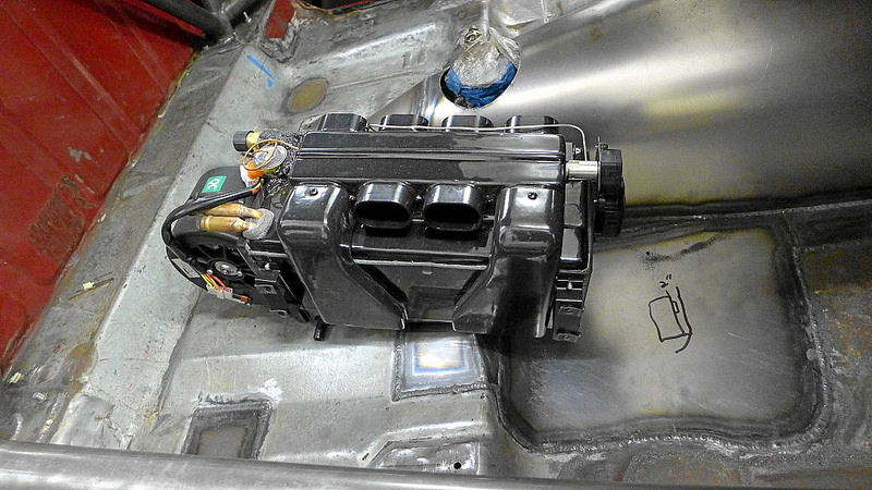

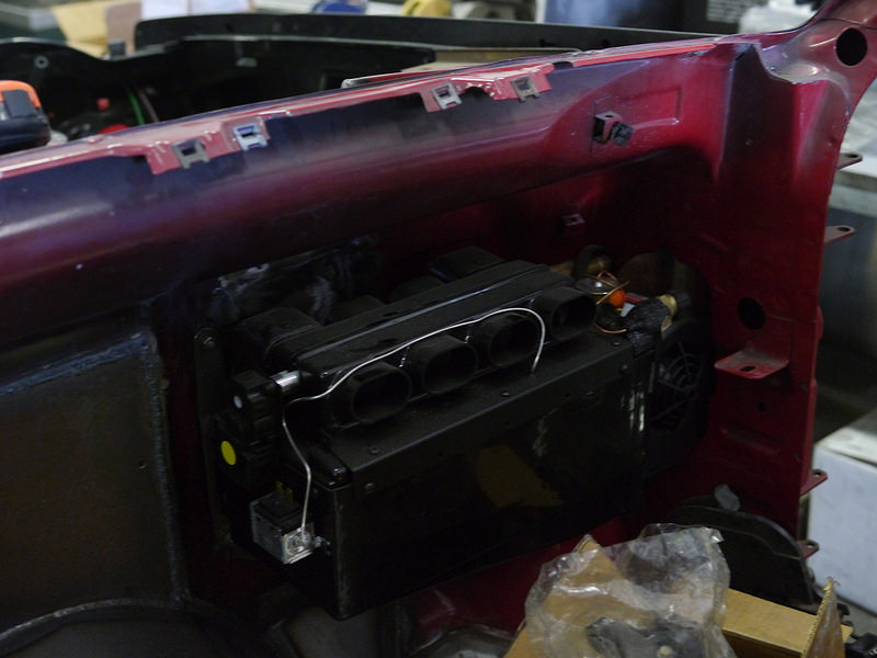

      Air conditioning compressor to be mounted behind glove box:

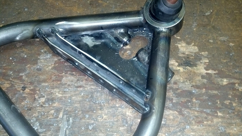

      Sway bar arm:
      Lower a-arm gusseted and with sway bar tabs adjustable for rate.

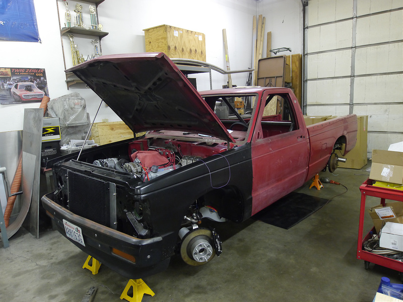

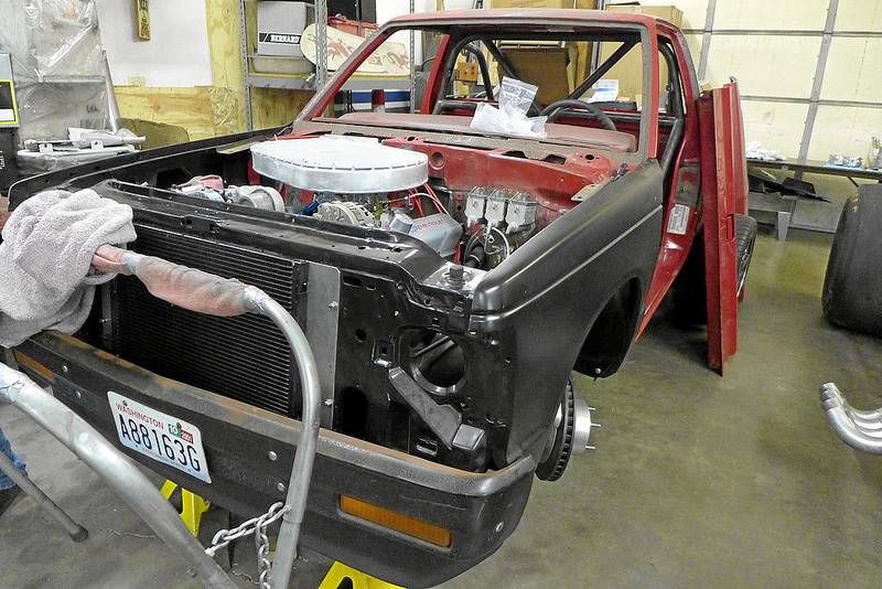

      Core support and fenders mocked up
      You can see a peek of the new carbon fiber driveshaft here
      Roll pan mounted
      Cowl air pan version 2 (first version was a bit too thin and warped after welding). It will be covered on top with a clear lexan sheet.
      Shot of the front suspension with the inner fenders installed. The brake cooling duct will likely not work, so Randy is looking for another solution that clears the tires at all steering angles and suspension travel.

      Where is that swaybar arm from?
      The part that has the adjustable holes in it - and the splined end and the pinch bolt in it.
      The Pfadt arms on my setup are taking a dump (cant replace them as they are out of business) - and that is a very similar design there...

      Nice project I like the air box.

      They are steel arms from Speedway Engineering, which is the source for most aftermarket companies' sway bar parts. You'll need to bend them to fit and then drill the holes. I believe that specific arm is a 30 degree bend.

      A/C and heat plumbing

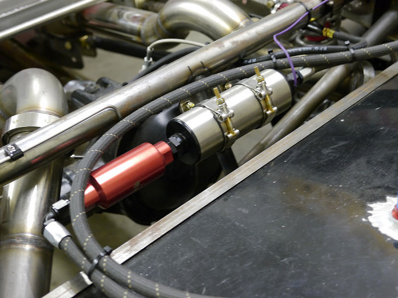

      Weldon A600-A fuel pump, Aeromotive filter, Goodridge 910 teflon hose

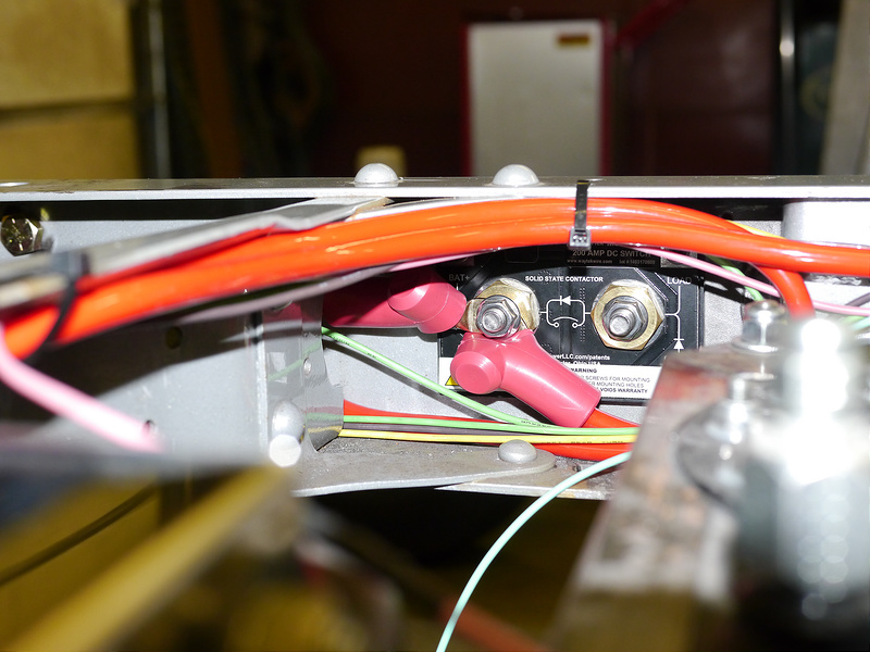

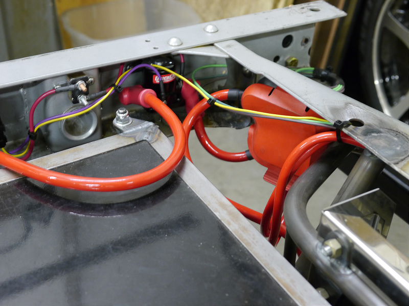

      Remote starter solenoid only activates starter cable when cranking, 3-pack of MEGA/AMG fuses from battery to alternator charging cable, main harness power, and starter solenoid
      Battery cutoff switch. Solid state and can use any switch to trigger (currently bypassed, but will include a switch at rear of vehicle for safety workers as well as one in the cabin for emergency shutdown). It shuts down the main feed from the battery to the wiring harness. The alternator is fed back to the battery and does not get cut, allowing the alternator to safely spin down into the battery, but not keep the engine running since the battery to main harness is cut.

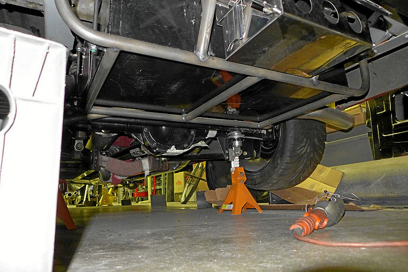

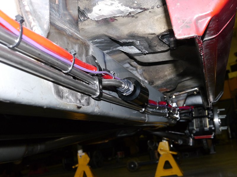

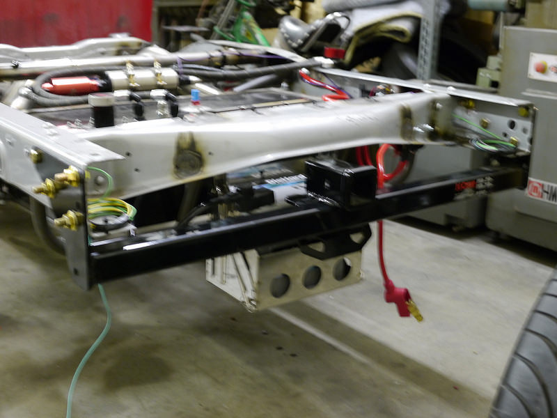

      Stainless fuel lines, starter cable and Aeromotive filter running up the passenger frame rail. I will need to move these lines inside the frame rail, at least in the tire area for safety reasons in case of a blowout or a side impact.
