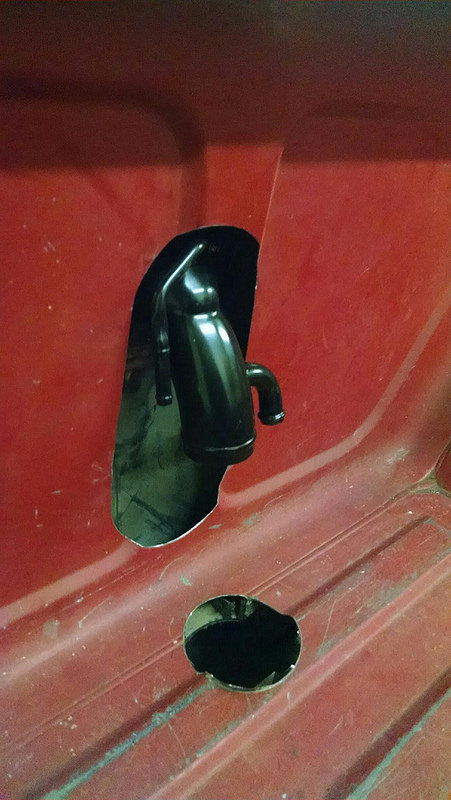

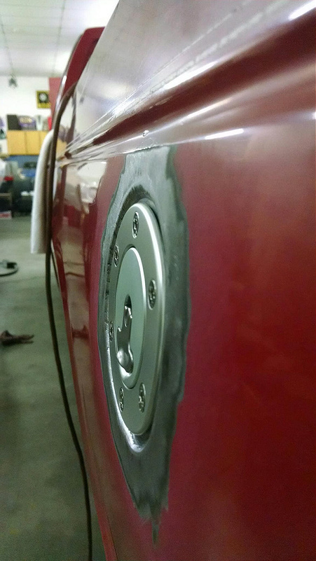

      Who manufactured your gas cap / filler neck ? . I've got an 88 S10 with the whole ridetech setup , warmed over 4.3 and is a blast to drive ( a big go-kart ). This thing should be a hand full .

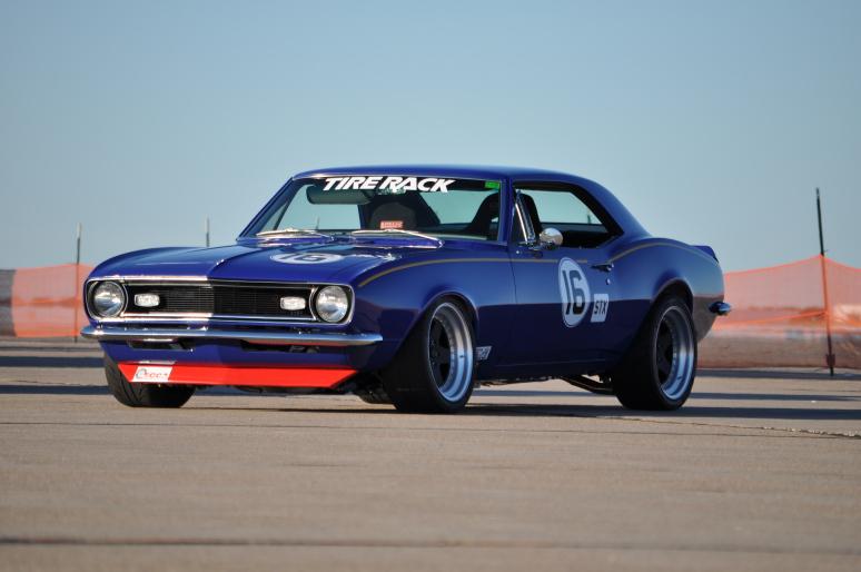

      Personally I would look at the 1le Camaro and you will see that it has a square set up. However the rear rim is wider which give the rear tire a slightly wider profile and a shorter sidewall.
      From talking with the a couple guys about setting up cars for Track use significantly wider in the rear is not optimum. However on a short course like autocross where you need traction is he helpful.

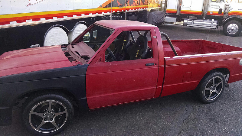

      I was able to drive the truck at Pacific Raceways back in January! Here is a video of the startup and pulling out of the lot:
      Unfortunately, the on-track video isn't the best since the track is wet and there was no windshield, so the sound is just wind noise (turn it down):
      It was very easy to drive and stable at speed. Tires were old and the track was wet, so it was very easy to get oversteer with the slightest amount of throttle, but for the most part it was very predicable and controllable. The 12.7:1 steering ratio felt much faster than anything I have driven, but it actually felt very natural. Brakes and clutch master cylinders weren't really optimized so brakes didn't feel very powerful and the clutch pedal sat really high, but those are all issues that can be fixed. Overall, I was really happy with how it drove.
      Regarding wheel and tire choice, I bought 4 TSW Nurburgring wheels in 18x10.5" +65 offset and 4 Hankook Ventus R-S3 tires in 285/35ZR18. The rears bolt up just fine, protruding from the bedside about 1" (the old 9.5" wheels were flush). The fronts will be setup with the same 1" poking out from the fender with a small amount of negative camber. I'll get rid of the spacer I was using to run the C5 wheels and move the spindle out to meet the wheels. This will get me to a scrub radius of 21mm, which is more than the stock C5 scrub radius of 10mm, but still a very modest amount. I should only lose a slight bit of turning radius.

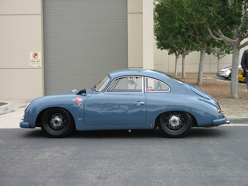

      The inspiration for the color I think I will go with (Porsche Aquamarine) is this 356:

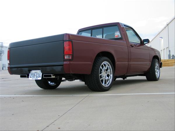

      Firstgenzq8, I hope you don't mind me stealing one of your pics to show a photoshop of the new wheels, since your paint color is so similar to the one I am looking for:
      that looks cool! those'll look great!
      Quote Originally Posted by jerome View Post
      Additionally, I was able to get a set of the Warn fender flares off of Craigslist, so I will be seeing how well they fit and deciding between those and the stock black flares like on the picture above. I may just keep the stock flares to keep it relatively modest looking for the street and if I ever get into more competitive autocross, I could run the wider flares with 18x12 tires and 335 Rivals.
      please take pics of those as soon as you get them. and if you happen to find any other warn flares, you know who to contact ;).
      i want to know the answer to my above question:
      Quote Originally Posted by FirstGenZq8
      the thing that i'm unsure of is in that pic, the part of the flare nearest the door at the bottom, i can't tell if that is some sort of mud-catcher or if it's an optical illusion.
