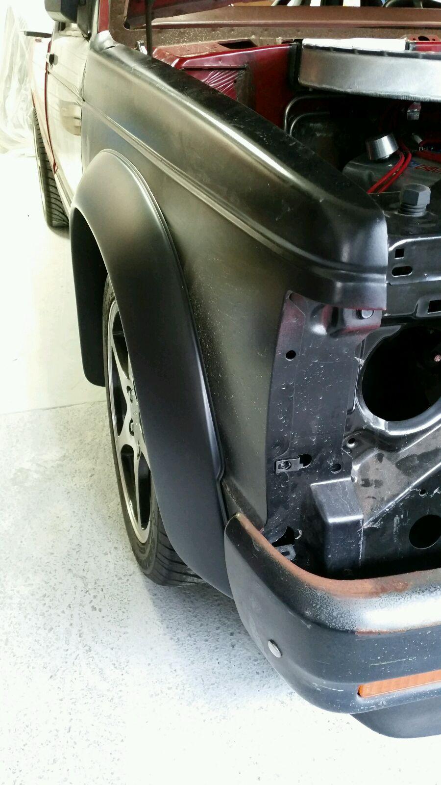

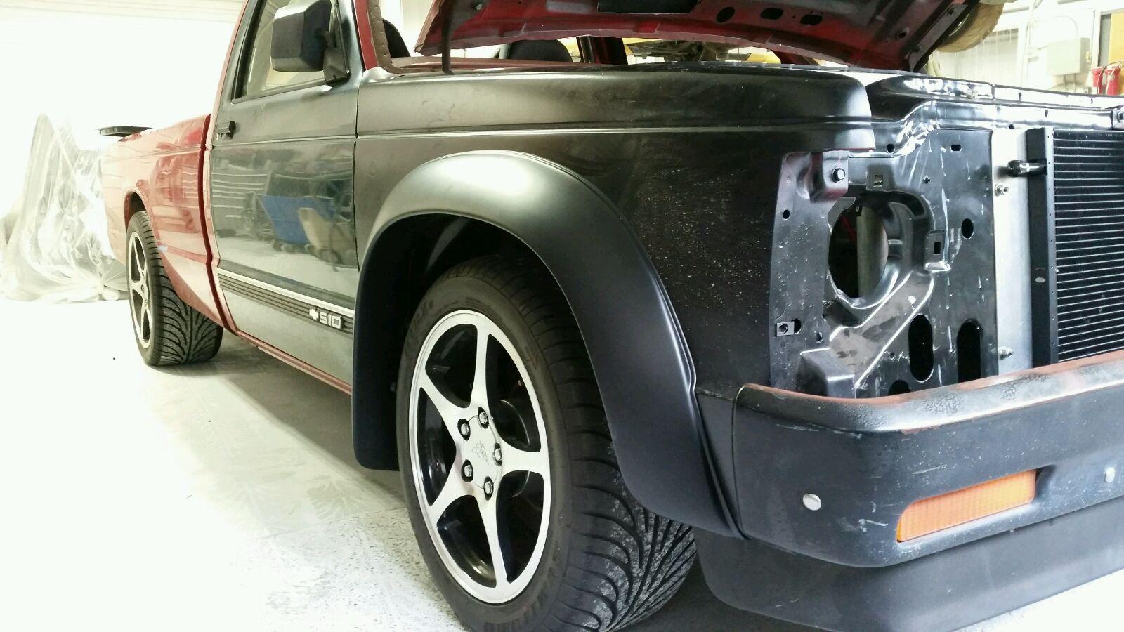

      I did get some pictures of the flares mocked up. Keep in mind the wheels will be at least 1" further outboard than the wheels currently on the truck:
      What do you guys think? Should I use these more aggressive ones or the stock S10 flares in the blue truck pictured above? Should they be painted to match body color?

      i hate them. when you decide against them, i'll take them off of your hands.

      So are you planning on going wider tires and if your not why not find a set of black OEM one's that give you an additional inch of coverage ??
      I'll likely stay with the 10.5" TSW Nurburgring wheels for now. I agree that they should fit under the OEM flares, and I've got a set of those now. I'll keep the big offroad flares in case I want to have a set of 335 width autocross tires on 12" wheels.

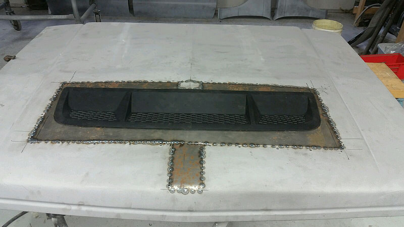

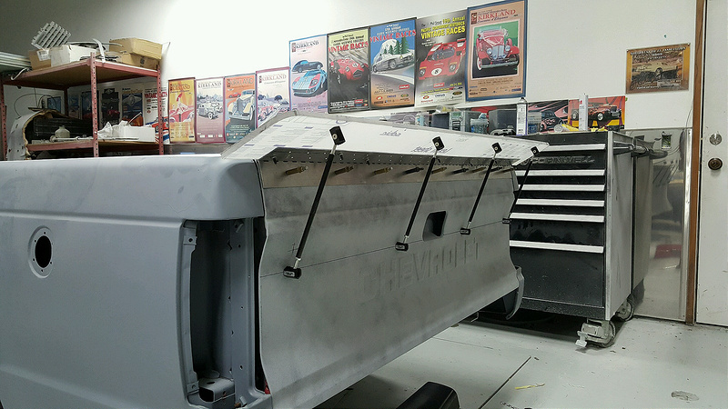

      Also at the body shop, the S10 is getting some limited aero: splitter, air dam, hood vent and spoiler. Splitter and air dam aren't done yet, but here's the hood vent (Mustang GT500) and clear lexan spoiler.
      Once paint is done (targeting February), the chassis will go out to the powdercoater and everything will go back to the chassis fabricator for final assembly and interior. Hoping to have a finished car this summer.
