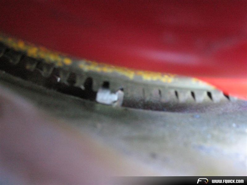

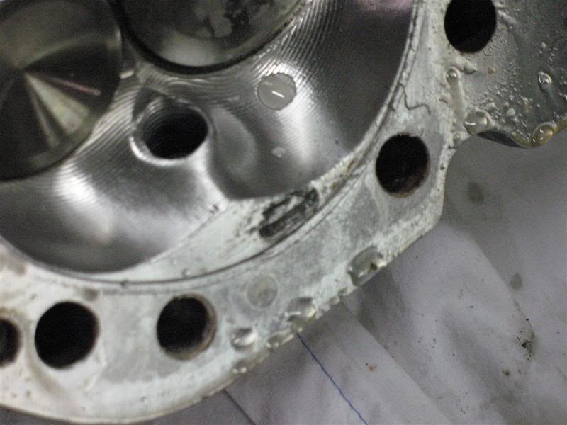

      a little piece of metal stamped into the head...left in there by some idiot (probably me)
      possibly cracks in the cylinder wall?
      It would be a huge coincidence if there were cracks and a foreign object unrelated to each other and both in the same cylinder. I'm fairly positive that those are cracks, do those look like cracks to you?
      I'm looking at getting the block sleeved, does anyone have better options? Also, do I need to get the head worked on to remove the nick from the foreign object? I have no idea what it is, it imprinted itself on both the cylinder and the head, I'm not sure if it is something from the head or if it was indeed something I dropped in.
