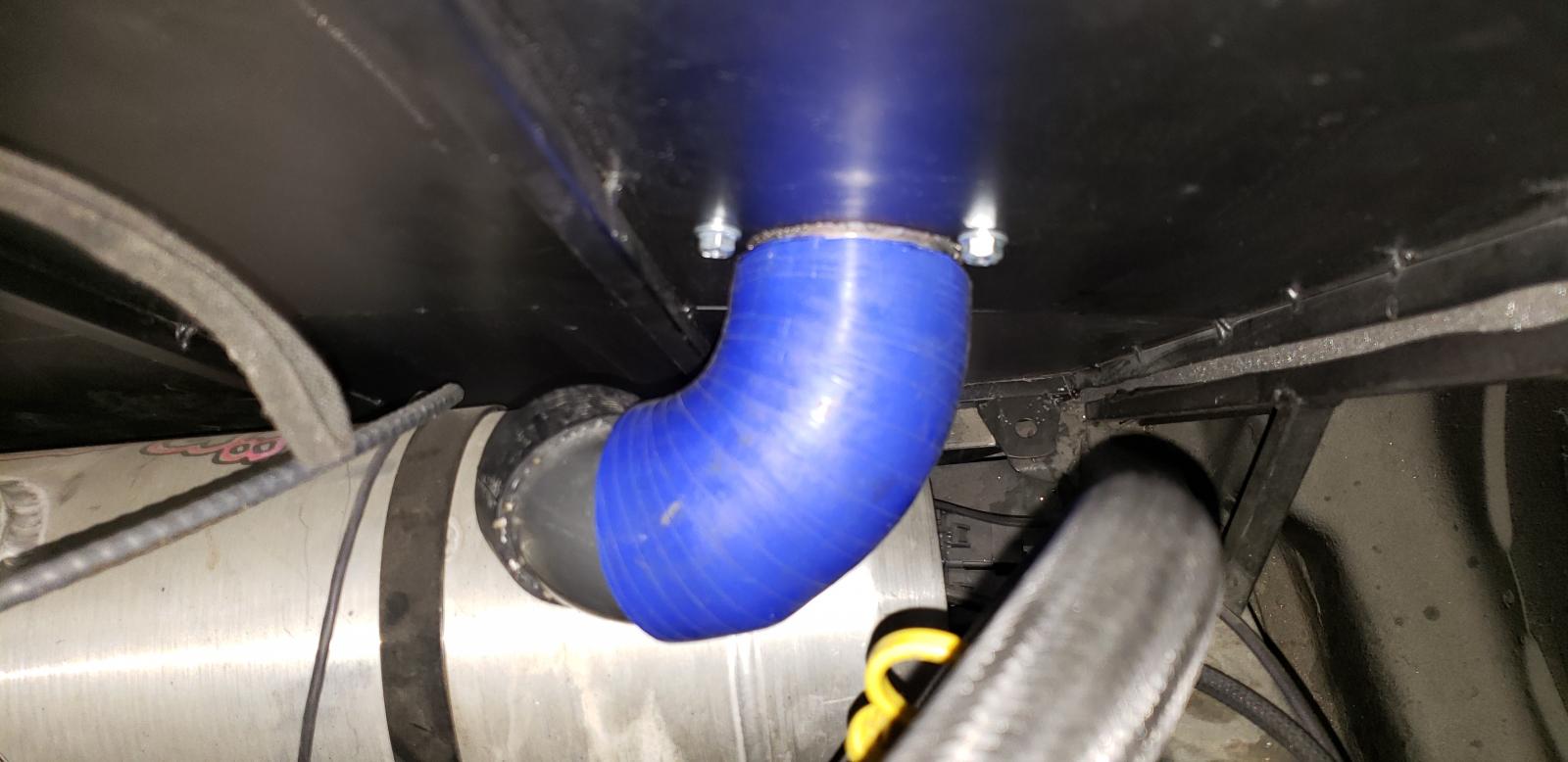

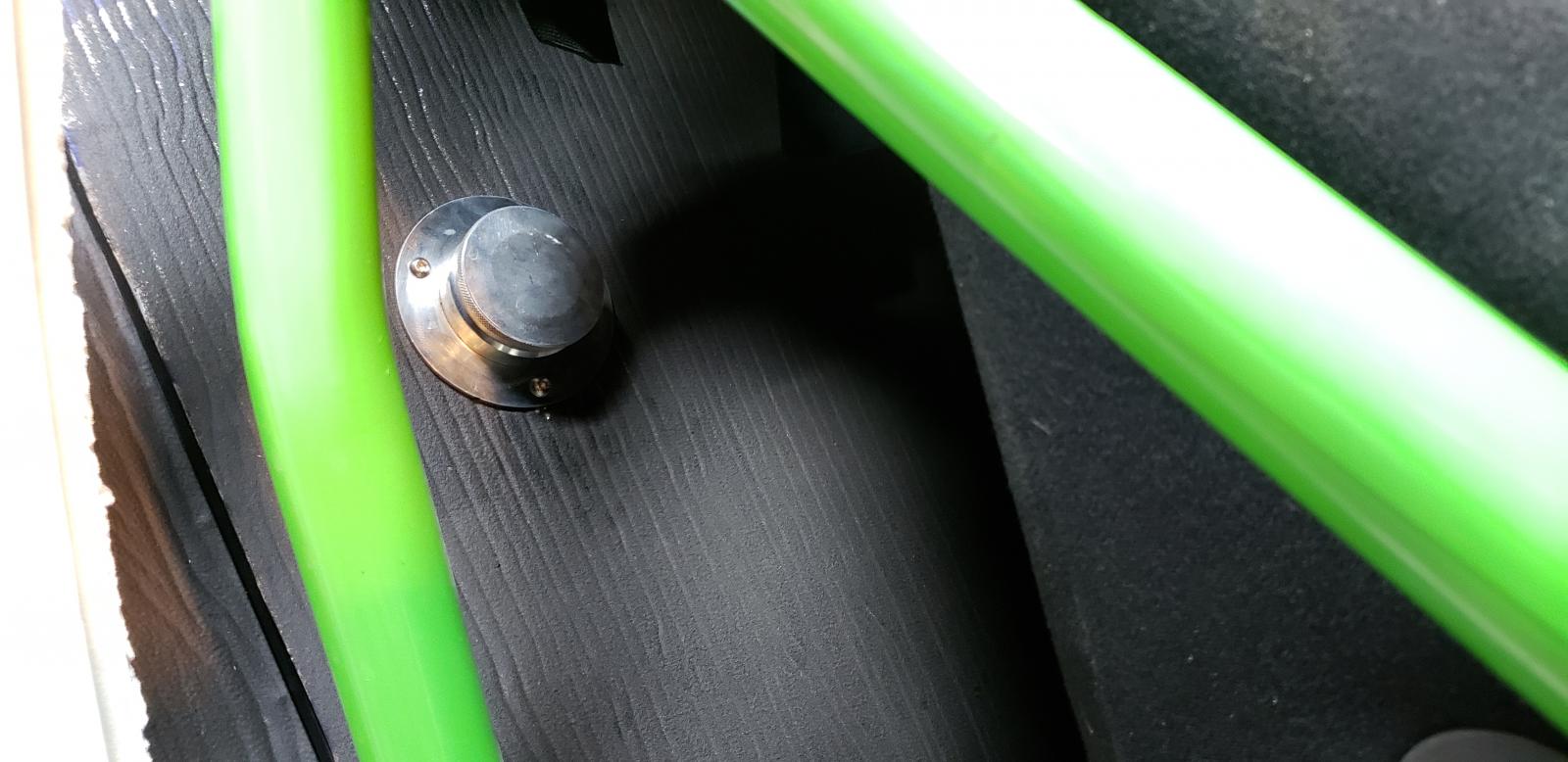

      I got an update finally! It's a very small one though. I have been slacking big time on working on the Bug. So anyways, I want to finally put in all the side windows. The one thing that has been holding me back is the gas filler. Before, I would have to pop the hatch, go in through the rear side window and fill it up. Big pain in the butt. I finally got around to installing a real filler neck for it. Didn't want it on the outside cause I couldn't figure out a good spot for it. So it's now in the firewall. Should work. Now I can put the windows back in. Just got to put some hose clamps on it and I can call it a day.

      One thing to watch though. Is that blue hose silicone? I asked the owner at my local Earls fitting and hose shop about using silicone hose for a fuel fill. They said it isn't rated for fuel. So, you may want to check how the fuel affect those hoses.

      Jetfixr - I believe you are correct. Oil and fuel are supposedly a no go with silicone hose. I did not have a 90° rubber hose to use so I just used a silicone piece from my scrap pile. It will be replaced with a rubber hose eventually. Ill just keep an eye on it for the time being.

      Even though it isn't fuel rated, it will take along time to deteriorate to point having an issue. Considering fuel isn't on/in it all time.

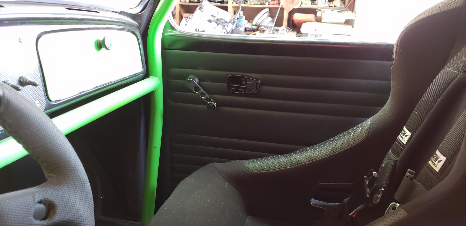

      Passengers side door panel is on.
