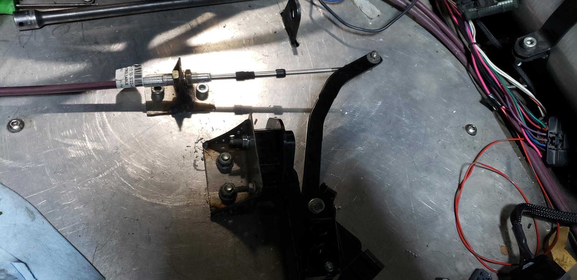

      Before I decide what the fate of the Evo is, I told myself I am going to get the Bug all put back together. I have too many projects going at the same time and need to focus on getting one done at a time. So that is what I have been doing, getting the Bug back together. The most time consuming part has been getting the gauges to work. They are on a specific can bus signal and can only be tied to one type of ECU which I am no longer running. So I pretty much had to make an entire engine harness for a separate ECU just to run the gauges. I got that all done but waiting on some programming to be done before I can verify that everything works. The other big issue I was having is that the thermostat would not open. Tried 3 different ones all with the same outcome. Little did I know, with the stock thermostat housing, you have to loop the heater lines or you run into this issue. Normally that would be an easy fix but with how my header is, that wasnt an option. Long story short, I removed the thermostat and all is good now. Moving on to the next thing, I finally remote mounted the gas pedal. Its going to fit nicely under the seat.
      From here, I have very little left to do. The engine is throwing a code for not enough fuel rail psi (direct injected) so I need to replace the high psi mechanical pump. My fuel psi regulator also decided it was going to start leaking out of the boost reference port. After I fix those 2 minor issues, I can slap all the interior back together and have a fairly finished car. Once that happens, I am going to bring it down to work and park it in the showroom.
      On top of all that, I am remodeling my house. So I really need the Bug out of my garage so that I have room to put things while the house is torn apart. This past year has been a pretty wild ride and I am ready to get things back in order and projects done. The ex and I finally got the kid on a schedule, so I am no longer watching him everyday which means I actually have time to work in the garage! That was the biggest hurdle. From here, progress should be steady! I think that should get us all caught up for now.

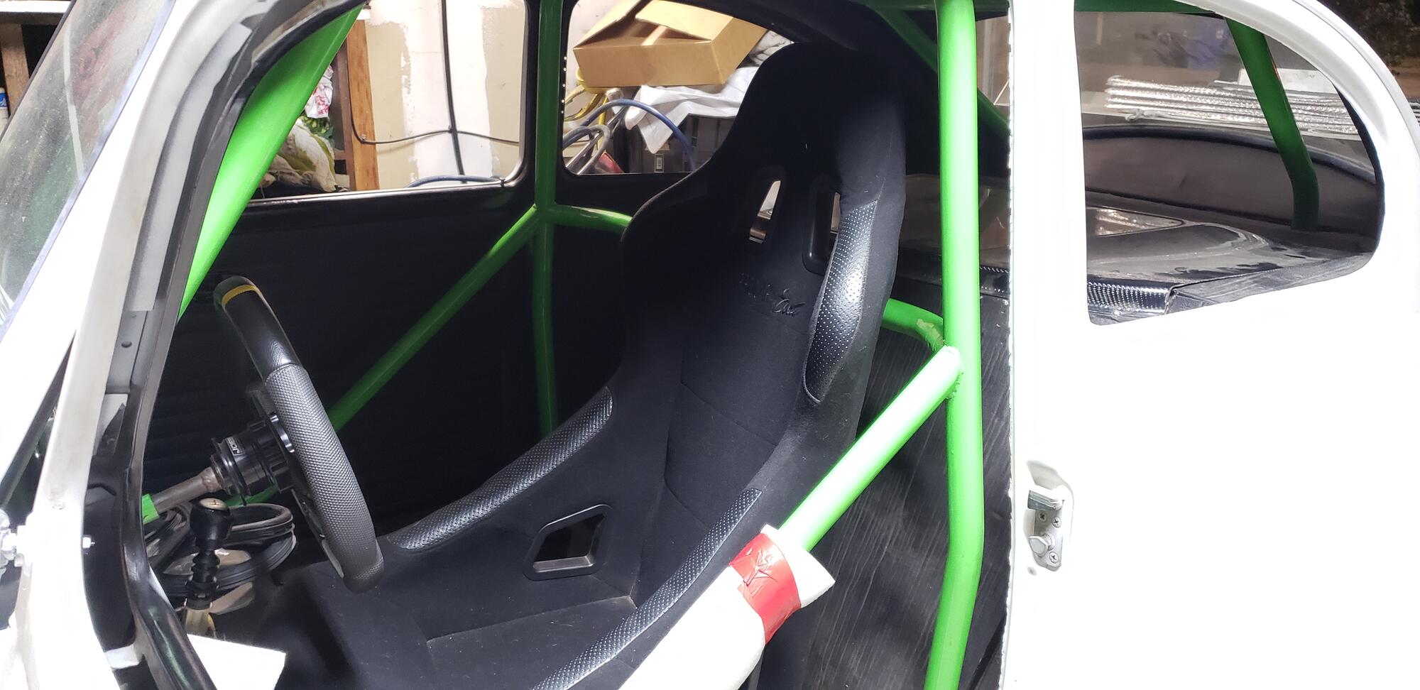

      Bug is 99% back together! Have 1 seat and 2 harnesses left to put back in. Thats it!
