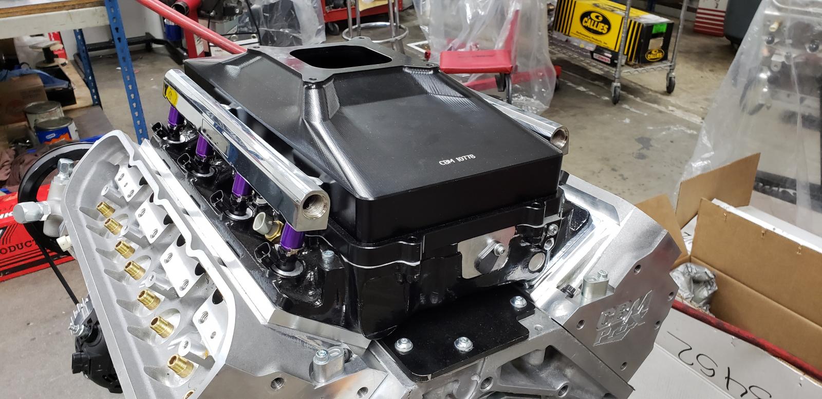

      You have to at least tell us what you were going to do with that LS7 manifold? I've been curious about it since you posted the teaser.
      The intake base was used for a big nasty turbo build. I think it ended up making around 2500hp. Pretty much the lower half is from a Whipple 4.0L, with the heat exchanger inside and then a custom billet top half that allows you to use something like a 4150 style throttle body. Think of it more as a fancy air to water setup. End result is like so....

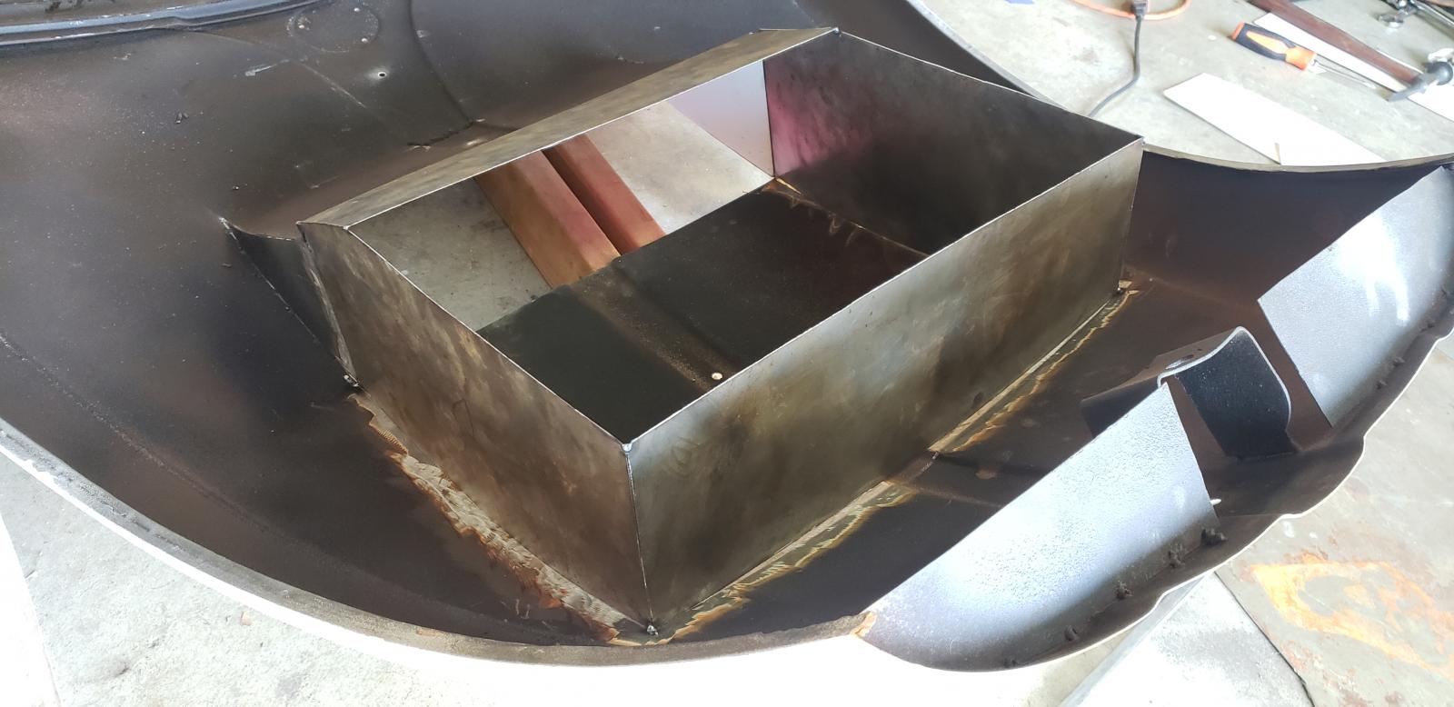

      A Bug update with pictures! Since the engine should be leaving soon, it gave me some motivation to finish up all the little stuff. First off is finally completely boxing in the radiator outlet.
      First, the very rough template.
      After that, making it even more rough but filling in the gaps.
      Then I moved on to making much nicer individual pieces and test fitted them.
      From there, I trimmed them to fit perfect and transferred those over to sheet metal.
      After that, tack the pieces in place and test fit.
      All looks good. Just have to get my foam seals, paint and this this small project is done. Hoping this helps keep some heat from coming in.
