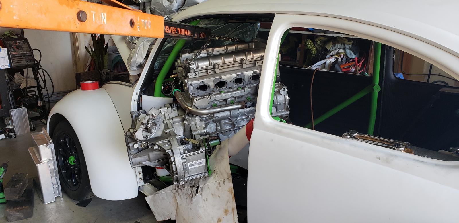

      The fun task of removing the engine has officially begun. Should be out by the weekend.

      Made some progress on the Bug over the weekend. I say progress but this is just putting me even further behind. Engine is out and will be going to its new home tomorrow. Internally, it still looks brand new and it should since it only has 250 miles and one race on it. Its going to be a while before I am back on this thing. Got to finish putting my house back together first. Maybe once the weather cools off it will be time to put the new engine in.
      And like normal, the absolutely horrible task of taking it out through the door!

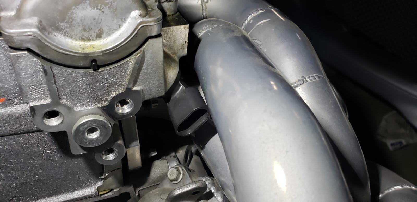

      Here are some pictures to show what I am dealing with. This is with the header not being flush to the head. Probably a 1/4" gap still.

      Exhaust flanges just suck some times
      Ouch! When i built my turbo manifold i had a similar issue but my gap wasn't quite as big. At that point i just sealed it up with some copper rtv and decided to just readdress it at a later time. I forgot to bolt my flange up to something to keep it from warping when welding...one day ill just build another set. This bug looks Awesome though. Been dreaming about a mid engine bug for quite awhile now and im glad i found this thread!

      Hey Straitbuggin! The issue isnt with the flange being warped, its just fine. Its that one sensor sticking out too far that wont allow me to slip the header all the way on. If I can get my Evo put back together this weekend, I will be going full force on the Bug right after. No need for you to dream about a mid engine Bug, this one is going up for sale early next year and could be yours!
