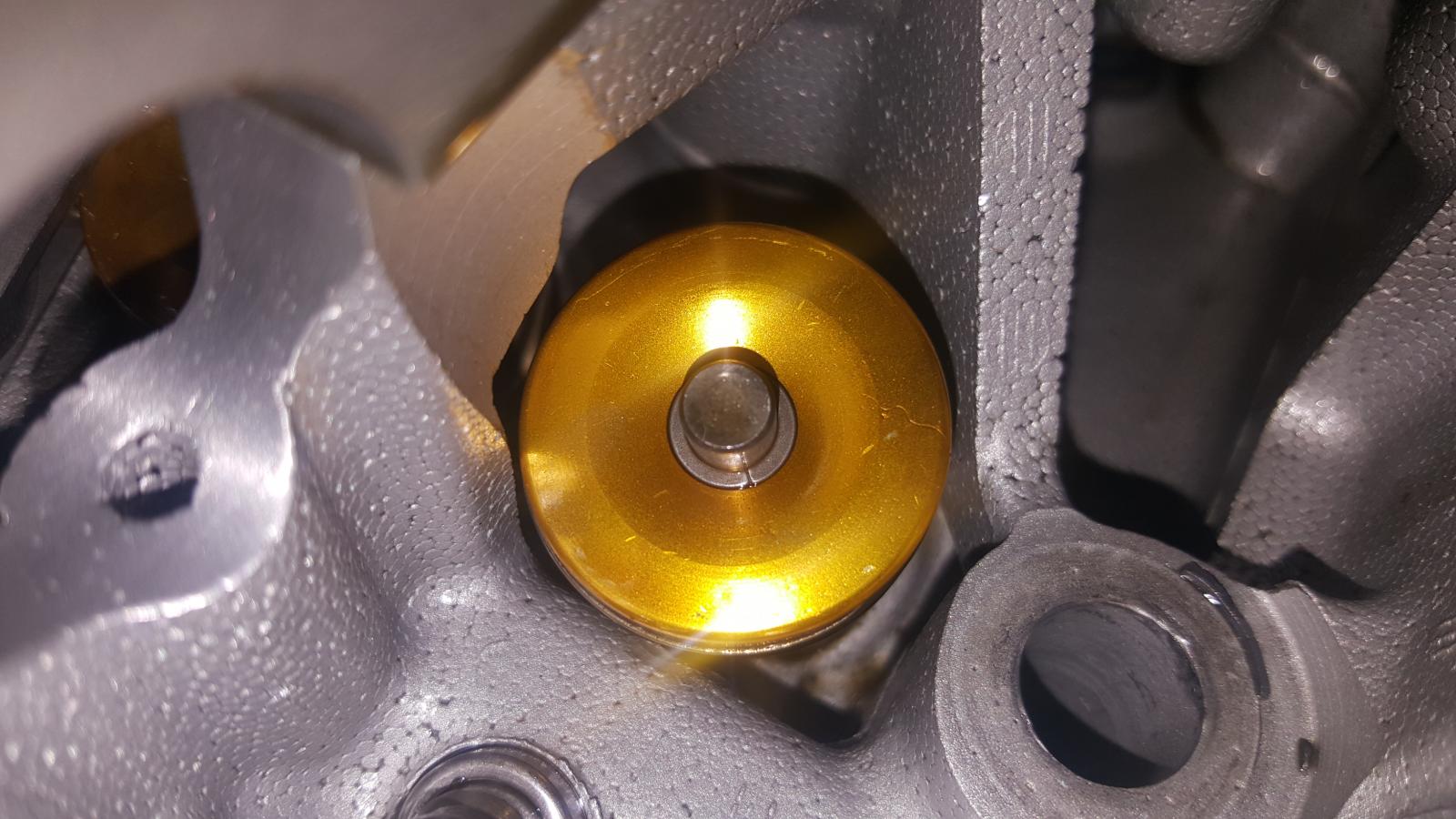

      I have no good news tonight. Looked over the head again tonight to see if there was anything else. Yep there is. First of all here is what I am dealing with.

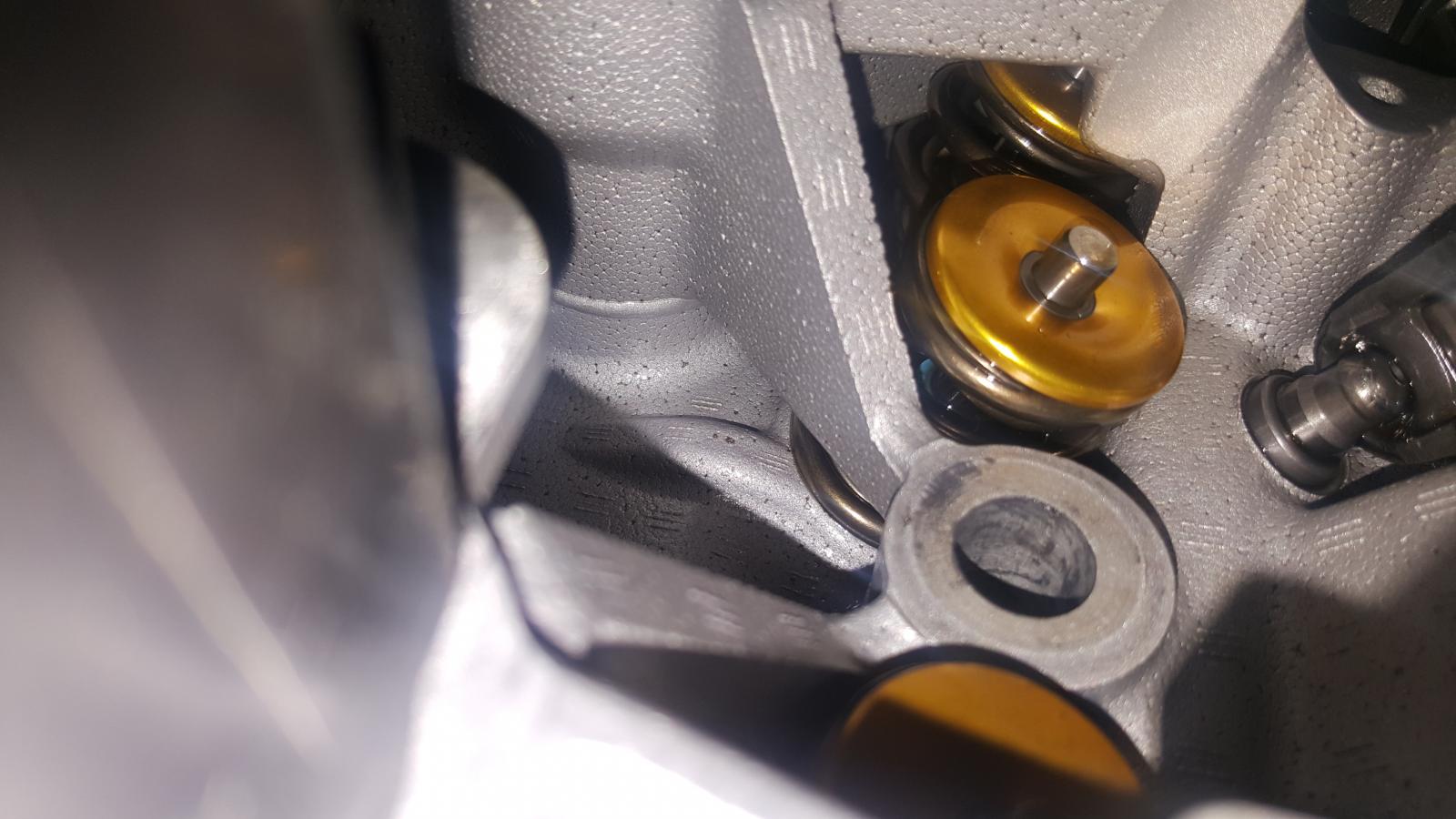

      You can see it is a very tight sqeeze. Since it has already self clearanced there are only a few spots left touching. This I already knew. I somehow managed to get in the right angle to see the bottom of the spring. Well looks like the base never got machined to fit a bigger spring. So the spring is sitting halfway in and halfway out of the spot it is supposed to sit in. Probably has a .100" deep lip. One thing after another with this head...
      You might be able to see it in this picture.

      I see. I'm a little surprised at how porous the casting is. I would have thought with today's technology, that it would be vacuum degassed in pouring.

      475
      Ya it is kinda sad. All the 2.2 heads are "foam cast" while all the 2.0 heads are "sand cast". At least thats how i describe it. The 2.0 heads go through a much better casting process and look how they should look. They are also supposed to be stronger

      Well, I'm glad you got to the source of a major issue. There is definitely some binding going on.
      In one pic, it even looks like the valve tip looks angled a bit (?)
      I would not be surprised to find major galling around the hats and spring bases as they chatter around.
      The glass 1/2 full is you had a great time shaking out the large bugs, the car just needs one task done, and it's time to chase some cones.

      Once I get the head taken apart, I am expecting to find more issues, especially where the springs meet the head. The valves I have already deemed as junk. I did the good'ol flashlight test through the intake and exhaust ports. Yep you can see the light between the valve and seat. So that also means that the guides are going to be junk. I just hope it didn't crack the head around the guide. I don't have the correct spring compressor so I can't take it apart at my house. Going to send it out next week to have someone else take it apart. Then we will see what happens from there.

      I got the head all torn apart. Yes, the valve springs were rubbing the head. The valves also seem a bit on the loose side. Some of the springs were wedged in so bad, I had a hard time getting them out with plyers. All the spring bases look good and dont have any indents like I thought they would. All the valves look to be straight and dont have much wear. I will get everything double check just to be safe. Better findings then I thought would happen.
