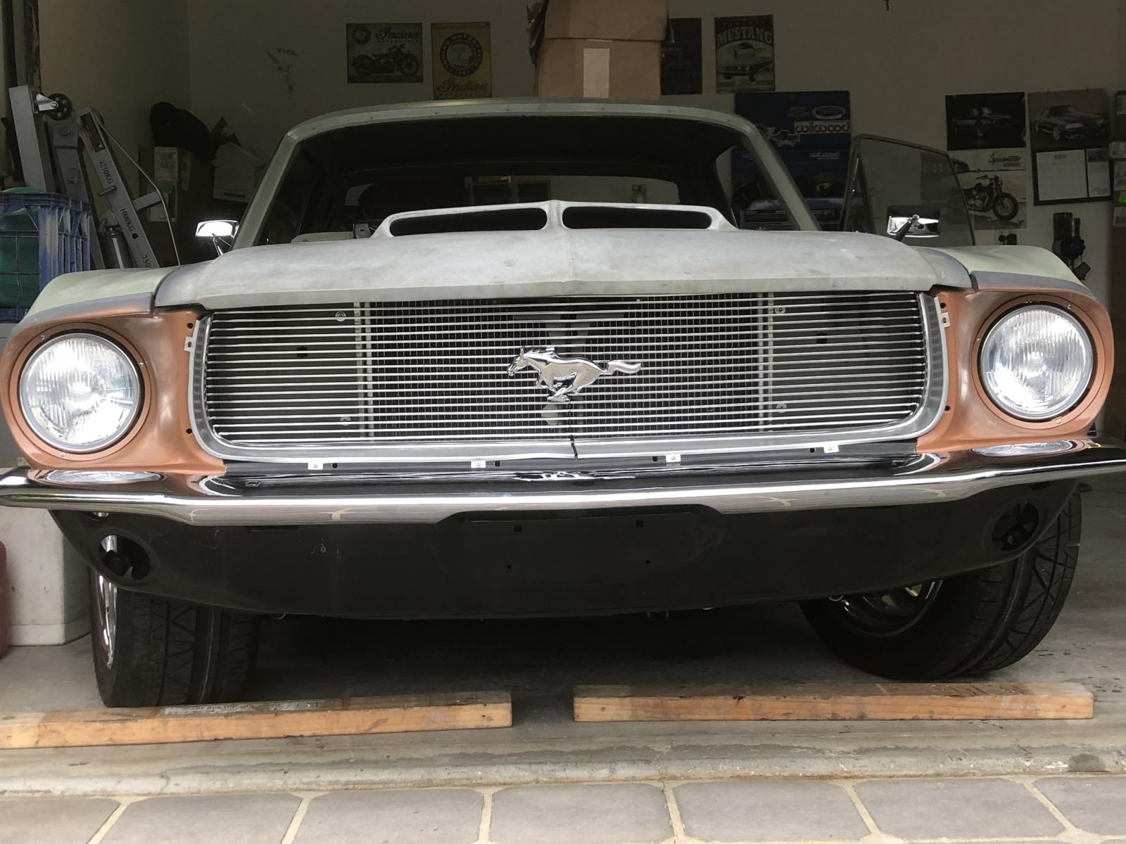

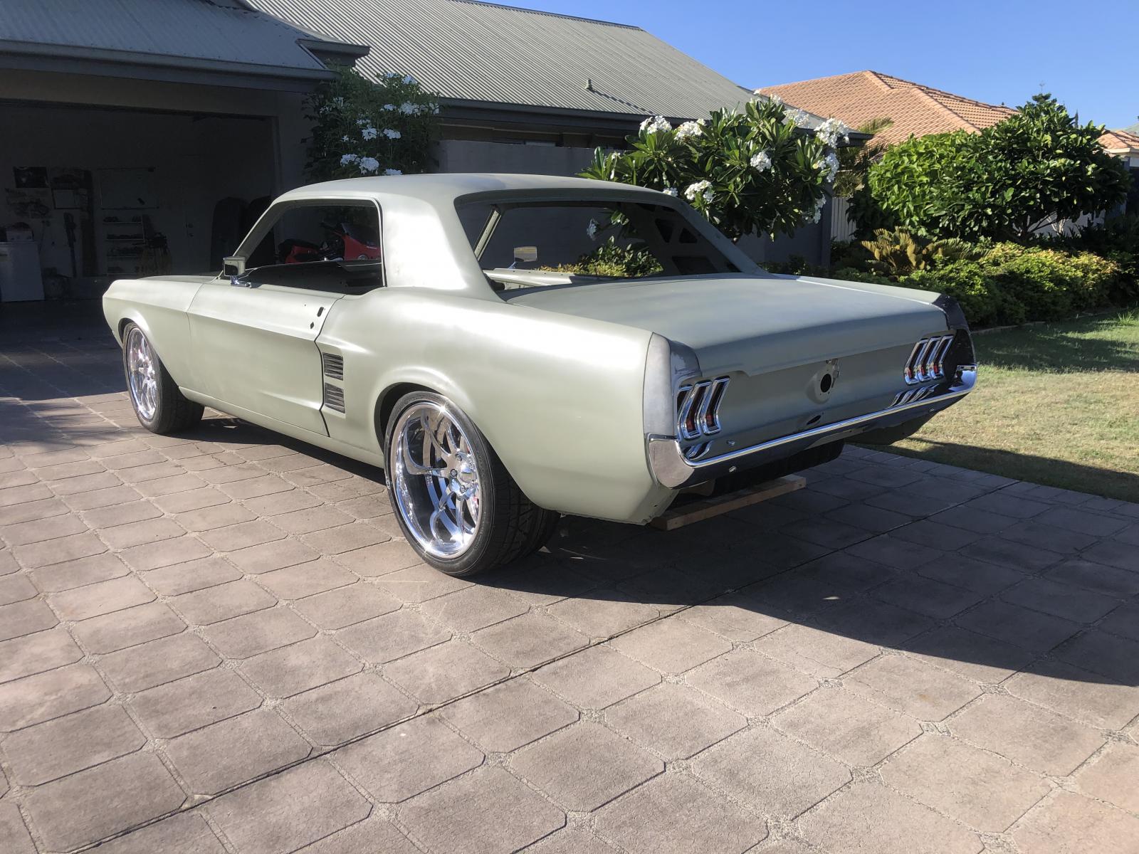

      Made a little progress over the last few weeks and I’m still in the process of doing a mock up to see how it all fits prior to painting. Here are a couple of progress shots.
      Thoughts on the Billet grill with the pony in the centre?Name:  FEE9F7AE-AD1C-488E-8A11-23B414330257.jpg

    3. #203
      Oct 2018
      San Jose, CA
      528
      Looks great ! Nice work.

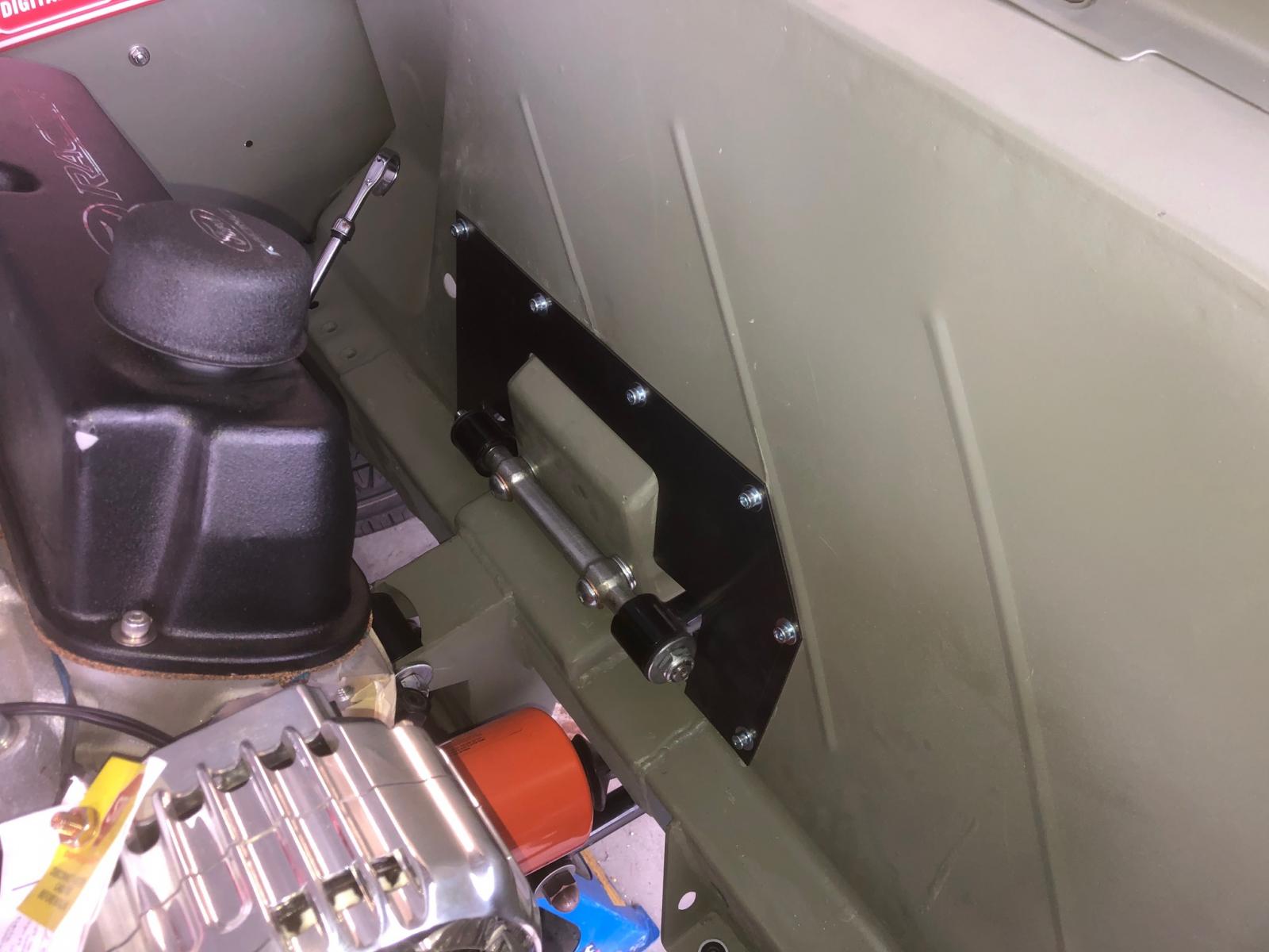

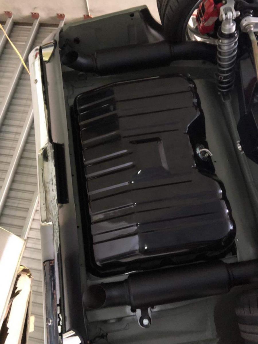

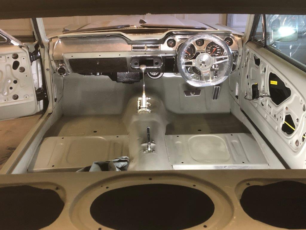

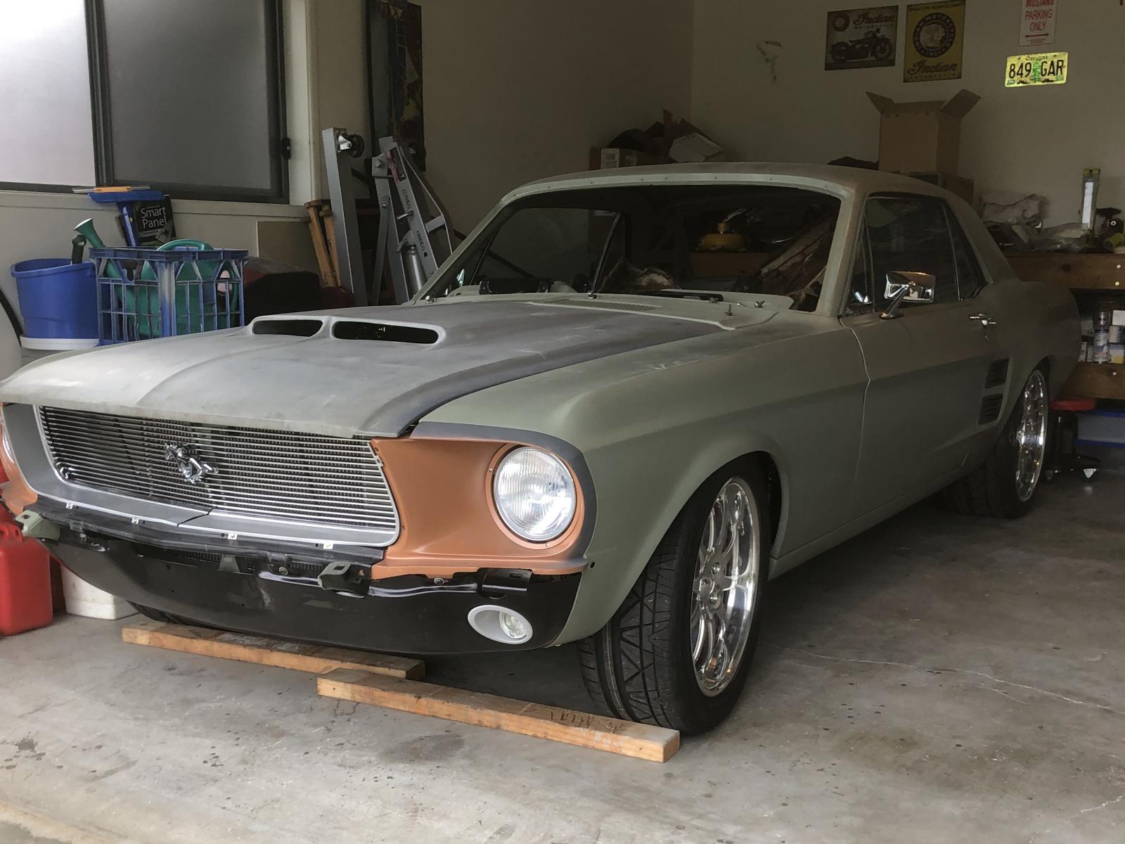

      Quick update. Added an A/C condenser, Suspension blanking plates, Ring Brother power steering reservoir and an air cleaner. I'm planning the plumbing and brake lines now and its off to the exhaust shop at the end of the month for custom headers and a 3" system.
      Still unsure of the interior. Love the TMI stuff but by the time i get it down here with the exchange rat it will cost me the best part of $8000. I could get a full custom one for around 10k. More research needed.
      Also love the Mustang to fear door cards but they want as much to ship them as they cost almost!!!.
      Anybody have any good ideas on getting parts shipped at a reasonable rate?

      On the last picture you can see the bottom of the Vintage Air A/C unit fitted to a R/H/D flat fire wall. They said it couldn't be done!!! Wrong

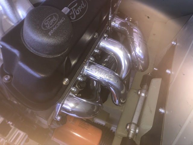

    9. #209
      Jan 2015
      Australia
      285
      Country Flag: Australia
Size:  210.0 KBName:  A53364CF-0684-42A5-8337-A6799050C8D4.jpeg
Size:  152.9 KBName:  DCFD1EA4-039C-4AD4-8FDD-3AF20FA6A05F.jpeg
Size:  176.5 KBName:  84EDD248-49F4-48EE-B132-3A01BE52E1DA.jpeg

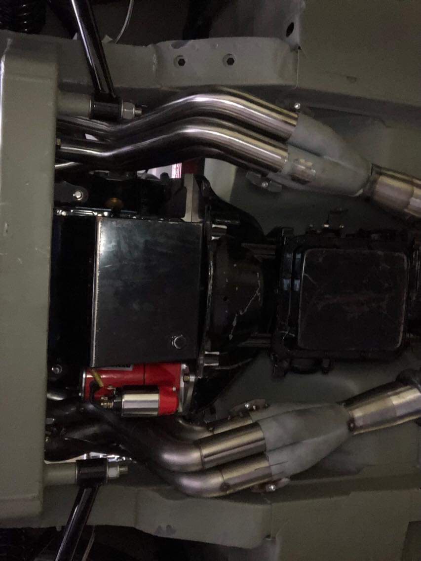

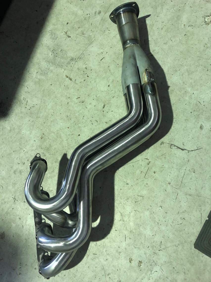

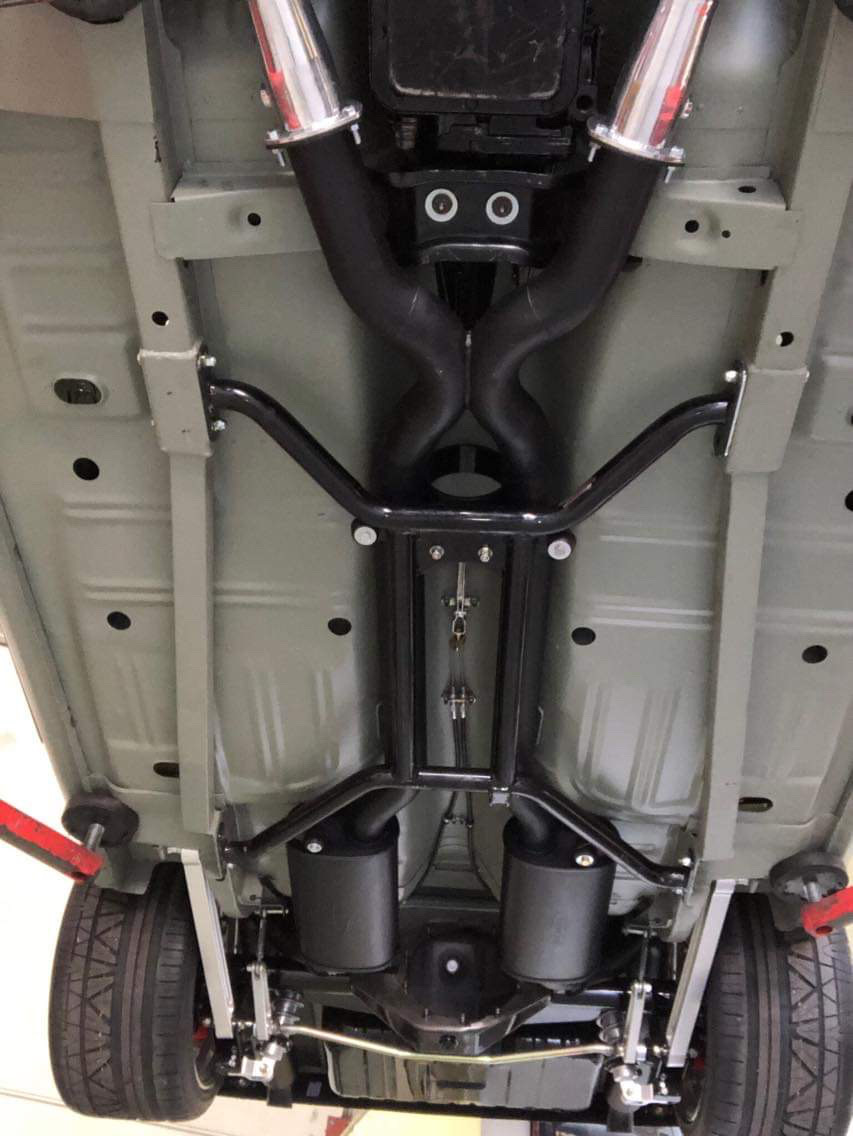

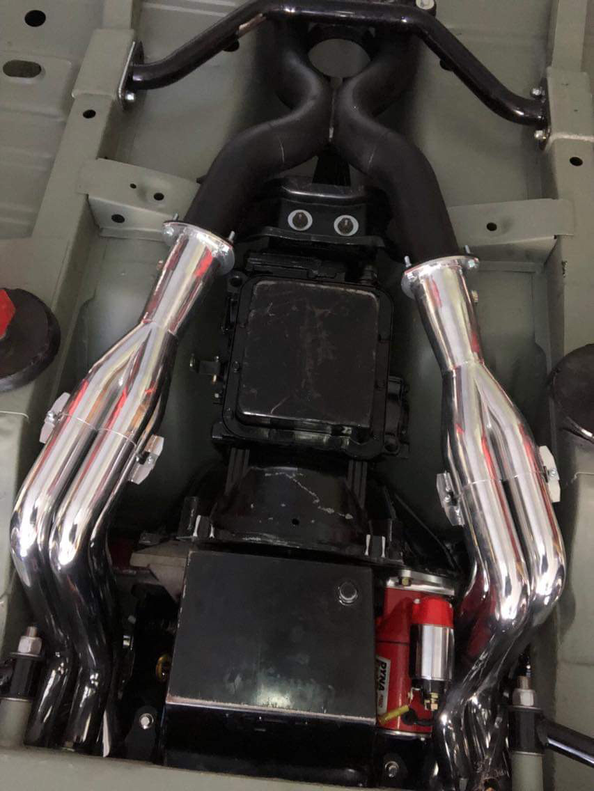

      A quick shot of my exhaust getting made. I’ll be interested to see how he fabricated the pipes over the axle and around the four link rear
    10. #210
      Dec 2014
      188
      I've always thought this would be one of those most hard jobs to take on.
      If you don't mind explaining, what was his reasoning behind the reduction in size after the collector then taper back out?
    11. #211
      Jan 2015
      Australia
      285
      Quote Originally Posted by Max Power View Post
      I did wonder the same thing after your question. Asked the exhaust man why not go straight to a 3" collector instead of going out to a 3". He said it enables a small pressure build up and act like a venturi pushing the gases out under that little bit of pressure clearing the headers better. He makes them this way after lots of testing on the Touring Car Masters cars down here in Australia. How true that is will be on the Dyno i suppose. Sounds a good in theory though.
      Saw him yesterday and he is going to go around the outside of the shocks on the rear in line with the rear rails and make the pipe over the axle oval keeping the same volume area but giving clearance for the suspension travel.
      Craig.

      I guess if he has the dyno testing to prove his theory, fair enough. It just had me curious. But thanks for being curious too and asking. Cheers!
      The oval pipe looks good. That looks great when done well. I've seen a few systems using that along the floor pan when ground clearance is at the minimum.

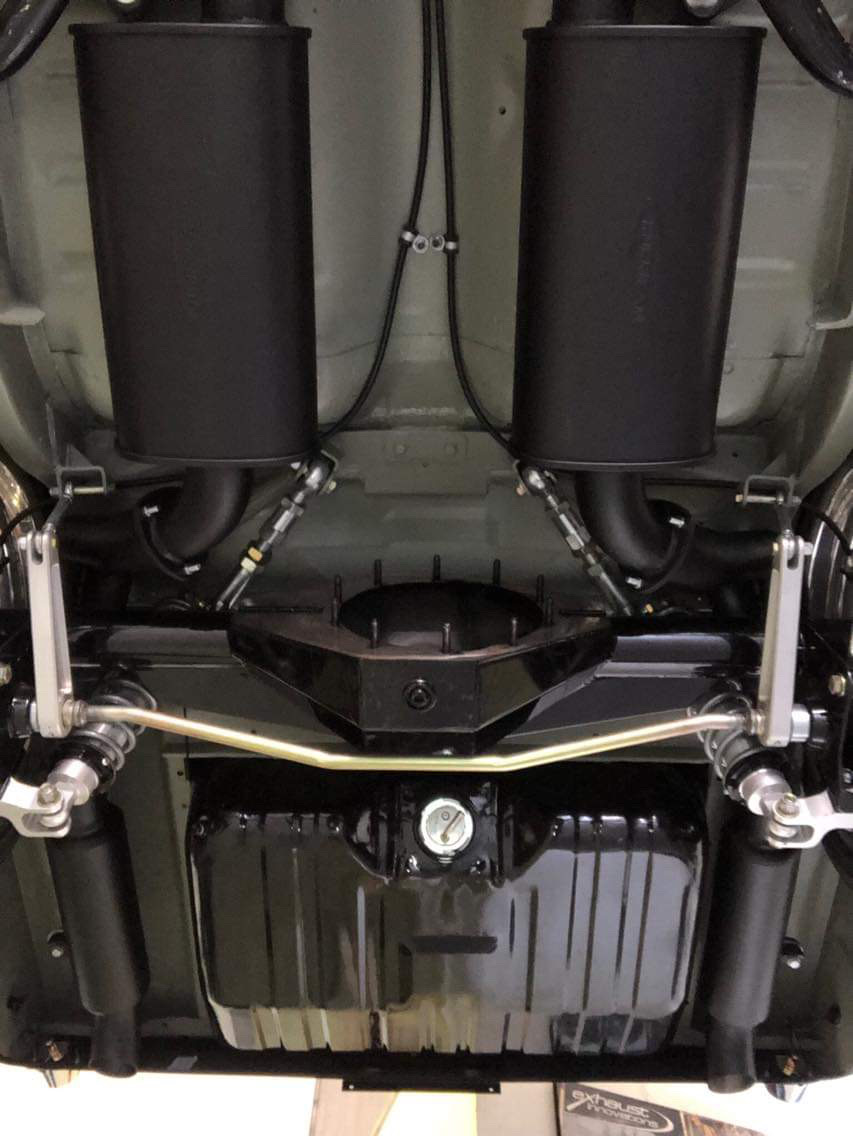

      Exhaust finished

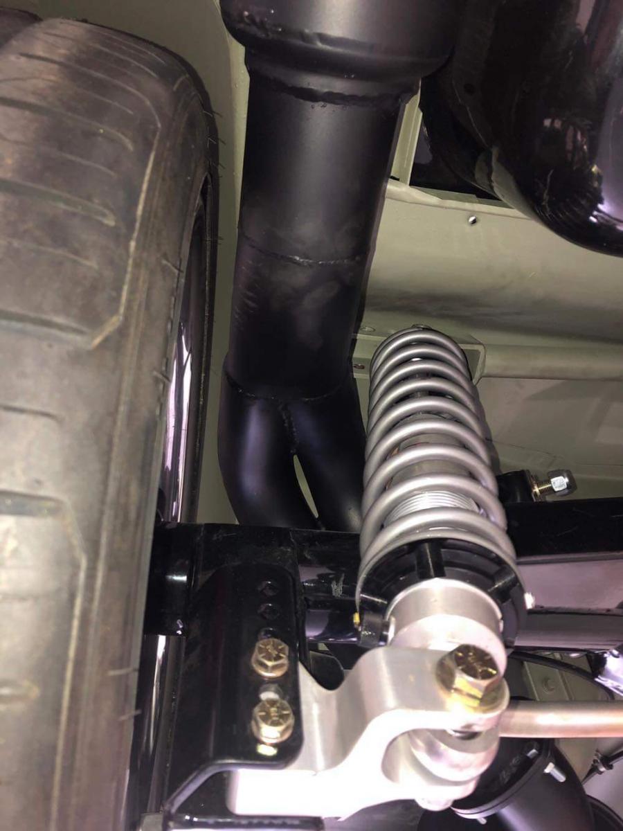

    14. #214
      Jan 2015
      Australia
      285
      Over the axle and around the four link. More like atrwork😎

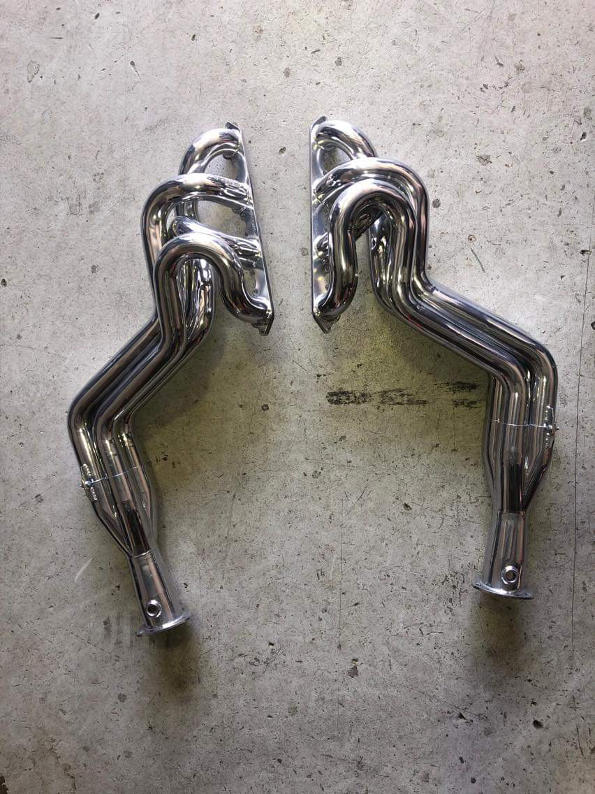

    15. #215
      Jan 2015
      Australia
      285
      Love the headers and workmanship from Exhaust Innotations
