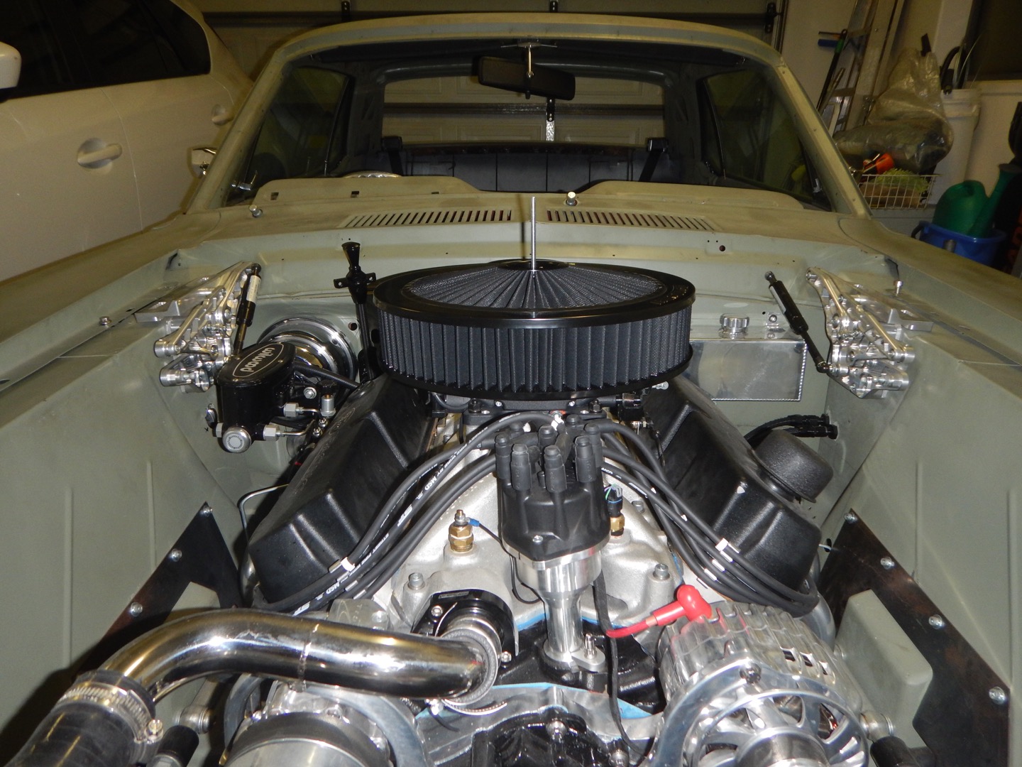

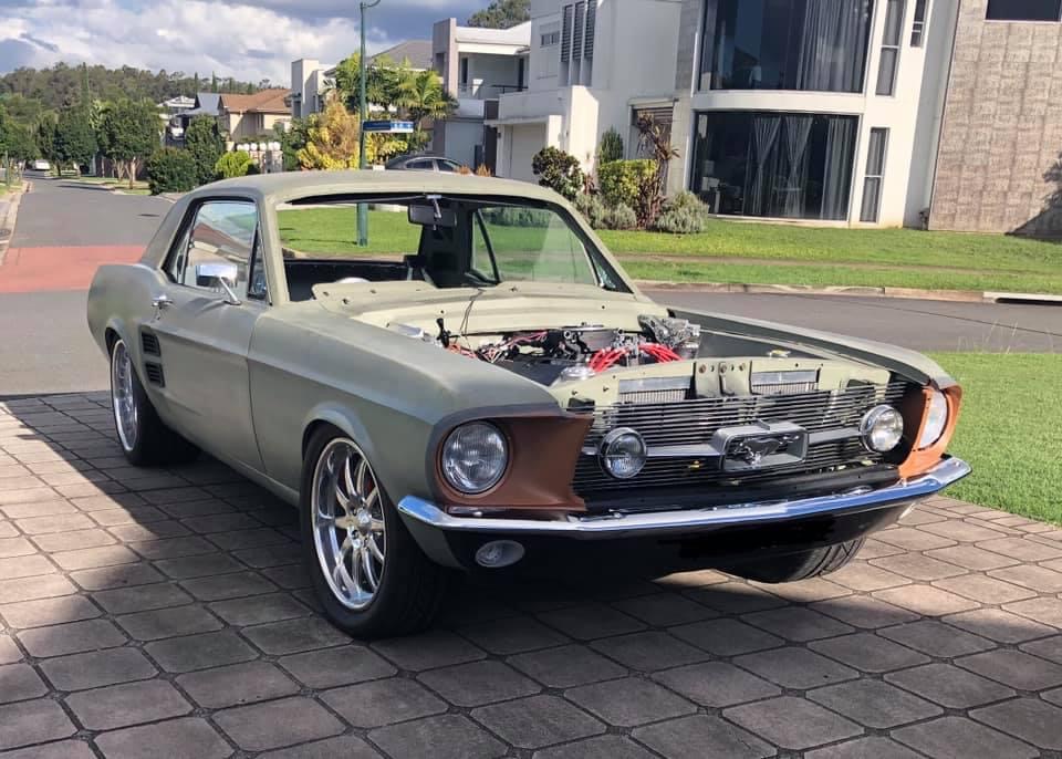

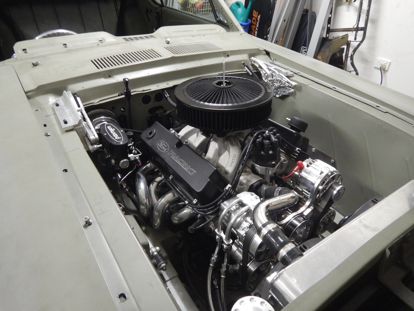

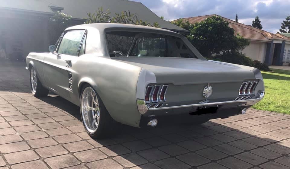

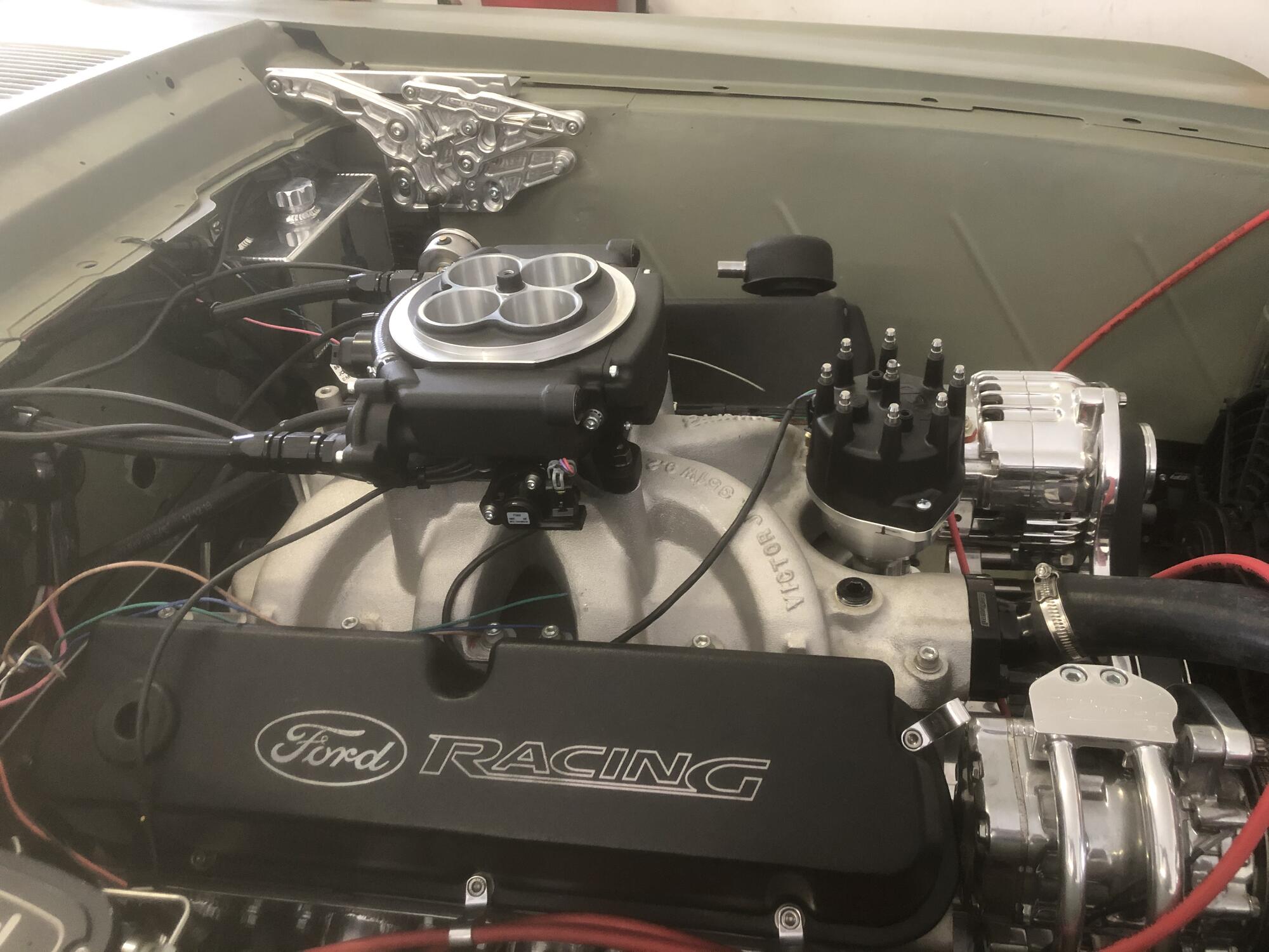

      Haven’t posted for a little while so here’s a quick picture.
      Car is at about 90% of build to check for fitment and to foresee any issues that may arise. It will then be stripped back to a shell to go to paint and final body finish. Have fitted a Holley Sniper which was so easy to do but the proof will be in the real drive and learning process.Name:  DB8E005D-7F2B-4B04-9C84-71A89A84E54F.jpeg

      Looking great! Can't wait to read about your first full-build drive.

      I see you have a Sniper system. You might find this useful:
      https://forums.holley.com/showthread...ey-EFI-systems
      I wrote that up a little while back. It really makes for a reliable and tidy Sniper installation.

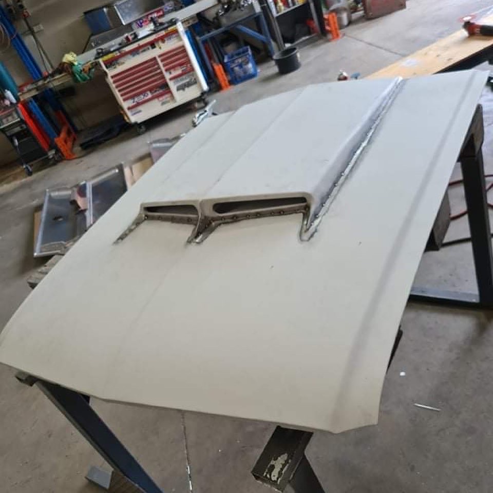

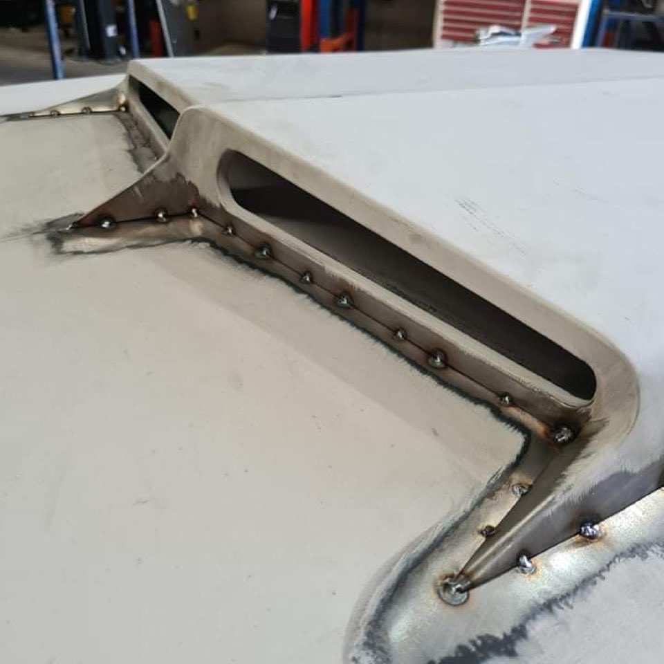

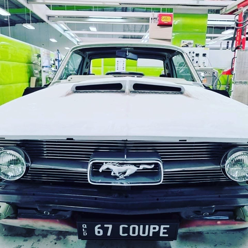

      Hi all. Haven’t posted for a while but here is a quick update on my hood
      Had an MTF scoop hood but wasn’t happy with it being a glass hood so I thought I’d have a go at fabricating a steel one. A friend fabbed the scoop then tigged it to a steel hood. Still in progress but I think it’s coming along nicely
    10. #250
      Oct 2007
      Camas, WA
      640
      That is a really nice job on the scoop. The build is coming along nicely!

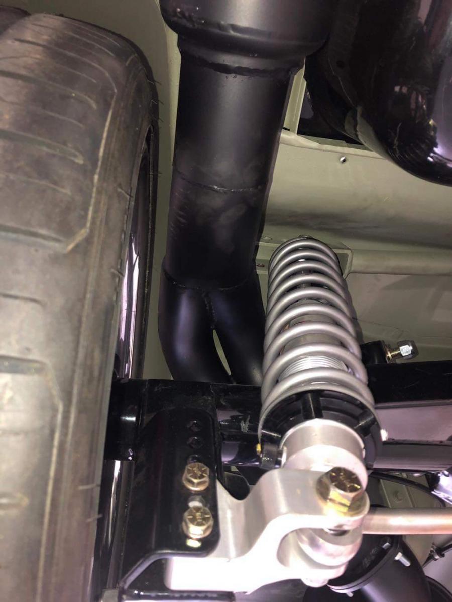

      Wow, you have done an outstanding job on this car. I noticed this little split pipe on your exhaust as it goes over the axle. Can you elaborate what this is for? I've never seen that done.
    12. #252
      Jan 2015
      Australia
      285
      Country Flag: Australia
      The split pipe is the exhaust. It goes from a 3” to a twin 2”. This gives more clearance for the axle tube. It then goes back to a 3”

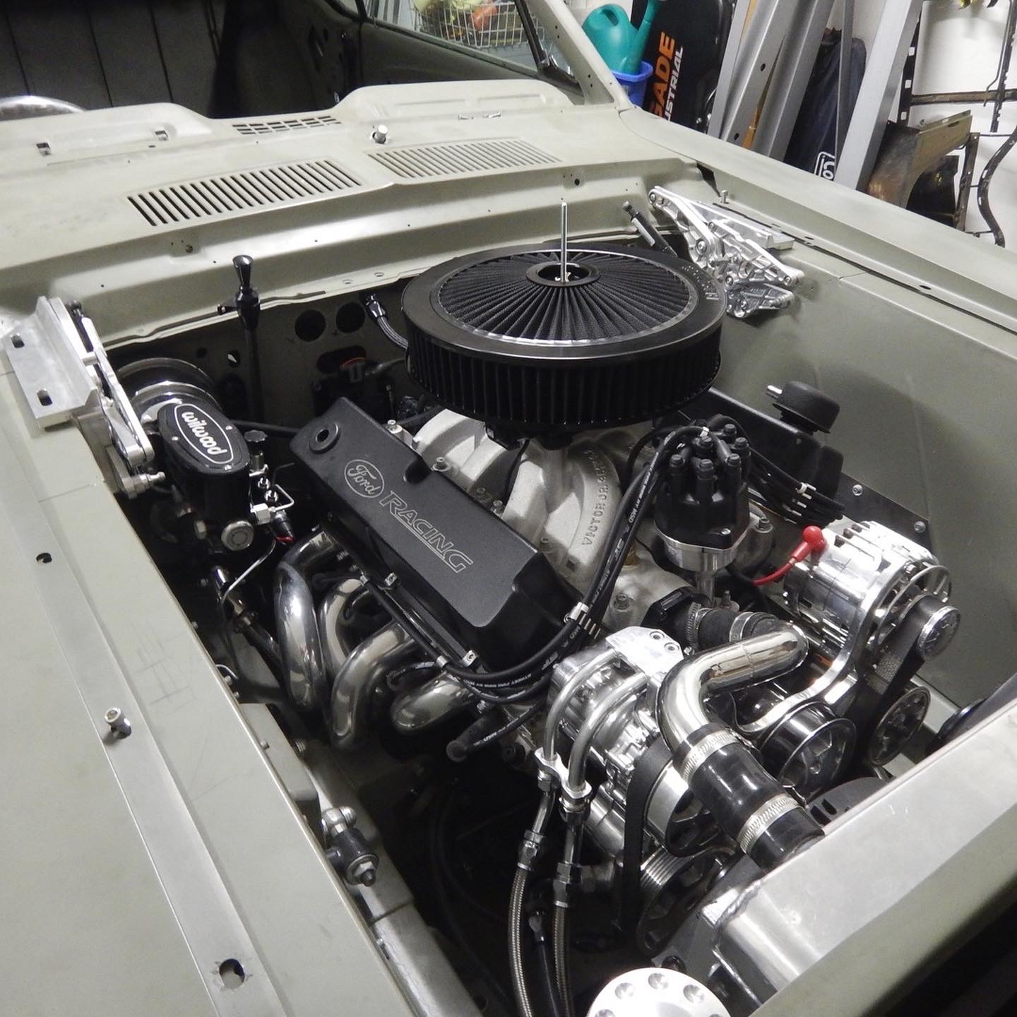

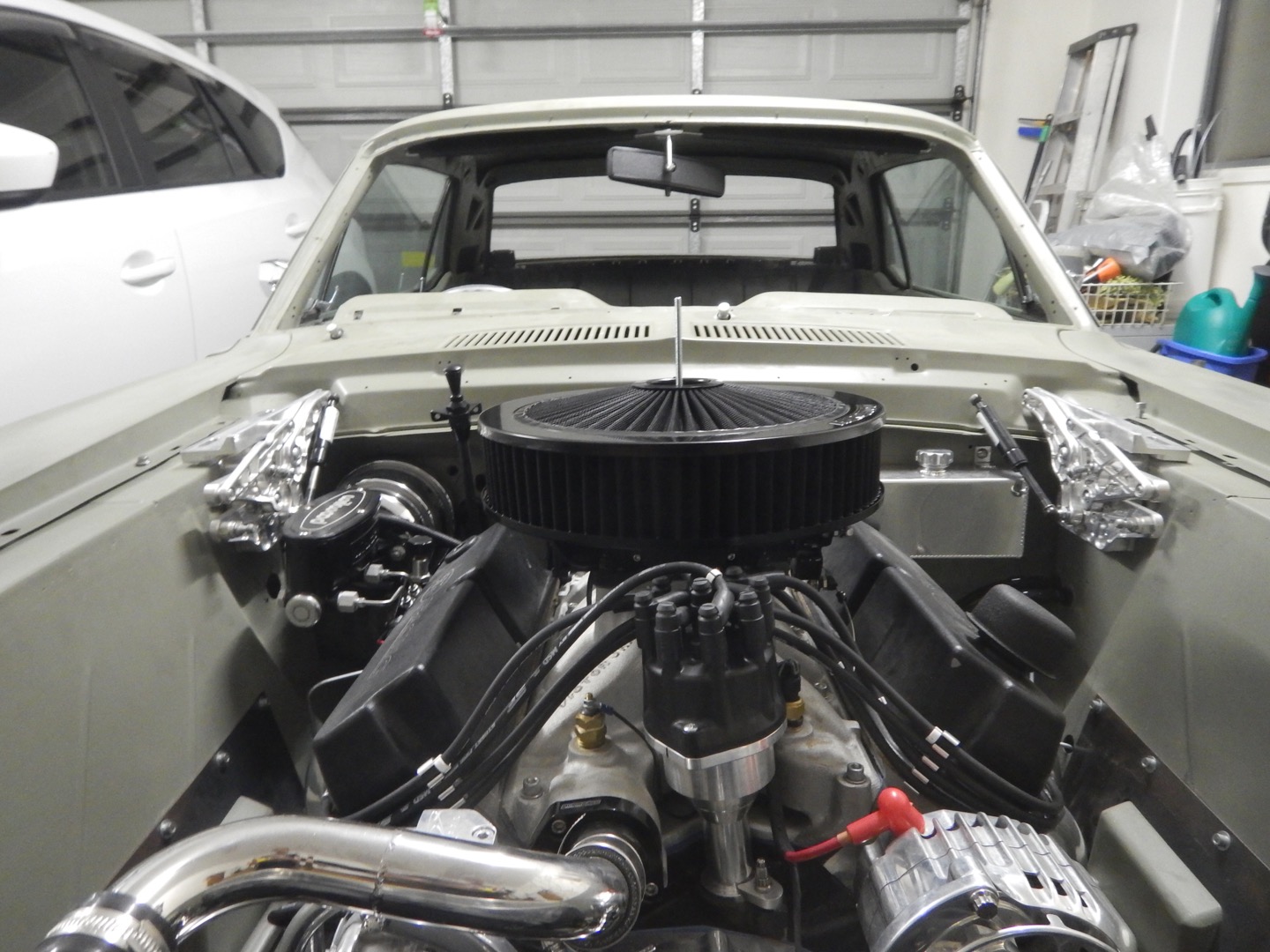

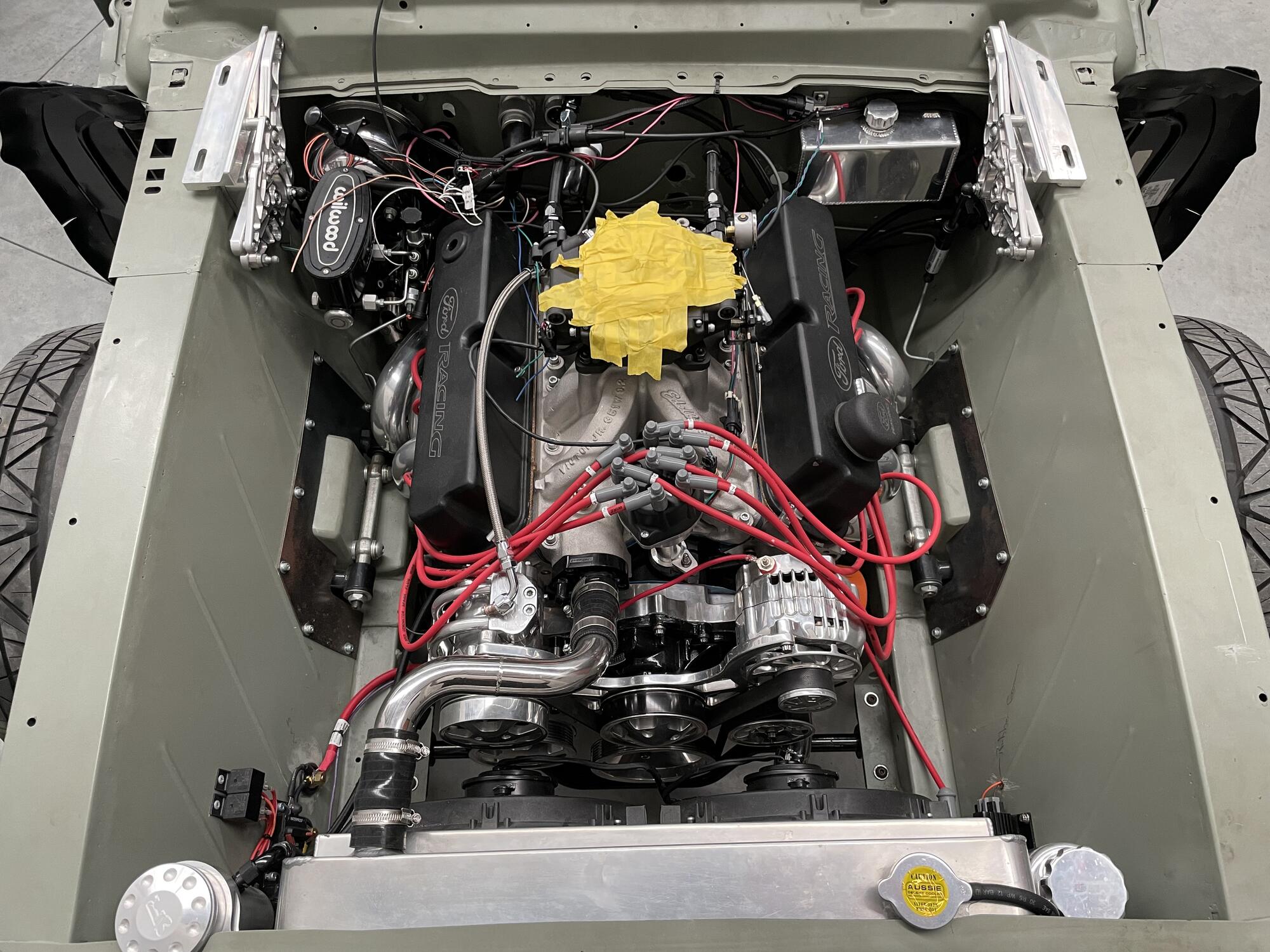

      Engine bay mock up

      Starting to tidy up wiring to be presentable
