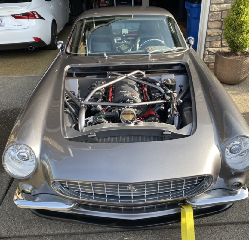

      The car went off to get the tuning done and shorten the harness. A local company, English Racing, who normally does a lot of Evo, GTR and boosted car feel that they can do the job. I wanted to get a picture of the car on the tow truck but the driver was really late. This is the best I got for now.
      Attachment 191315

      We ran into some problems. The tuner didn't like how I ran some of the wiring near the battery and wanted to redo it. We got to the point of starting the car up and noticed some metal on metal sounds. It appears that I may have an issue with my transmission, converter or pump. We are now going to have to pull the transmission which is not an easy task on this car. It requires removing the full exhaust, (including passenger header), and removal of the torque arm. I am going to go over and help him do the work since I am so familiar with the car. I hope to have it removed and replaced in a day.
      Another item that has surfaced is with the accessory drive. He noticed that the crank pulley is not quite deep enough for the belt to run straight. It is a Vintage Air Front Runner but I added a Texas Speed rotating assembly. Not sure if that would cause the problem with the crank pulley alignment (off about .2") or if the ATI balancer is not fully on. The ARP crank bolt is fully seated so I am a little confused. If anyone has a thought please speak up.
      Not the update I wanted to share but it is what it is. Time to pull the car back apart...…….

      The balancer issue may take a bit of research. I have a Texas Speed forged crank and a vintage Air front runner serpentine setup. The tuner thinks that the crank my not have the same snout as a stock LS3 crank. The ATI balancer has a steel sleeve that mounts on the crank and then the balancer mounts to that. He feels that I may need to get a new steel sleeve with more backspacing. As it is the balanced does not slide far enough back. It is mounted all the way on so that is not the issue.
      It looks like I have a couple calls to make on Monday. I hope there is a new sleeve that I can buy to fix this issue.

      It has been a long time since I have had an update. This is an update but not a good one. We ran into some issues when we started to crank the engine over to start the tuning process. We heard some grinding sound that we thought was coming form the transmission. The engine was also very difficult to turn over by hand. Because of these issues we never started the engine. We were also running into quite a few clearance problems with the transmission pan and the exhaust. This really had me questioning everything because the exhaust was prefabbed before tearing the car apart for final body and paint.
      As it turns out, the mock up transmission used was for a 5.3LS and the transmission guy is telling me that the bellhousing on my block has a different bolt pattern than the earlier LS's or maybe it is just the 5.3L engines. I am a little unsure. To top that off the mock up transmission (using the 5.3 bellhousing is about 1/2" shorter than the later style bellhousing. That was causing the transmission mount to be off, exhaust clearance problems..... To fix the situation I either have to find an aftermarket bellhousing that has the correct depth and bolt pattern or cut and weld my two bellhousing to make one that is the correct depth and has the right bolt pattern. I think we are going to go down that path since I am unsure what other clearance issues come up with an aftermarket bellhousing.
      After we pulled the transmission out and discovered the issue above we were still not able to turn over the engine. So, out it came. This is a brand mew rotating assembly (crank, rods, pistons, bearings..) from Texas Speed in my factory block that was bored out. After the pan was pulled this morning there is excessive wear on the main bearings. It looks like there is 80,000 miles on it not 8 rotations of the crank. Something is obviously wrong with the setup. It now is being taken back down to see why there is an issue. The engine builder who is also my tuner said he has had problems with TSP kits in the past with similar issues but also said we will need to make sure that the block does not need to be line bored. Seems like that should have been checked before but what do I know.
      There doesn't seem to be any damage to the crank or rods so I hope this is a simple fix. Taking the engine out was a project. Everything is so tight and if you miss a step to remove a part in the right order it makes the job impossible. So glad I didn't already charge the AC system and the other small stuff like that. So frustrated but oh well.
