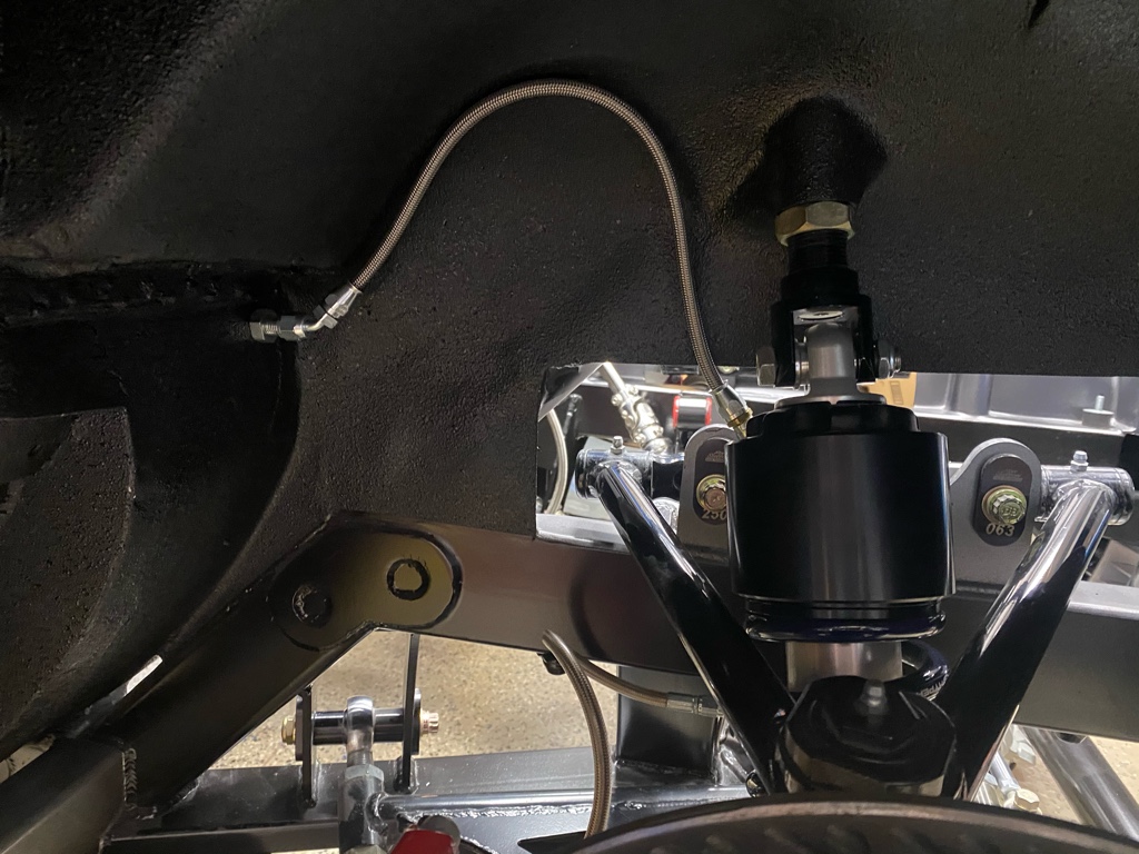

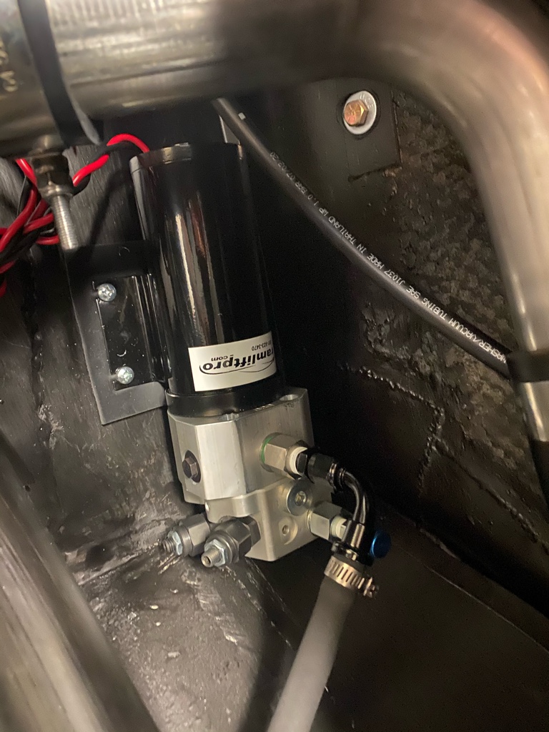

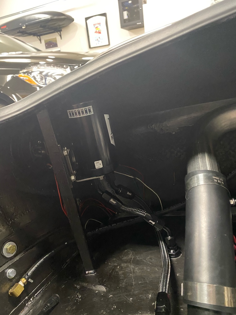

      Progress is slow lately. Seems like I have been waiting for fittings or hoses more than working on the car. I almost have the plumbing done and have started working on the wiring. Stilll need to get my new Wilwood master cylinder and larger rear calipers as well as some hose to finish plumbing the Ram Lift Pro hydraulic lift system.
      The RLP setup is pretty cool. With a push of a button I will be able to lift the nose of the car up about 2” to clear driveways or speed bumps. The pump is mounted in the trunk since there is no space in the front of the car.

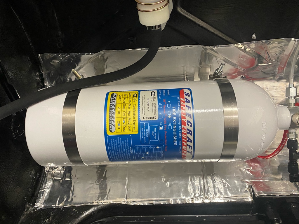

      I also installed the Safecraft fire suppression system.

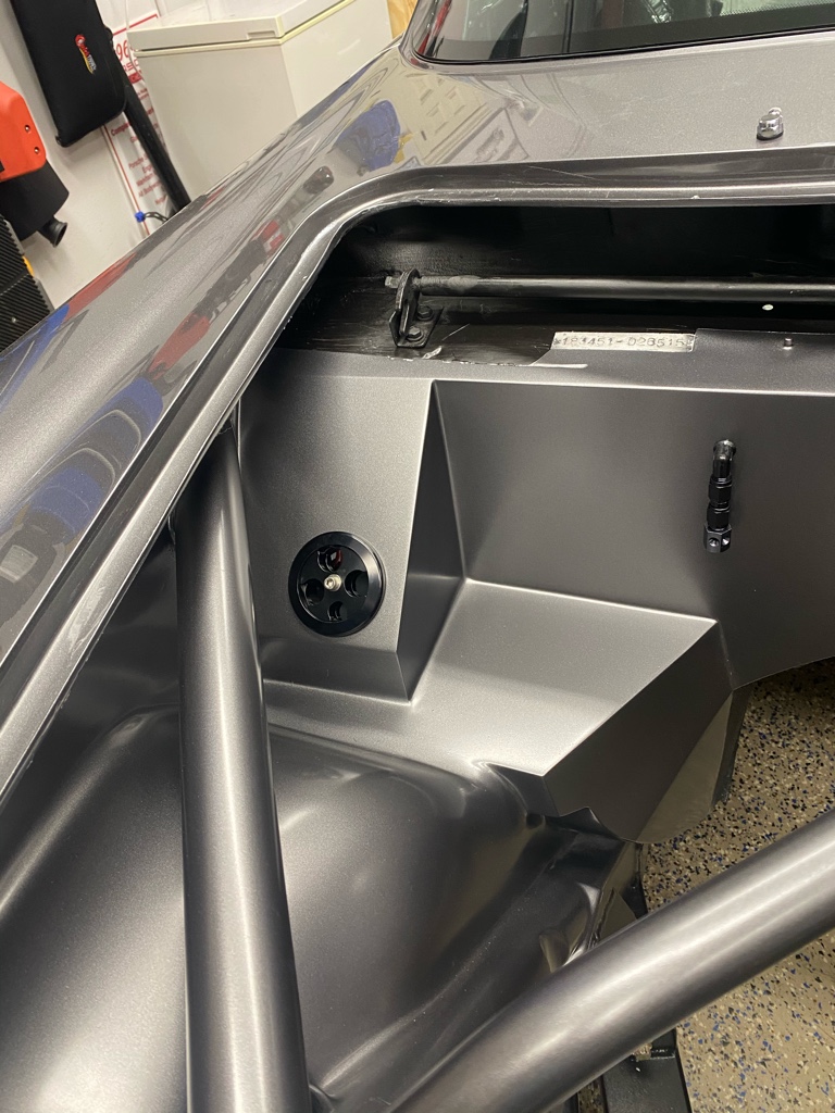

      The IIMuch fuel vent and bulkhead connectors are installed.

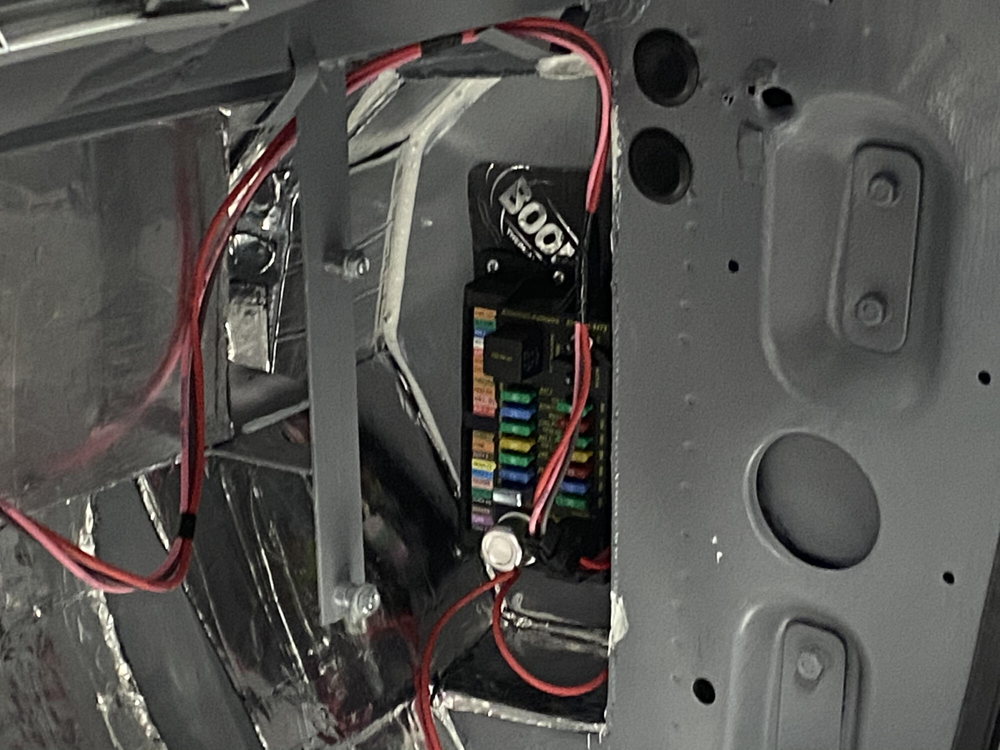

      And now I am beginning the process of installing the American Autowire harness.
