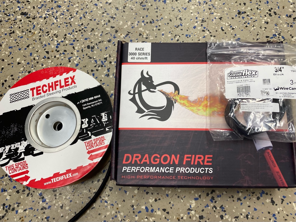

      I received my samples in from TechFlex. I ordered some Insultherm and Insultherm Tru-Fit. The product will go on my spark plug wires. I ended up going with the Tru-Fit. It was a little smoother looking and slightly easier to work with. I ordered the 0 gauge which should expand over my wires and have a little extra capacity. The sample I ordered was for 3/8" and was a little loose fitting. The plug wire diameter was .32" so slight smaller than 3/8". I believe they will help protect the plug wires up to 1,200 degrees. I ordered some more shrink wrap to seal up the ends of the wrap and make a clean look.
      https://www.techflex.com/high-temper...ltherm-tru-fit

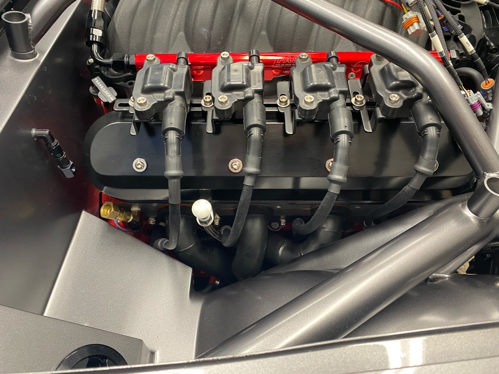

      I finished up on the plug wires today. The are Dragon Fire wires with Flextech heat shield. I chose the Dragon Fire wires because I needed 45 degree boots on the plugs and that are the only ones I could find. I hope they are good.
      In the picture you can also see the adapters for my temperature gauge. I think I will take it off and paint it all black. I hope that will make it disappear a little more.
