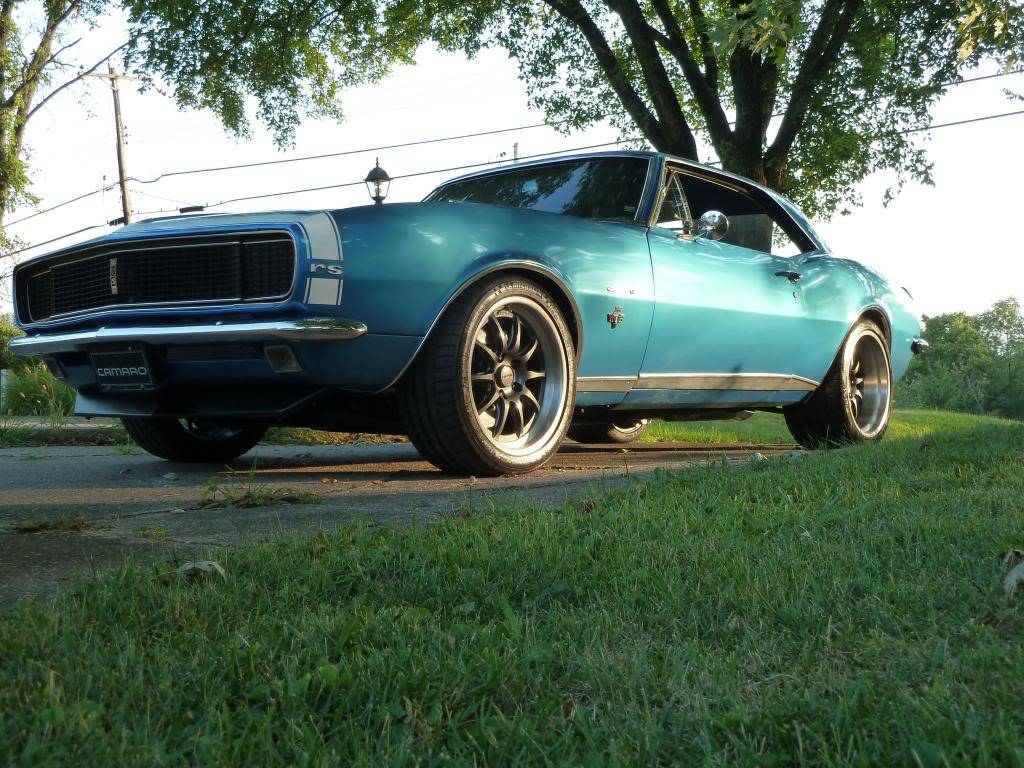

      At least you are getting to use your car. Mine just got on the road last weekend and I am also ironing out the bugs.
      Here is how she looks

      Wow Jim! It looks amazing! I'm happy for you to get it on the road! How's that rear axle working out for you so far? I don't get to use mine as much as I'd like. I'm not driving it much until I can get the more pronounced issues addressed (vibrations and noises that shouldn't be there).

      The rear axle is working perfectly. No vibrations at all. I noticed the four link does transfer some sound though. There is some singing at cruise throttle but none under load or deceleration. I really like the look 2 inches of narrowing each side made.

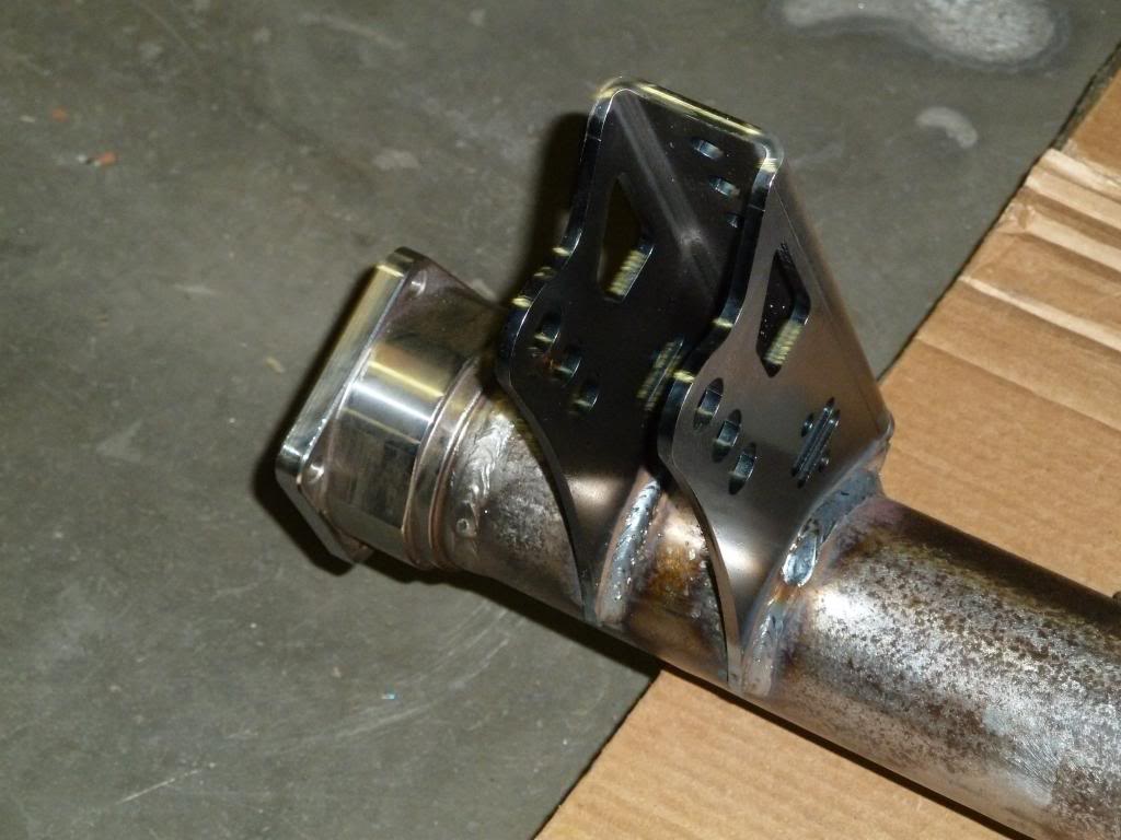

      Gosh Geoff, I wish it was skill. You know how long on here I looked for advice..lol I have been in fab work most of my life so I do have a bunch of equipment to use. Makes it nice. But if I had it to do over, I might just go with a complete Moser unit. If I calculate the time and effort (cursing), the cost savings was a wash. I was hoping to make the RTTH but I am still working on the front end. Just about got it right. I am hoping my brother wants to run his 67 F100 too. He went with me for the MWMC last year.

      Quick question, when mounting the 4 link, does it use the factory leaf spring perches or did you use new weld on perches? The reason I ask is that the factory perch location doesn't leave a whole lot of room between the outside edge of the factory perch and the housing flange for narrowing the rearend. Looks like maybe 1" at most. I am thinking about adding ford ends to the existing housing to eliminate the c- clips and thought maybe I would narrow it at the same time since we have to cut the old ends off any way. Any advice you can provide is appreciated.

      Yes the lower link bar uses the front leaf spring mount. As far as I know pretty much all of the aftermarket suspension kits use this for their lower link. It doesn't appear to be a problem to get 335's to fit with the right tub setup. I think some of the companies even make a special lower link bar to get additional clearance for 345's but don't quote me on that.

      32, The spring perch that comes with the Ride Tech kit uses the stock differential mount, but I believe will not allow as much in the way of narrowing of the rear and brake clearance. You will have to check with them. I narrowed mine 2 inches per side and used the weld in mount they supply, which eliminates the stock spring perches on the diff. I set the width of those by measuring the distance between the front mounting points of he lower links keeping them perfectly parallel when mounting the differential brackets. The lower links in the RT kit utilize an offset to allow for better tire clearance.

      You've got some skills there Jim! I love looking at your welds! Thanks for chiming in!
