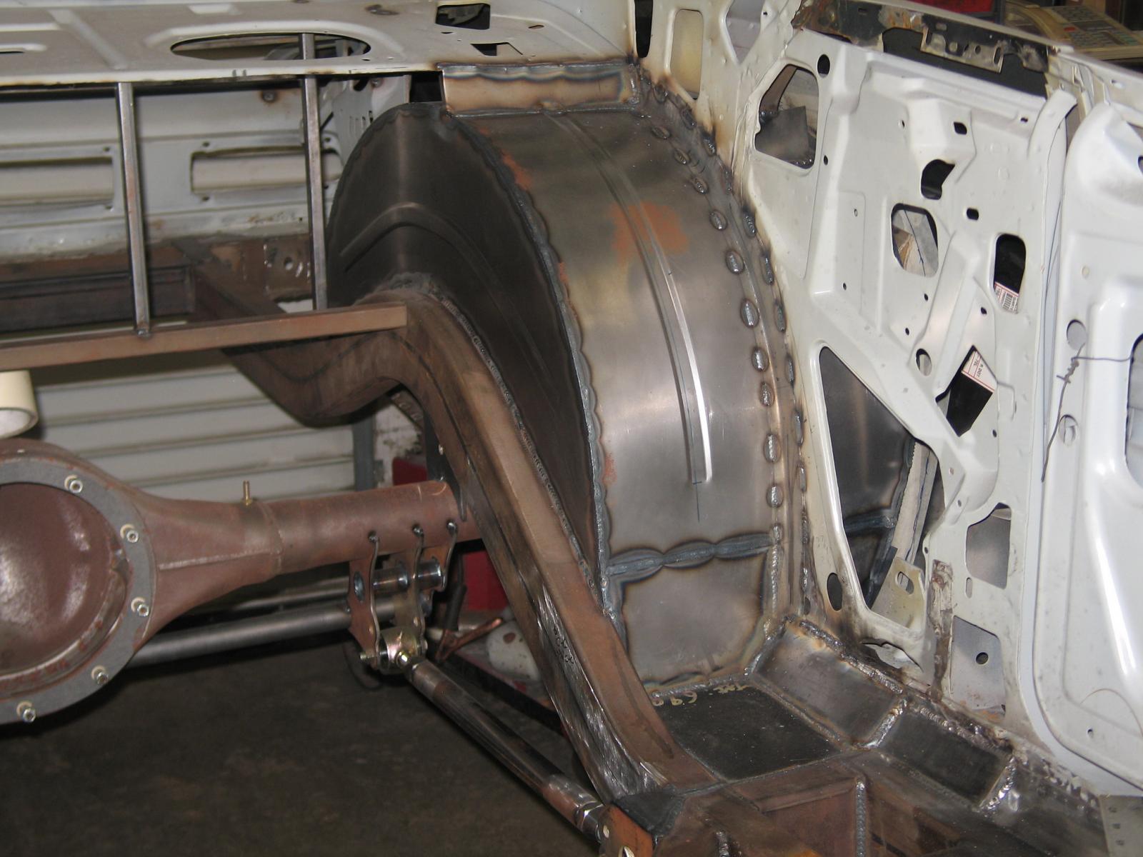

      I have the tubs finished now and roughed in the wheel opening lips. The tubb extension (lower,front) is made of 16 ga.-it ties the chassis to the back of the 'B' pillar.

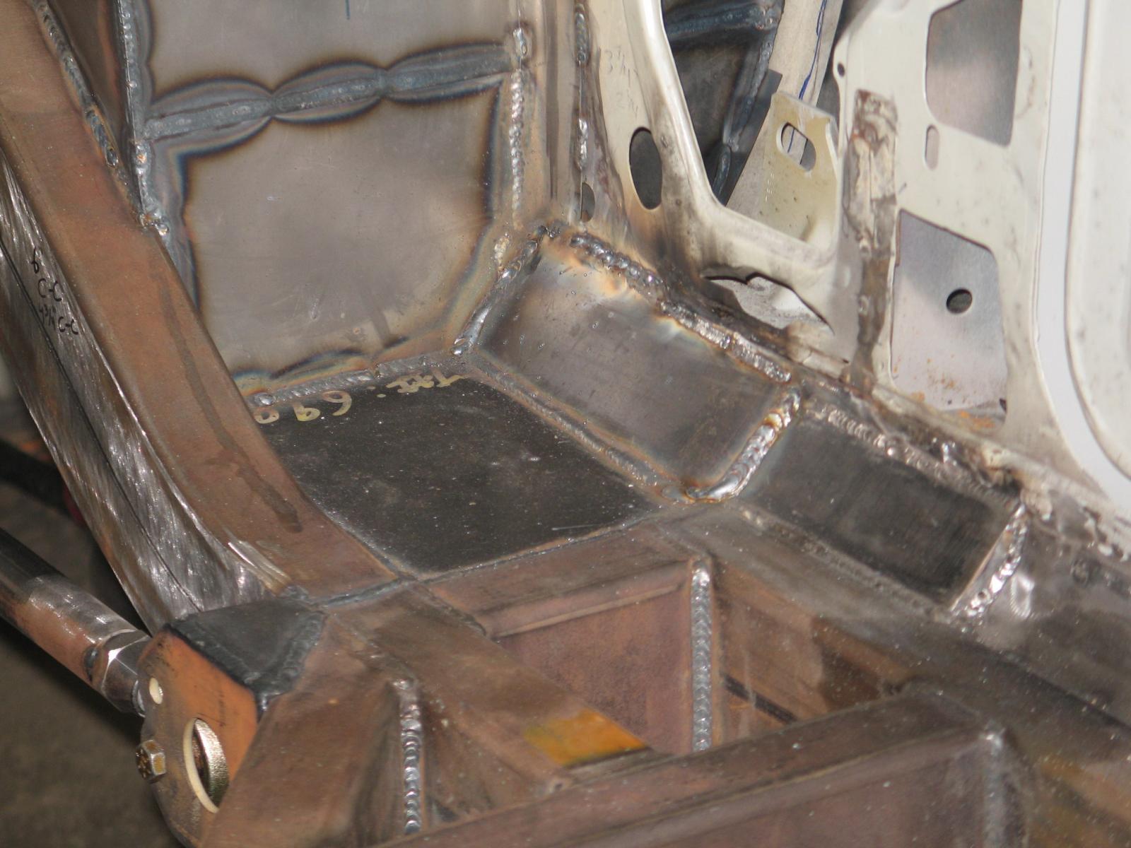

      On the inside the flat plate floor piece is 1/8" steel. this acts as a gusset from the rear rail out to the rocker rail, braces the lower link mount, and is the floor. I pitty the fool who t-bones the challenger.

      Two stepped braces join the rocker rail and rear floor plate up to the 'B' pillar. They are 1/8" steel.

      A look at the hinge brace attached to the wheel tubs.

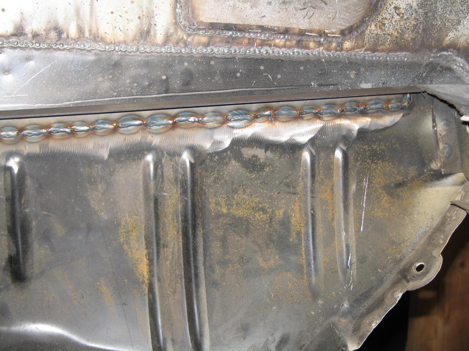

      I use a lot of 'trim rails' when building floors. 1/2" x 1/2" 18 ga angle. This helps define the new floor height.

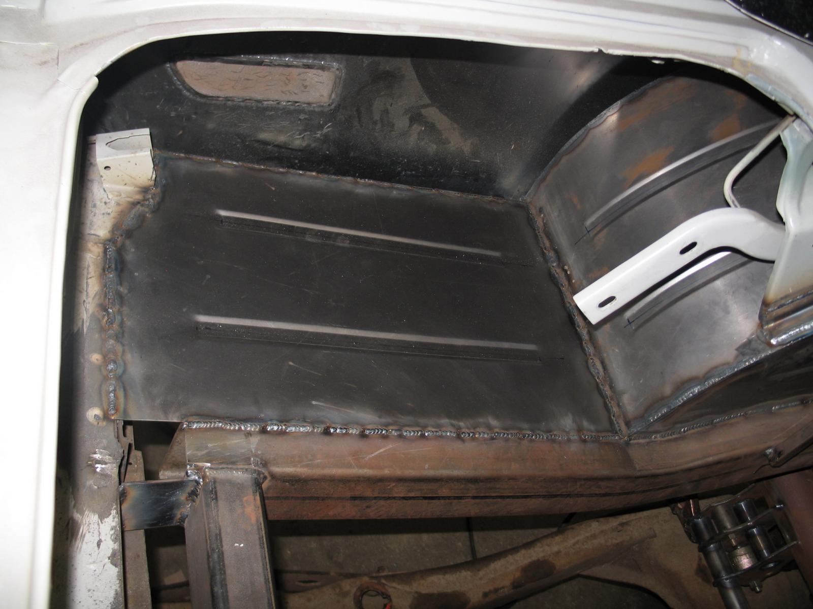

      Passenger Rear floor dropped in.

      Drivers side finished

      Passenger side finished
