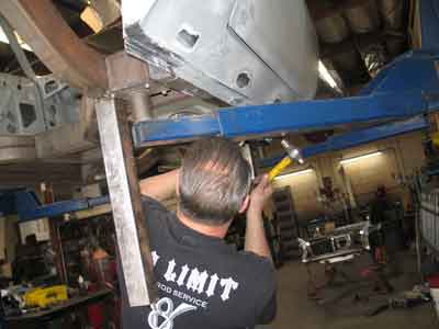

      Owen fitting in the rocker edges

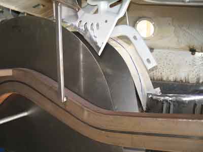

      Looking Down the Rocker-Frame Rail
