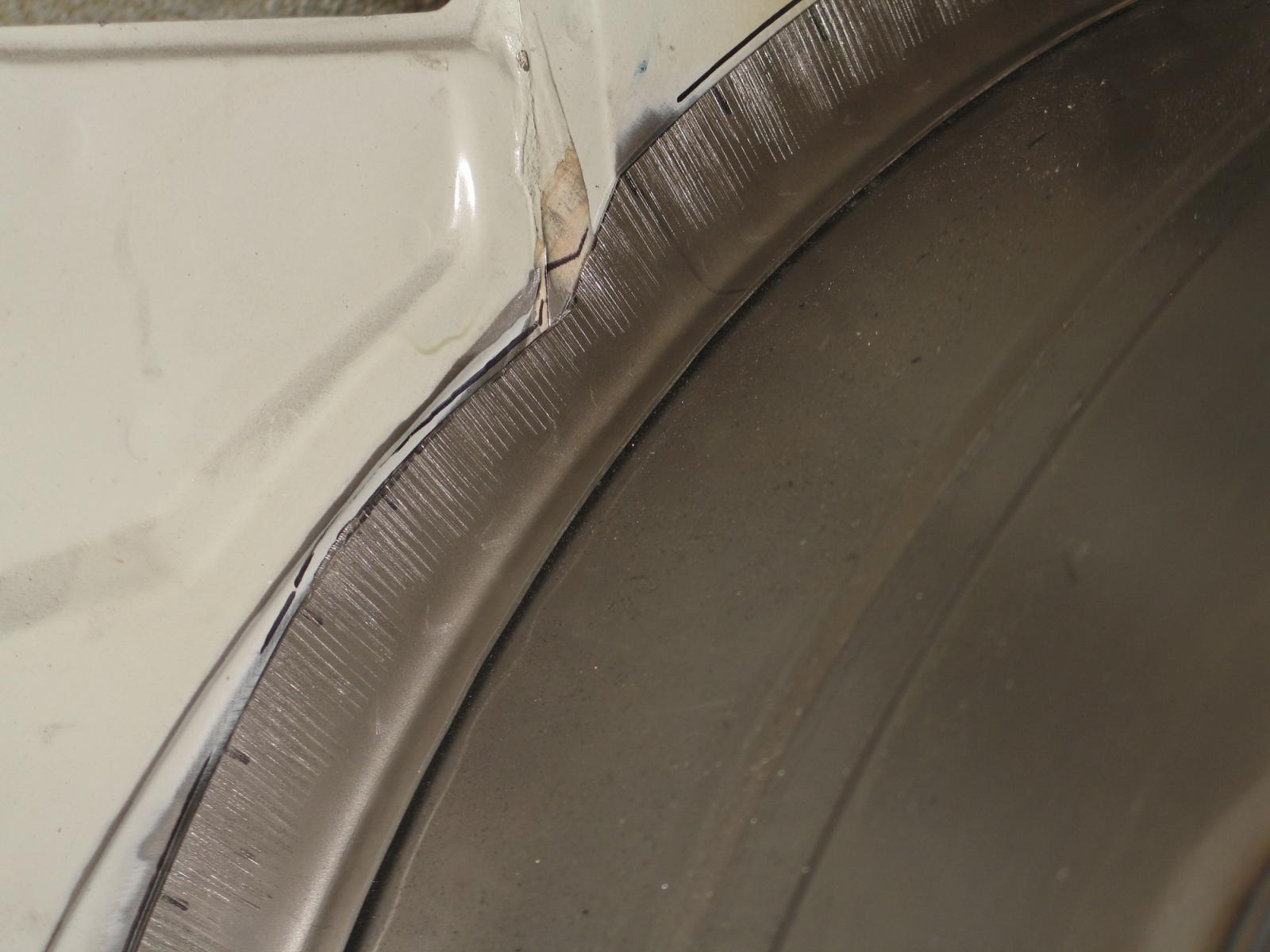

      With the tubs welded in place, it's time to start trimmimg them in. What you can't see is the original inner roof brace. I started there, and attached it down to the new tubs.

      This will be a front side trimmer. 18 GA 1 1/8 wide, formed 90 @ 1/2" in. Notice the marks down the edge every inch. This makes forming a lot easier.

      Forming the front trimmer using a stretcher. This took about 30 min to fit in per side.

      Once the trimmer fits all around it's time to install it. The back side is sprayed with rust-o-leum along with the tubb tops. Then the welding starts, this approach will follow all around the tubbs.

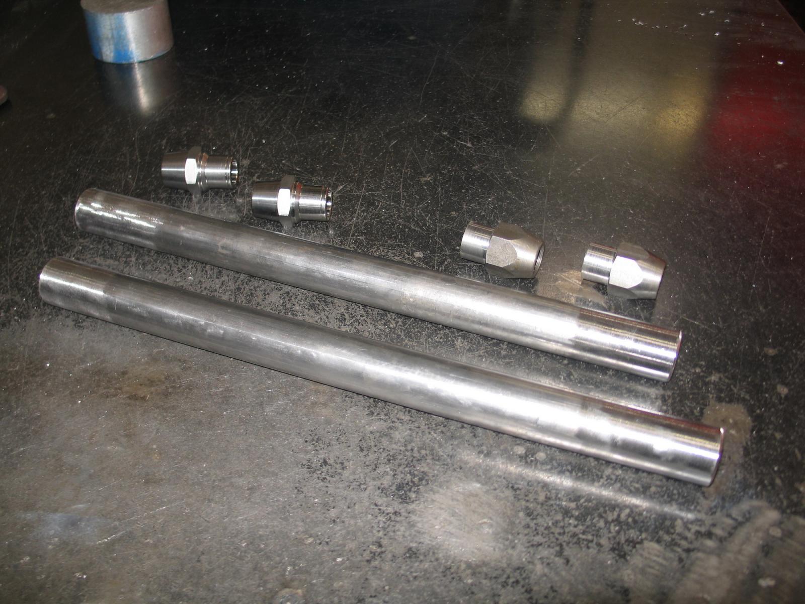

      Here are the lower bar parts. The tube inserts on the right are mine-No Limit Parts. The ones on the left are from "The Chassis Shop"-really nice-L.H. tread. You know the really cool ones you see-nice, smooth, and tapered down that you weld in and smooth off-well, they suck. You WILL need to put a wrench on these, and if your bar is all smooth then I guess you use chanell locks or vise grips. Plan ahead use hex inserts

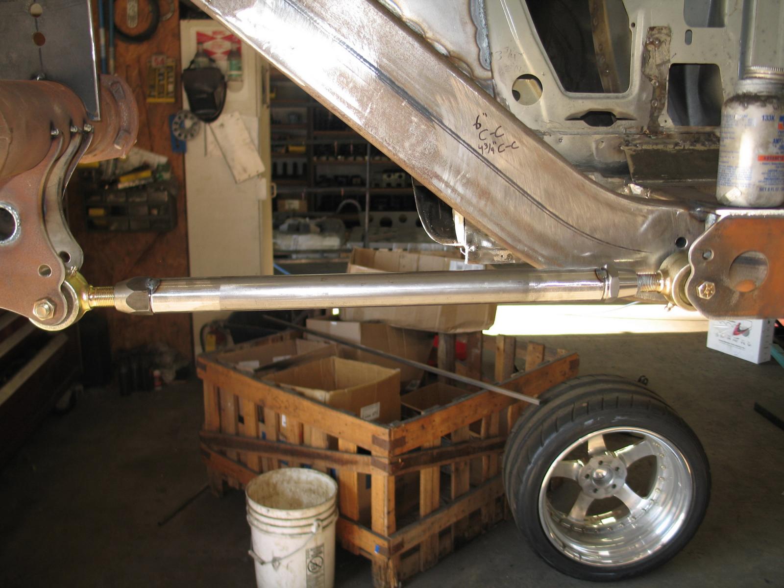

      Here is a look at the lower bars. Yes-I will use jam nuts during assembly. LOL Looking at this picture makes me realize it's time to clean the shop.
      Hi Rob, do/can you sell these not threaded?

      no, the ones I have made in hex stock are all threaded 3/4-16 RH. I have tham done at a local job shop in batches of apx 400 pts, so it's tough to make get them any other way unless i want big numbers.
