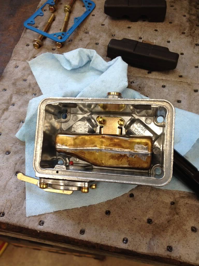

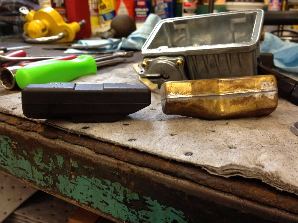

      First thing I have done recently is replace my stock floats with some wedged Nitrophyl units from Holley. These are lighter than stock and the wedged sides are supposed to push the fuel toward the center of the fuel bowl under hard cornering. I was having some throttle hesitation in the autox so I figuered I would try these...and they worked!!!!!

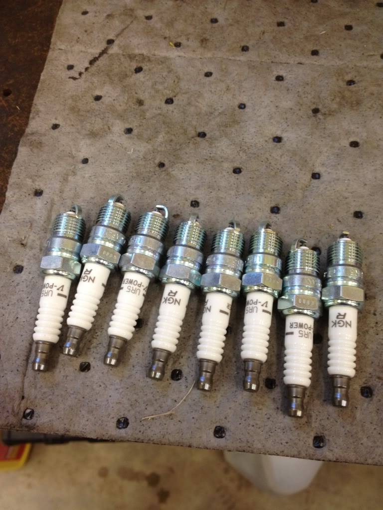

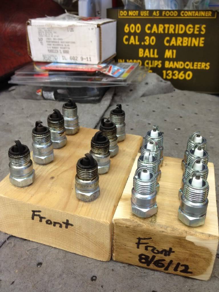

      I also put some new NGK UR5 plugs in too....
      Old vs new......I want to check these in about a month to see what they look like with the new MSD ignition.

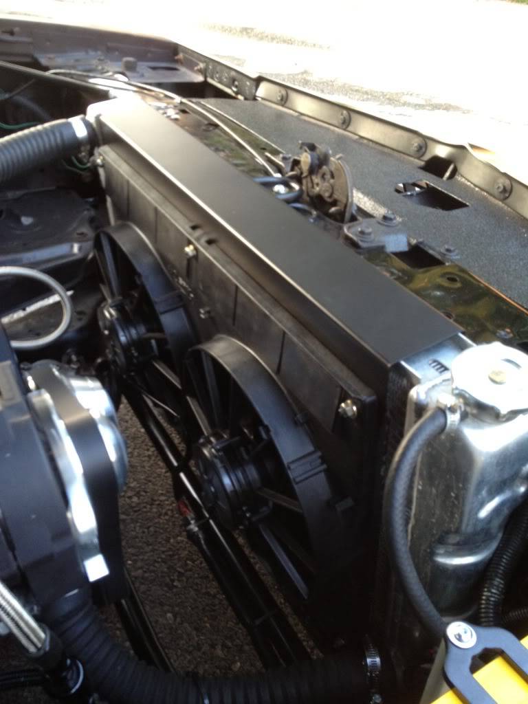

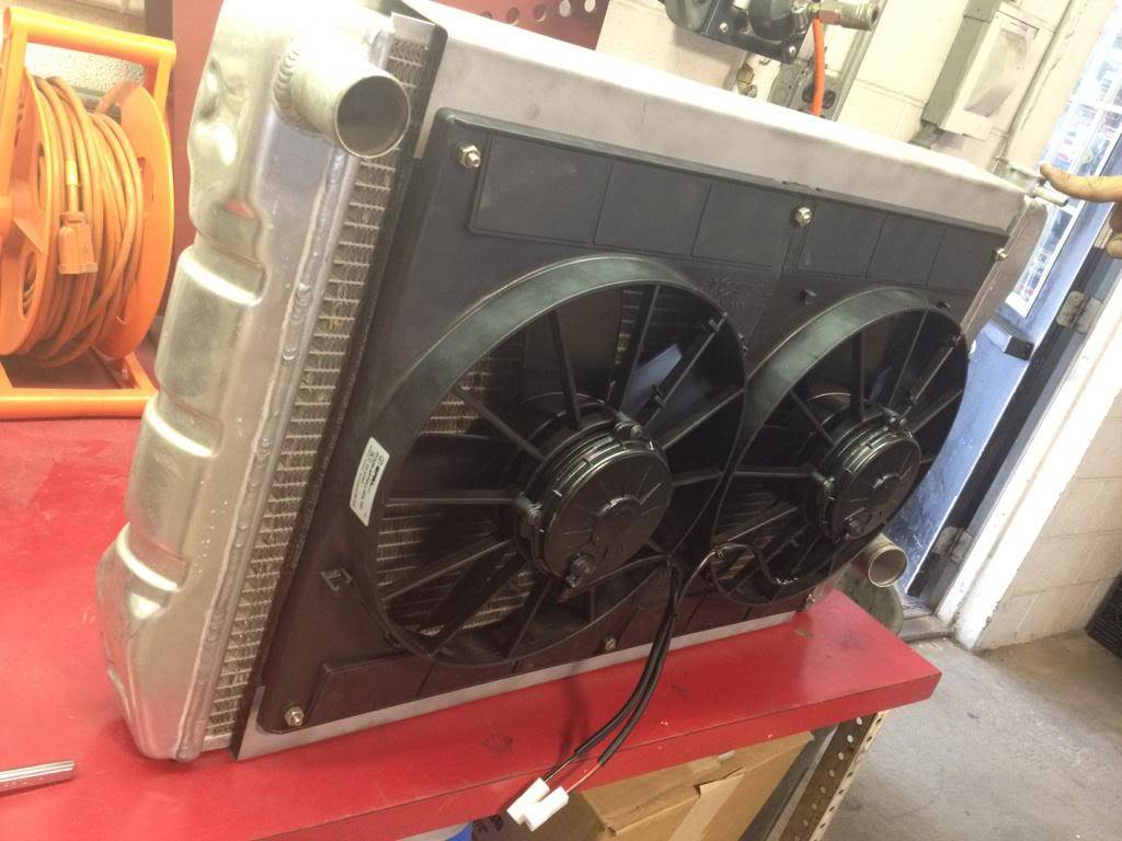

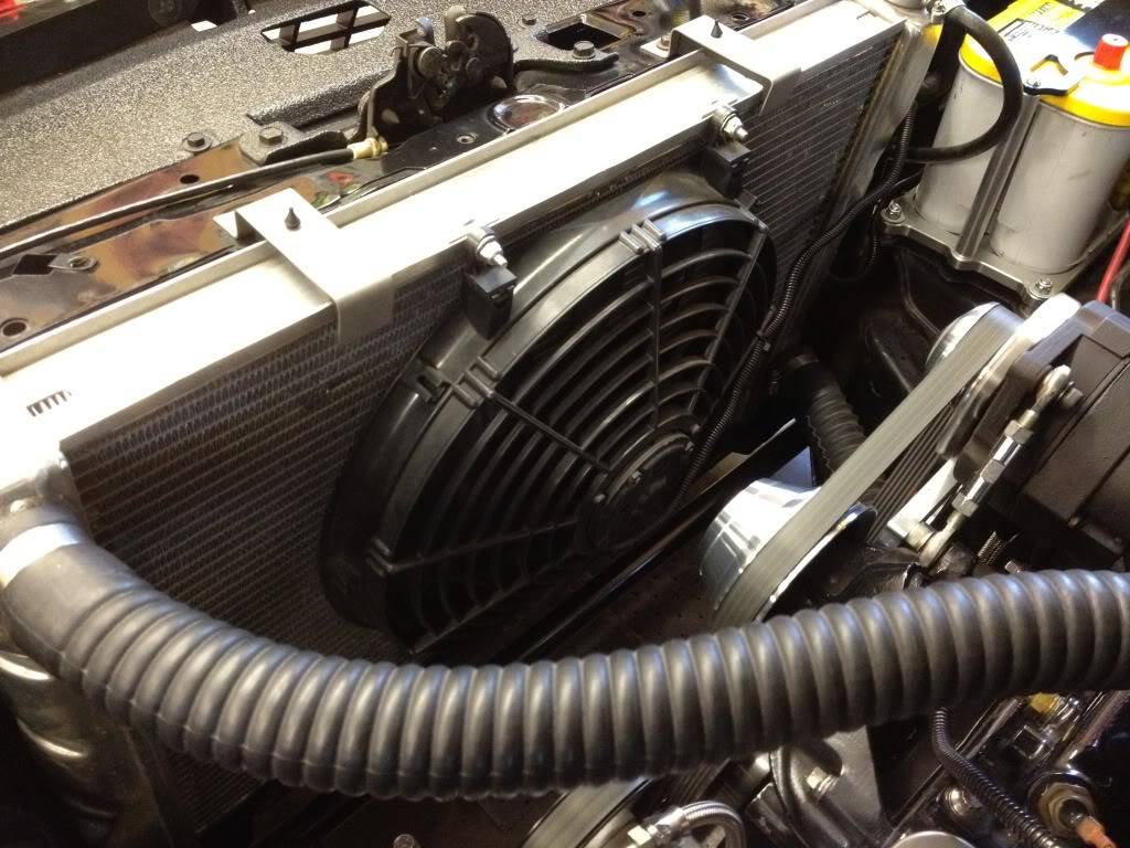

      My car was getting hot pretty bad since I installed the huge x huge trans cooler in front of the radiator. The outside air flow was prety much cut in half.
      This is what I used to have...
      This is what I had GForce Design Concepts put in there!!! It's the same Griffin radiator, just the new SPAL dual 11" fans and the mount they made.
      In the car...and this thing hits 180...turns on and goes right down to 165. Perfect.

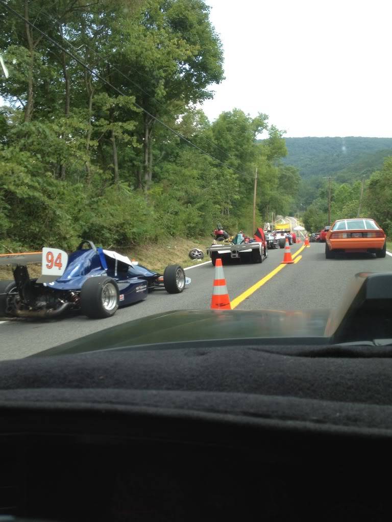

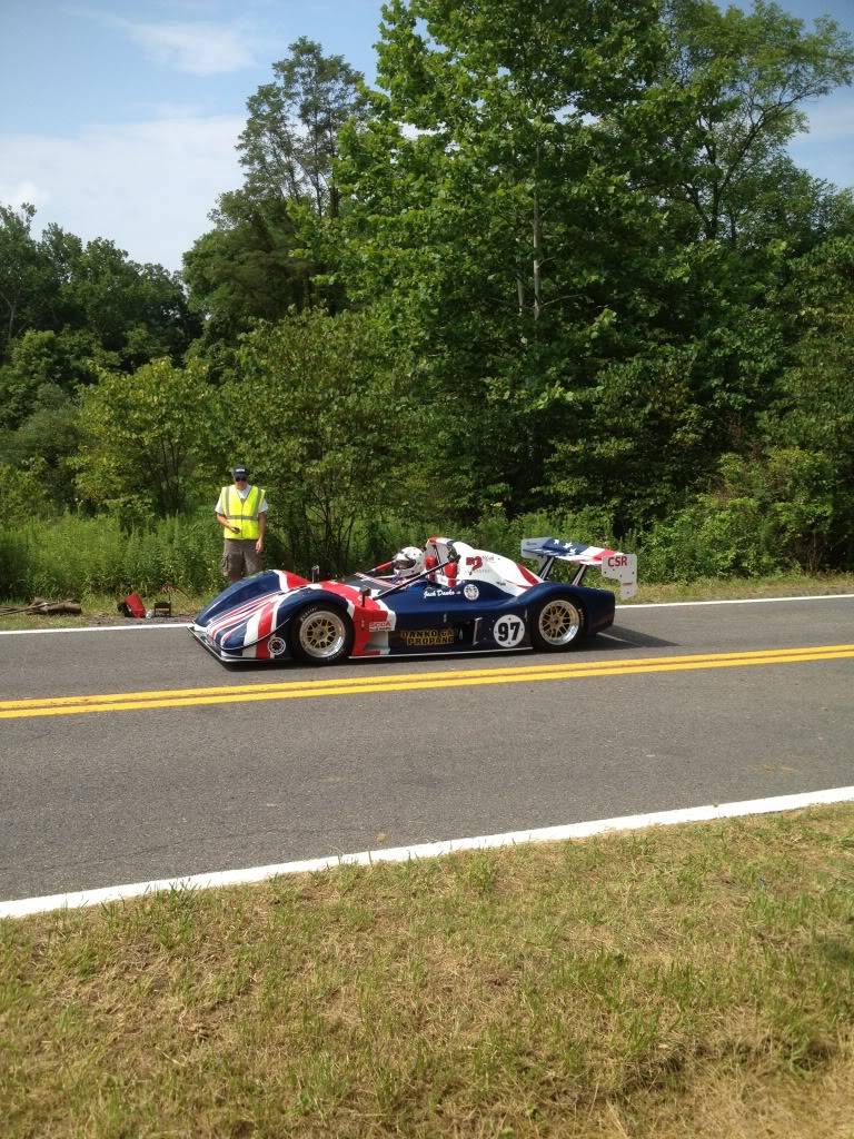

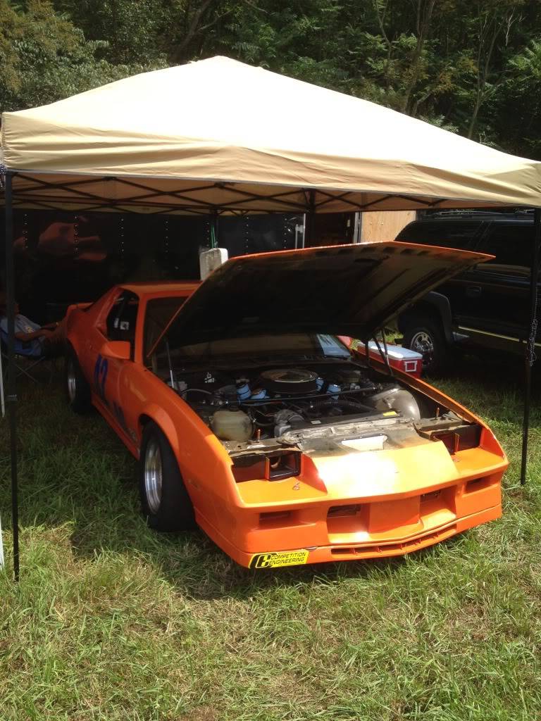

      Polish Mountain Hill Climb 8/4/12: This was a SCCA/PHA sanctioned event and was held on 8/4/12 in Flintstone Maryland. This was a hill climb event on a closed off paved two lane road up the mountain. There was no runoff area, just a 5 foot ditch and either a cliff or trees. It was by far the most challenging racing I have done up to that point. I had six runs and decreased my time by a total of 6 seconds throughout the day. This is now going to be a yearly event for me!!!
      Heres the link to my photobucket page: http://s212.photobucket.com/albums/c...hMountain2012/
      It was soooooo hot in the helmet, fire suit and gloves!!!
      Douglas Lutes
      1988 Monte Carlo SS

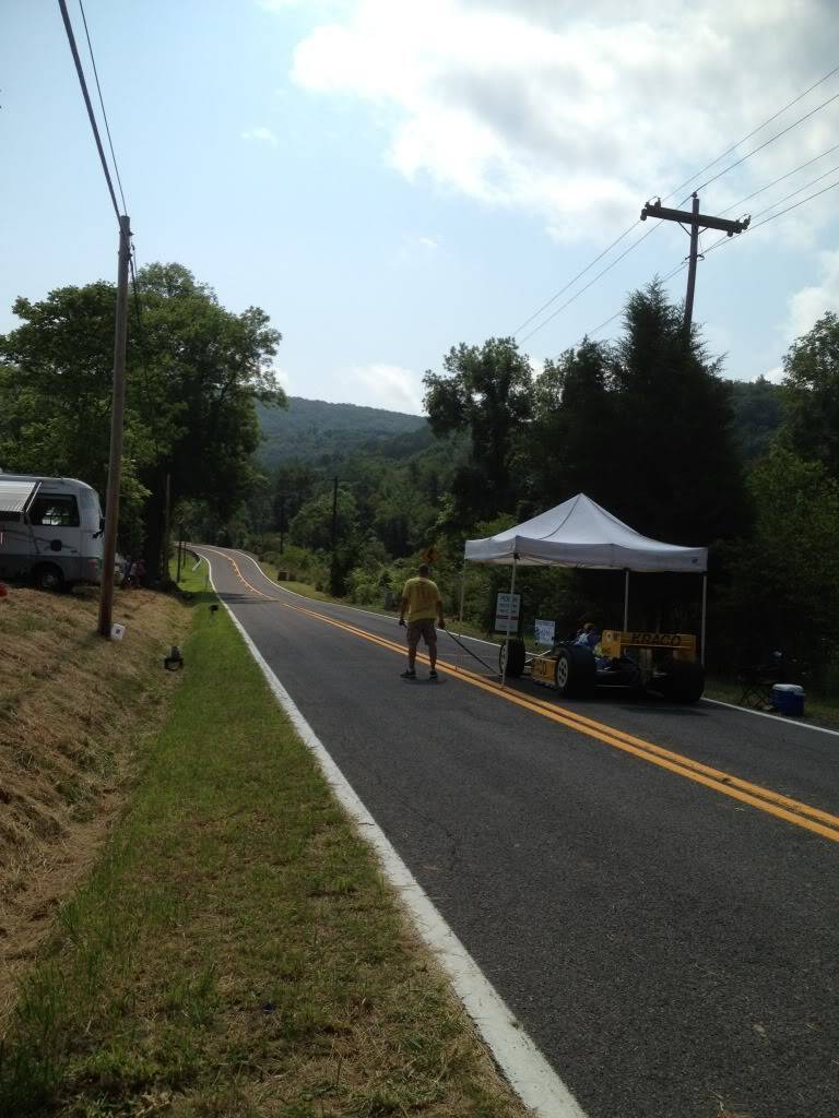

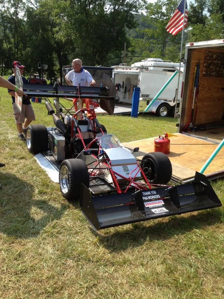

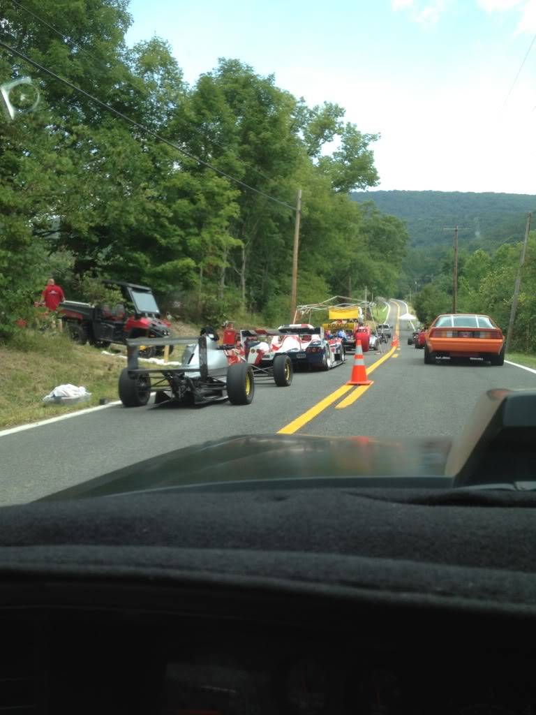

      Starting line and turn one in the distance...

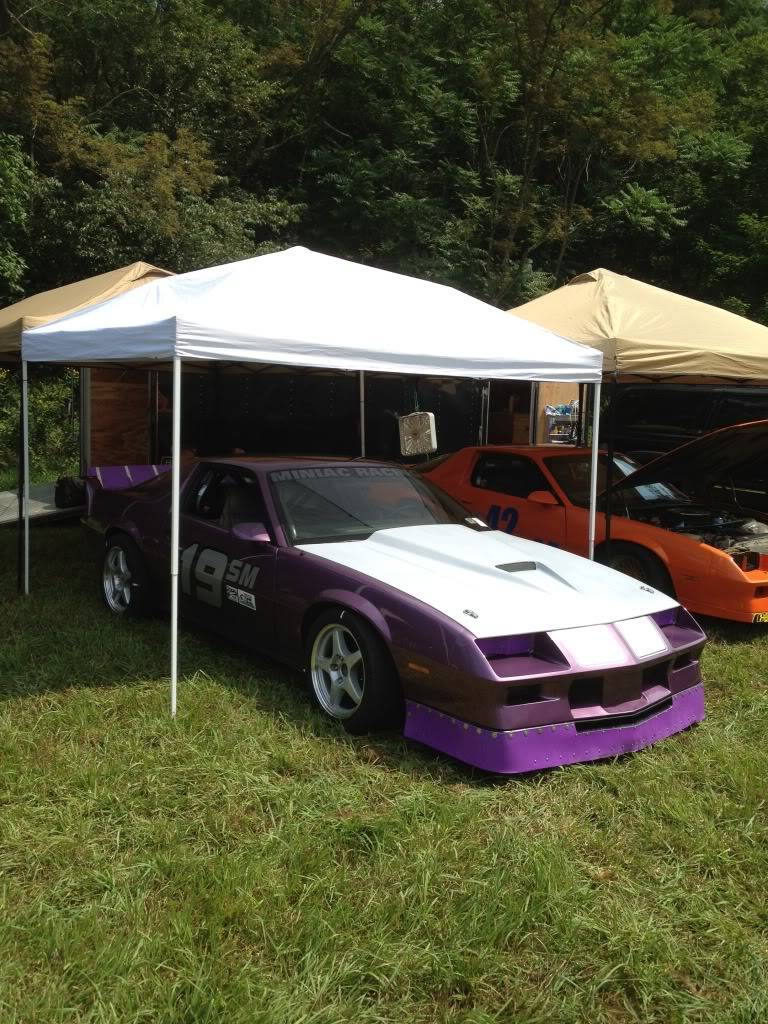

      My pit area
      Douglas Lutes

      View from the top of the moutain going down the return road.
      Heading back into the pits.
