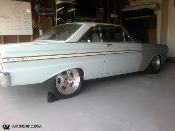

      Now I am trying to get this ride height:

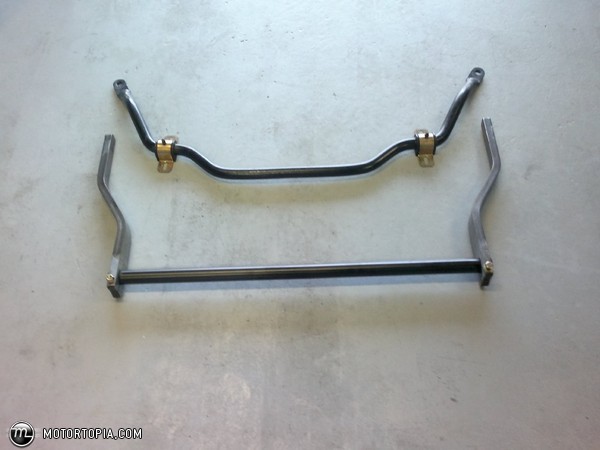

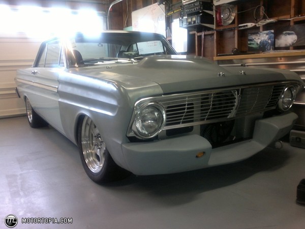

      Now time for upgrades:

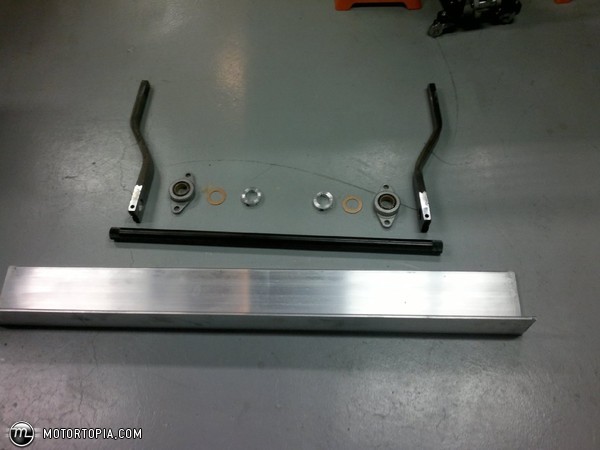

      The new bar is twice the siffness and the same weight. But I will be cutting the arms off shorter and adding speed holes. I ordered the 32" bar, 1.25" OD and 3/16" wall thickness. The old bar was a solid 1.125" OD. The 32" bar is the shortest bar available from speedway engineering but they will cut and re-spline any off the shelf bar for an aditional 40 bucks. That is very reasonable. An advantage of the shorter bar, the shorter the bar the stiffer the bar and the lighter the bar.
      Now just to make it fit!
      Right now the K-strut bar the frame and the sway bar want to occupy the same space. Somthing will have to move!
      I ordered the arms splined and prebent with a 3.25" offset. It lines up perfect with my previously welded sway bar end link mounts on my LCA.

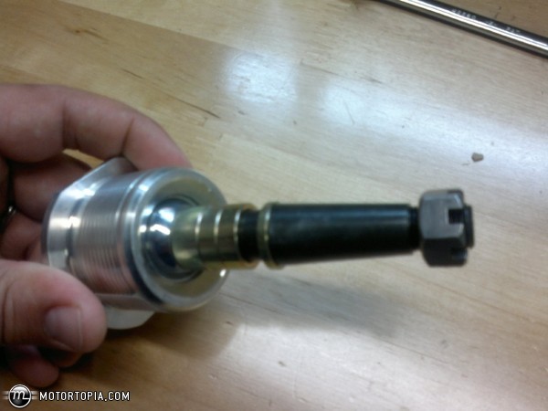

      I have been sick for the last week, but I was still able to order parts.

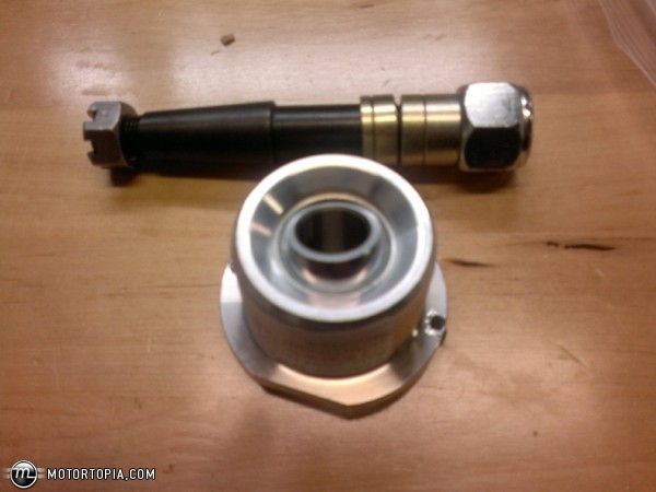

      These are aluminum hosing ball joints that will thread into my upper and lower control arms. This should give me a better, more precise pivot point. It also allows me to adjust my suspension. Add or remove shims from the LCA and raise/lower the car. Add or remove shims from the UCA and adjust camber gain. Also I can adjust roll center at the same time.

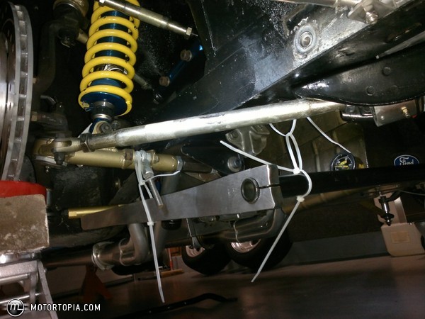

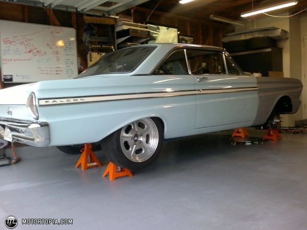

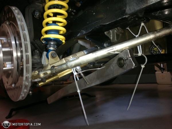

      Mocked up the sway bar with a very quick and efficient way to locate the bar and arms. looks hokey in pictures though.
      Ride heigtht:
      Bump:
      Droop:

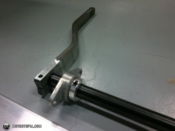

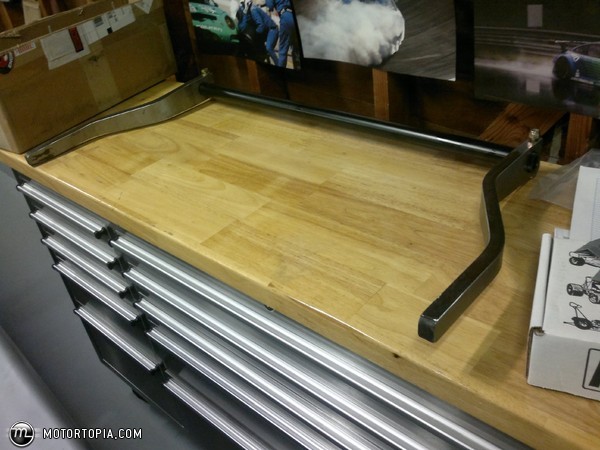

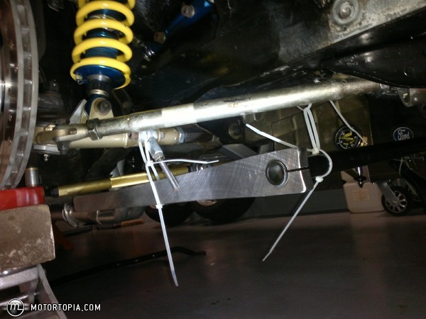

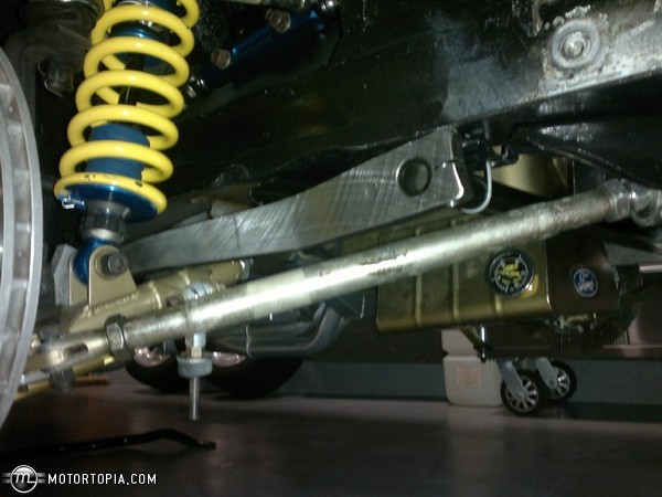

      A couple more pics as I slowly put the sway bar in:
