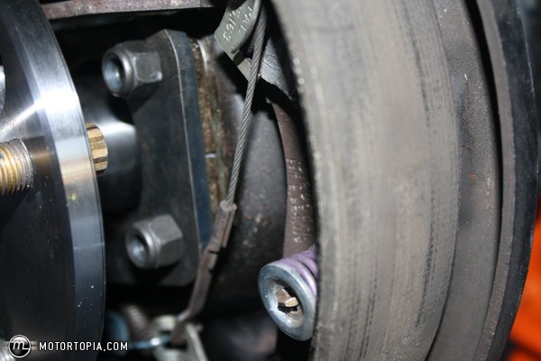

      Off to modify some axle retainers. I will be using a combo of currie and mark williams. I will post some pics when I am done. I will also have to modify the brakes to fit the thicker axle retainers.
      Im also planning a switch to a fuel cell in the near future.
    15. #1395
      san diego
      5,101

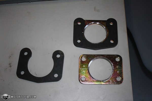

      I finished the axle retainers. I just need some longer bolts, that I will pick up at my hardware store tomorrow morning.

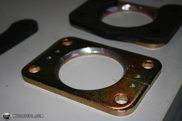

      I used the currie 360 degree plates that had a smaller ID than moser or mark williams. I cut the plates in half along the horizontal centerline. This was so that I did not half to press the bearings off and on. The ID of the bearing outer race is 2.485" the currie retainer plate ID is 2.25" I had to bevel the ID of the retainer plate so that it would not make contact with the polymer seal on the bearing. I am then backing up the Currie plates with the mark williams plates. Both are 1/4" thick.
      I marked the plates as a matching pair after I cut them in half.
      Installed with the short stock fasteners.

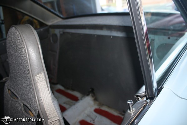

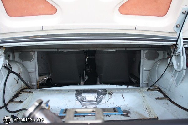

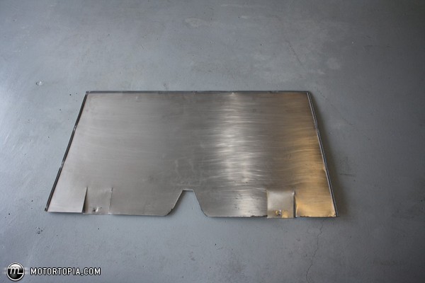

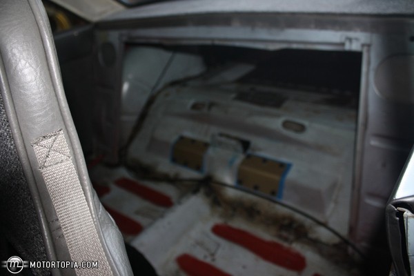

      Here are some pictures of my firewall/trunk separator. Its aluminum and matches the NHRA firewall requirement. I just finished this up today.
      Before:
      Firewall with rubber weather strip along the edges to prevent rattling:
      After:
