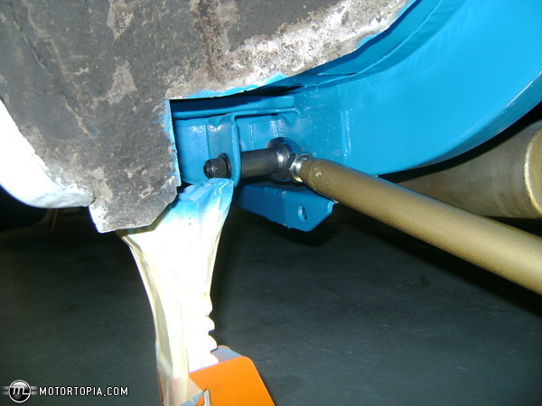

      im sure you know but just to be safe we/you need to make two mounts see ya sat.
      john
      BUILD LINK
      san diego
      5,101
      Quote Originally Posted by johnny68 View Post
      john
      HAHA, no worries I figured you have two rear brakes!

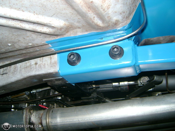

      Is anyone running any type of subframe connector on your falcons? When I removed the stock export brace install the new adjustable piece I noticed it was under a little tension once I finally got it the break free. Just tells me how floppy my car is, and the less the body moves the better the suspension can do it's job. Nice videos Bryce, gotta feel good to get out and drive. later...
      Badbird here is a link to my thread. There should be some pics of the subframe connectors I built.

      Quote Originally Posted by Badbird1963 View Post
      I have heidts bolt on SFC's. This goes with the theme of the car. Everything has been bolt on so far. I can remove my shock tower braces and I have no movement, so they are easy to put back in.... I credit that to my aluminum radiator core support that is much stiffer than stock.

      Quote Originally Posted by fordsbyjay View Post
      https://www.pro-touring.com/showthre...uot&highlight=
      Jason, your weld in through the floor SFC is a lot better than a bolt in style. I still have great torsional stiffness with my bolt in ones. The bolt in ones need to be heavier than weld thru floor SFC to achieve similar stiffness.

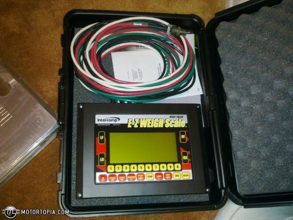

      Here is my b-day present!
      We are having a scales part on saturday! Bring some food or drink and we will weigh your car. haha.

      Bryce, do you have a pic of the bolt in subframe connectors. I like bolt in rather than weld in, I just don't want to cut up the wagon to install the by far superior x-bracing along the floor.
      san diego
      5,101
      Here are the pics I have right now. I will get more later.
