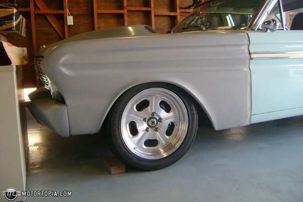

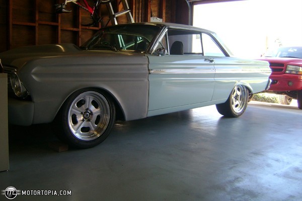

      I was bored last night and wanted to play in the garage. I lowered the Falcon another 2" in the front. Most of the front tire is tucked under the fender. I lowered the back 3/4". No rubbing on the first test drive. So that was promising. It looks a little bit better. I will take a picture tonight.
    16. #1136
      Texan Back in Texas!
      675
      Excited to see the "dropped" pics. Especially with the 17" wheels
      1965 Falcon Hardtop
    17. #1137
      Jul 2009
      Grand Rapids, MI
      1,559
      Awesome! If there is one thing I would change about your Falcon it would be ride height. That little car needs to set down low, IMO. Looking forward to pics.
      Will Ellis
      Build Thread
    18. #1138
      san diego
      5,101
      Quote Originally Posted by LowFast View Post
      Quote Originally Posted by wellis77 View Post
      Here you go!
      The top of of the front fender is 34.5" rear fender is at 36.5"
      The fender lip is at 23.3"
      roof is currently at 52.5
      the headers are about 3" off the ground. Frame rail is 6.25" off the ground.
      This is as low as a falcon can go with stock spindles the LCA is now parallel to the ground.

      I like the stance, purposeful rather than slammed for visual impact. Great build btw I've taken a lot away from it to apply to the design elements in my own project.
    20. #1140
      Jul 2009
      Grand Rapids, MI
      1,559
      That looks good Bryce! Too bad the headers are so close to the ground now, another inch would be money. I definitely like the lowered look though, especially how the quarter tucks the wheel. That's something I really dig on my Dart too.
