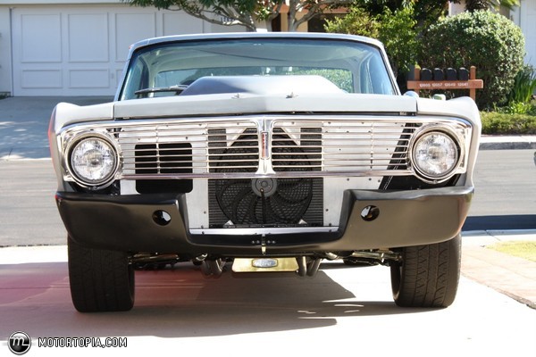

      Quote Originally Posted by MCMLXIX View Post
      Are you plannig on filling the gap between the grill and the valance? Under the headlight area and where it meets the fender...
      I have considered it. I have also considered bringing the opening in the valance in and up to match the radiator cutout. But then I desided to put a intercooler there. SO i guess my car will get a supercharger at some point HAHA. SO i guess I will wait to do the intercooler then determine what it needs to look perfect.

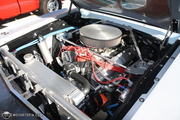

      Quote Originally Posted by hivewax View Post

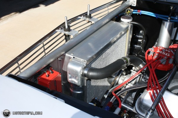

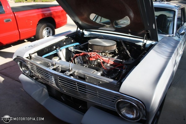

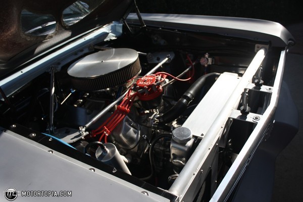

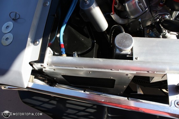

      Wow, that's a first for me in seeing a custom aluminum radiator support. How involved was it... hours of labor, tools involved, etc? Please post up any close-up shots.
      I would saw fairly complex. I did this 7 years ago when I was 19. I didnt even have a bandsaw yet. The aluminum was cut with a jigsaw and filed/sanded to fit. There are a few tricks to the install that arent seen in pictures. But its completely unboltable (new word, HAHA) so the motor comes out the front for quicker changes, I have a 550-600hp race motor. Its also a lot stiffer with the aluminum tube going across the top. It took awhile to get it perfect. I would guess a few weeks, from memory. But I designed it to be built with the basic tools that I have. The trans cooler is on the passanger side and my MSD 6AL is on the driver side. So that defined the max radiator width.

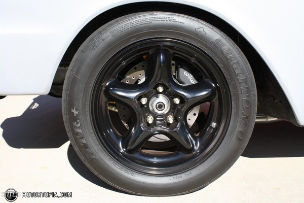

      Quote Originally Posted by Bjkadron View Post
      Ahhh! haha! Sorry, that went right over my head. By the way, Are those the wheels you are going to keep on it? or are you planning something different?
      I like the wheels the look and fit great, but they are heavy. i will probably go 15 or 16s and some cot race tire. like the toyo 888 (245/45/16) or the BFG R1 (235/50/15).
      It's really nice ,isn't it!
      You can also see another custom radiator support if you look around for my pics. They are a lot easier to do and a lot less expensive than you might think if you look for materials on the cheap in a scrap yard. Companies throw away machines and other equipment all of the time that have more aluminum of all the sizes and types you are looking for and you buy it by the pound. the tools needed to work with aluminum are the same as working with wood and sheetmetal.

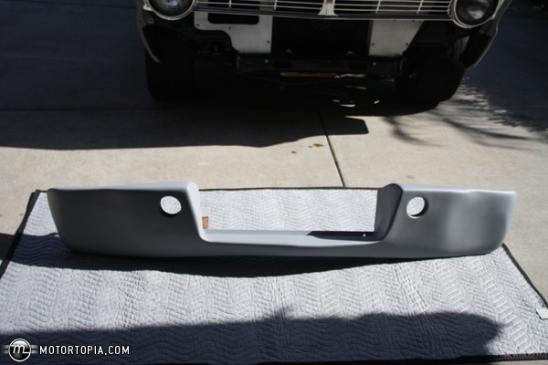

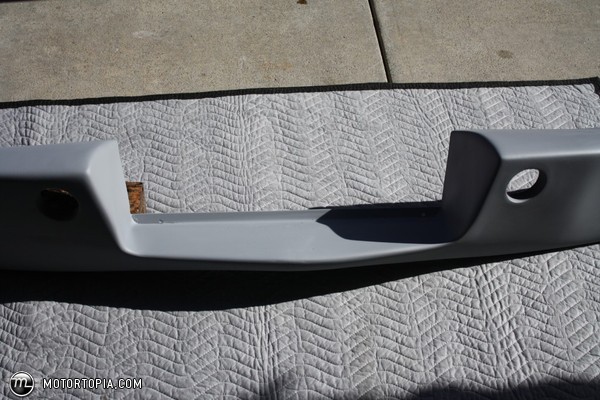

      So I finished the valance fiberglass and everything is smooth and filled. I also primed it in gray to match the front end. HAHA. the LED turn signals are going in this weekend. and its ready to be installed. I cant wait to take some pics.

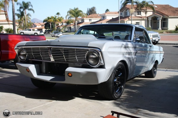

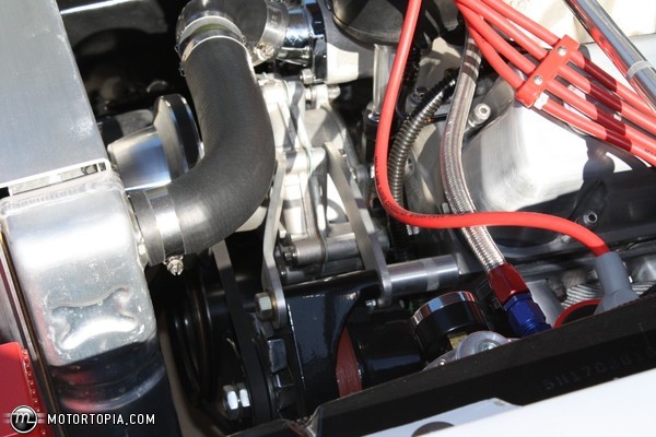

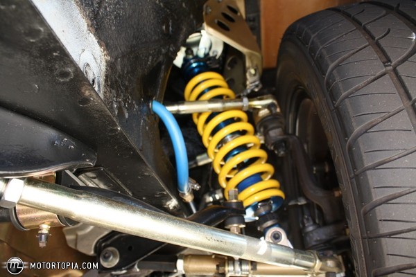

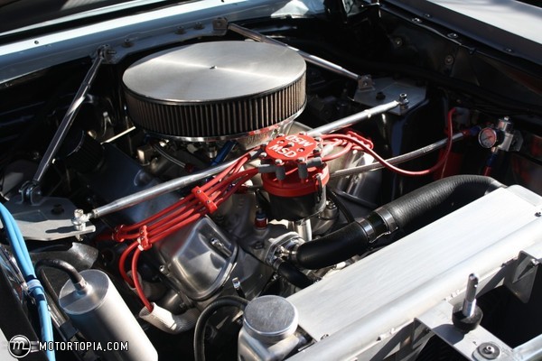

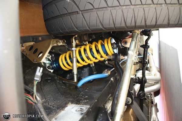

      Some new pics no paticular order. Engine, Valance, Radiator core support and suspension.

      Bro...looks awesome! Moving right along it is...
      My radiator support isn't even cut out yet so I'll make the opening the same width as the opening in the apron, even though it'll all be black, but I can fit a bigger radiator in there, too.

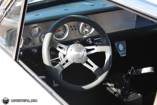

      Do you have more info on your dash? More interior pics in general?
    20. #140
      san diego
      5,101
      I should have some more pics. What do you want to know about the dash?
