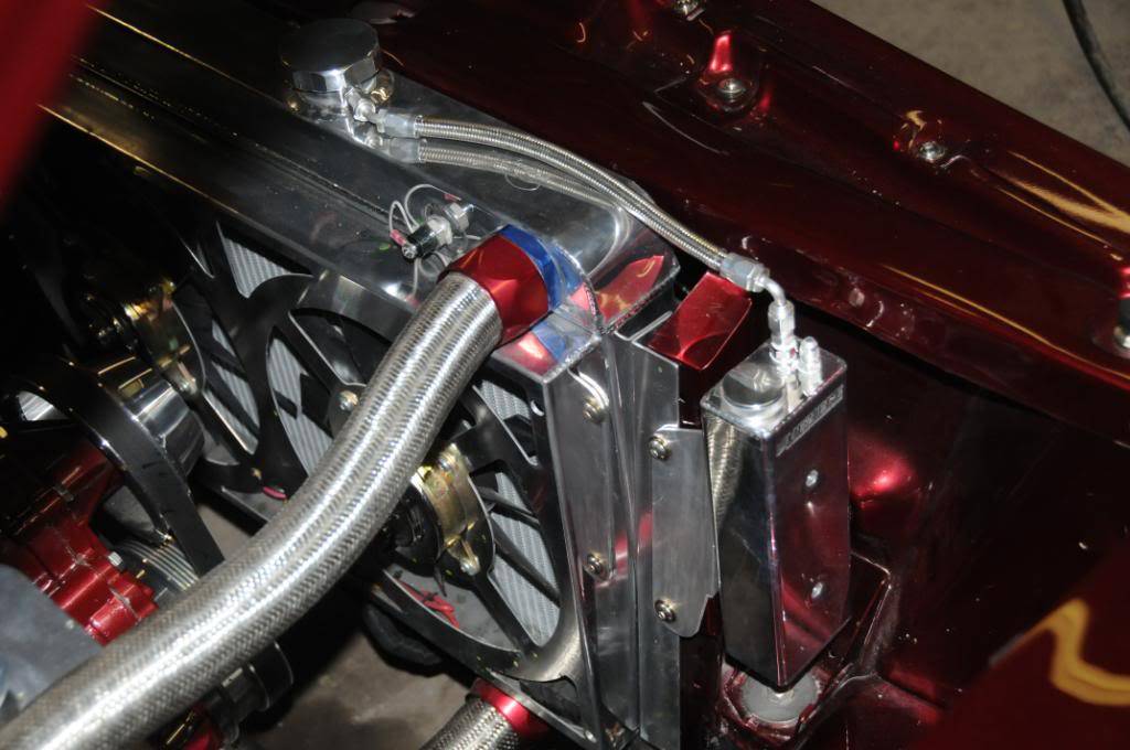

      Made a little progress last night. Not much time, but at least I got a little done.
      Mounted the Meziere overflow reservoir using the aluminum bracket I made. Haven't polished the bracket yet. Installed two 1/8" NPT to -4AN fittings to the reservoir. Replaced the 1/8" NPT barbed fitting with a 1/8" NPT to -4AN fitting in the rad neck. Made a -4AN braided line with some clear plastic sleeve over it and installed it. I still need to make the vent line and attach it - plan to use a -4AN 180 degree hose end. Looks like this will work pretty well.

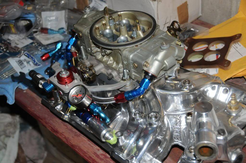

      Also mocked up the initial fuel deliver setup. Note the regulator relocated to under the bracket, the repositioning of both the mechanical regulator and the electronic fuel pressure sending unit. I have some fittings due in today to make the -6AN braided feed lines. I think this will work well, and the good news is that it only slightly lowers the main supply and return lines so I don't need to replace them.

      More progress - but slow
      Had some time to work on the car last night. The fuel supply lines from each side of the regulator to the carb (front and back bowls) really had a tight turn. By lowering the regulator I could no longer use the stainless hard supply lines. I had talked to Brint at Fragola earlier in the day to bounce a couple ideas off him.
      I ended up using 180deg hose ends, and having the back regulator port come around behind the regulator and feed the front carb inlet, and the front regulator port come around behind and feed the rear carb inlet. Problem was that the rear of the regulator bracket was completely in the way of the rear carb inlet feed then. I did some playing around, and realized that the rear of the bracket really isn't necessary in my configuration as the bracket is providing limited support. So, I removed the rear, cleaned up the cut, and installed it.

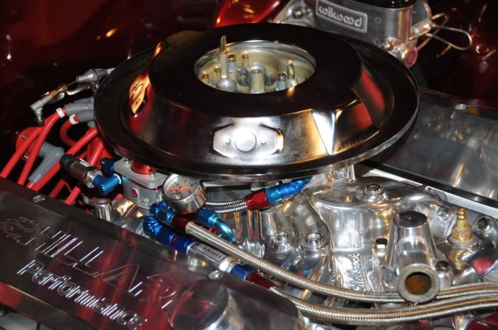

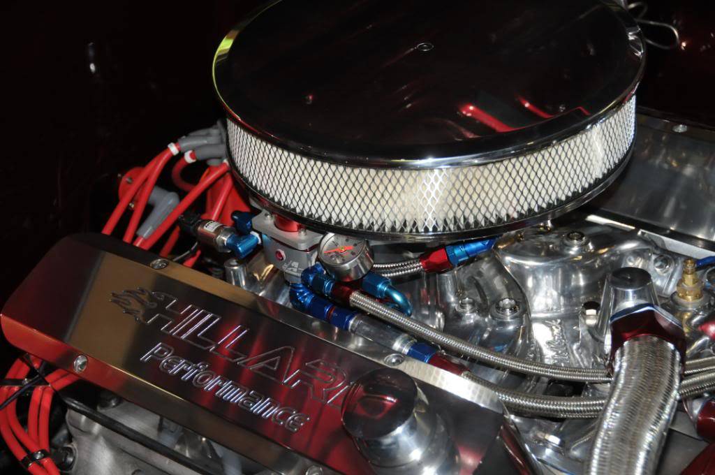

      It's not perfect, but it's about perfect in terms of fitment and clearance with the drop base air cleaner
      Previously, I had checked and was also very pleasantly surprised to discover that with the drop air cleaner, I could swap out the 3/8" phenolic spacer for the 1" Wilson carb spacer and fit a full 3" element in the 14" round air cleaner. I put clay balls on top of the air cleaner assembly to check for clearance, and seemed to have plenty of room!

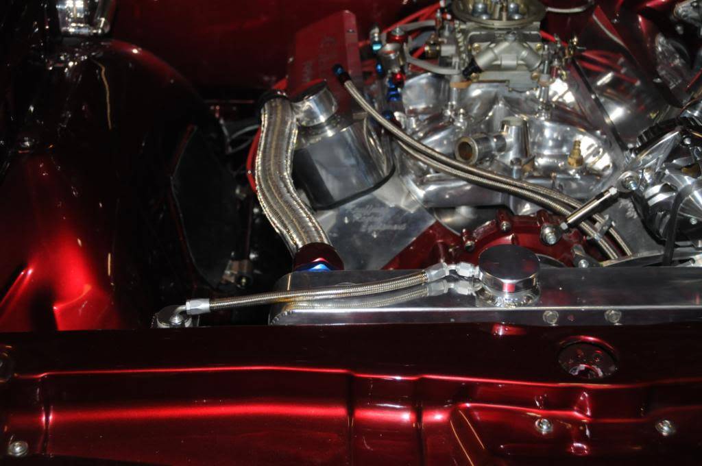

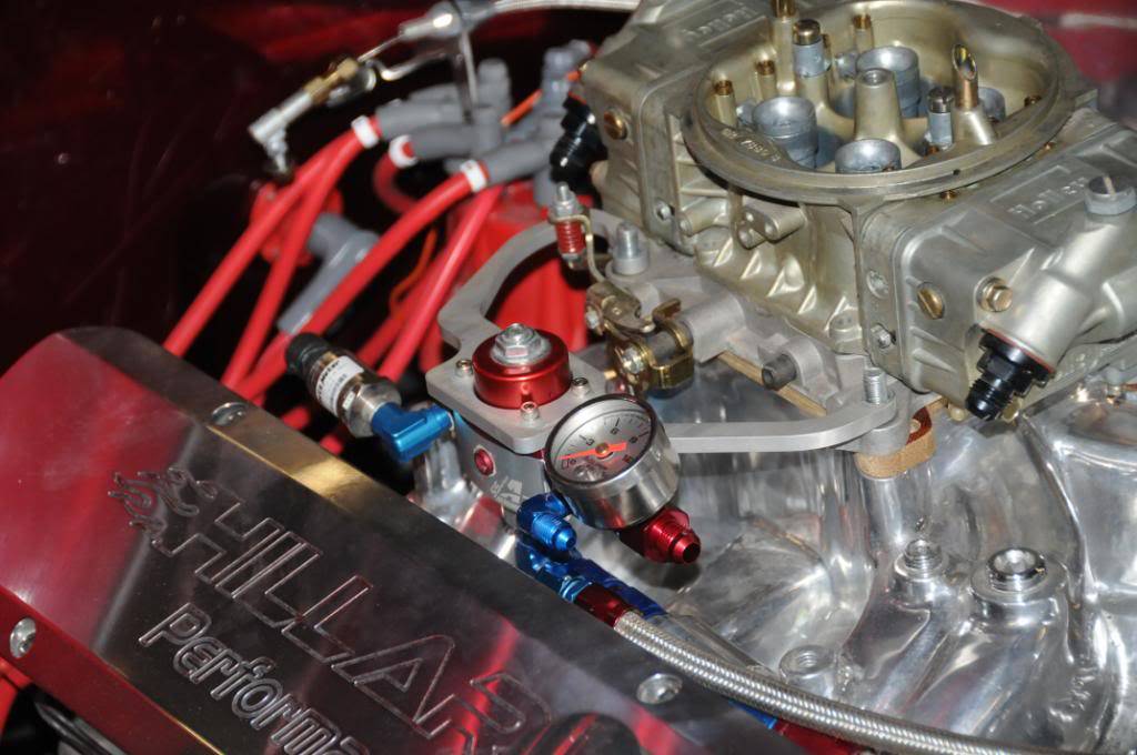

      Here's what the engine compartment looks like now (though it should be cleaner...) The photo is just a little dark...
      I think it's actually pretty good. Just about perfect clearance for the gauge, and it looks pretty solid and neat.

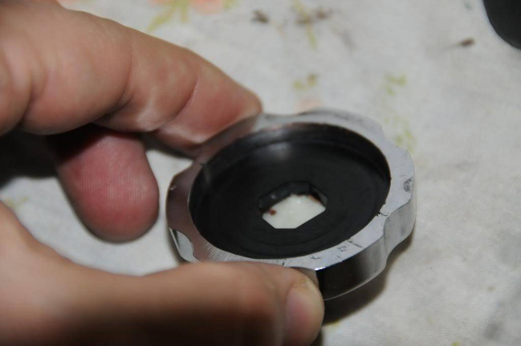

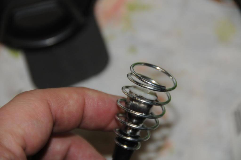

      Also, I had a bit of bad luck - all due to what appears to be a poorly designed $10 part. I put a Spectre power steering reservoir cap on the freshly painted and rebuilt pump. I checked my fluids yesterday morning, only to find...
      The brand new cap with a total of about 25 miles on the car fell apart. This piece - the dipstick:
      fell off and was in the reservoir. The little tabs that secure the cap to the reservoir are missing. I was able to fish out the dipstick assembly but cannot find the tabs. Who knows what may have been ground up and shoved through the pump, lines and box. I put a stock cap on. I'll be callling Spectre today, but most likely it means pulling the pump, reservoir, lines and box. All because of a friggin cap.

      There should be a magnet in the pump body as well as a fine pre-filter screen.

      Quote Originally Posted by old66tiger View Post
      If I remove the pump assembly, how would I check for that? Drain the fluid, remove the pump from the reservoir, and look where? Or do I need to also disassemble the pump itself? Thanks!
