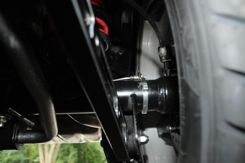

      Hydraulic clutch is in, bled, and adjusted. Seems to work great. I used -4AN braided to connect the billet fluid reservoir to the master cylinder. It turned out nice and clean. Have just a little more work to do with brakes.

      Planning to finish the brakes this Friday evening as well as setting the pinion angle. Then hopefully next week I'll take the car for front end alignment.
