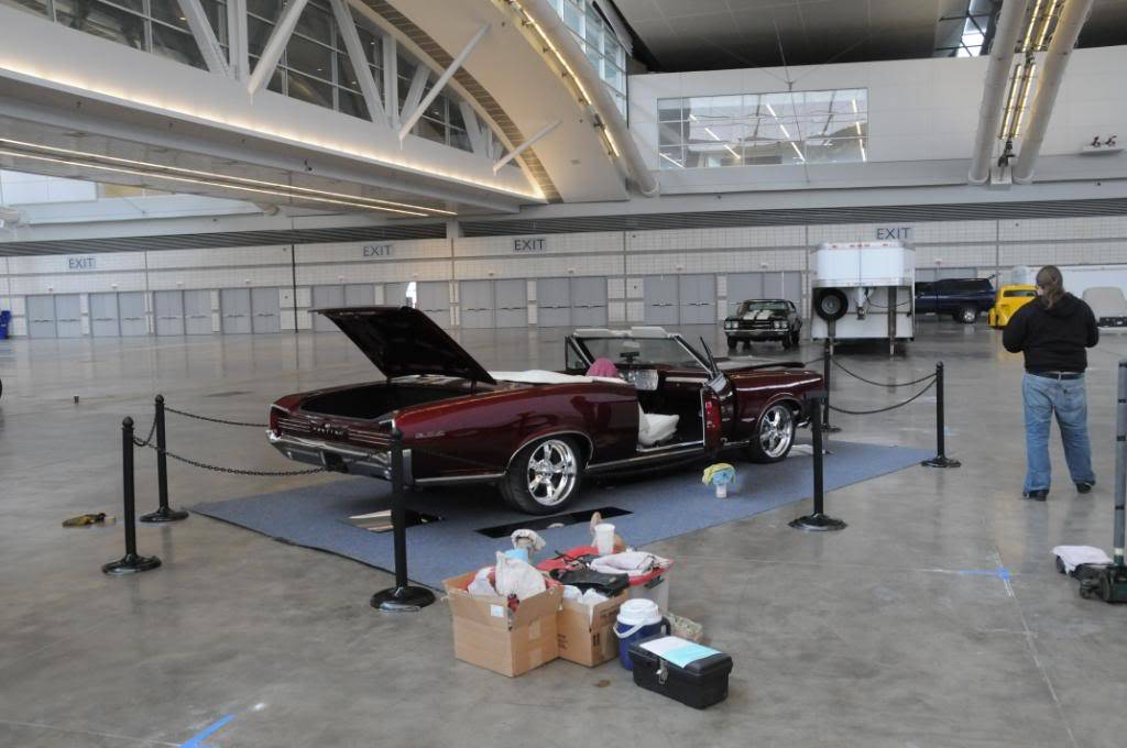

      Well, delivered the car to the show this morning. Only forgot a few things I was glad we got an early time/date to get in. When we arrived at the convention center, there was almost nobody there. Easy to offload and setup. The power to the spots has not been setup yet, but at least we got the spot, the carpet down, and the stanchions setup. Still have to setup the lights, mirrors, display boards, clean, polish.... In the background you can see I even washed my truck and trailer. It's been so messy outside recently that I was afraid they wouldn't let me in on the convention center floor if I didn't at least rinse the crud off.
      These are poor pics, but here are a couple...

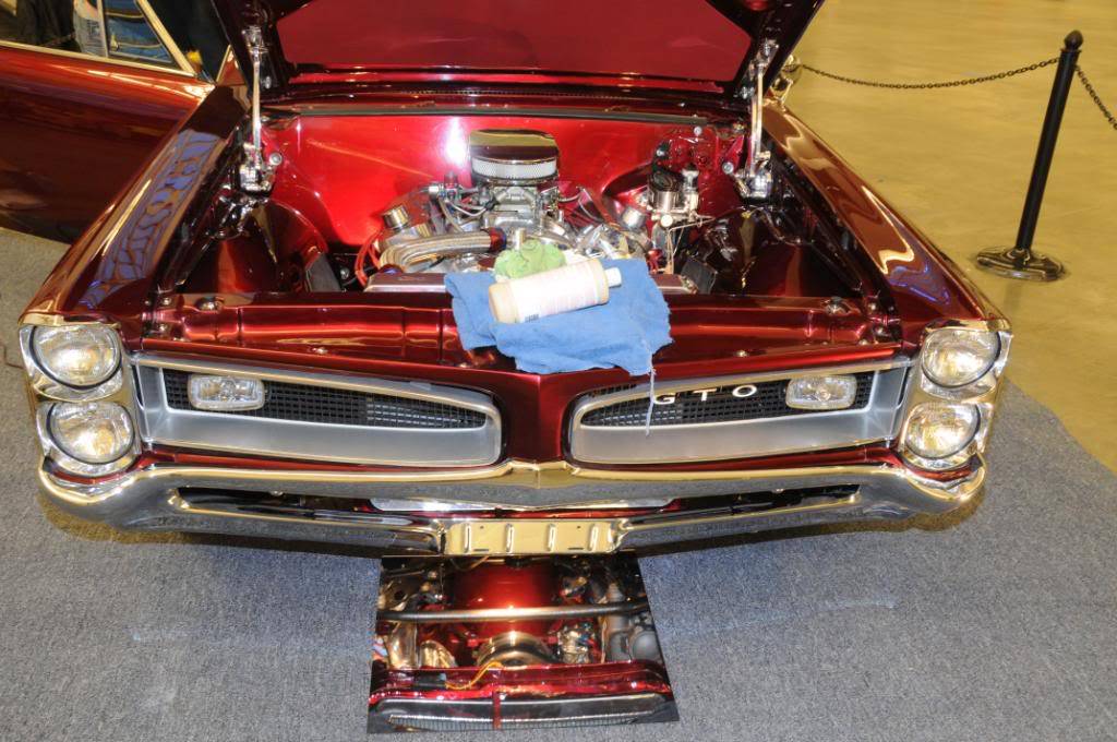

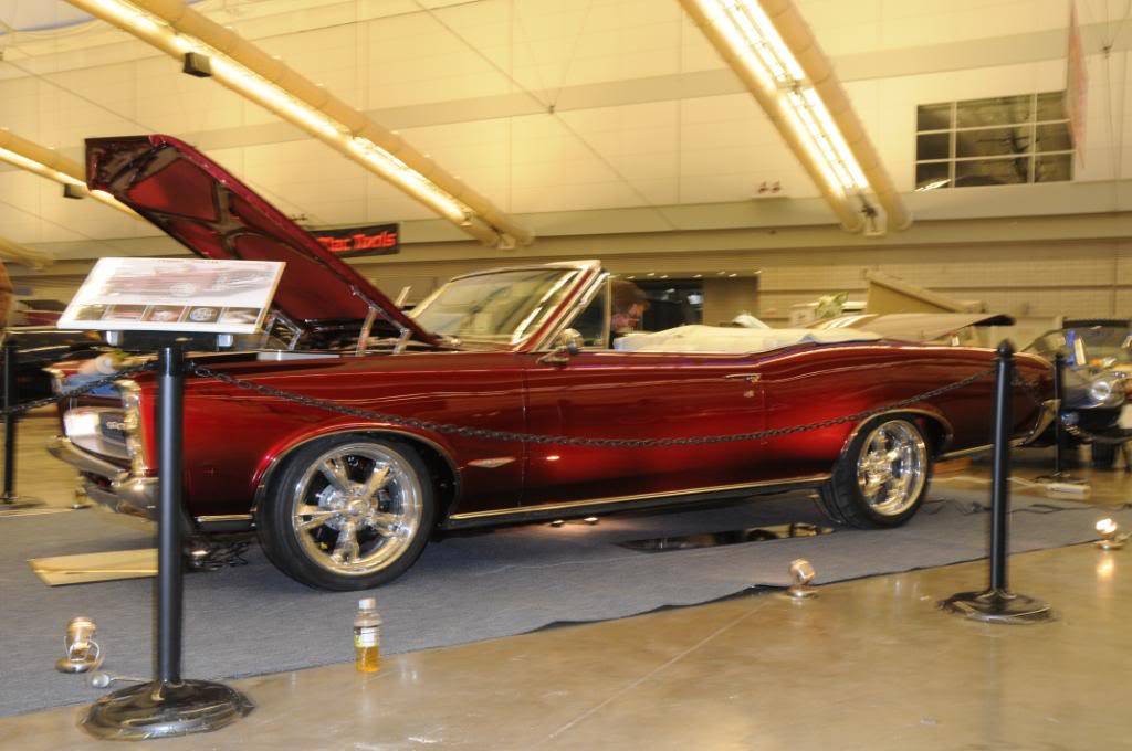

      Thanks! Setup continues. Still have some things to get done in the morning. The show starts tomorrow at 3pm. Still in progress....
      Out of focus, but getting there. Still need to secure the carpet edges, finish the lights, adjust the mirrors, and CLEAN.
      Need to cover the pesky fan wires in the AM, and POLISH....
