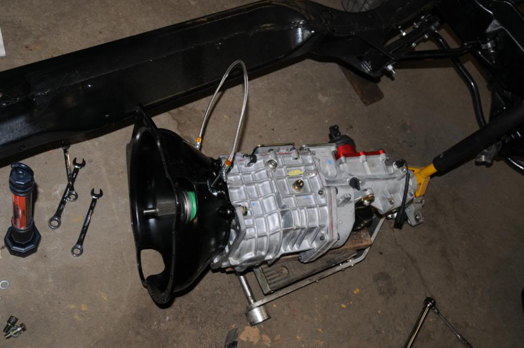

      Finished powdercoating frame, SPC tubular adjustable UCAs in front, Howe tall ball joints, SPC springs all around, Currie Currectrac rear UCAs and LCAs, Spohn rear sway bar, Moser 12 bolt crate rear end w/Truetrac, 33 spline 3.73...

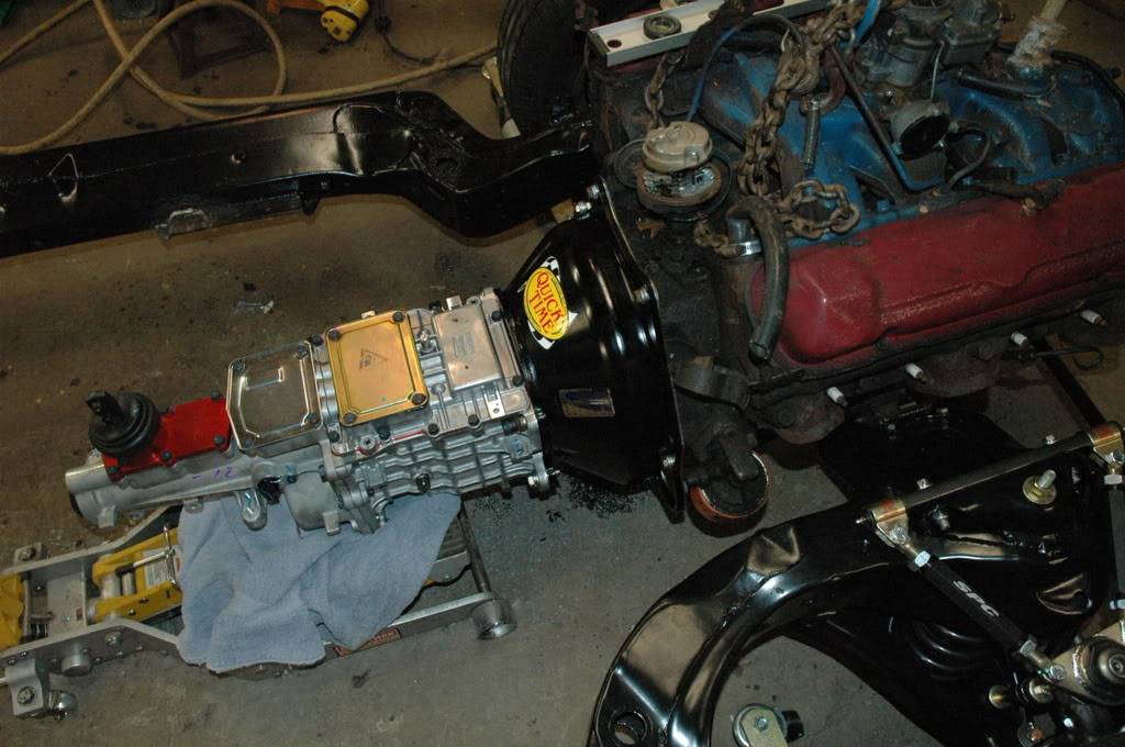

      Quicktime scattershield mocked up with TREMEC TKO600 Tranny:

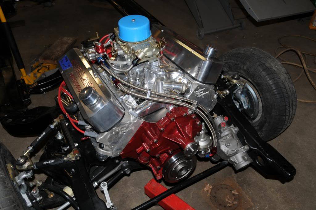

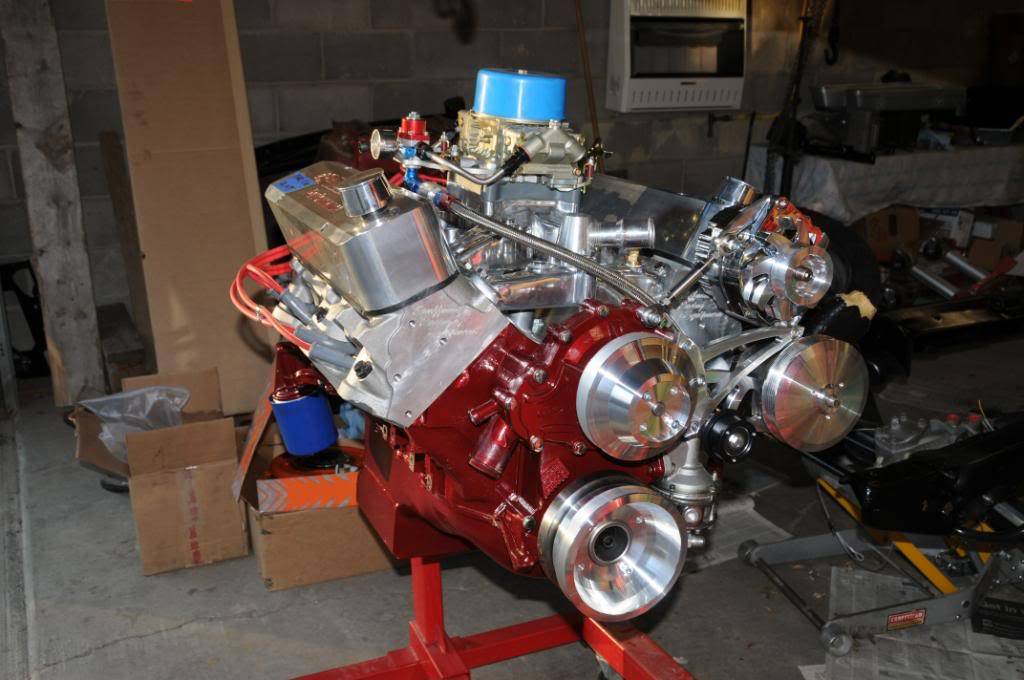

      Engine built, tested, dyno'd and ready for installation...

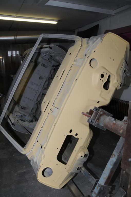

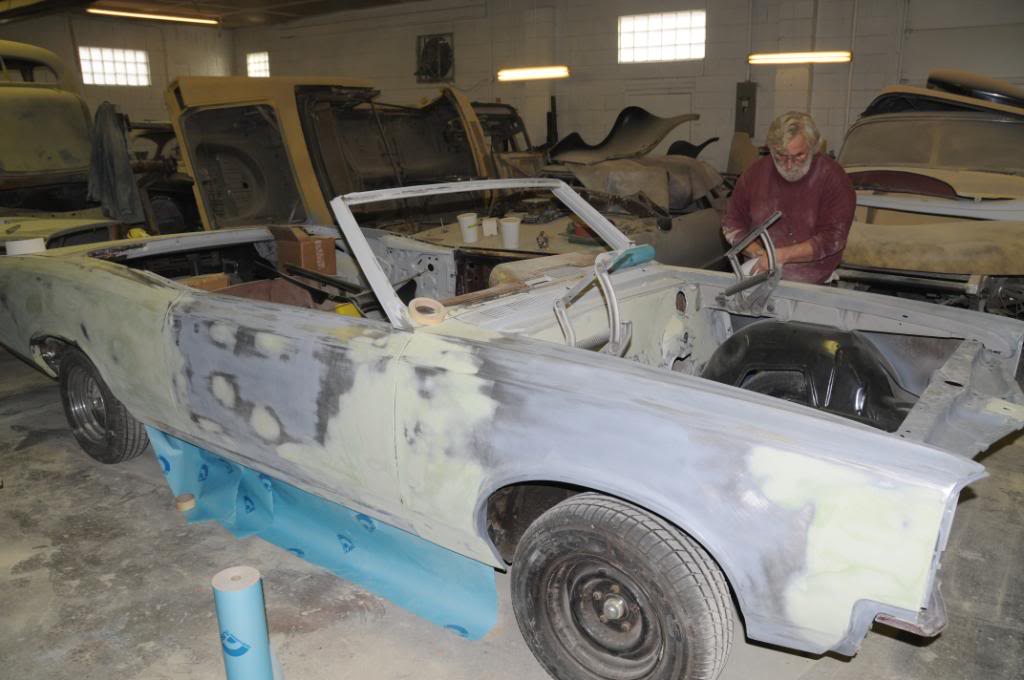

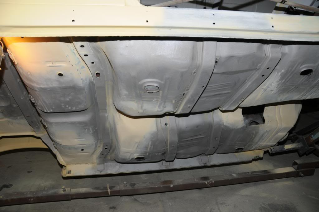

      Body has been gone through. Everything aligned, 3 rounds of block sanding already...

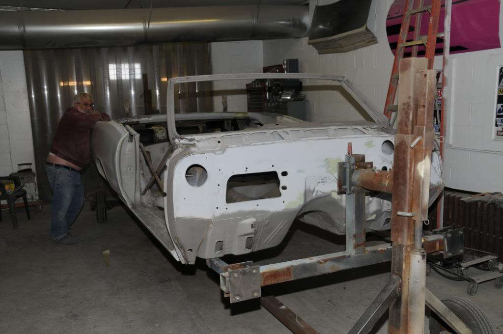

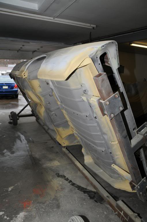

      It's off the frame one last time on the rotisserie. Hopefully have the underneath and firewall painted by the end of next week or early the week after...
      Hope to have all bodywork, paint and chassis assembly done by May 1st.

      Nice motor. More please. Got any specs? C.I.D. , type of heads, etc.
      RagRat
      Chris Costa
      Aug 2008
      Pgh, PA
      2,177
      Quote Originally Posted by Rag-Rat View Post
      Pontiac 400 block, .035 over, 4 bolt billet caps, bottom filled
      Forged 4.25" crank
      Ross Pistons
      4340 forged ultralight rods
      Custom ground 246/252 roller cam, 112 LSA, .660 lift w/1.65 roller rockers
      Solid roller lifters
      KRE aluminum ported heads, 320cfm @ .700 lift
      TII intake
      Custom built Holley 4150 carb @ about 950cfm

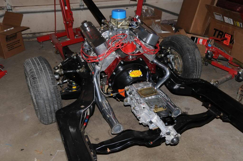

      More progress. Over the weekend, got the motor in for the last time, with headers. Installed the hydraulic clutch assembly (concentric slave cylinder/TO bearing), scattershield, etc. Installed entire assembly. Installed new stainless 8AN fuel supply, 4AN fuel return, and hard stainles front to rear brake lines. Installed air bags in coils, and put the front shocks on.
      Waiting for a few parts this week, but expect to take the rolling chassis back to the body shop this weekend. Underneath of body and smoothed firewall will be painted by then, and body will go back on car. It's been through 3 rounds of priming and block sanding. One more, and then it will be finish up and paint. Already clearanced the inside of the rear wheel wells to make a wee bit more room for rubber.

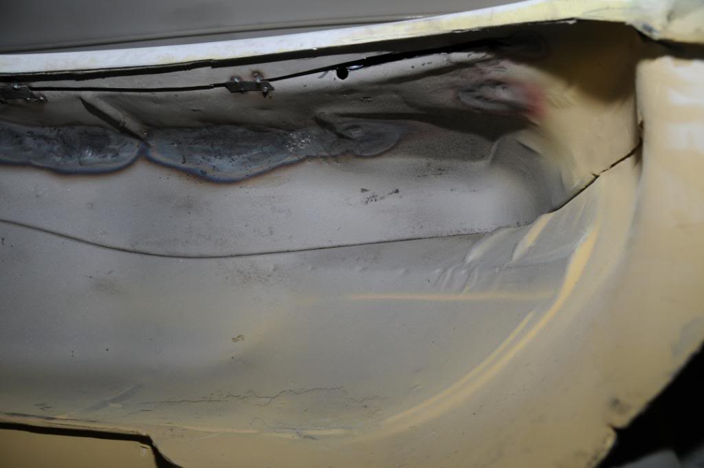

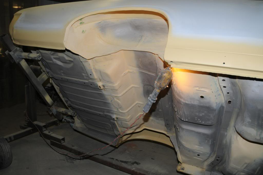

      And a couple body pics at this stage...
      This isn't done yet, but making a little more room in there....

      Nice engine. Did you dyno it yet?
      Yes. There's still more in it. For a number of reasons, ran out of time and I never touched the carb yet. Without any changes to jetting whatsoever, it was 561hp/580tq. Avg hp was 505 and avg tq was 550. Torque was already at 550 by 3800 and stayed above 500 to 6000rpm. Timing was only 28.5. With a little fatter jetting and a degree or two of timing I'm pretty confident that the final numbers will be another 20-30hp. But the torque curve is so solid I hate to mess with it.
      I was building for 550/550 reliably on pump gas so I'm happy. I could run this thing right now on 89 octane if I had to.

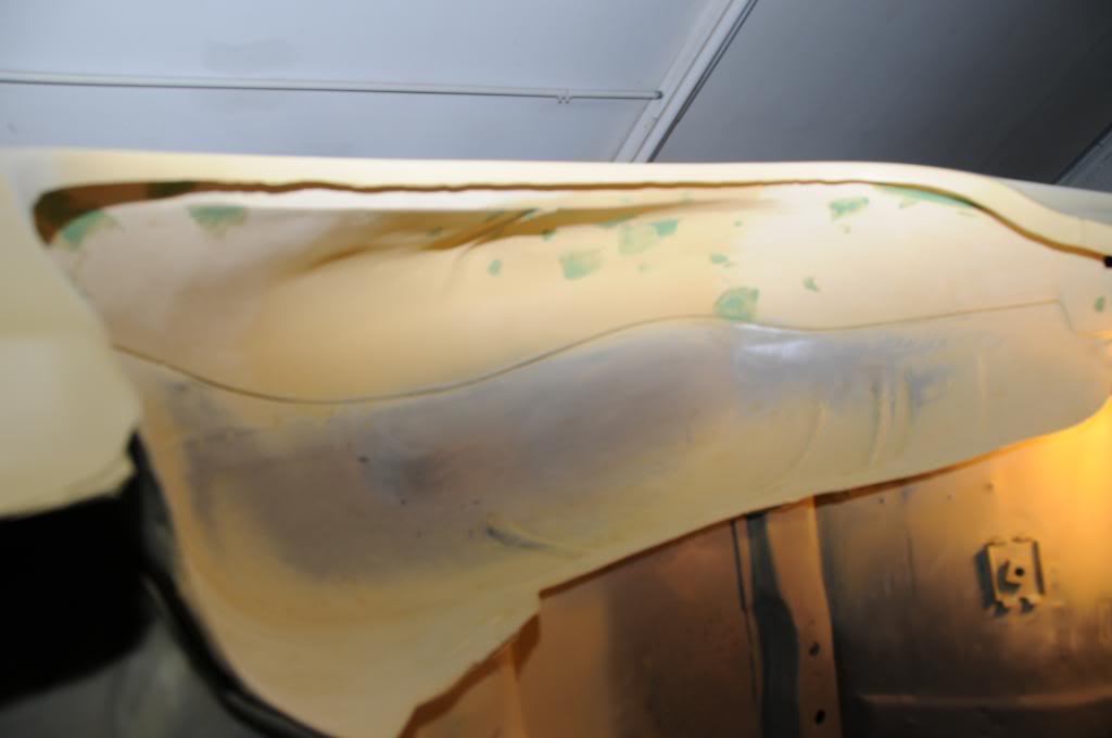

      Stopped in today. Things are coming along nicely. Here are a few updates.
      Wheel wells continue to get nicer:
      Underneath will be extremely clean
