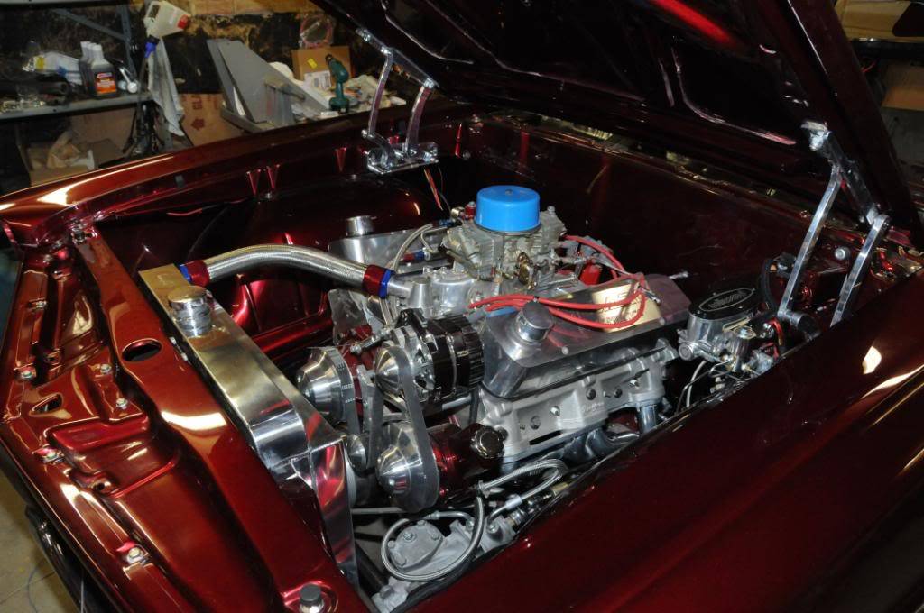

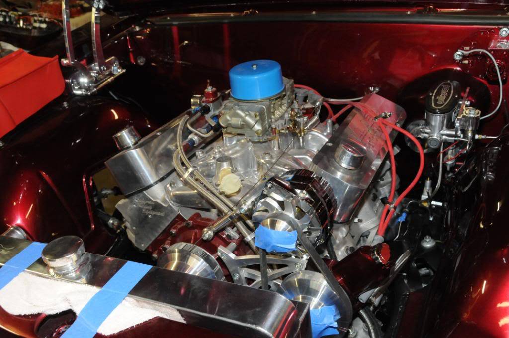

      Front end and engine compartment is just about done with wiring. Headlights done, markers/turn signals wired - just need to put the plugs on. Starter, alternator, fuel pressure and water temp sending unit wires are routed and attached, with some "round-it" black fabric covers. Just need the wiper motor, oil pressure, line lock and oil temp to finish up in the front. When done, you'll see almost no wires whatsoever. Rear end is also well along. Remote battery plate temporarily mounted - still need to make some bushings for final mounting due to the irregular floor height. Need to install the remote solenoid and the master switch along with the main power fuse. All quick work. Almost all wires going from either the front or the rear of the car to under the dash are routed. Some are already tied into the fuse box. Instrument panel is almost wired, with quick disconnects.

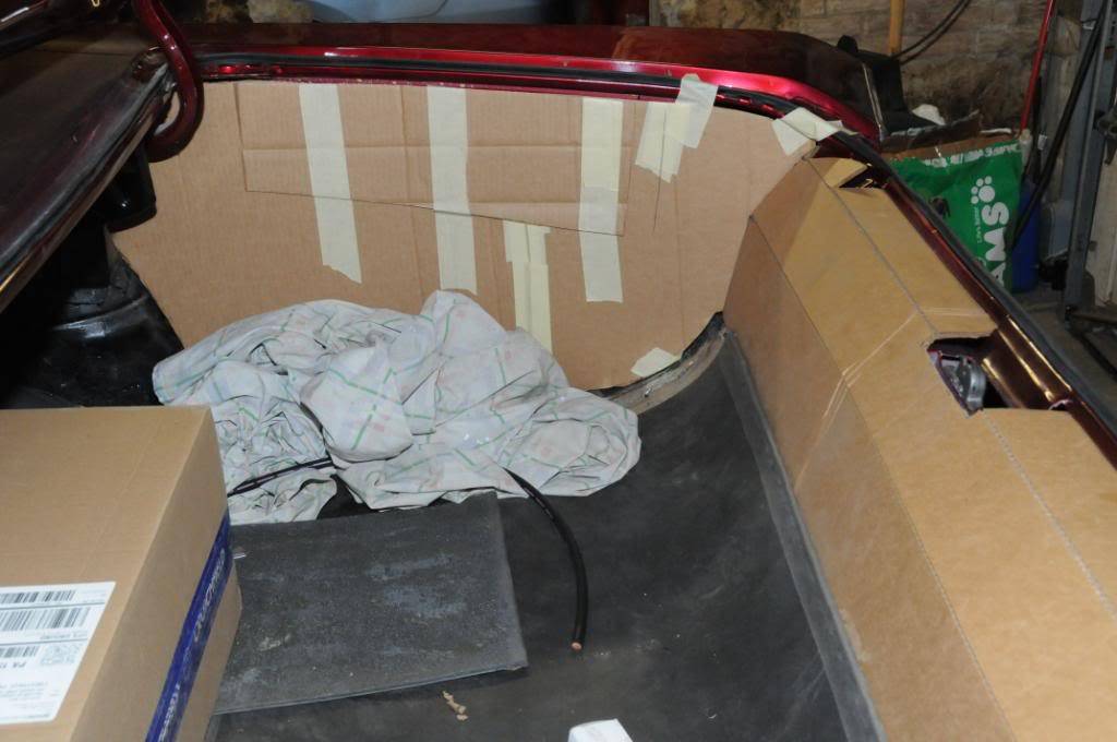

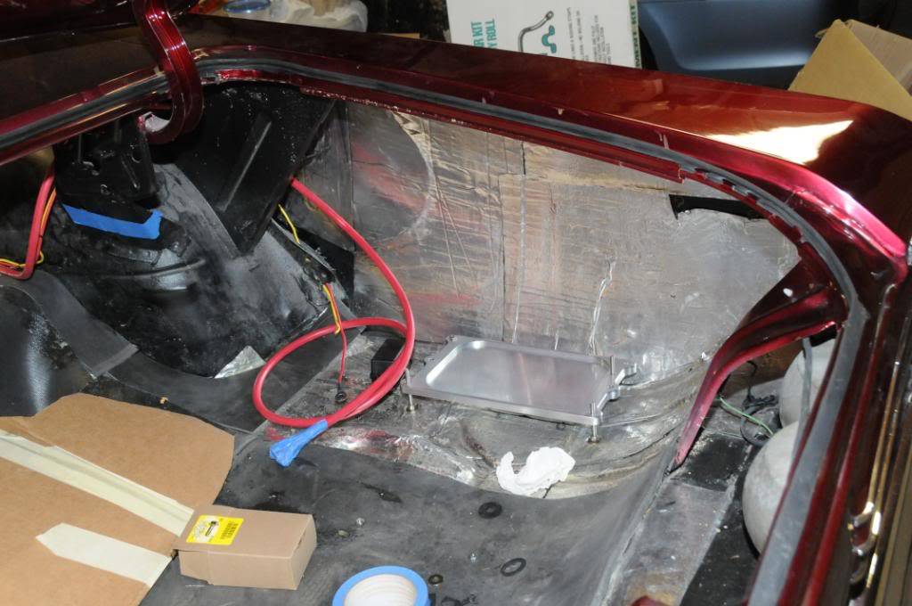

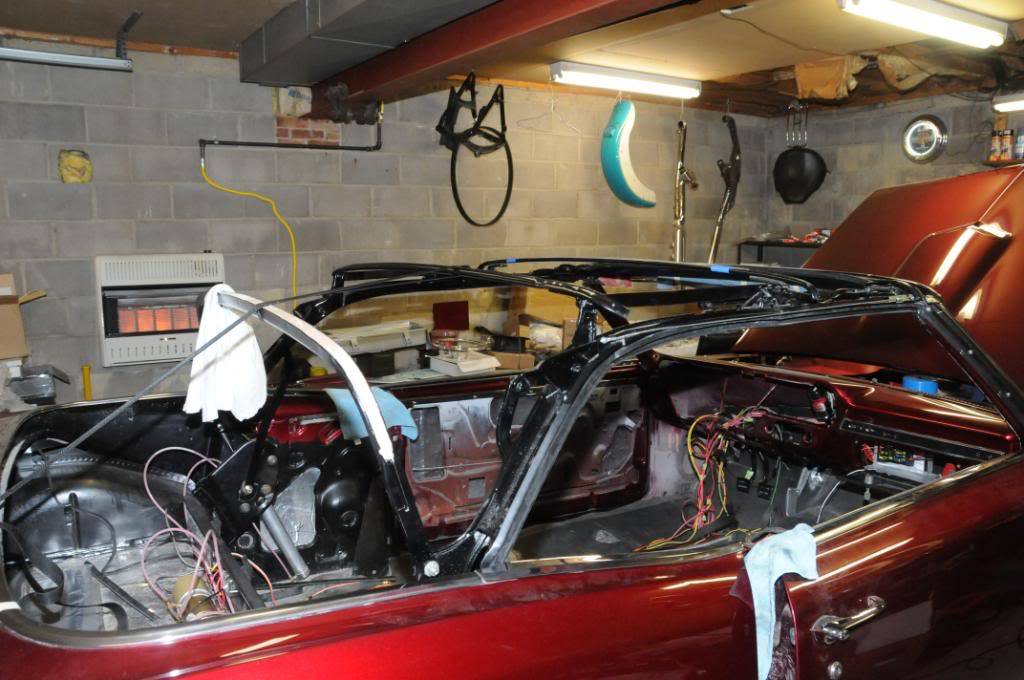

      Also - don't focus on either the dust - or the unfinished trunk, etc. The trunk side upholstery panels already have forms, and the front and rear should be done sometime next week. The battery will be hidden behind the passenger panel.
      The convertible top frame is now ready - with the exception of one bushing I need to swap. A 2 minute job. Rear bow is filled and ready for staples. Inserts are in the front bow, and weather stripping is on.
      The new radiator is mocked in place. I still need to finish the mounting brackets (they'll be on the sides, to mount to the boxed core support mounting surfaces - all fabricated. The Rodney Red radiator is a very nice piece, and the fitment and quality are excellent.
      I've got an appt to install glass on Jan 4th. The glass is already there and prepped. Should be done by close of business on the 5th. Exhaust is a bigger problem. I got the materials from Ram Air Restorations. 3" at the header flanges going to 3" oval X-pipe, to 3" spintech mufflers, to 3" round tail pipes. All mandrel bent - nice stuff. Problem is that there are only a couple "good" exhaust guys around here. One guy can't fit me in for several months. The other guy is a bit harder to work with. Plus, ideally I want him to mount the exhaust and fit it, then I'd like to remove it, finish the welds, and have it ceramic coated and polished. We'll see how that works out.
      My goal over the next week is to finish the wiring, get the steering and dash back in, install the gas tank, and do some more detailing. I have some bolts on the core support (all stainless) that I want to polish also.

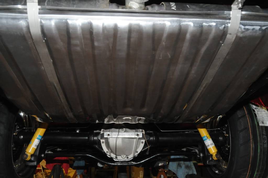

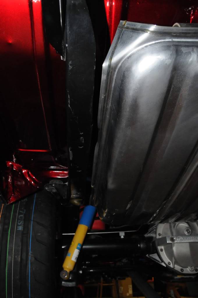

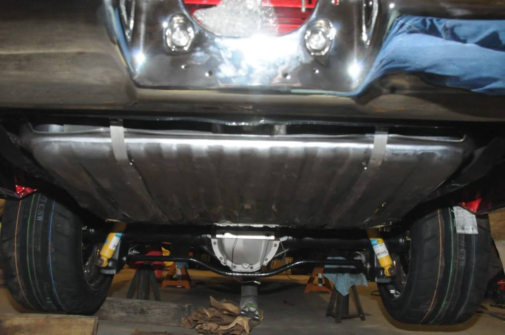

      Got a little more done. Fuel tank is in - man the stainless straps were tight! Tank is clear powder coated. Doesn't look too bad.

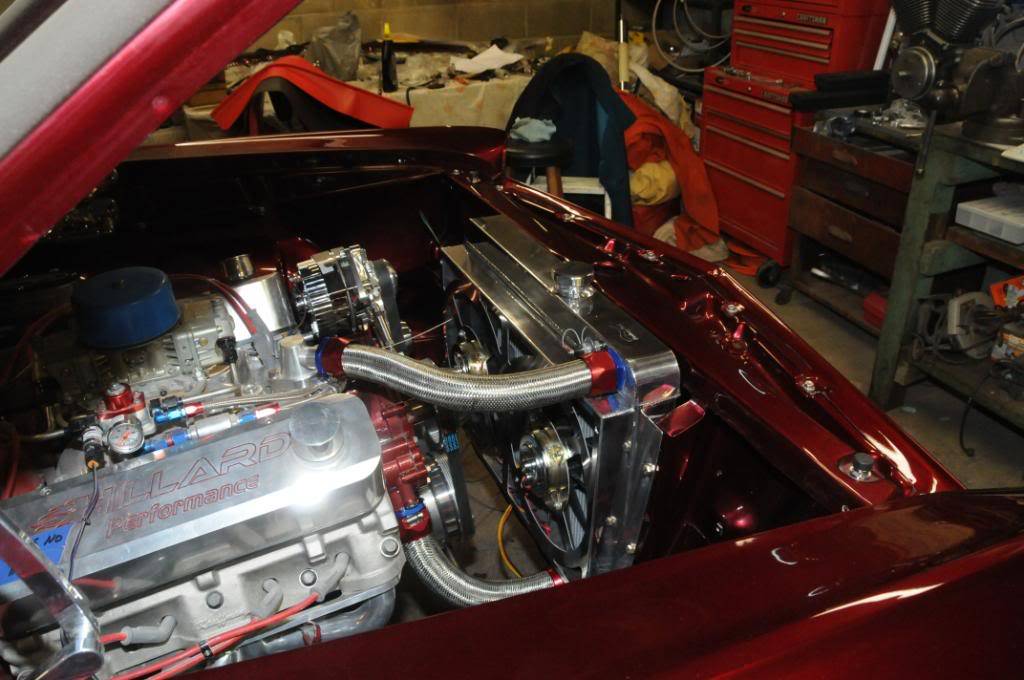

      Frank and Jeff - thanks! Jeff, the WW show is Jan 22-24. As you can imagine, I'm busier than I'd like to be right now. Just shut down the shop for tonight. Back at it in the AM. Here are some more update pics...

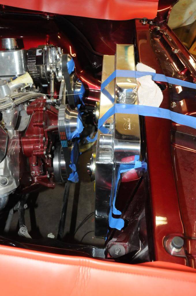

      Radiator is in, and connected
      I don't like where the clamp head is on the water pump connection, but...

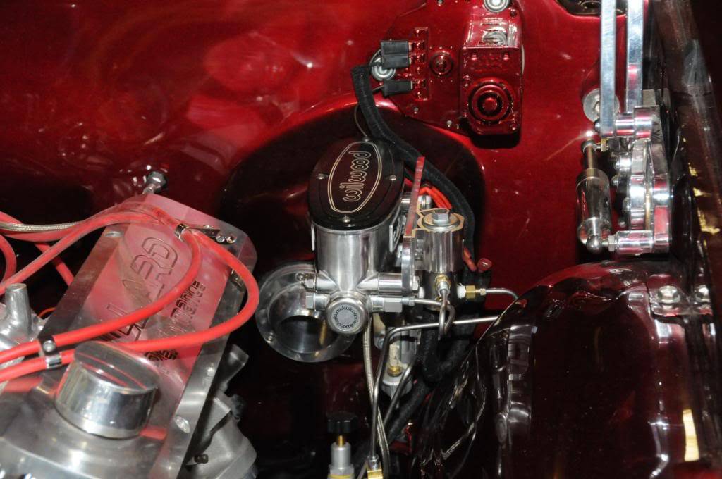

      I don't like how I've run the brake lines. This will do for the first show, but I'm going to redo this. Also, billet reservoir for the clutch master cylinder mounts on the same billet plate I made that is attached to the Wilwood master. I still have to make the braided stainless line for it. I've already drilled and tapped the plate to mount it.
      Trunk forms are coming along.

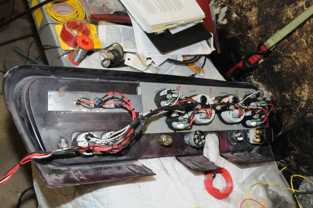

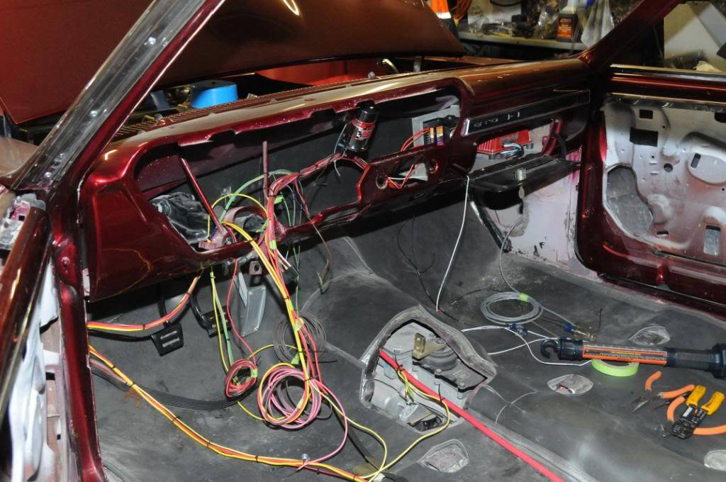

      Disregard the dust in my shop - but believe it or not, the wiring is almost complete.
      Tomorrow is a big day. Need to finish almost all the wiring (there are a few things that aren't critical behind a trunk panel). Need to finish the fuel tank plumbing. Install the vents, connect the driveshaft, and load the car in my trailer. Monday morning I drop it off for all the glass to be installed, and then the (already completed) interior goes in. It'll come back on Friday.

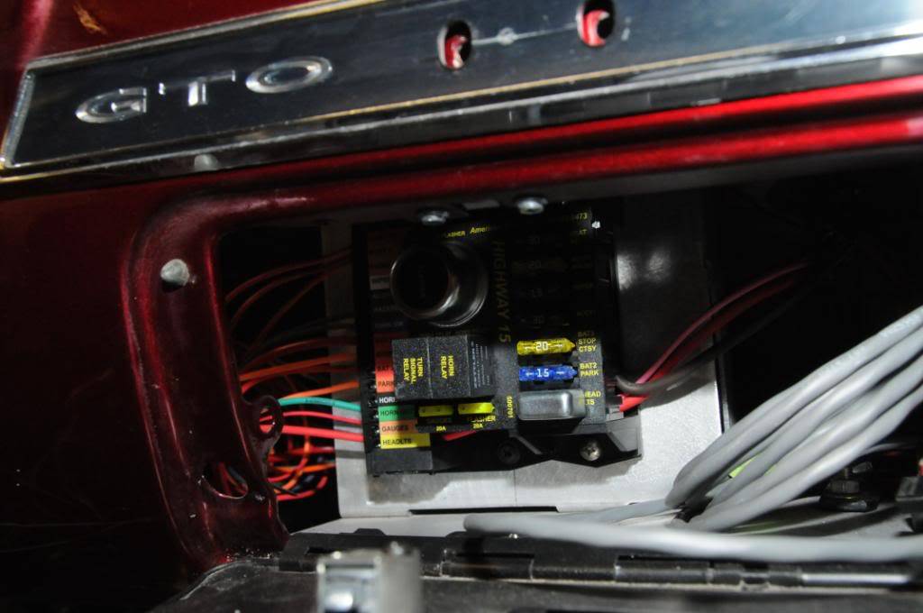

      Also, I've used the AAW Highway 15 wiring harness mainly in this car - though it's been modified a bit. But, I have to say it's been pretty good to work with, and the box is a nice form factor, well laid out and marked
      Here you can see the aluminum bracket assembly I built for in the glove box. On the left you see the box, nice and neat. To the right the pic doesn't show the MSD 6AL-2 ignition mounted on the same panel. It's turning out real nice. Oh, and disregard the black "GTO grab bar" plate in the pic. That won't be there, and I have something nice to replace it with
