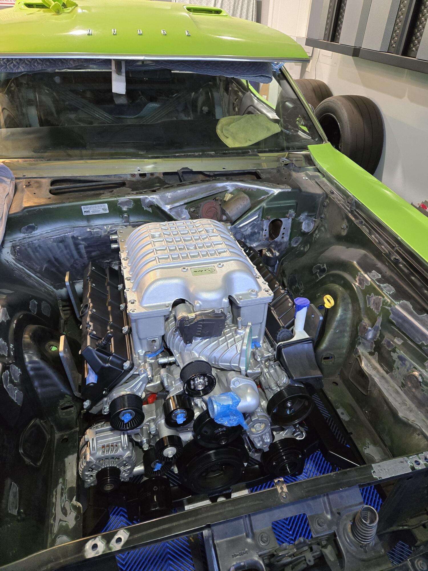

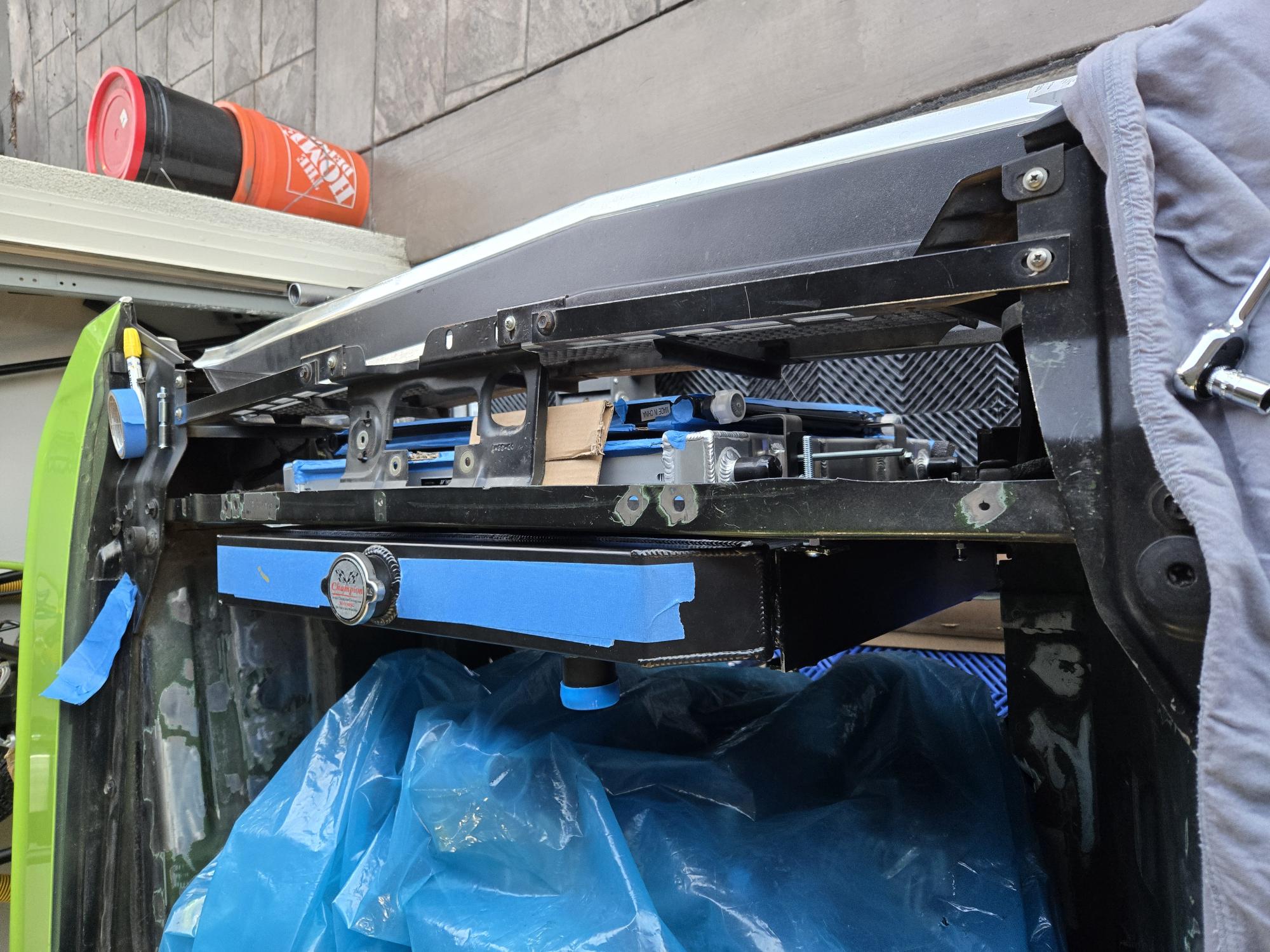

      I ended up removing the hood latch support and will run hood pins. This gives me plenty of room up front to move everything forward. I have the radiator mounted to the core support now.
      I'm running dual 12" spal fans with a total 2850 cfm rating. Name:  20250116_170019.jpg

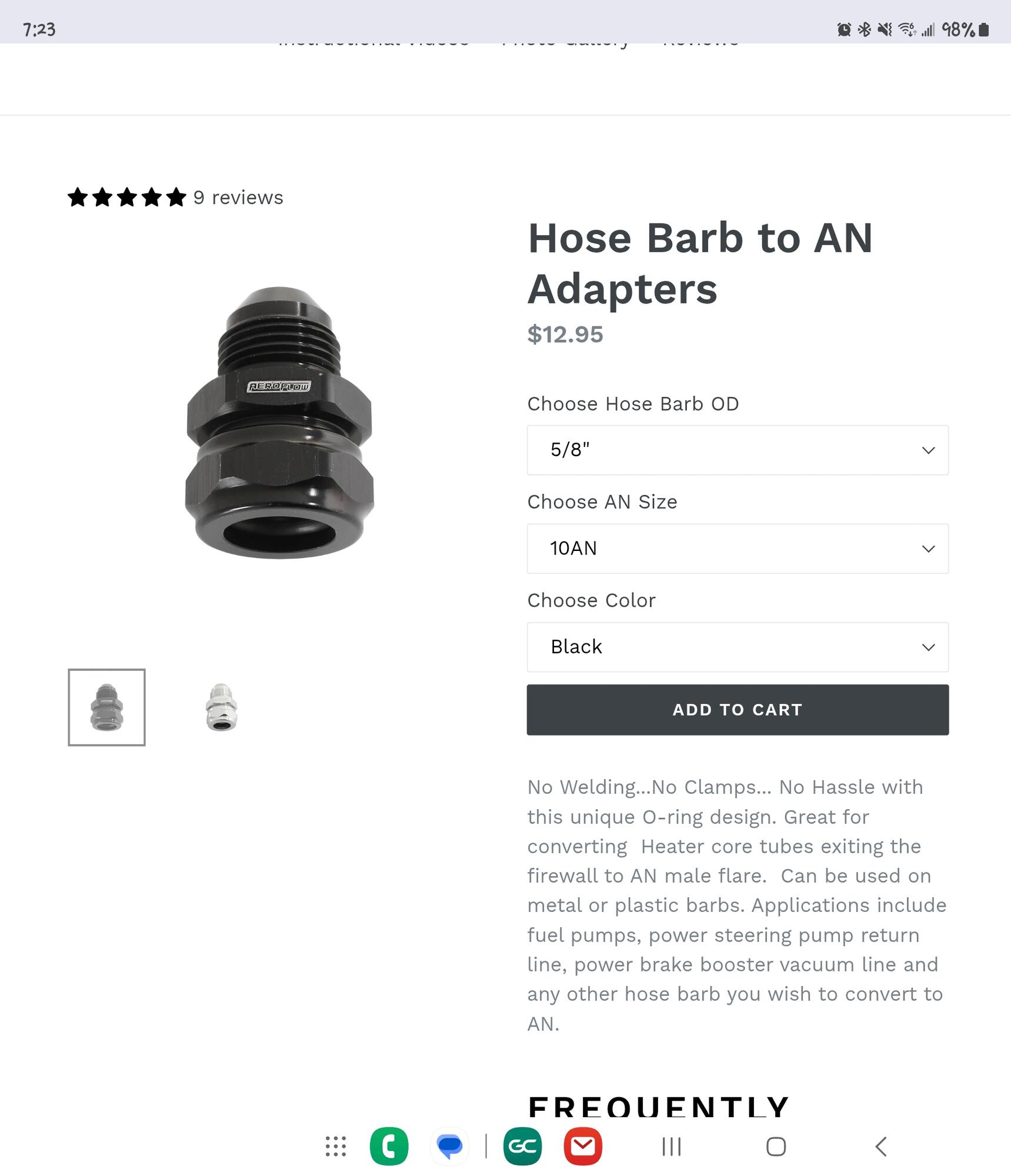

      Hey all, quick question on AN fittings. Has anyone used these AN barb adapters from Aeroflow? I was thinking about using them on my heater core lines to convert to AN fittings. Looks like they compress an o-ring down around the factory barb fitting. I haven't found much information on them so I wanted to know your thoughts.Name:  Screenshot_20250220_072338_Chrome.jpg
      I use them on my intercooler/heat exchanger and heater core, they work awesome.

      Awesome, thanks for the feedback. I ordered some for my heat exchanger to try out. I wasn't sure how well the o-ring would seal.

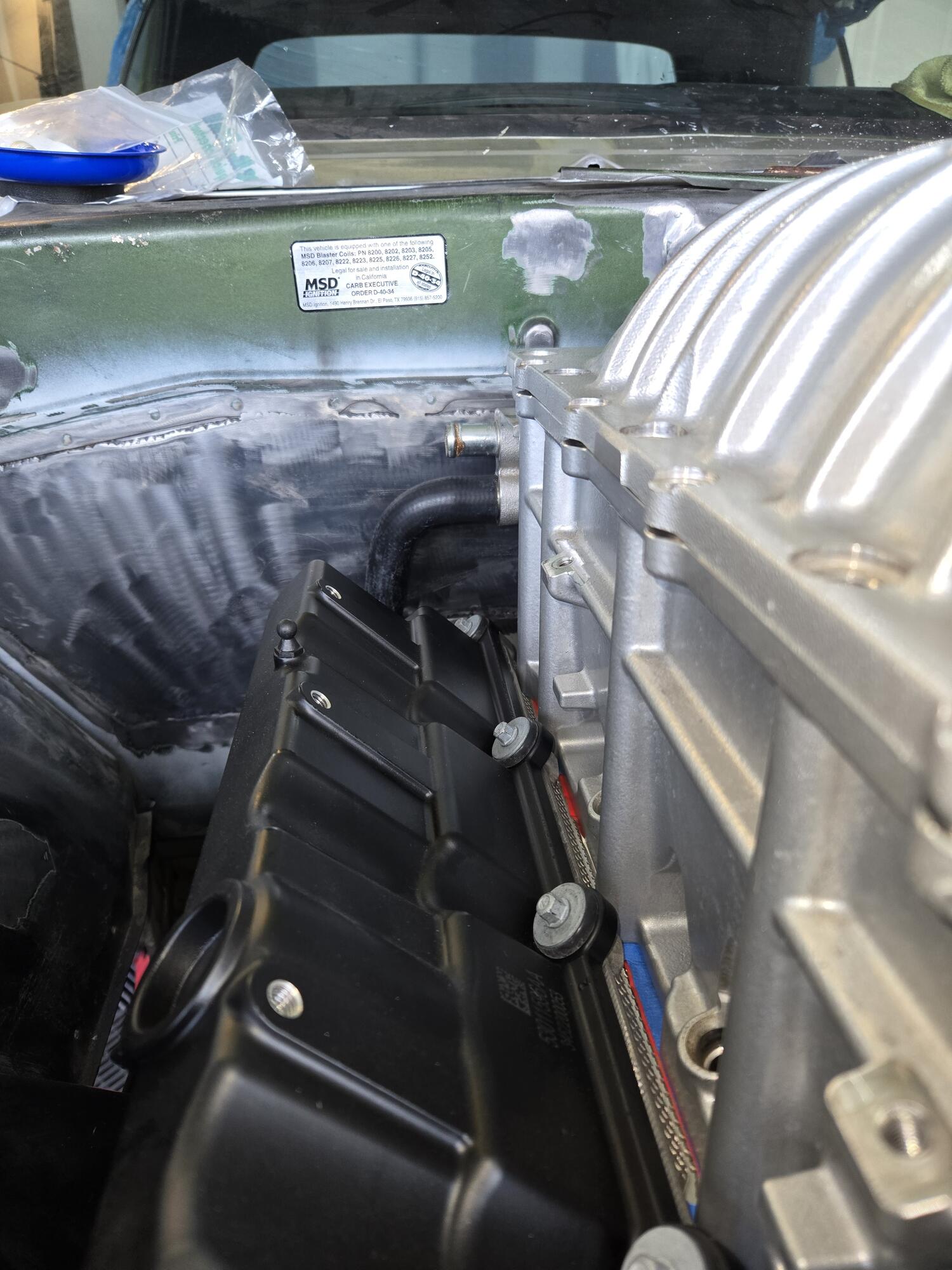

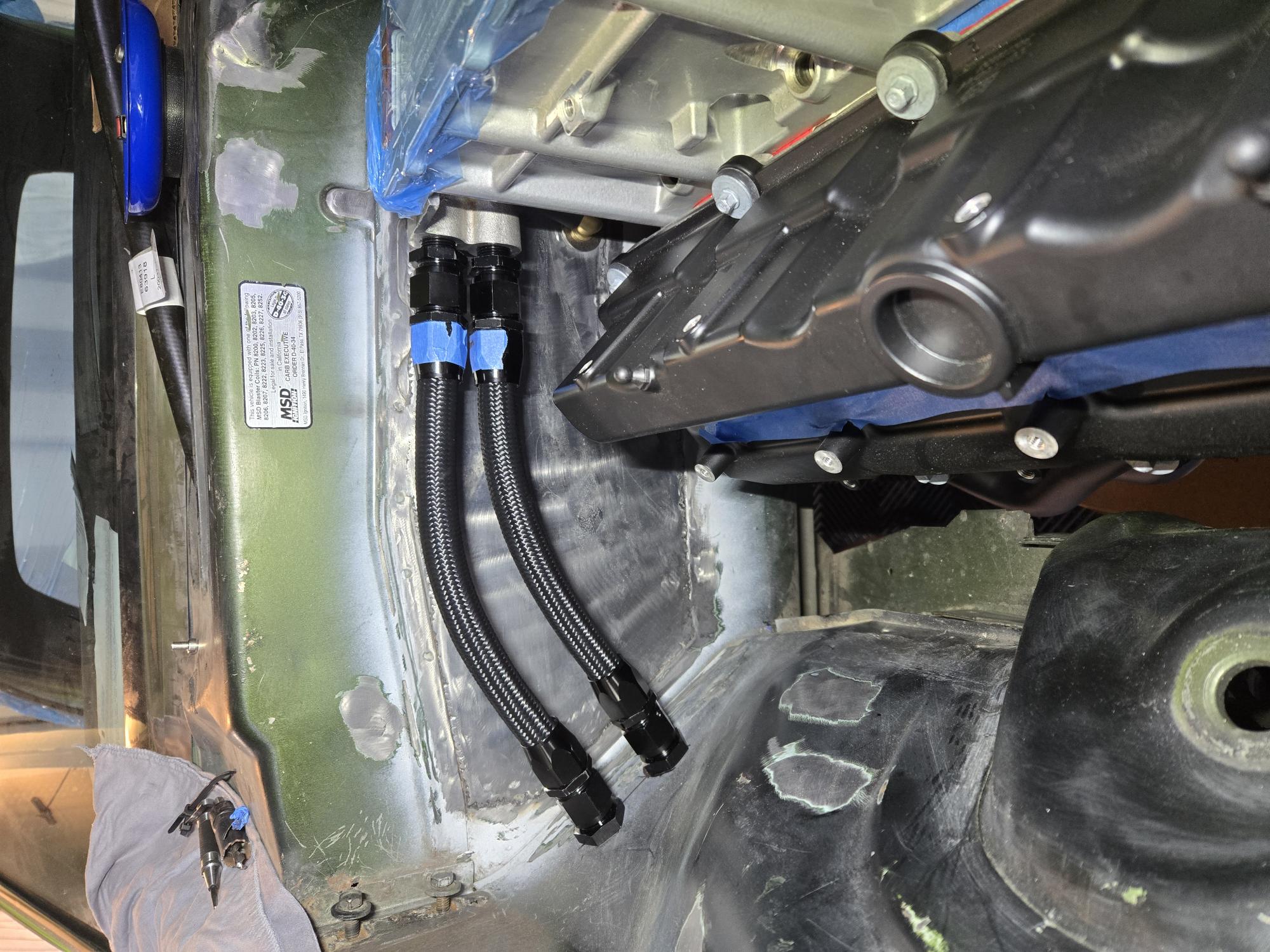

      A few more updates, I got the blower back from jokerz performance, started routing the plumbing g for the supercharger intercooler hoses. I hope to get the tank mocked up this weekend as well.

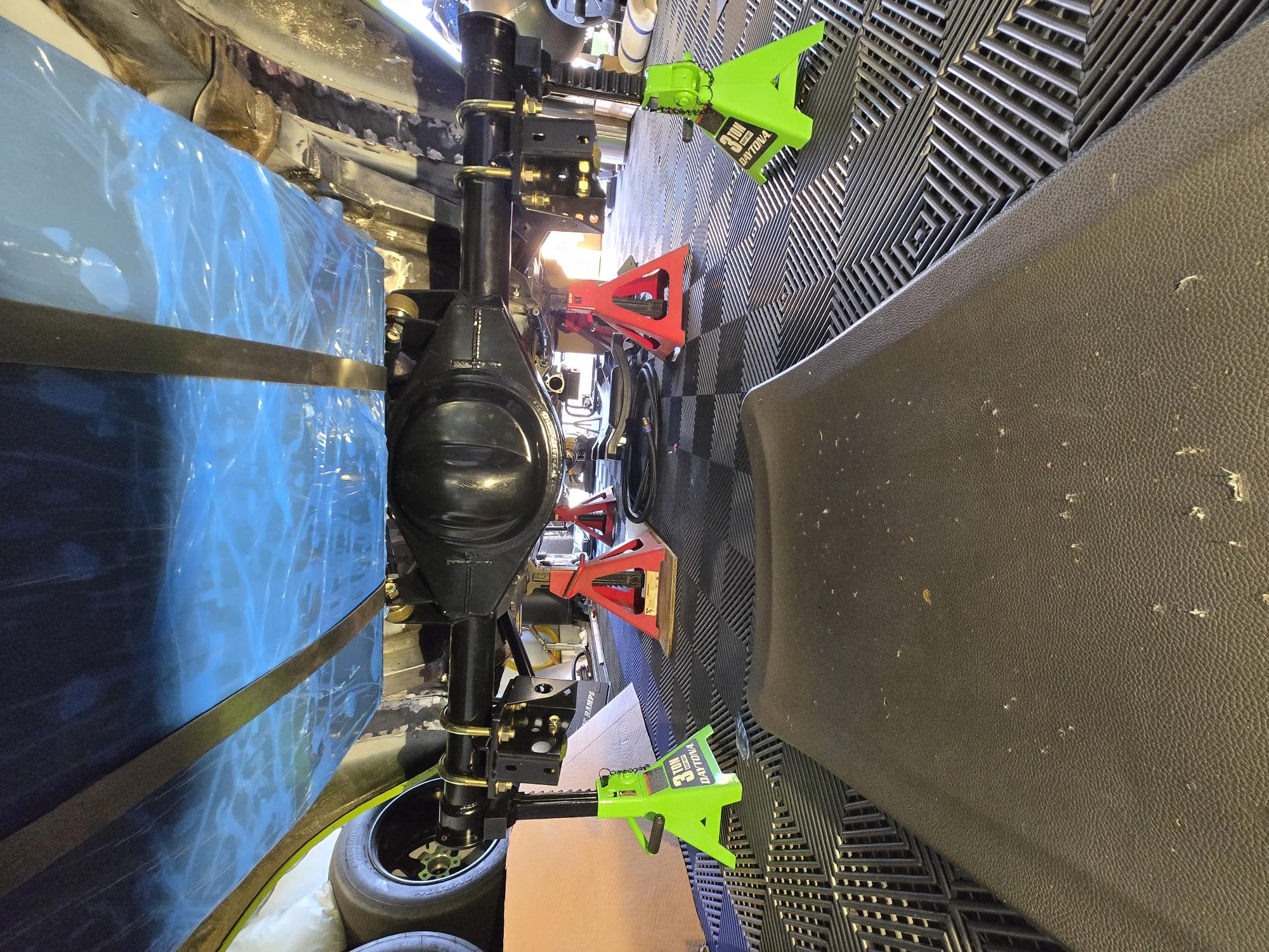

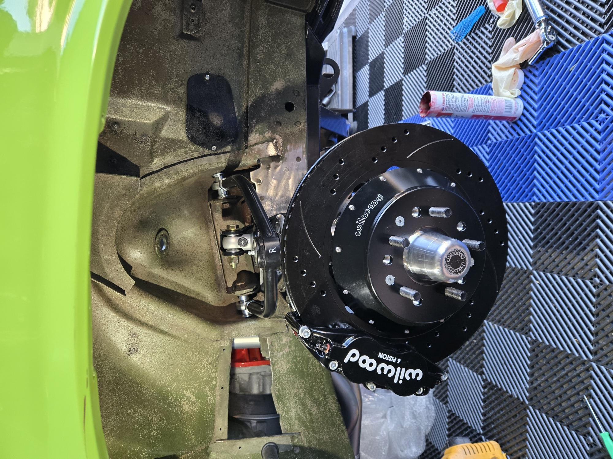

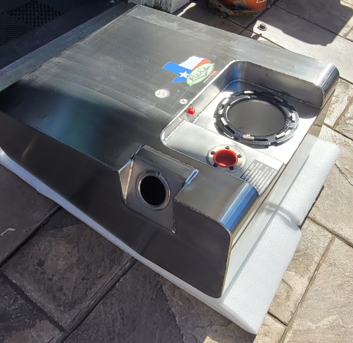

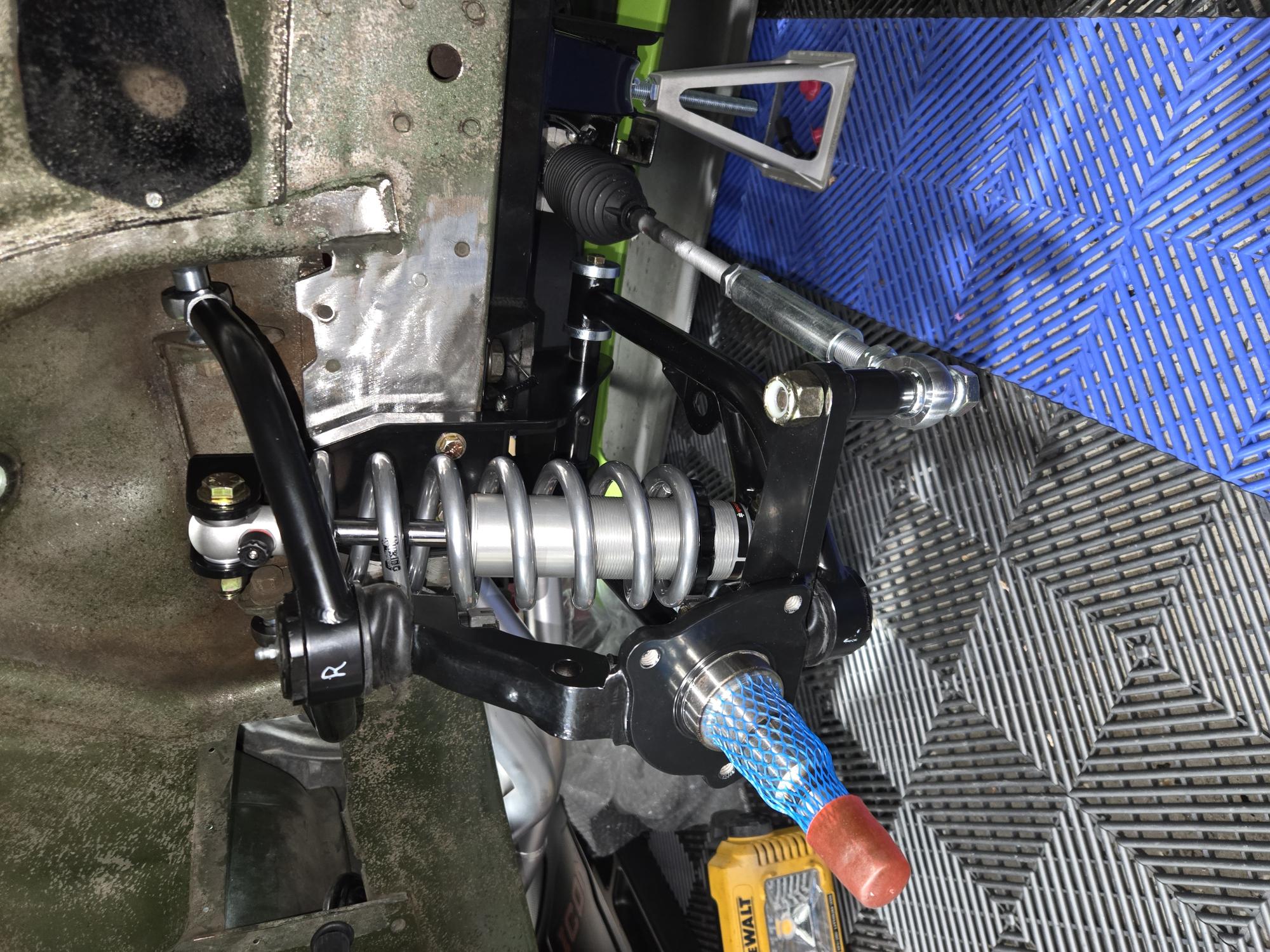

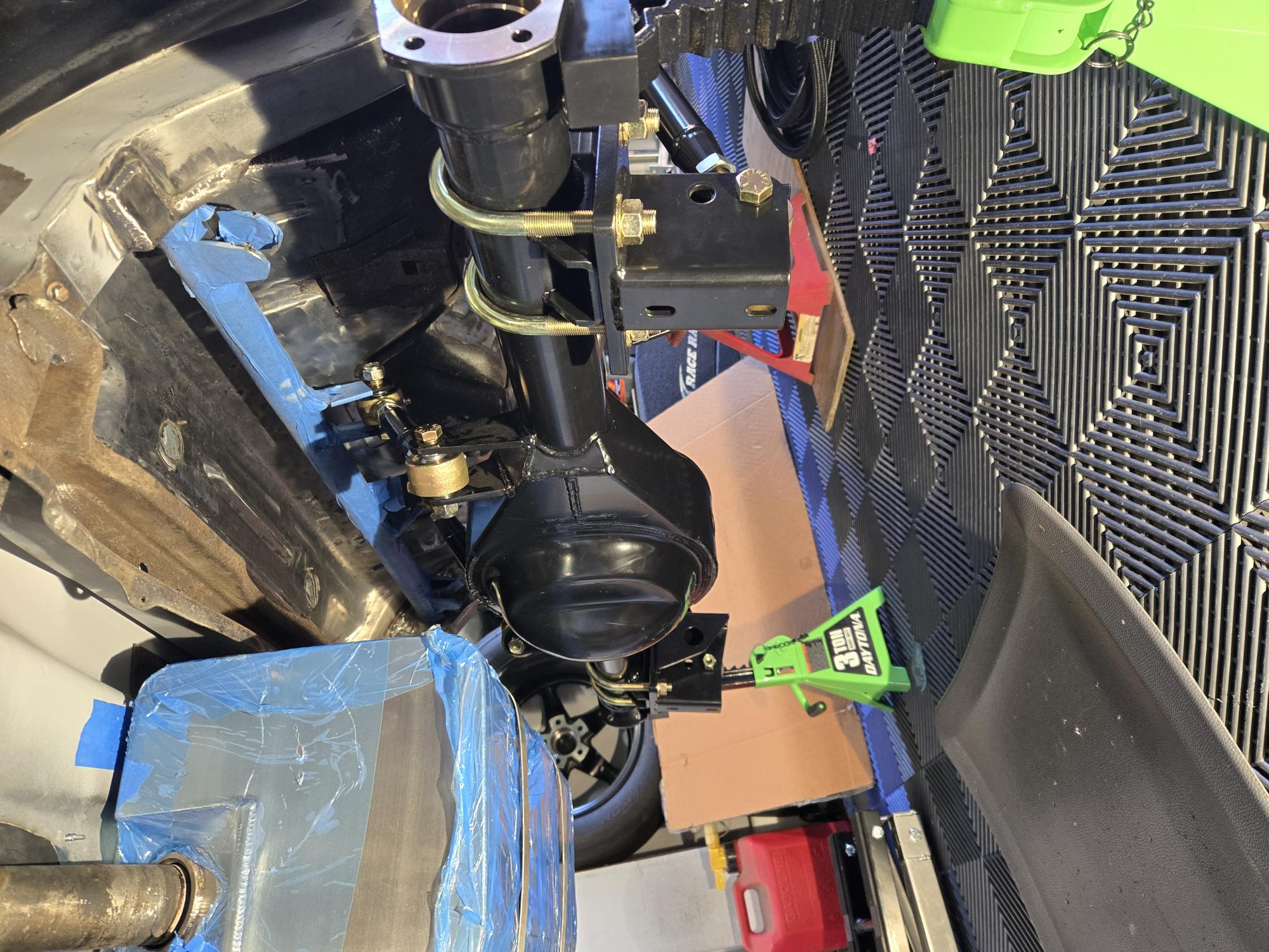

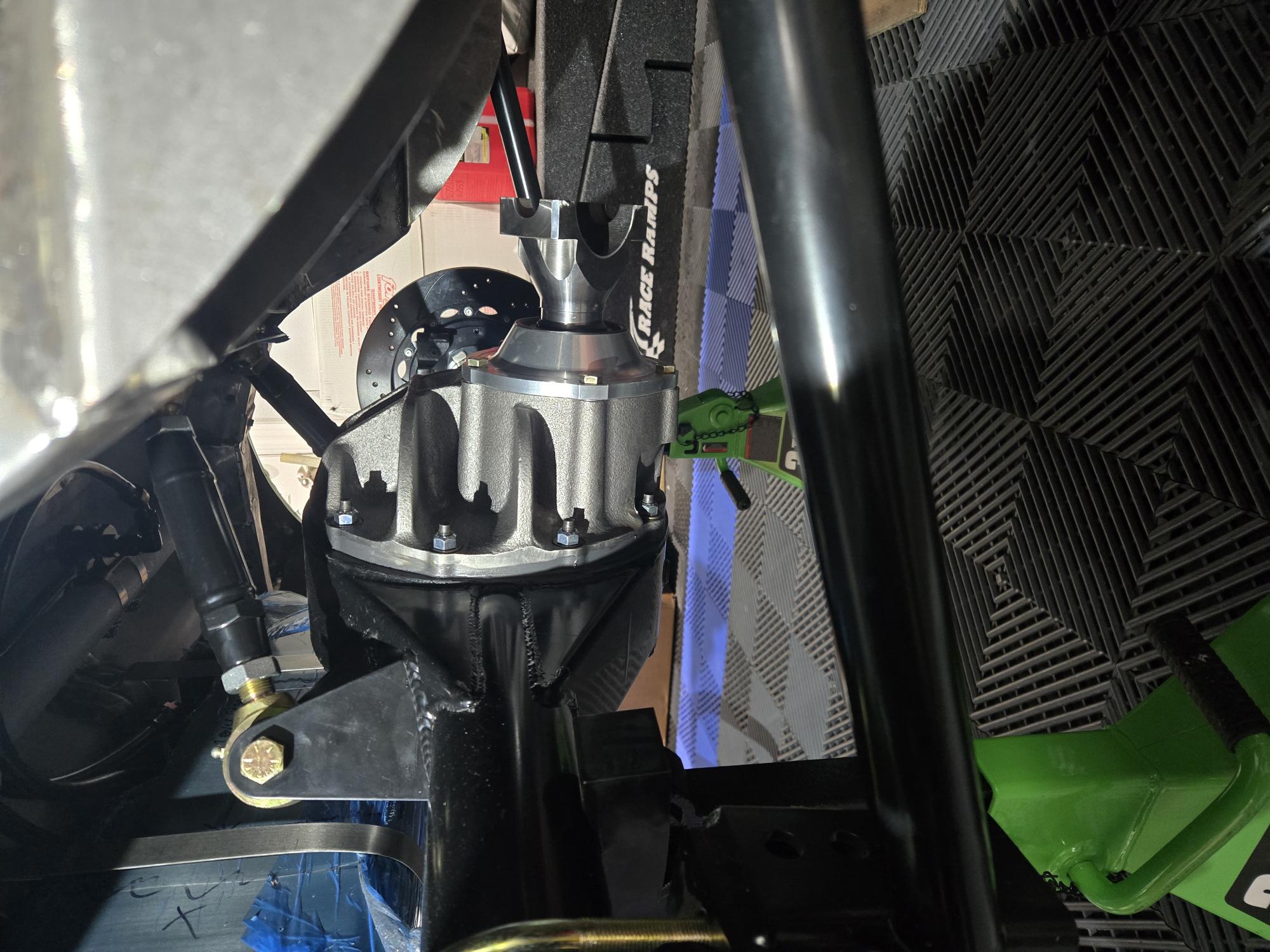

      It's been a little while since I have posted an update but lots of progress. Front suspension is complete, gas tank installed, rear suspension mocked up, coolant hoses ran for motor and supercharger. I will mount the coolant tank in the trunk with a davies craig pump.
      I also got the blower back from jokerz performance, with their race package.
      Next it to work on rear brakes, and get the rear end completed. Ordered some tubing so I can mock up the intake. Once I get everything mocked up, tear it down, epoxy paint the underside and spray the raptor liner.

      It's been a while since I posted. Made lots of progress the last couple of months. I got the front brakes done, rear end is complete, fuel system sorted and lines routed, trans & oil coolers mounted. I'm also converting to Rallye style gauges and dakota digital. Vintage air was delivered last week. I will get that mocked up this weekend so I can figure out the hose routing and make some hoses. I also got the electric brake booster mounted. I still need to make a cover but I need to run the lines to the master cylinder first.
