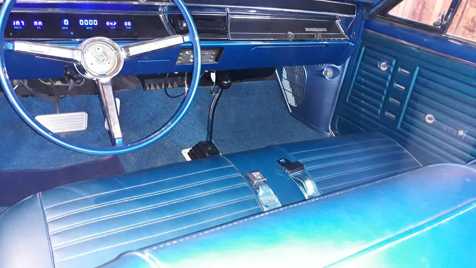

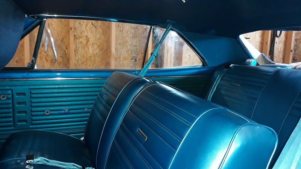

      Ok, been a while. Life got in the way but I fInally got something done to report.i put the complete interior in from carpet to headliner. Need to finish up the steering wheel and dome light yet. First time I’ve sat in it since I got it 10 years ago. ��. Name:  13F4F1E9-77D8-498E-AA21-46740AE11F7B.jpeg
