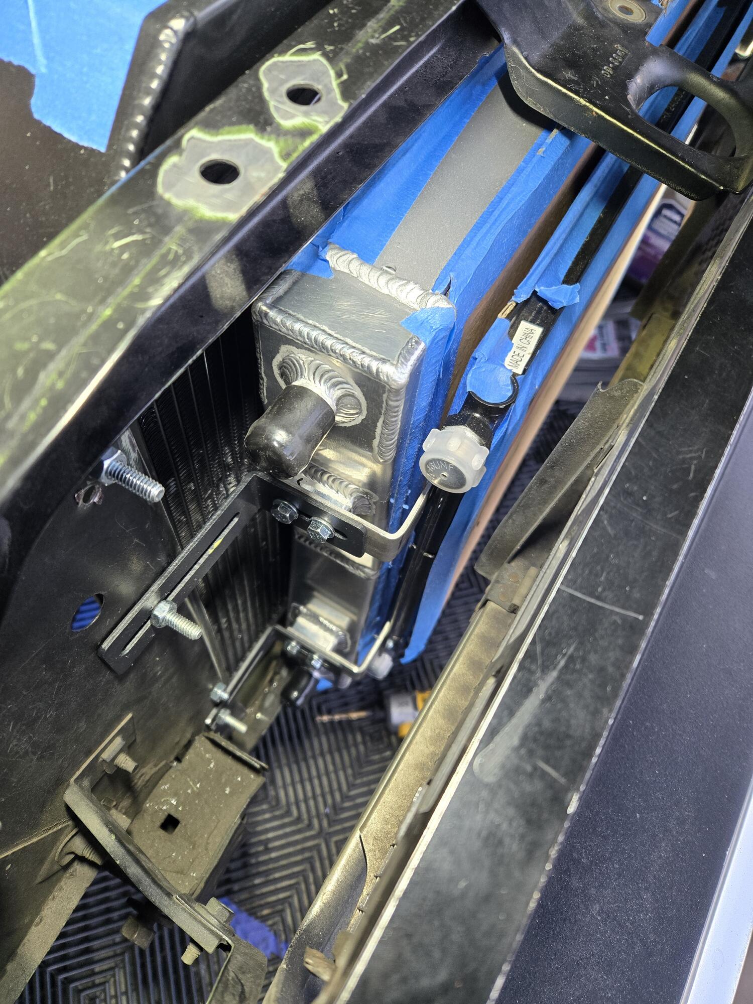

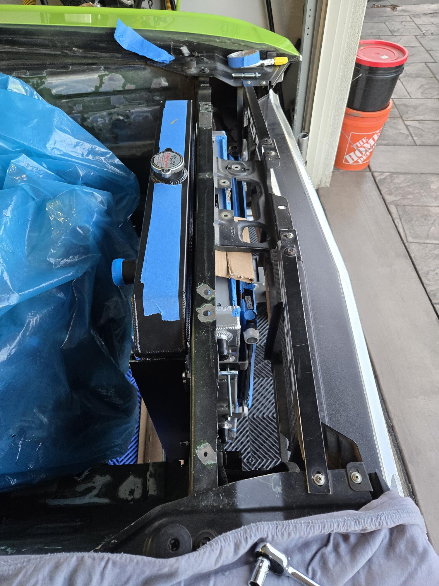

      I ended up removing the hood latch support and will run hood pins. This gives me plenty of room up front to move everything forward. I have the radiator mounted to the core support now.
      I'm running dual 12" spal fans with a total 2850 cfm rating. Name:  20250116_170019.jpg
Size:  391.4 KBAttachment 215980Name:  20250116_165708.jpg
Size:  412.9 KBName:  20250120_170819.jpg
