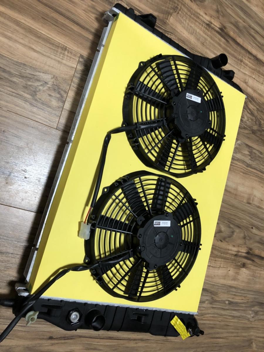

      I’ve been around the site but haven’t been posting much on the car. I’ve been getting closer but yet so far away... I just got some of the 3/8” Vapor Guard hose in from Holley along with all of the fittings to finish up the fuel system.
      I didn’t feel like laying under the car tonight so I started playing “arts and crafts”. Got the measurements down on the 4th gen radiator to make the fan shroud. I’ll cut/bend it up tomorrow over lunch and get it thrown in the car this weekend. Then it’s down to finding the right coolant hoses!

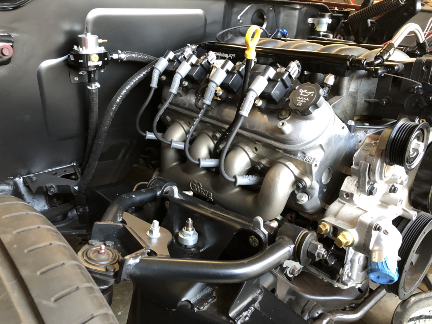

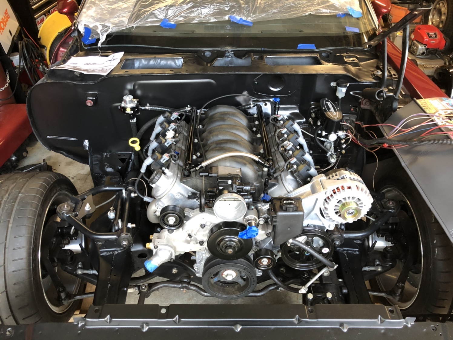

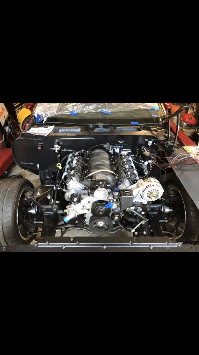

      It’s crazy how I’ve actually got a lot done but it still looks the same... one step at a time! Fuel lines are ran, now it’s buttoning up the coolant system and wiring the Terminator X!

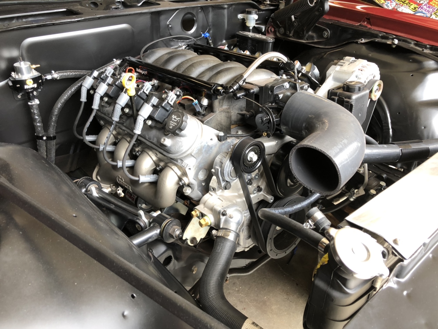

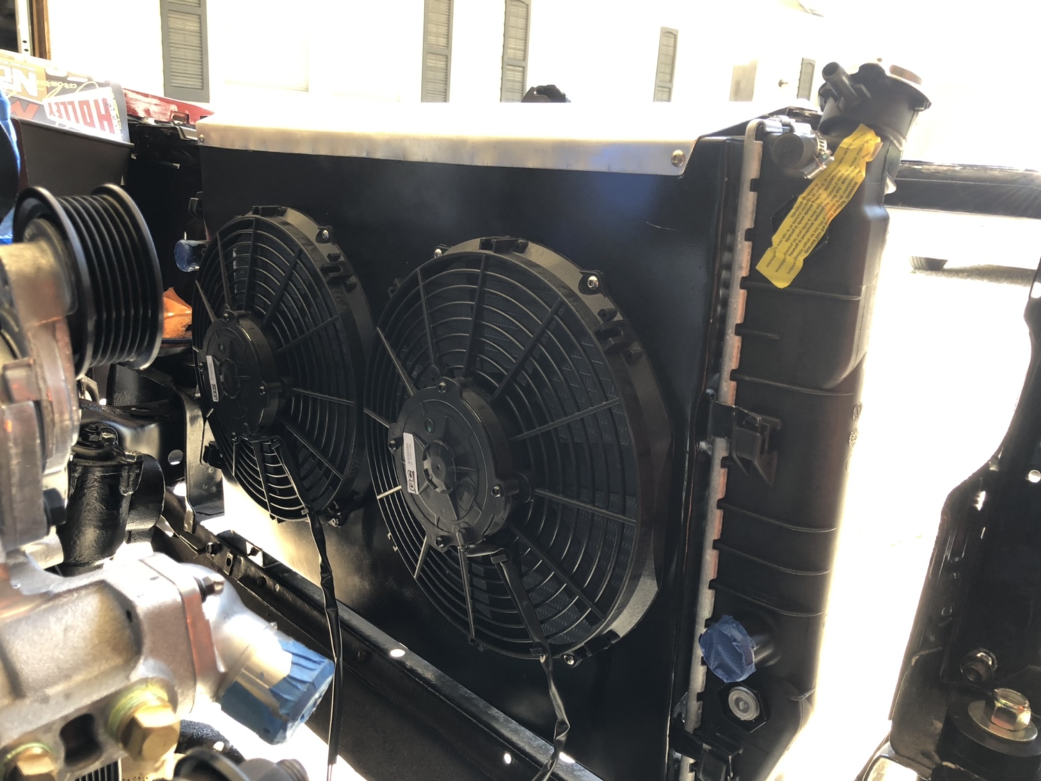

      I suppose being stuck at home right now isn’t a bad thing. I found a ton of motivation yesterday and was able to spend almost all day (and until 2 this morning) in the garage. I got the fan shroud finished up, made a new hold down, and got everything mounted in the car. Lokar throttle cable is hooked up. Fuel lines are all done and mounted up in the car. Now to figure out coolant hoses and wire the car.

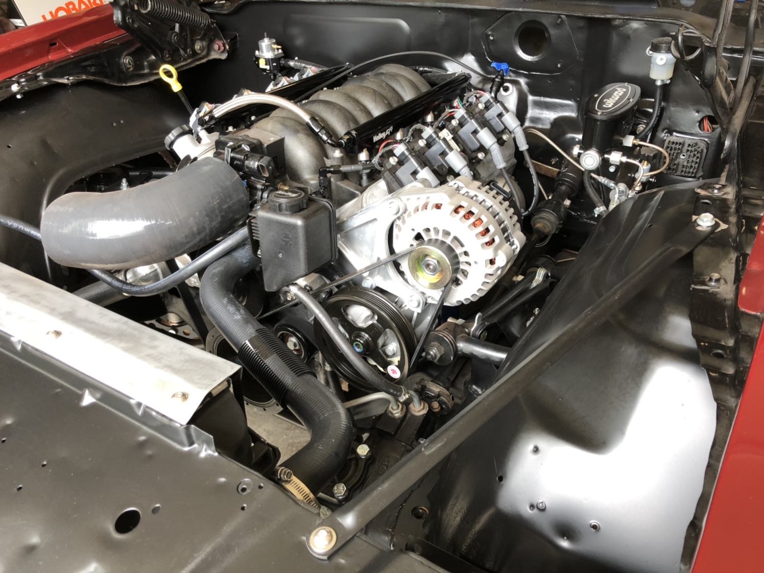

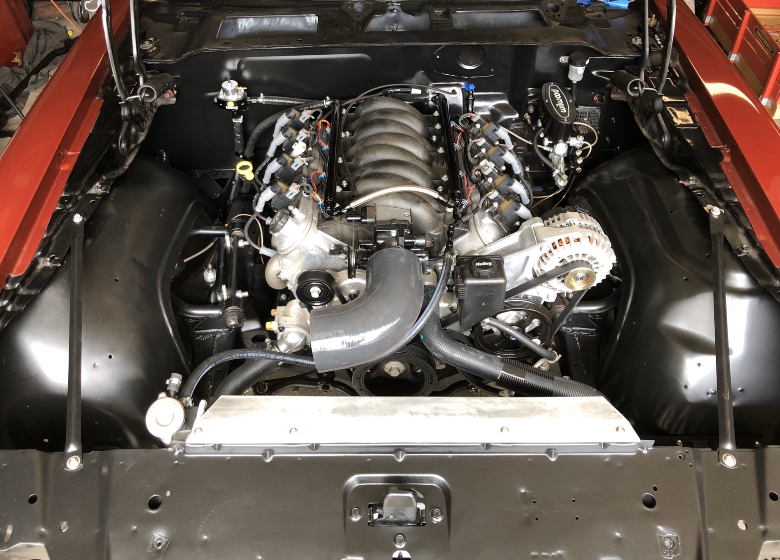

      A little more of an update! Hung the inner and outer fenders this past weekend. Coolant hoses figured out (who would’ve guessed that one from a 2003 Windstar van would fall right into place...). Getting ready to wire up the car, going to pick on andrewb70 for some tips and info so I’ll be sure to post that up too! Car goes in for exhaust next week. I couldn’t be more excited to see this thing going together.

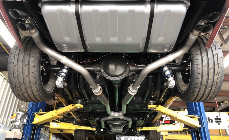

      Had our local exhaust shop (M&M Exhaust) bend and weld up the exhaust on the car. Under the rear like the cars here and clear as could be. I’m happy with the way it came out!
