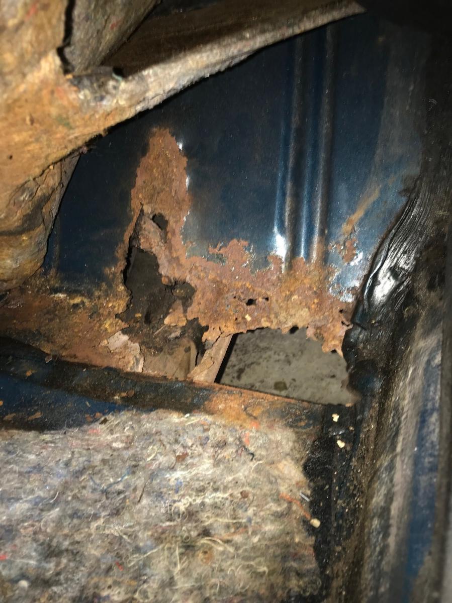

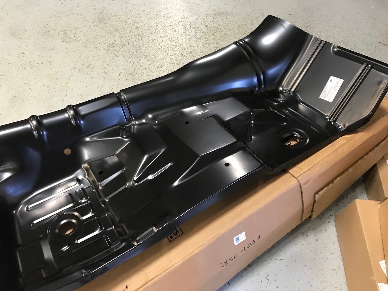

      I've had the car over at Herb's shop (newly named Rotten Metal Garage) for the last few days. We're tearing into it a little more, fixing some things that I've ran across, and also starting on the coilover kit (Going with this kit: https://www.ridetech.com/products/su...maro-firebird/). The car does need some love in a few spots. It's got some rusty spots (I have to keep telling myself it's almost 40 years old) that are really bugging me so I'm going to address that while it's here. The heater core leaked and rusted a spot that's about 8" wide up by the toe board. I've got a new floor pan that we're going to cut up and weld into place. On the rear end of the car, I just need to do some wire wheeling, and coat it with some paint.

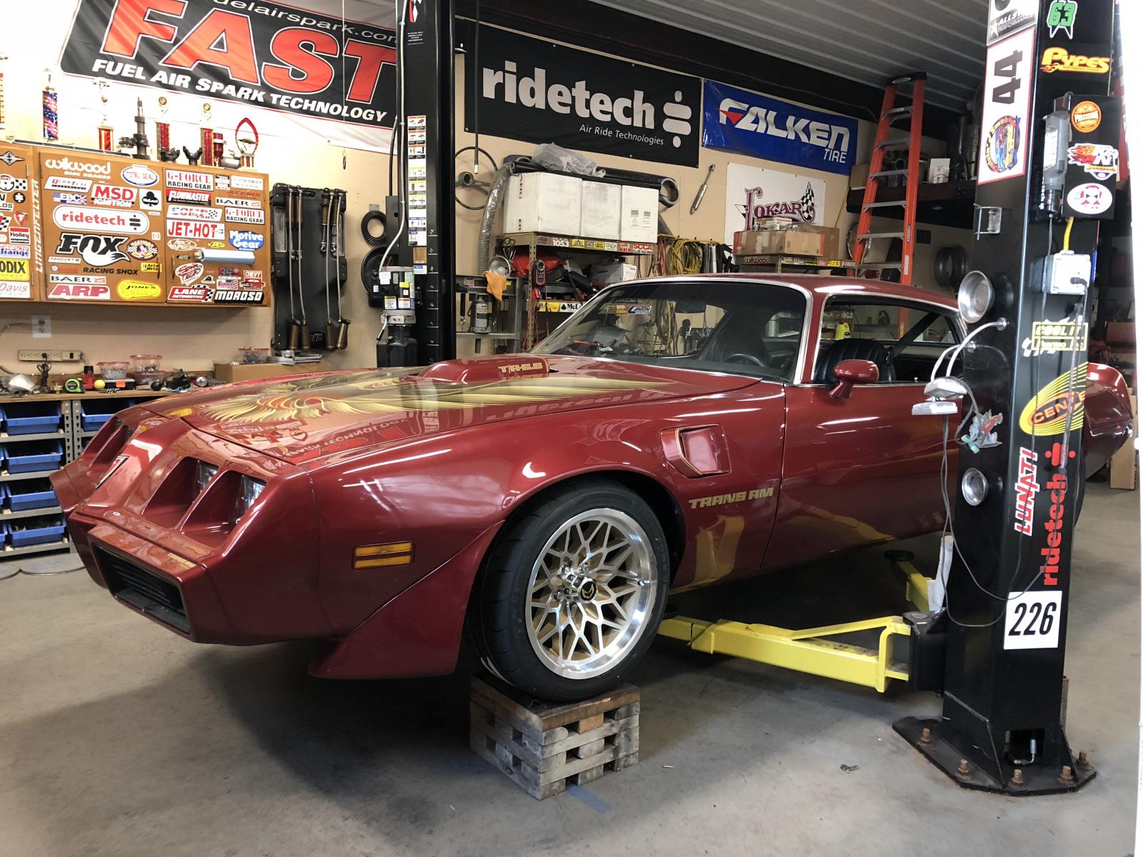

      Last night, we put the new arms, coilovers, and new sway bar on the front. I've been sitting on these wheels for a couple of weeks so I've been itching to snap a picture of the car with them on it and at the even lower height.

      Same issue as me Josh! Keep us posted on this! I need some pointers on doing a floor pan and toe board due a leaking heater core.

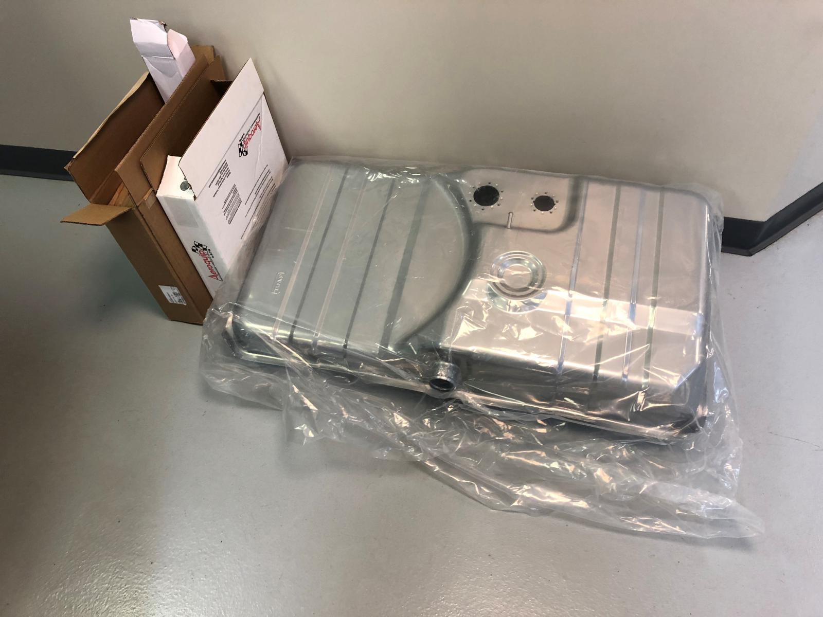

      When I bought the car, it had a fuel cell in the trunk for whatever reason. It was removed and replaced with a new Tanks, Inc setup. It had an ungodly loud Holley fuel pump, with the previous setup, so I did opt to go to an in-tank pump as well. It was a super nice kit for the price!

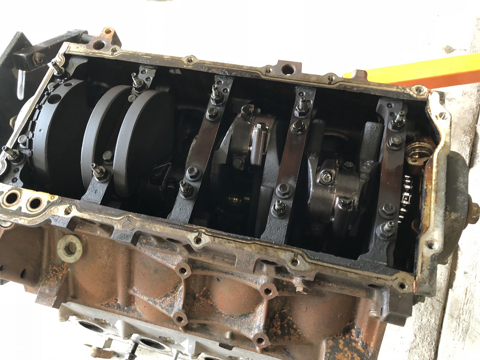

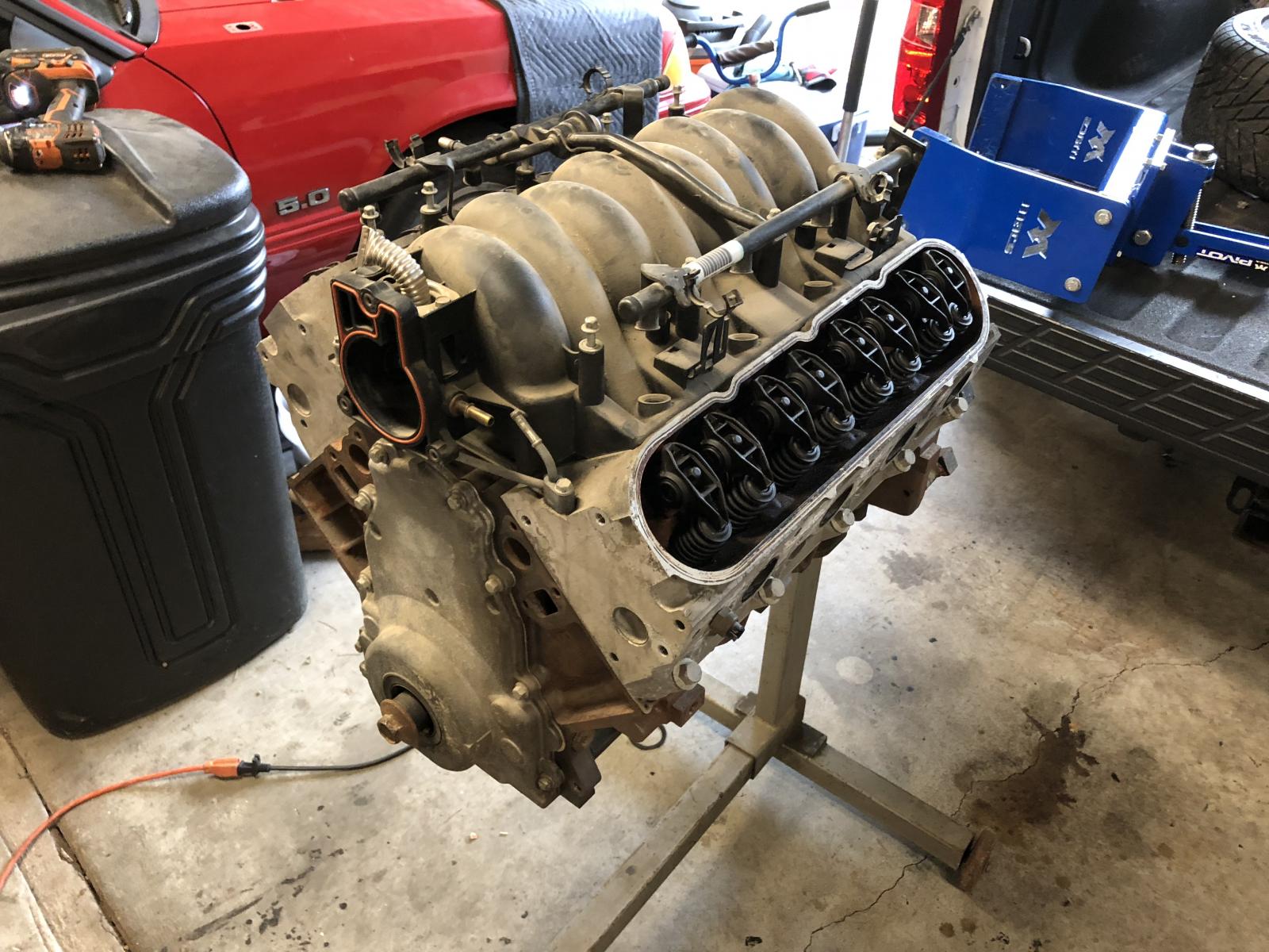

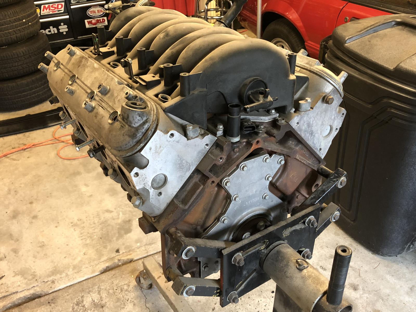

      For the last update, I picked up an LQ4 6.0 over the weekend. It has roughly 60k miles on it, ls1 intake, and some other goodies that came with it. It was in a dusty garage for a period of time but cleaned up nicely. The plan is to throw a different cam in and run it. I'm not going to get all fancy with it just yet, I'm just ready to yank the 400 out of the car. Once I gain some more money, I'll be in the market for a T56 takeout from a 4th gen Camaro/Firebird. I will then put the engine on my other subframe and shove it in the car! I'll get some more pictures but here's how it sat when I got it.

      I had an 81Z28 with similar rot in the right hand floor. I actually found that the seam sealer was bad at the top of the cowl and that let water in run down the fire wall on the inside.

      I'll have to look into the cowl area as well, I appreciate the tip. I'm 99% sure that this was caused by a leaking heater core (or a few of them over the years). It appears that someone either didn't want to replace it again or just didn't care about having one in the car because it is nowhere to be found .

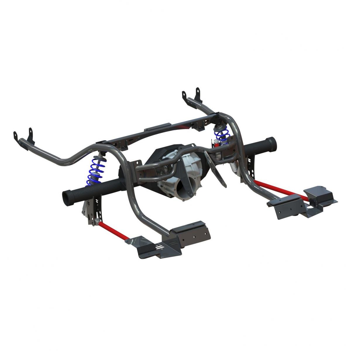

      Without a doubt, I can't wait to take that picture for comparison. With these wheels only having the one option for backspacing, I was a little unsure of being able to fit a 275 in the front. Now that everything is on, it does appear that there is plenty of clearance for a bigger tire. All of my previous builds have had the pipes going over the rear, I never even thought about going under. However, we've had several shop cars in the past with the tailpipes going under the axle housing and the only time you'll see it is when the car is on a lift. Holley just developed this 3" exhaust system on our 48 Hour Camaro and it turned out great. You'd wouldn't know it was on the car unless it was pointed out.

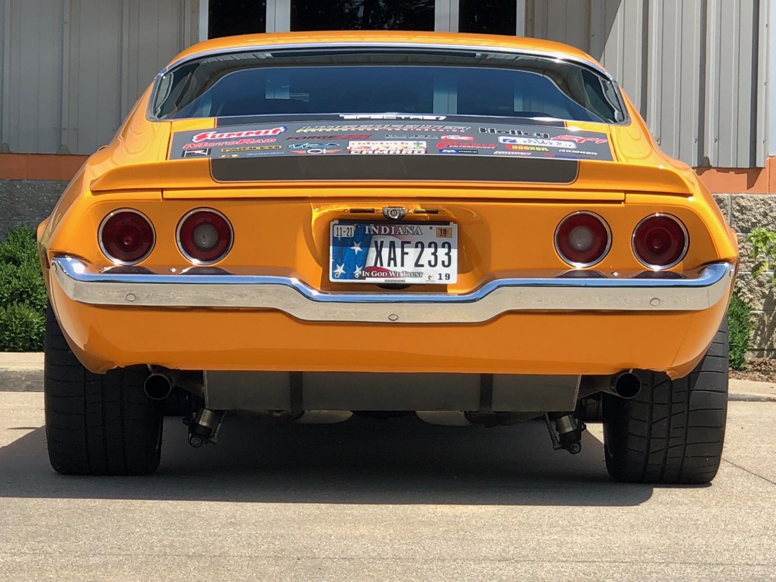

      Here's a shot from the rear of the car to show how nicely the exhaust is tucked away.
      On the subframe connectors, they can be ran, however we do not. The Tiger Cage in our car is a great chassis stiffener so we don't typically use them. As far as them being a "need", that's more of a preference. If you want a street car, the coilover kit makes the car corner much better all by itself and doesn't necessarily need that much stiffness. If you're wanting a corner carver, it would be a decent idea to to look into a cage or a set of subframe connectors.

      I'm not saying anything riveting here, but sub frame connectors are essential for any 2nd gen putting down decent power that is going to get worked.
      In order of descending structural assistance for any 2nd gen:
      1) Sub frame connectors
      2) 8 point cage
      3) Cowl to front sub frame bracing (like what F-Body International / Lab-14 offer)
      And if you're going this route you might as well toss in at least poly-body mounts if not solid aluminum ones.
      The Camaro pictured above does appear to have some inherent integrity added via the design of their rear suspension. Based on what I can tell they are at least partially benefiting from the bracing. I'm not sure if that car has a cage or not. Regardless, sub frame connectors would provide significant benefit.
      There are several options available. DSE offers a great kit although the installation is more extensive than others being that they run 'within' the floor pans. The benefit here is that you don't lose any ground clearance. If you're building a street car that won't get beat on time and time again...no, you probably don't NEED sub-frame connectors and would likely over build the car. However, if you're trying to get the maximum potential out of a 50 year old design; yes. You need them.

      This is what I was getting at. I'm not disagreeing with you at all. The car's definitely weren't built for the power levels and autocross events that we have today. The kit that we build can facilitate a street car build or can be added onto to create a track car. It just depends on how far you want to go into it. As far as our new four link, we're not losing any ground clearance at all. We create our own "frame rails" that run right next to the factory ones with this kit to add strength and a stronger mounting point for the coilovers.
      Name:  CAD 2nd Gen.jpg
