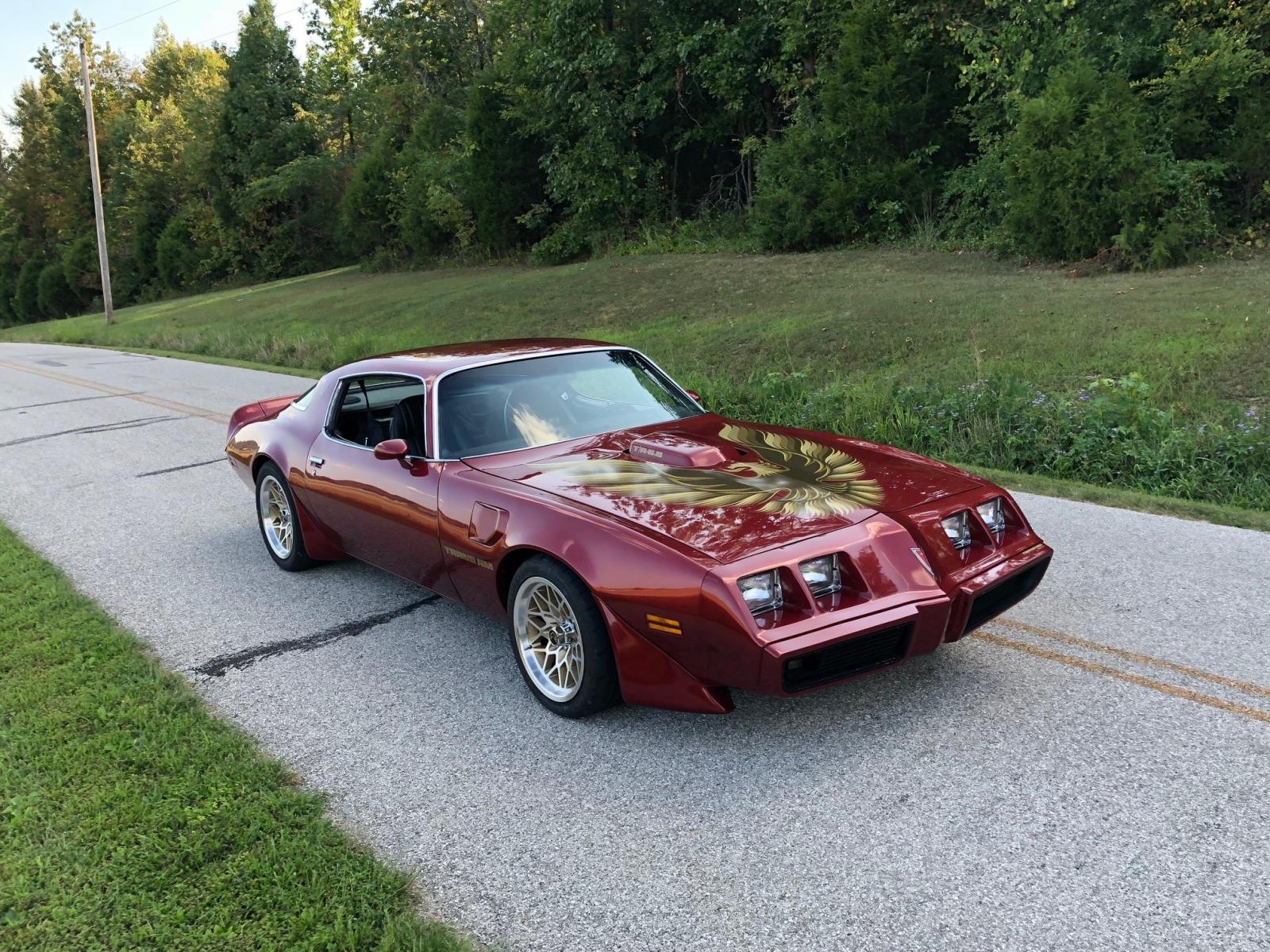

      The car has been back on the road for a few weeks and I'm very happy. The Tanks Inc. tank was a great fit and SO much better than dealing with the 10 gallon fuel cell (especially in a car that gets 8mpg on a good day...). Our coilover package gave me the stance and performance that I've been wanting. The car is going to a mixture of a street/performance restomod so I'll be updating as the budget/time allows! The new stance and wheels made a huge difference!
      Attachment 156065

      I'm slow... I had a few issues right before I put the car up for the winter actually. I noticed that there was some antifreeze in the oil catch cans when I went to empty them so that only means a few things... I found out that I have a set of the Castech 706 heads on mine which is where I'm believing my issue is coming from. The head bolts, gaskets, and everything else is new. I think one of the heads has a small crack in it. I've got another set of heads and gaskets that I'm putting on it when I pull it back out along with the cam swap.

      Thanks! The four link rides very nice as well but the handling is on a different level. As far as it being better suited with the TruTurn, it's not that it won't work with the streetgrip components, we just built that coilover system to correct all of the geometry issues that we could (which required tubular arms). I've had many guys run the Streegrip in the front and coilover system in the rear (or vice versa) with nothing but good things to say.
