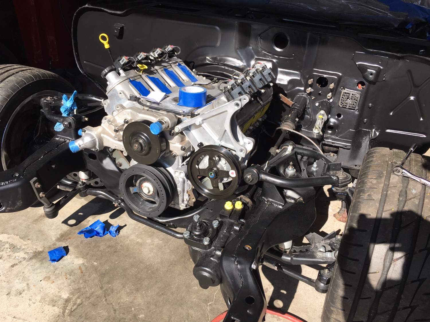

      Got some more parts on! Because I'm running our pre-truturn control arm setup on the front, my control arm setup utilized factory second gen spindles which have almost zero decent brake options. I switched over to the CPP spindles that are set up for C5/C6 brakes. Nothing crazy brake wise now, just some factory replacement Corvette brakes. The one thing I did upgrade to was a C7 hub.

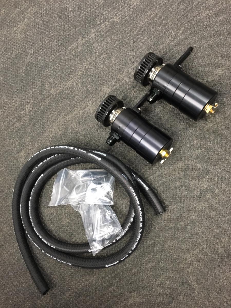

      Also got in my catch cans in from UPR Products. I figured two would be useful when I throw some boost at it ;). I used these exact same ones on my Mustangs and loved them. They've actually ventured out quite a bit with these and do quite a few setups for newer cars as well.

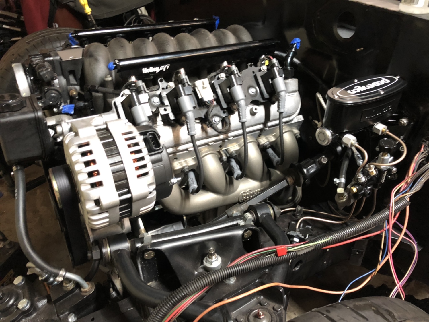

      Haven’t posted an update for a little bit, everything else is keeping me quite busy. I’ve ran all new brake lines, got all of the Wilwood components on, intake/fuel rails are on, and Hooker cast manifolds on. I just need to find the time to paint my core support and get the coolant hoses figured out. After that it’s just running fuel lines and the Holley Terminator X. I can’t wait to hear it start up!

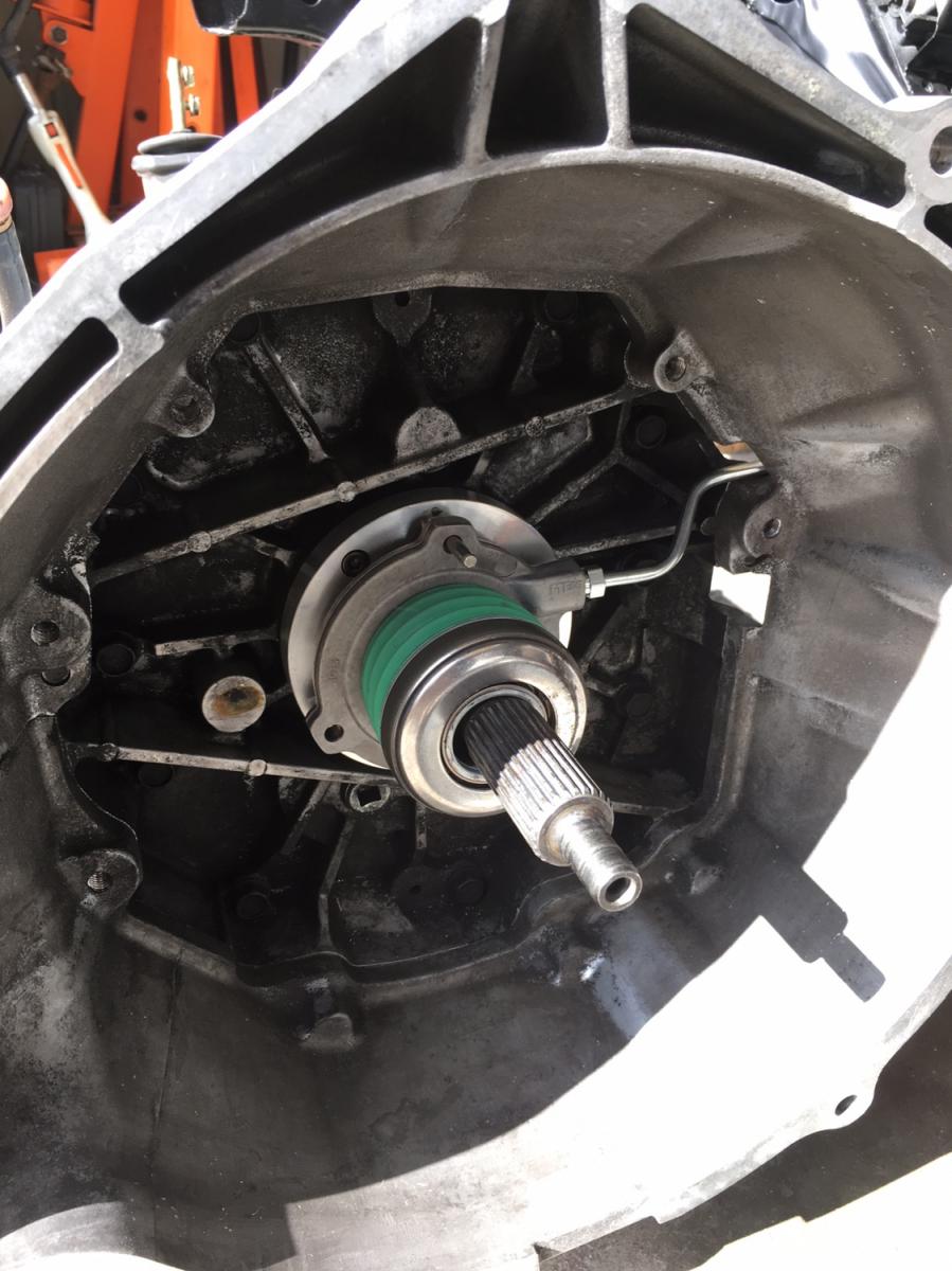

      Quote Originally Posted by Josh@ridetech View Post
      What slave is used? Looks like an adapter plate also? Curious why there kit does not use a stock 98-02 f-body slave. I am working on clutch stuff and wondering if there are better options now then the stock f-body stuff. Thanks
