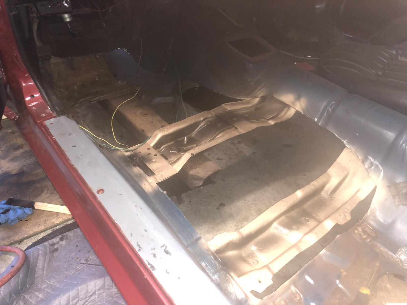

      Passenger side toe board and drivers side pan have been cut out and replaced. Apparently I need to take more of it in it's finished state...I'll add those later.

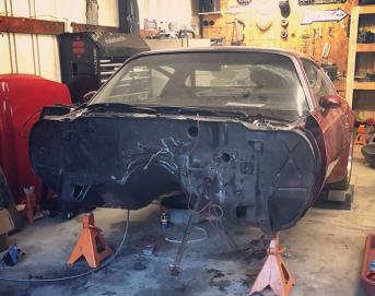

      Initial tear down

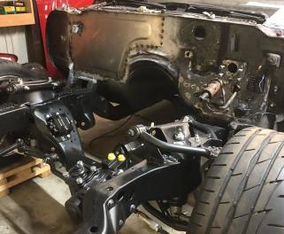

      Pulled the original subframe off to replace it with another one that I had blasted and powdercoated. I had a ton of cleaning to do, finished welding in the bottom side of the floor pans, replaced body bushings.

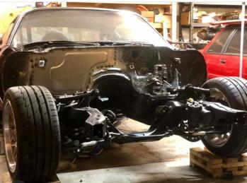

      Mock up block on the new subframe with the the T56. I used the stock clam shell mounts along with the Holley engine and transmission mounts. Got it rolled under the car to check clearances on the factory shifter hole. I ended up cutting into the factory floor brace about an 1.5" to get everything where it worked well. Braced it all back up and she's ready to rock.

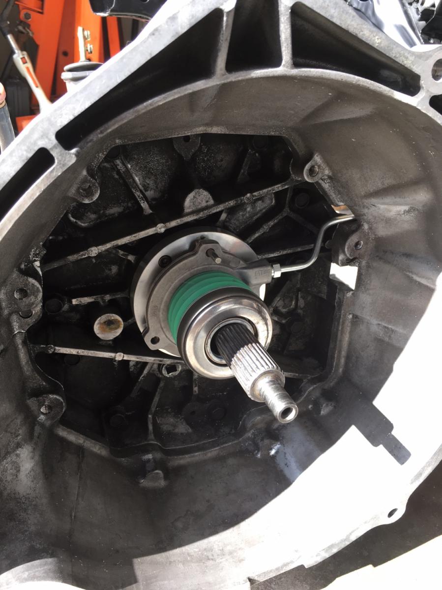

      Just a few more updates! I'm using the Silver Sport Transmissions hydraulic setup to get the T56 up and going. Its been a very easy kit to work with. At the moment, I'm trying to save a little cash so it's just getting a stock LS1/LS6 replacement clutch (as much power as I'd like it to make...let's face it, it'll be way more than enough for an N/A 5.3 ).
      I've mocked up the bellhousing on the engine to make sure the throw out bearing had proper cushion. The measurement from the clutch fingers to the transmission mounting surface was right at 2.06", compressed the throwout bearing with a straight edge and measured to the face of the transmission. I came up with 1.80" on the second measurement, giving me .260" on the bearing "cushion". Everything looks to be where it needs to be, time to bolt the engine and trans together and get it in the car!
