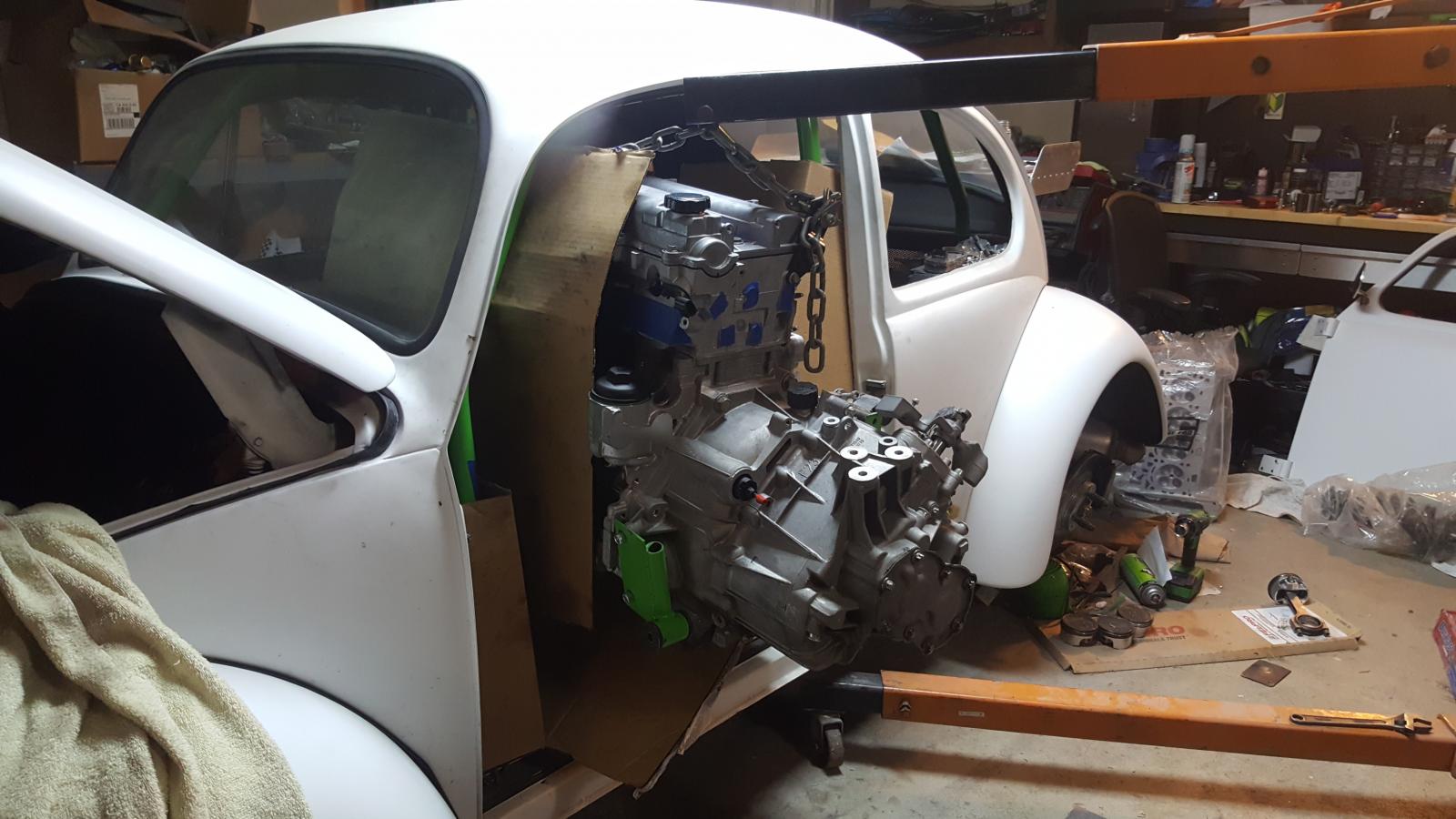

      Looks like its going in, through the door again unfortunately...

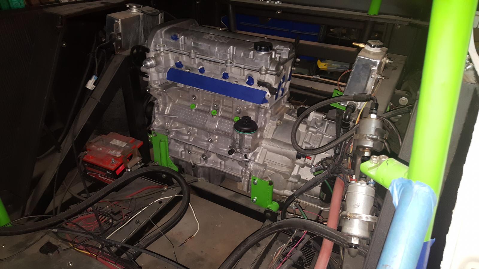

      And a few hours later... and after a lot of sweating....it fit.

    6. #206
      Feb 2016
      SoCal
      475
      Quote Originally Posted by Switta View Post
      WOW ! very cool build nice work .
      Dave
      Thanks Dave. Cant wait to drive it again.
      Quote Originally Posted by Kenova View Post
      Removable subframe and car hoist.
      Ken
      Ken, I will inform the designer of his very bad design and make him do the engine swap next time. If it was up to me it would have been removable.

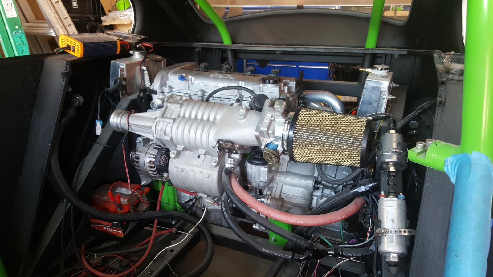

      I think it will run today.

      I ran it for about 45 min yesterday. Found a few minor issues. 1st issue - it is way louder then it was before. Apparently bumping the compression 1 point makes that big of a difference. 2nd issue - oil psi. I was hoping it was going to be lower this time around since it now has oil squirters. Nope, still have crazy oil psi. Lowest I saw it get was 55 psi at a 1000 rpm hot idle. Cold idle, 80 psi. So thats about 5 psi less then the last engine. Might have to mess with the relief spring. 3rd issue - this thing sucks to put coolant in. Pretty sure there is still a bubble in the system but the fan kicks on and turns off as it should. Temps are good. The best part is that there are 0 leaks!
      So I might bolt in a seat and take it around the block tonight. The tune seems to be pretty good so might as well try to drive it. Its a little fat at idle (12:1) but revs up fine. We will see what putting a load on it does. I still see a couple hours of street tuning in my future.

      Well I took the Bug for another spin this morning. I actually had the laptop hooked up this time to log and its making a lousy 9 psi of boost. I cant really go much smaller with the pulley either. I already had to clearance the snout to make my current pulley work. I think ATI makes and oversized balancer. Might be next on the list... I am hoping to hit 14-15 psi. Will post the video of the run shortly.

      Thanks guys! It is still a blast to drive despite being low on boost. I am guessing its 50hp down from where it should be. 50hp on 2000lbs is a big deal. If I can get the boost up to where it should be, its going to be scary.
      WFO - Yes it really does sound like a normal Bug while cruising! Even more so in person. That blower whine is a give-a-way though. No way to hide it either. Its just loud 100% of the time.
