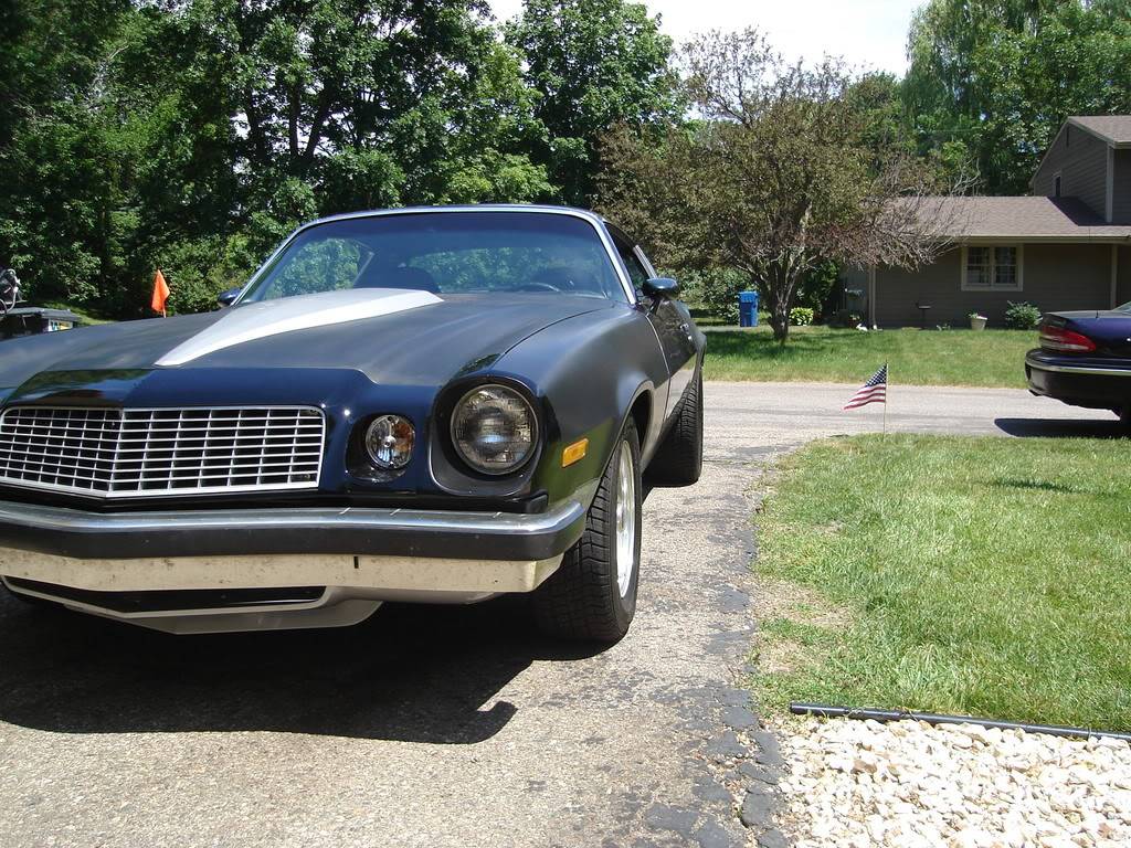

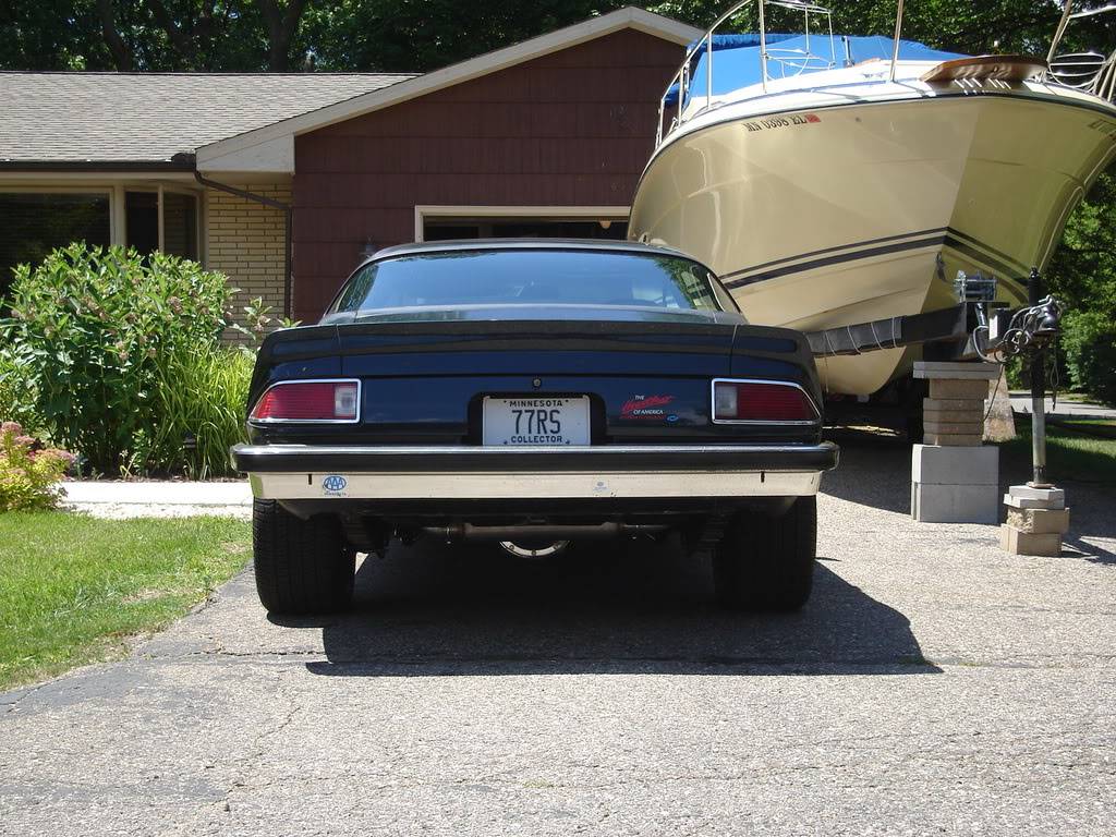

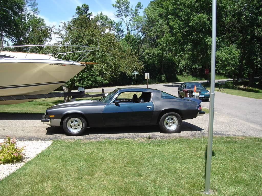

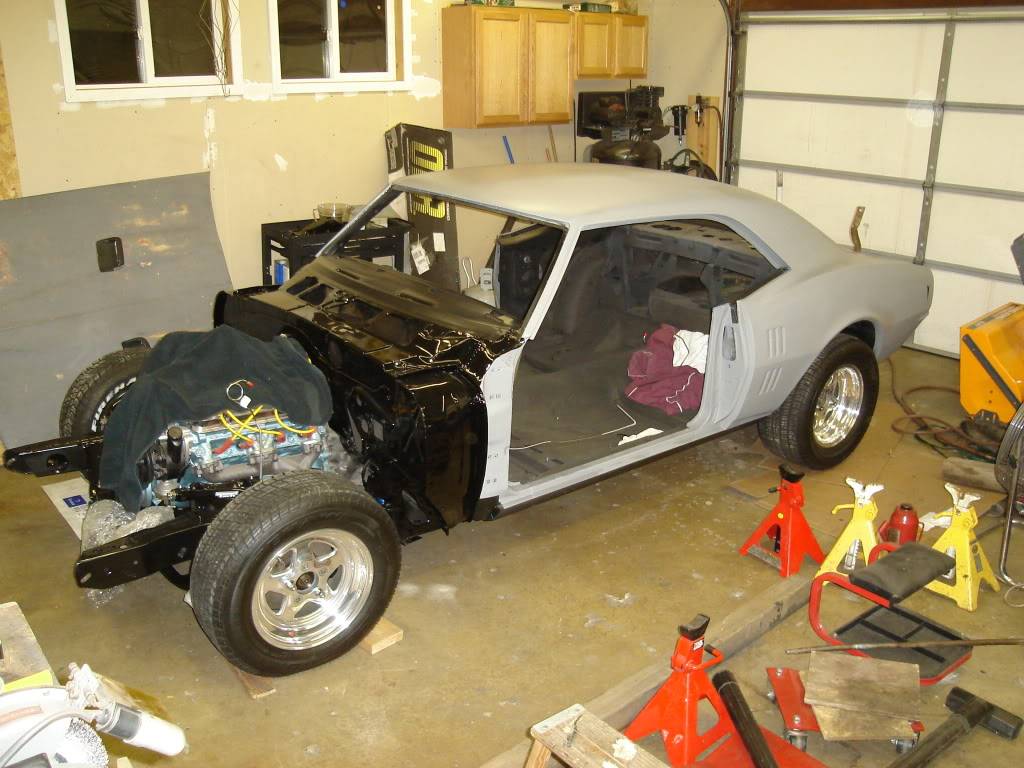

      It's been almost a year since the car has been sitting on the ground. I bolted the wheels up that were on my 77 Camaro. I'm not sure if I'm going to go this route or not. The rear tires look a little wide. I think???
      The rear tires at least do not stick out of the wheel wells. I know the car will come down an inch or two when all the weight is back on it. I also have the option of running a set of 15" Pontiac rally rims. I don't see having the money any time soon for a new set of fancy rims. Just not in the budget.

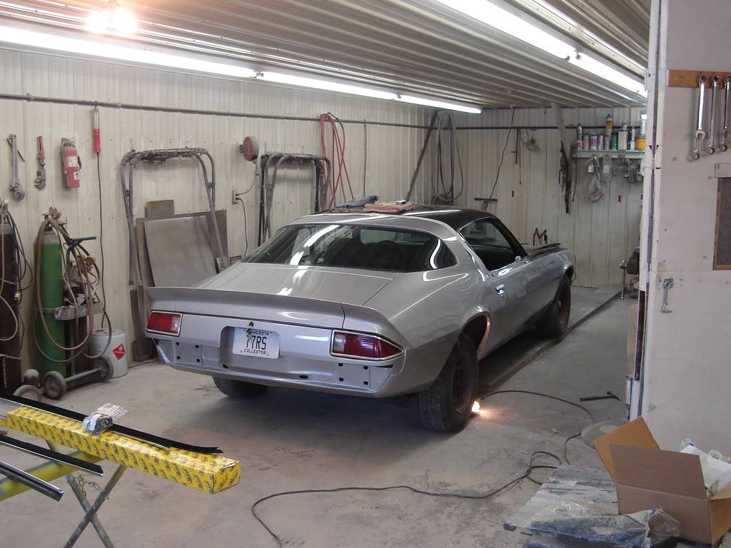

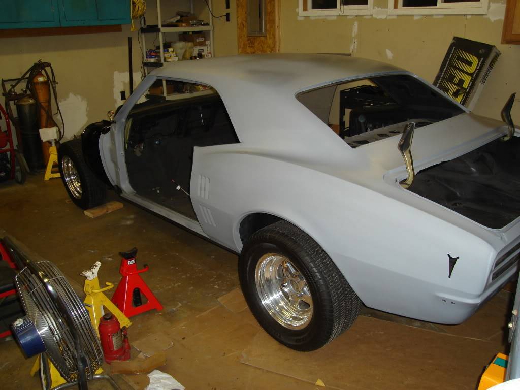

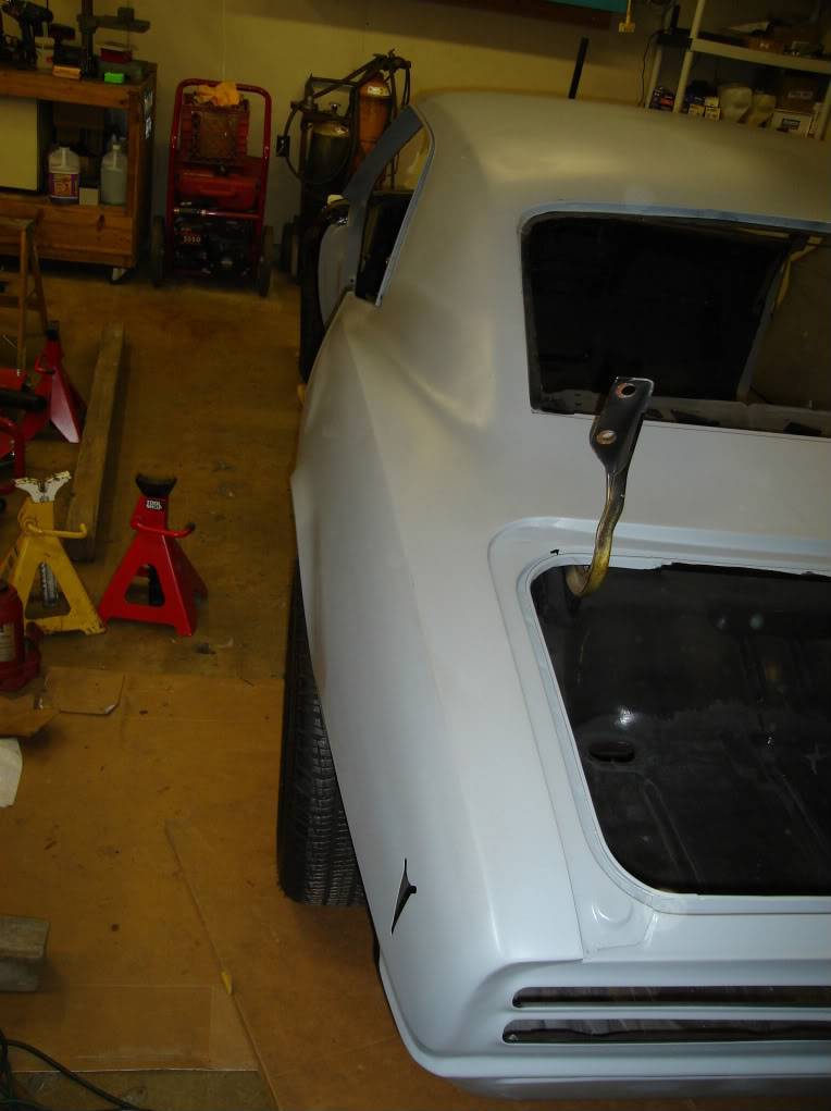

      Heres a couple of shots with the wheels on my last Camaro and one of the rally rims before the start of the resto.
      Heres a shot of my old car just out of paint.
      And heres the only pic I have of the rally rims. If I use these I would put a wider tire on them.
      Like I commented before, new rims are out of the budget for a long time. I can run the Weld pro stars with a smaller tire on the back. Or, sell the pro stars and buy all new tires,trim rings,center caps and lugs for the rallys. What do you think??

      The rear tires do look wide. I like the look of the rally II better.

      The more that I look at it I think both tires front and back look to big on this car. I think I will go with the Rally II's in 15" and some new rubber.

      I like the wheel size!

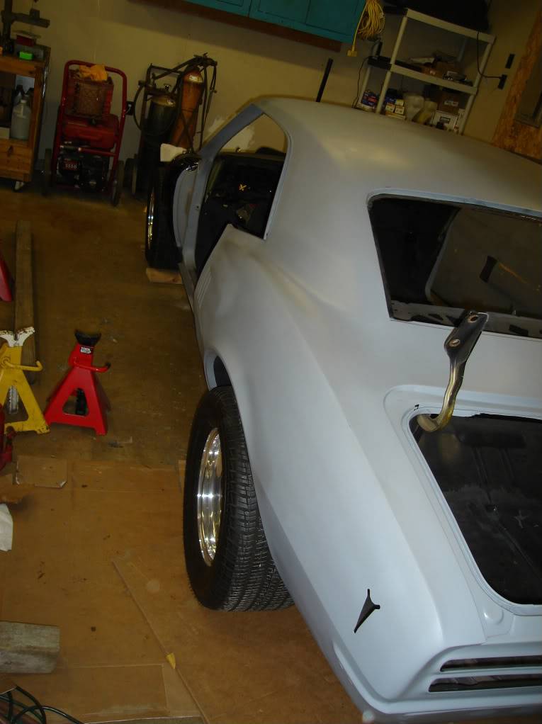

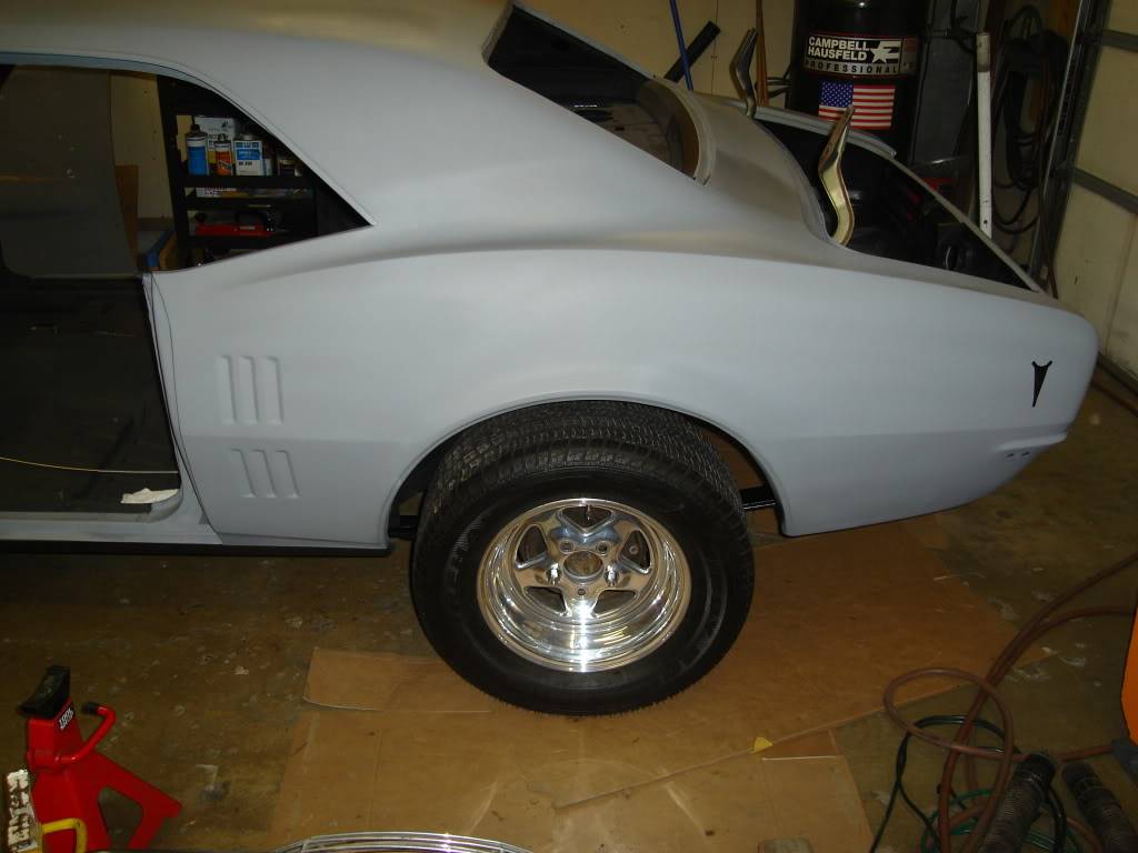

      A little trial fit of some rims and tires from my last car.
      I think the back tires are going to be to wide. I can either buy different tires or go back to the Rally II's.
