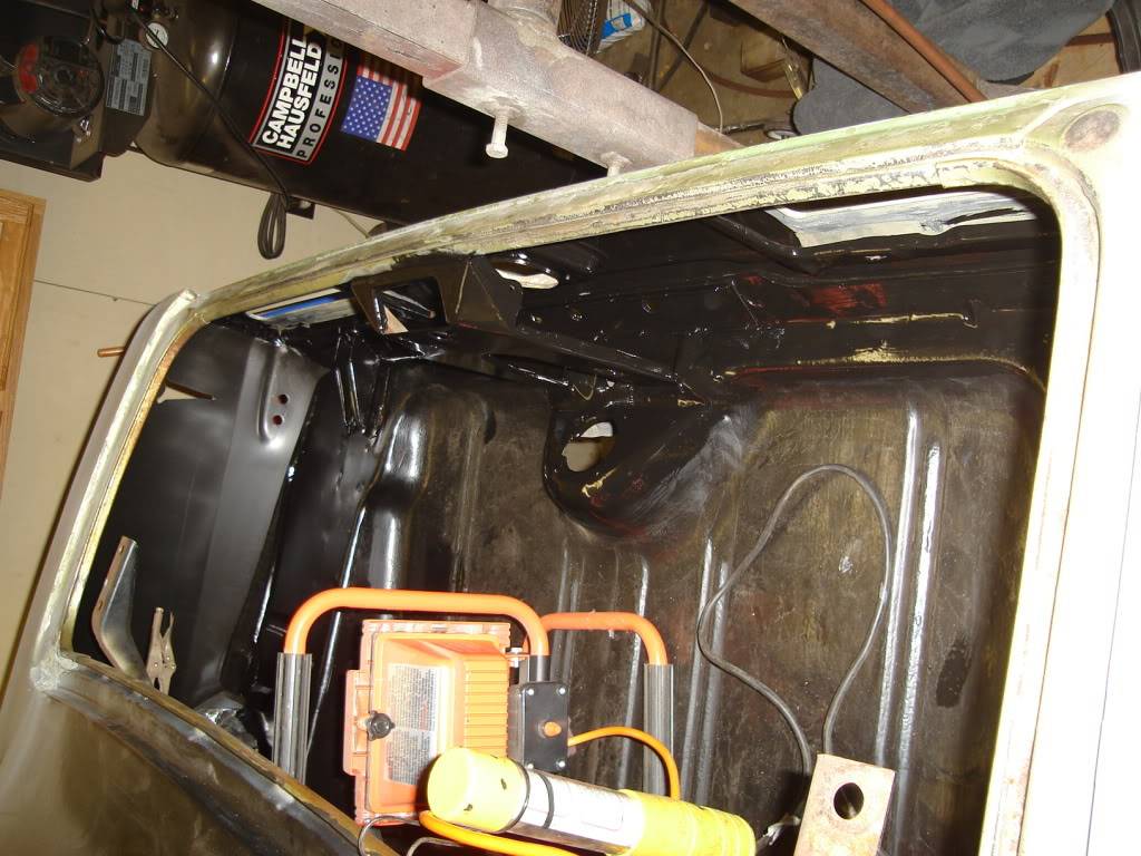

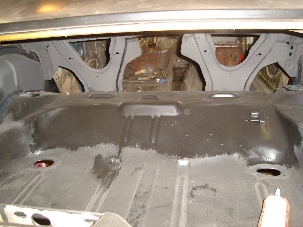

      Started working on the inside of the trunk again. I have around 15 hours into grinding down welds,sandblasting,acid etching, and general clean up of panels and old seam sealer. I have one patch welded in and a couple of pin holes that I welded close. I acid etched the inside of the trunk and put down two coats of POR15. I'm going to sand it all down with 400 and put two coats of Lizard skin down.

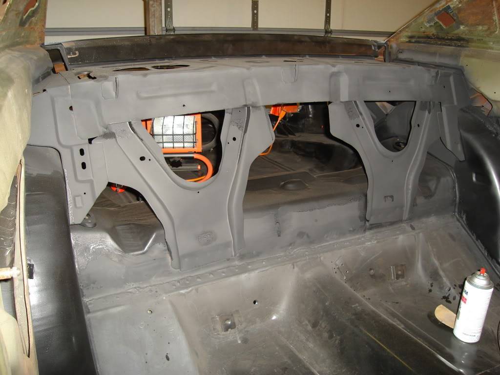

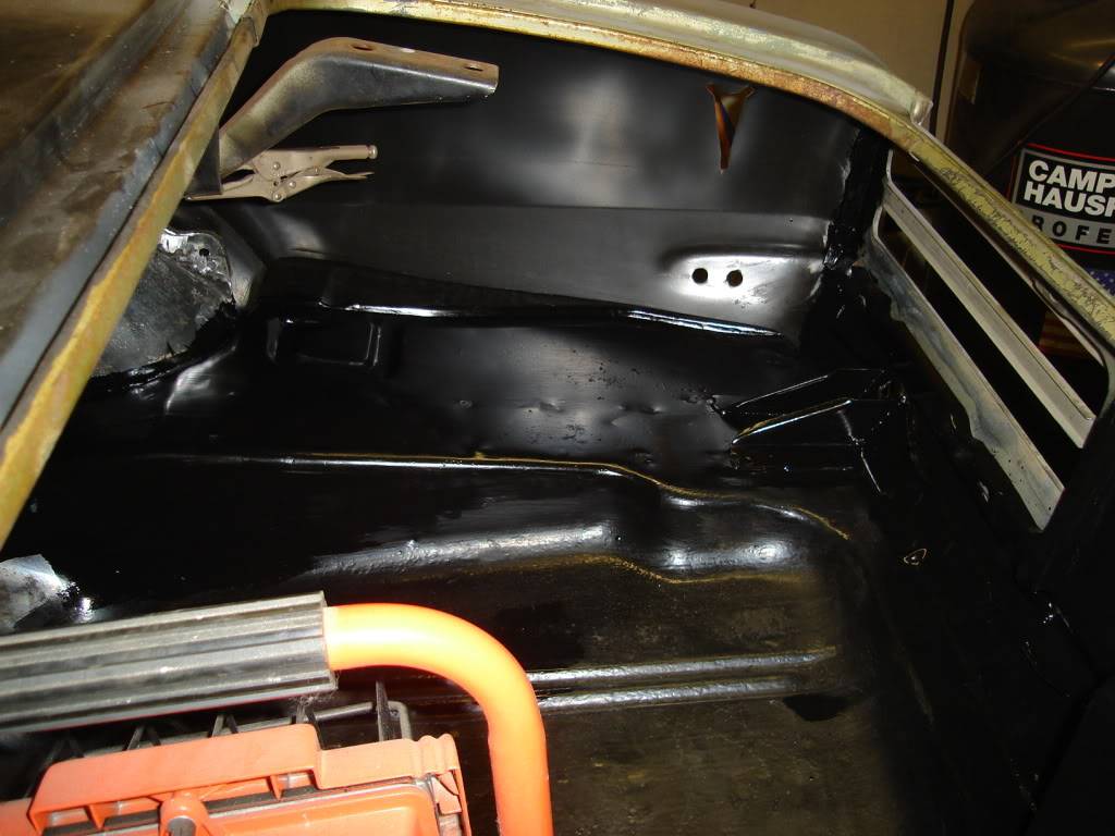

      I did some work in the trunk. The paint looks funny because I used two different POR15 products. One was satin and one was gloss. I sandblasted the whole trunk,acid etched, and either sprayed DP90 or used POR15 depanding on the location. This will all get scuffed down and then will get 2-3 coats of Lizardskin and then spatter paint.

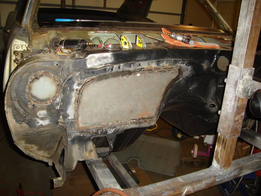

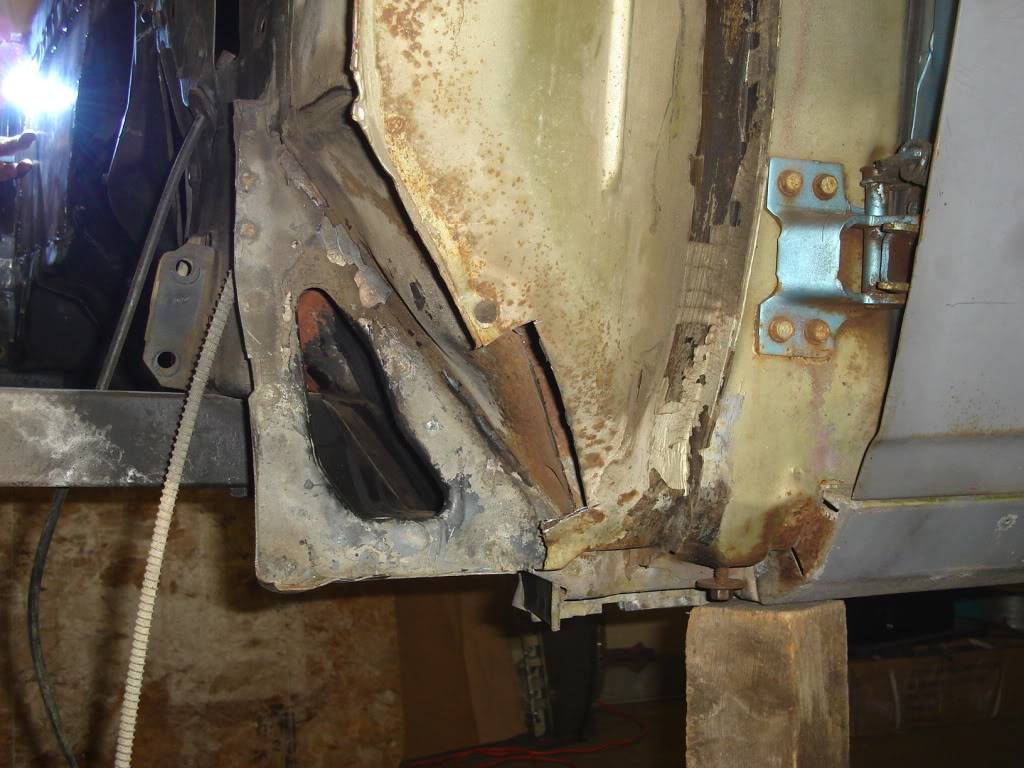

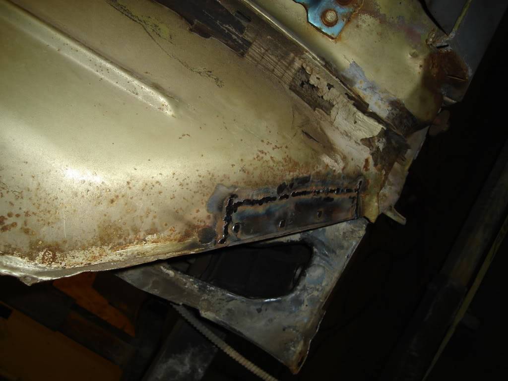

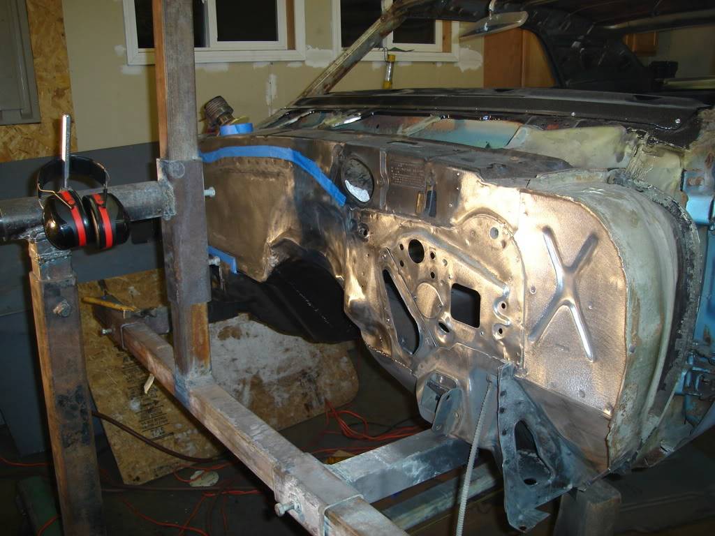

      I had a friend stop by and help this last Sunday and we decided to tackle the firewall.
      Here is what it looked like when we started.
      A couple of patches welded in.
      I had one spot on the cowl that was in bad shape. I cut out both sides and welded in new metal. All welds need to be ground down before painting.

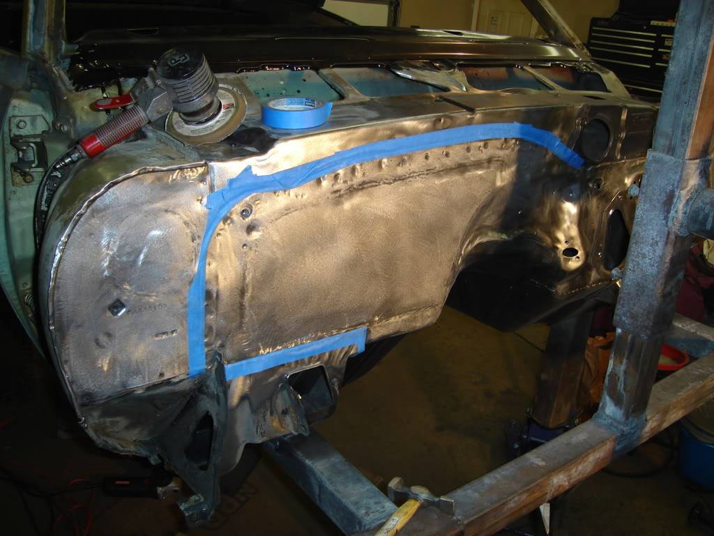

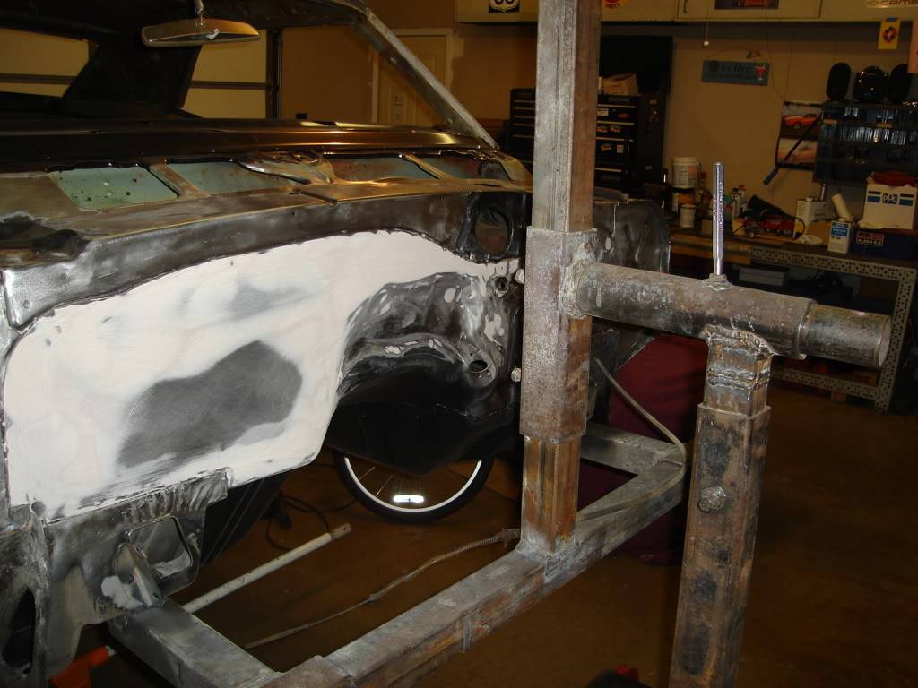

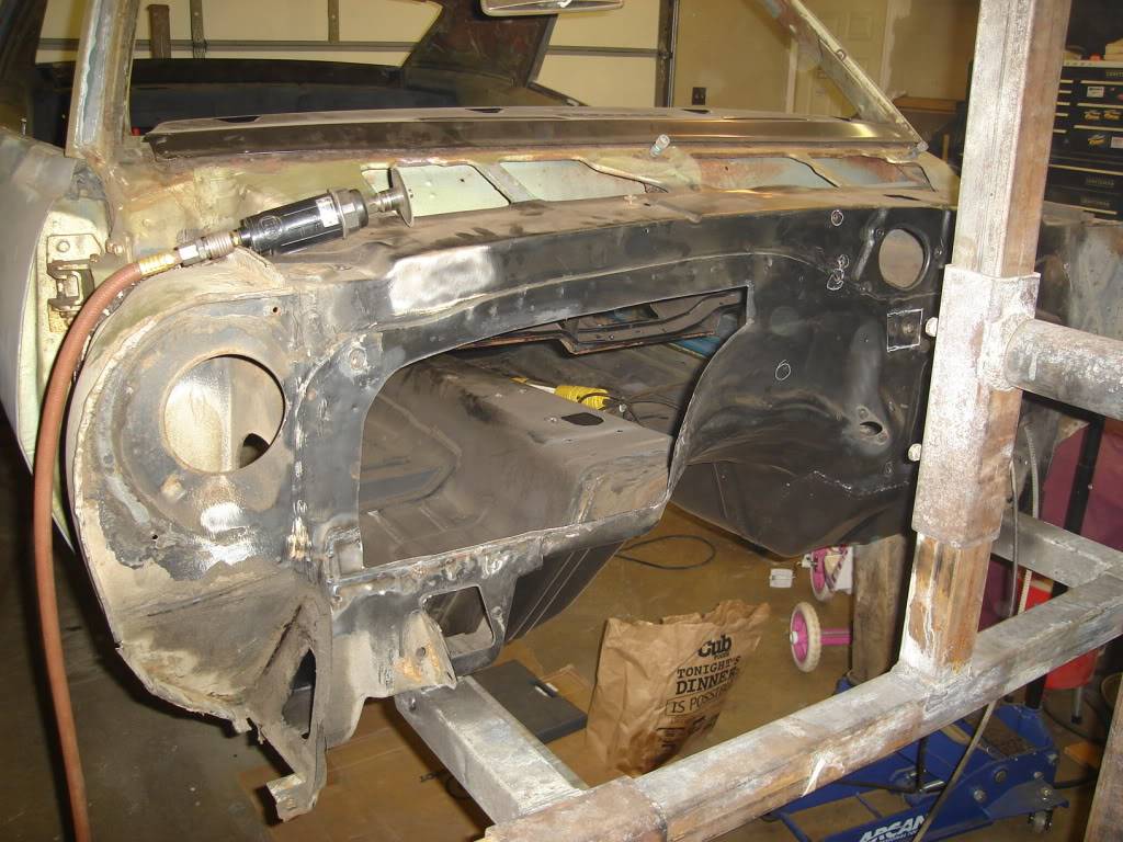

      Started on the firewall this weekend. Heres a before pic.
      After a little grinding.
      And a little body work. I'm not going for perfect but I will smooth out as much as possible. The firewall did not have a flat surface on it from the factory.LOL
